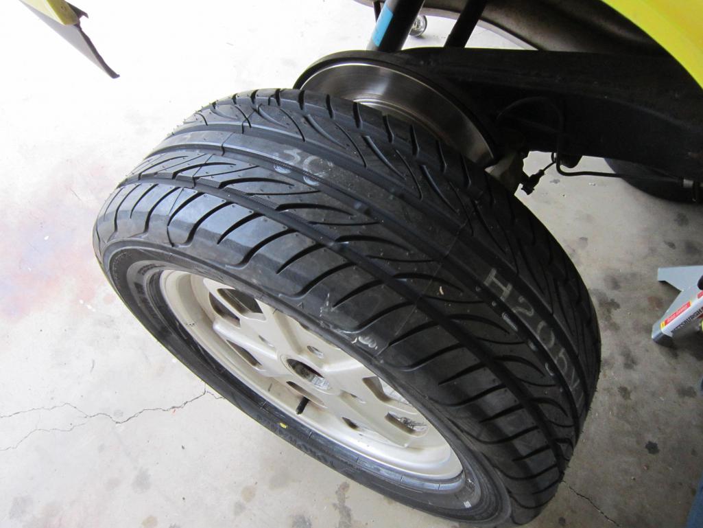

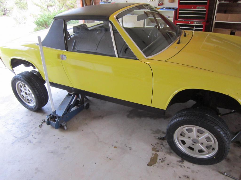

Posted by: drifter914 Jan 7 2018, 11:31 AM
Greetings... I just bought new tires for my 914, ended with happy results, so far !
I have the 15" Fuch alloy rims & want to keep them, so was limited to that size range, obviously. Finally decided on the Yokohama S-Drive 205/55 R 15, which is, surprisingly, made in USA !
It's an aggressive looking tire, business like in the spirited driving venue. A more modern low profile, which is better for cornering, but provides slightly less ground clearance. Has a high speed rating, temp & traction ratings also. Looks like it was made for the 914, in my opinion. However, being a 205, looks a bit pudgy on the 5.5 " Fuchs rim. Height is 23.5", mounted, not 24" that Discount tire claims.
Price is a moderate $95. per tire, plus the usual M&B fees, etc. Oh yes... tread width is 7.5 " So far, I like it.
Here's some pics of the occasion... [attachmentid=634
165][attachmentid=634166]

Man, the pics above remind me just how much I love the look of 205/55R15 tires on a narrow-body 914. Ran a set of BFG Comp T/A3s for years in that size, and the car handled and rode beautifully. Looked great, too.
I've been through a lot of sets of tires in the last ten years trying to find the perfect tire in terms of handling, ride, and appearance (I've grown to like more sidewall, and have grown to hate busy/modern sidewall graphics) in that order. Vredesteins 185/70s had sweet steering response and rode well but were just too far a step back in terms of grip for me, and modern 195/65R15 Dunlop SP4000 (or were they 8000s) just didn't cut it. Currently on Avon CR6ZZ 185/70R15s, but while I love the clean sidewalls, they look a bit wimpy from an angle or behind the tire. More importantly, they have super stiff sidewalls as a tarmac rally/vintage racing tire, and I get the sense they don't come into their own until they're very hot—and I just don't drive my 914 the way I drive a GT3.
I'm back to the tire I probably should have gotten last time: The N2-spec Pirelli P6000 in 195/65R15. They are a modern summer tire that is factory tested and approved (now for a second time) and they look "old enough" to get away with. If I was going down the concours route, I might try the CN36s, but the 185/70s are too narrow while the 215/60s are too wide.
Oh for a great choice in 205/60 that looks period correct, but the only one I've seen is the BFG Radial T/A, and I wonder if they'd be any good on a sports car. Of course, they're probably leagues better than what these cars came on.
