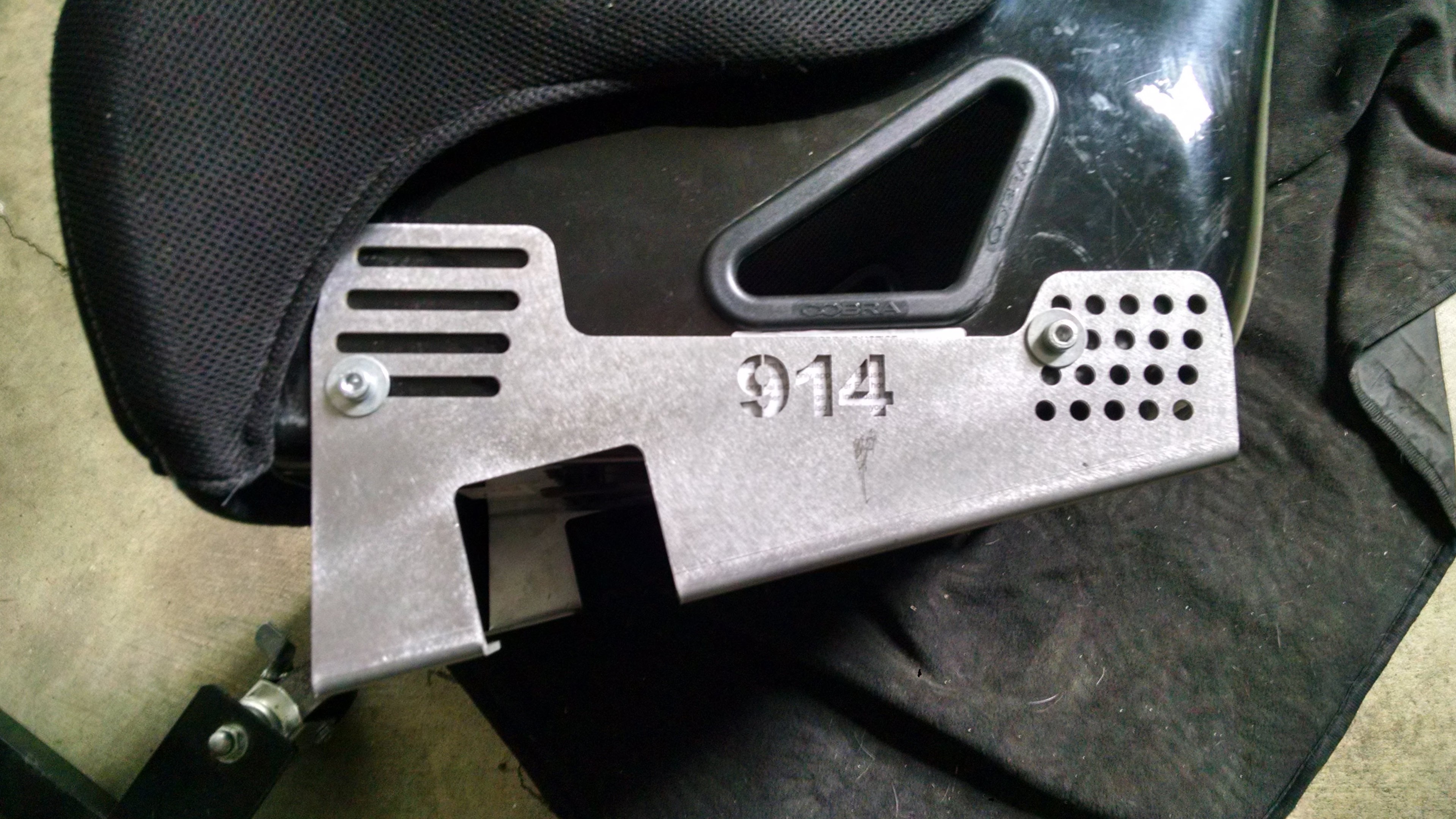

For those who are interested, I had this seat mount fabricated and bolted the mount right through the floor. It is very solid and has plenty of adjustment if I want to change the rake or move the seat backwards
Very nice solution!
