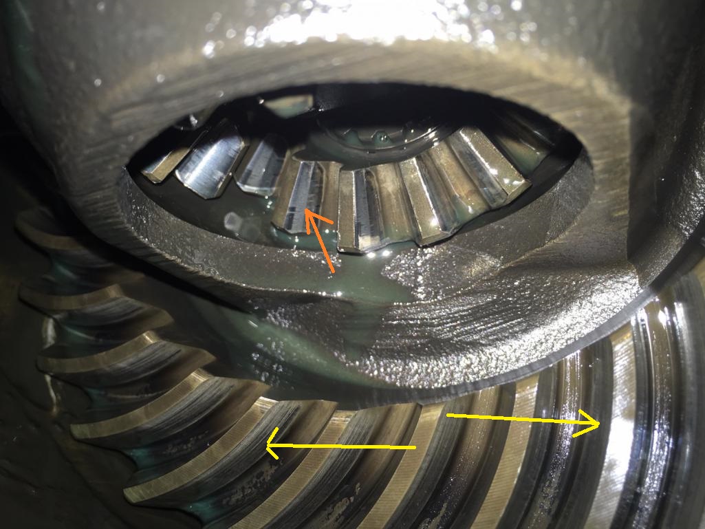

The last picture looks bad. Did you find the chunks in there?

Look again, that’s 2 smaller gears at different angles... I thought I saw broken gears until I looked closer...

I don't see anything wrong with the spider gears or the ring

Hard to tell exactly in this pic, but it is a great start. The yellow arrow show the faces of the pinion that need to be wiped clean and inspected. You are looking for any pock marks, galling, spalling (some fancy terms) where there is metal missing. Wear marks are not a big deal, missing metal is definitely a big deal. Many that have been an issue in the past were blatant (big metal pieces missing from face of pinion).
Orang arrow is your "spider gears" and that wear is normal. No chunks missing. The yellow arrows indicate the faces that need to be inspected. Similar to pinion, we are mainly looking for missing material.

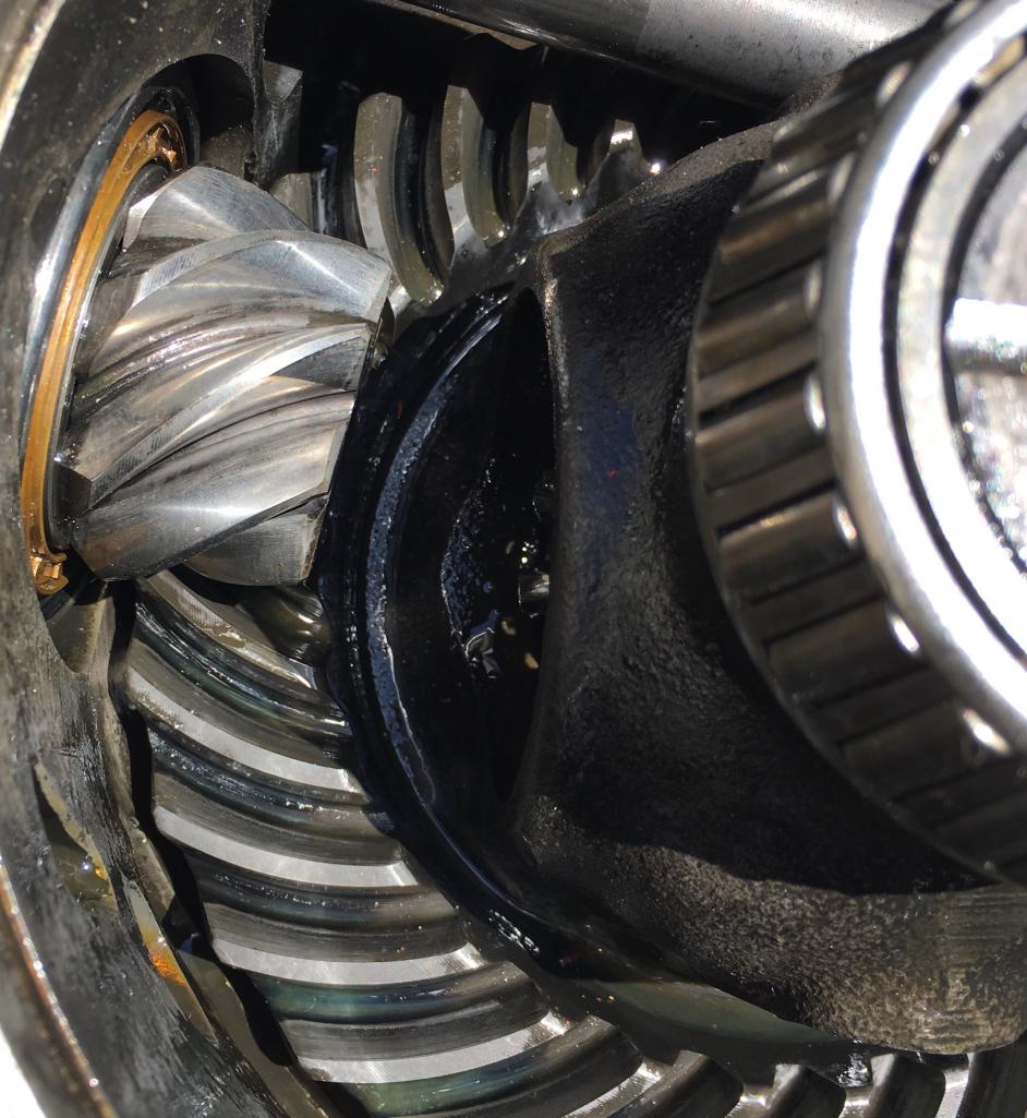

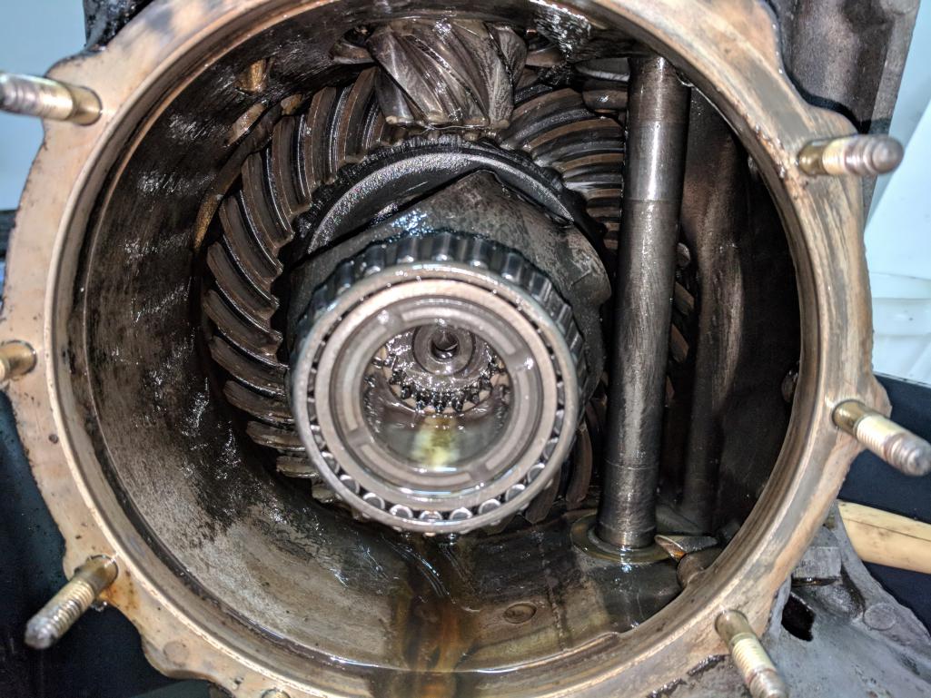

Pulled the sidecover from my core box today. All dif gearing that I can see shows no signs of pitting, scrapes, gouges or uneven wear to my untrained eye. There was a lot of very fine junk on the drain plug magnet. I will try to get my other box out of storage this weekend to compare. I bought this core because the blue paint made me hope it had been rebuilt before and possibly have some new or upgraded parts

This would be a no go
Posted by: yeahmag Apr 27 2018, 06:30 PM
That ones toast. Dr. Evil and I may have some spares, but another box would be easier to start with.
Posted by: Krieger Apr 27 2018, 06:51 PM
Yeah, that's my parts box.

AutonAtlanta racing box with custom lightened pinion. Like their race fans.... ya, that’s poo.

Posted by: Tdskip May 15 2018, 09:05 AM
Pictures of my box
Posted by: Dr Evil May 15 2018, 09:15 AM
QUOTE(Tdskip @ May 15 2018, 11:05 AM)
Pictures of my box
Wrong side cover, but stuff looks good. I need you to take the 19mm bolt out of the flange on the side of the side cover (passenger side in 914), pull the flange, then remove the 13mm nuts and pop off the side cover to get to the r/p.

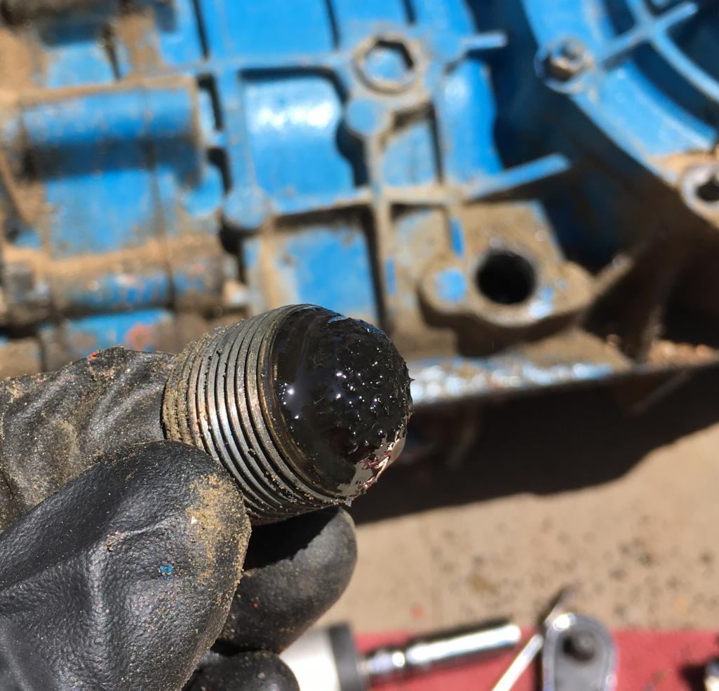

Posted by: ValcoOscar May 19 2018, 01:26 PM
All I could do for now...what you think?

Posted by: Dr Evil May 20 2018, 12:05 AM
Oscar, those pics look fine.

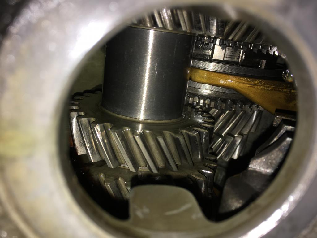

Posted by: Tdskip May 20 2018, 10:42 AM
Posted by: Tdskip May 20 2018, 10:43 AM

Posted by: Dr Evil May 21 2018, 09:26 AM
QUOTE(Tdskip @ May 20 2018, 12:43 PM)
Looks good.
Posted by: Tdskip May 21 2018, 09:45 AM
Phew - thanks Doc!

Dr - I opened and cleaned my trans tonight. Here's a pic of my R/P. It looks good to me... but what do I know, I'm not even your student yet. It was a little gunky inside but there are no missing teeth or anything weird.

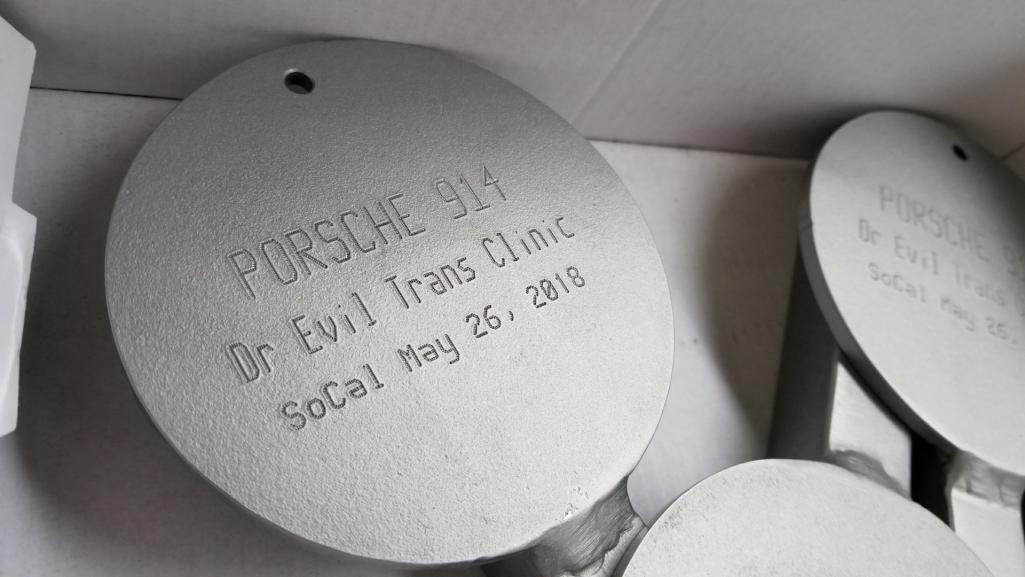

Posted by: ValcoOscar May 25 2018, 11:44 AM
Well, I made something special for tomorrow.
I'm bringing a few FREEBIES for Dr, Host and all paid participants.
Extras will be made available @ $15/ea or two for $20
Jack Pad for 356 / 911 / 912 / 914 / 930
Some w script, others bare.
I just can't stand to throw away useful metal scrap.
Oscar

Uh....your teeth on the pinion look weird. Is that from the degreaser?

Ha! That’s fantastic! Very cool.

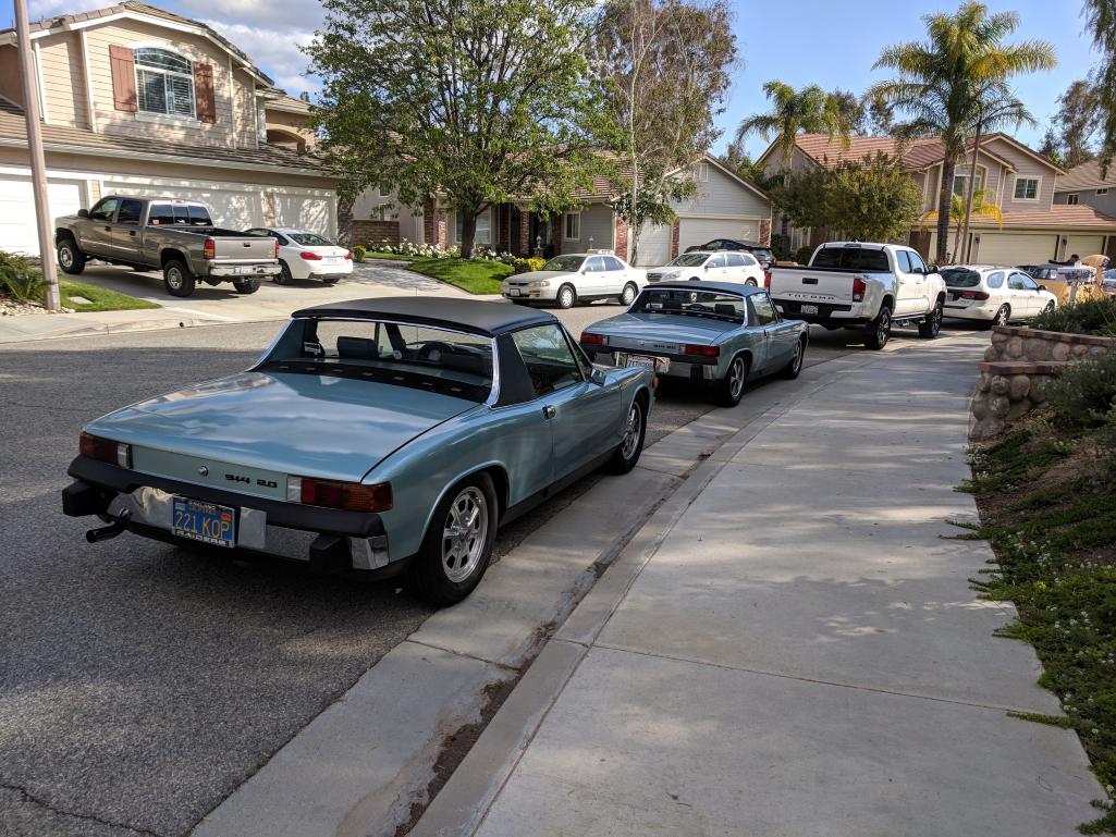

Ravi and Gabe's 914's
Posted by: MM1 May 27 2018, 08:32 PM
Thanks to Dr. Evil and Jeff (and all the Ladies and Gents), I learned a lot and had a chance to practice on most of the transaxles. So today I decided to reinforce, practice and discover he state of my 901. . .
Pinion looks chipped a bit, scynchros look shot, and the speedo gear lock bolt threads look like they had been heli-coiled (which has failed- figured something was up with all the zip ties). Guess it was rebuilt at some point, but this car had 238k on it.
I would never have been able to open this box up without your guidance, Doc- mil grazie!
Posted by: MM1 May 27 2018, 08:33 PM
Ring and pinion
Posted by: MM1 May 27 2018, 08:37 PM
Pinion - didnt see chips in the other pinion shots- doubt it was normal machinng but don’t know
Posted by: MM1 May 27 2018, 08:39 PM
Ring
Posted by: MM1 May 27 2018, 08:42 PM
2nd and 3rd- scynchros rounded, band flattened
Posted by: MM1 May 27 2018, 08:44 PM
2 and 3 rotated
Posted by: MM1 May 27 2018, 08:46 PM
4 and 5
Posted by: MM1 May 27 2018, 08:48 PM
2-5
