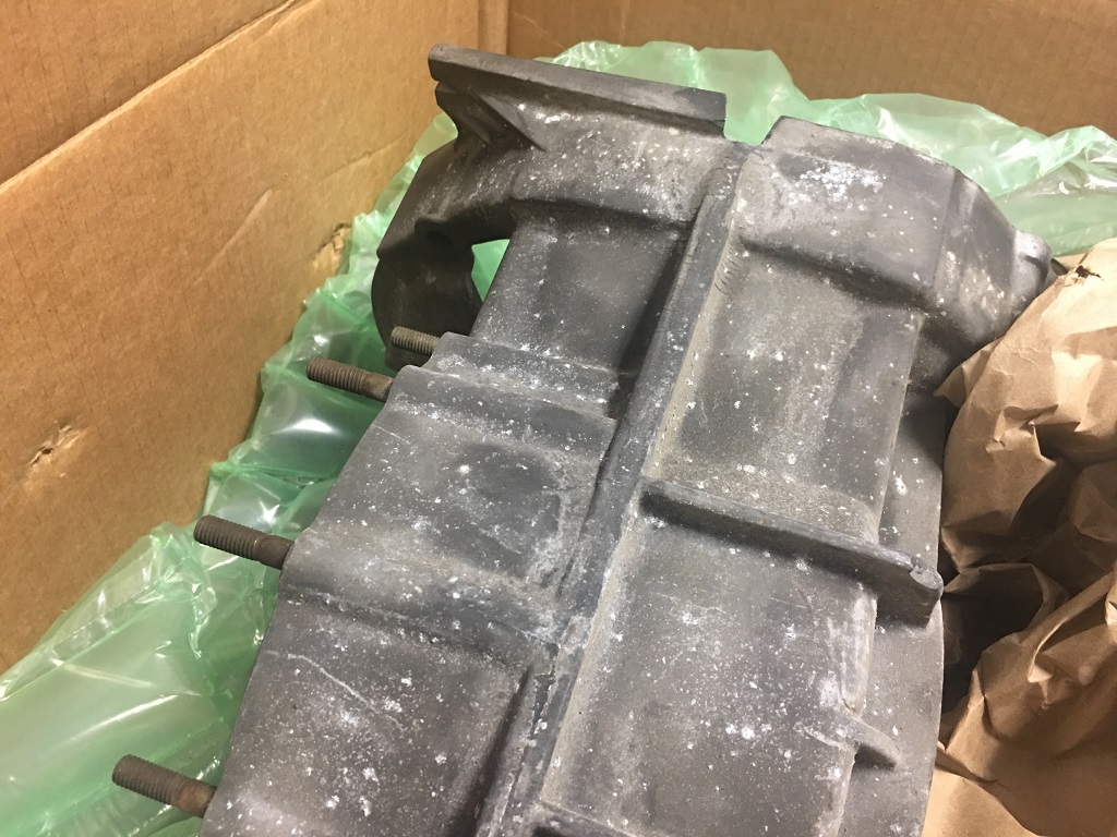

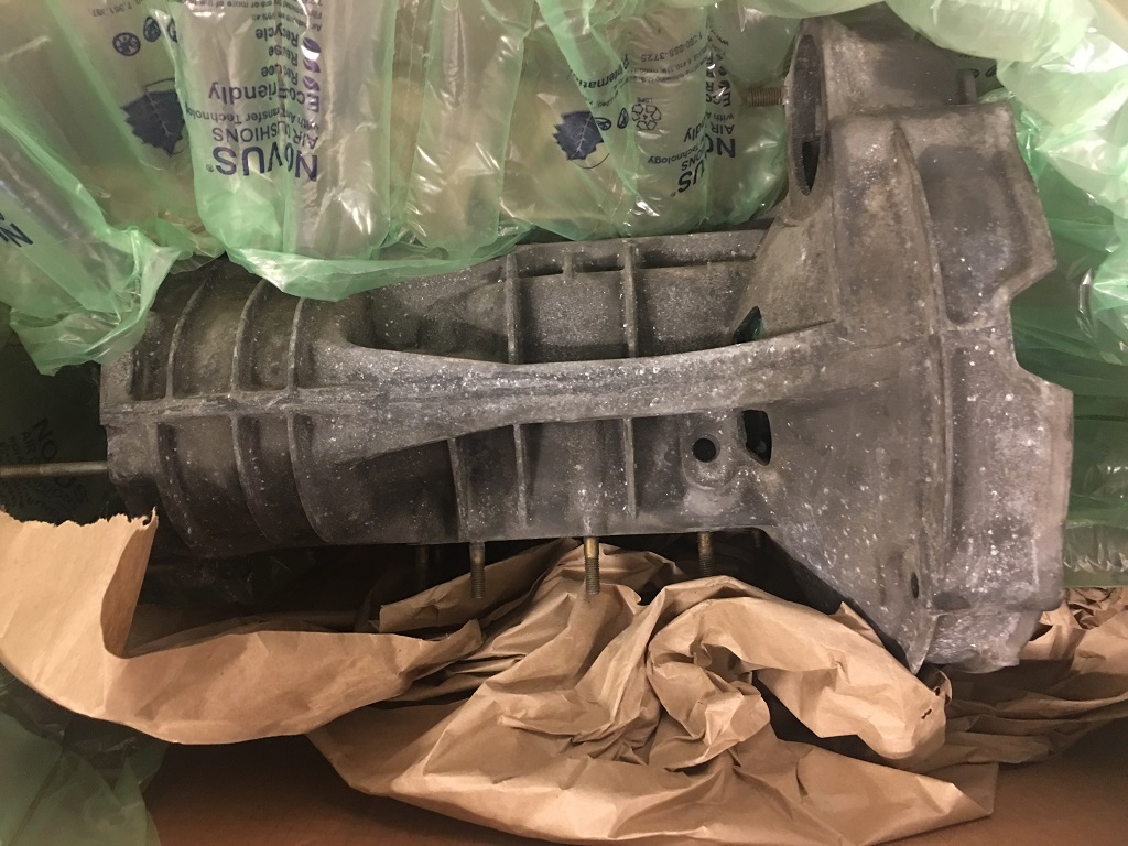

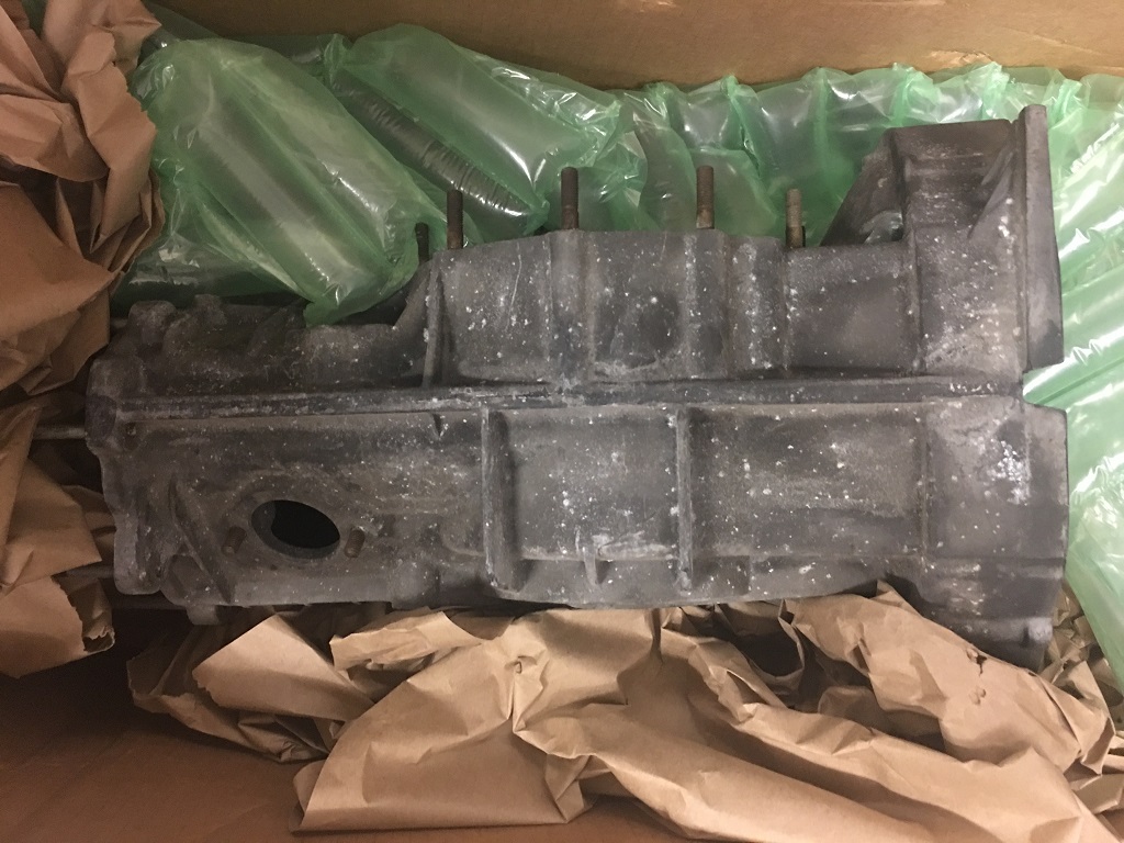

I need to have my trans case cleaned. Can someone recommend a shop in Portland (or the outlying areas) that specializes in cleaning and treating mag cases? I want a professional to do it, as I'd probably make a mistake and damage it in some way.
Thanks,
Greg
If it’s a bare case, find someone with a hot steam pressure washer. Takes 5-10 minutes and gets it clean without chemicals. The steam melts off the tar, undercoating and oil and the pressure gets all the nooks and crannies clean. If you were around me, I’d do it for the cost of a cheap tyvek suit - $10. It makes a bit of a mess.
Then I would just hose it down with Gibbs or ACF-50
I've soda blasted light oxidation with good success. After soda blasting I've been told that it's a good idea to rinse with vinegar.
Greg, Gordon Ledbetter uses plastic beads to finish the high $$ mag cases.
The place we use to blast our chassis uses plastic media. I bet if you call around you can find someone. It will look great when done.
They bought a place in Arizona. I think he's finally really retiring.
But he was in the shop week ............. I think you'll need to catch him at weak moment.
When I get home I'll PM you his contact info.
I believe hot tanking can dissolve magnesium from what I have heard.
