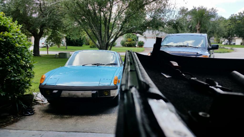

Luckily I have a late top amongst the spare parts, and as I was removing the old seals and getting it ready for clean up and paint, I noticed that the two side rails that the side seals slide into are bowed. Both rails are bowed towards the center of the top.
I looked at other spare tops and one of them has the bow towards the outside, and some towards the center of the top.
Which is correct? Is the rail supposed to be bowed at all?

Posted by: theer Jun 2 2018, 05:52 AM
I would expect the shape of the rails to match the top edge of the window. I've never actually cheeked, but I always assumed the windows are pretty darn flat/straight... if so, the rail should be straight? But maybe I'm misunderstanding the question?
If you have the rails off the top, slide a seal in there and hold it up against the window and take a picture.

I looked at the top of the window and it looks strait to me. However, the the rail for the side seal has a definite curve to it and it does not match the side line of the top which also looks straight to me.
The top is now at the body shop getting repainted so I can't put the rail against the top of the window at this moment. But I can tell you that the other tops I have in storage are the same. The issue is that some tops have the curved rail facing the center of the top, and others have it facing out. Which one is correct???

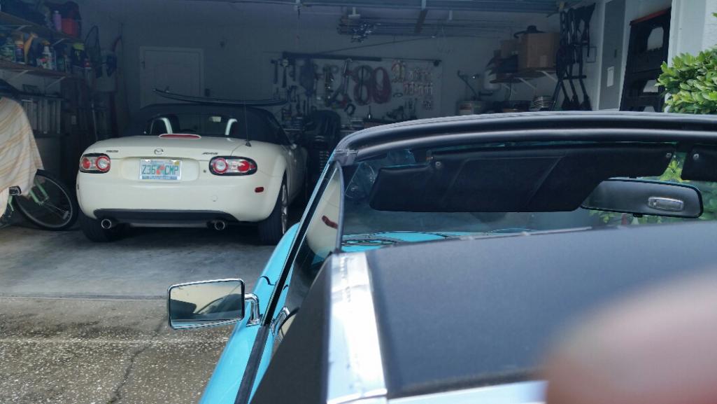

Posted by: sholman5 Jun 2 2018, 12:09 PM
I have a 73. Manufacture date 10/72. Early top. Seal channel curves to the inside as well as the window.
Posted by: theer Jun 2 2018, 01:49 PM
Aha! That picture of the top of the window is perfect. The arc of the glass (higher in the middle), at an angle to the plane of the top rails = a slight bow in at the center.
Never really noticed the arc of the glass before.

Posted by: jcd914 Jun 2 2018, 02:44 PM
QUOTE(theer @ Jun 2 2018, 12:49 PM) *
I looked at 3 tops today and they all had the slight curve in from the edge of the top.
Now it makes sense.
