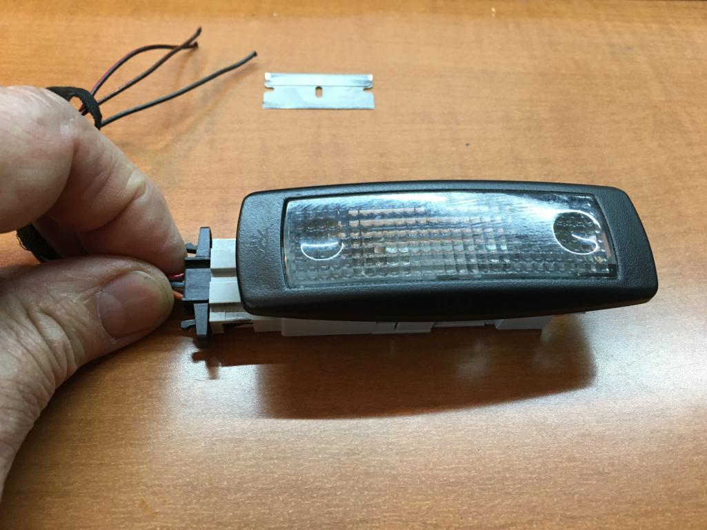

[attachmentid=667159]

Her yo go. Found my photos.
