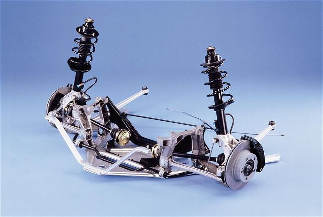

My idea of the ultimate 914 brake/suspension setup.
911 GT3 front suspension with coilover shocks and Boxster Brakes
IPB Image
Boxster rear suspension complete with brake calipers.
IPB Image
Go full race bushings on the Boxster rear suspension.
Very adjustable and capable of handling a lot of HP.

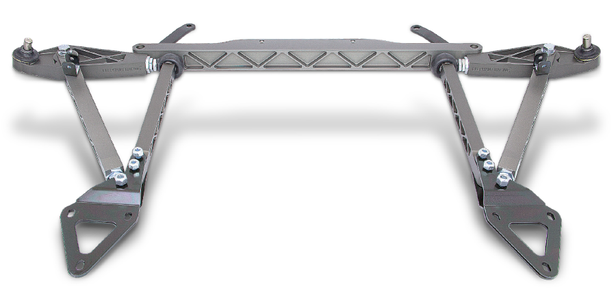

Very cool idea, Clay—and GT3 Cup control arms are a direct bolt in for the rear, which offer a lot of precision with more than enough compliance to be nice on the street.
Raise the upper damper mounts for the rear with custom coil-overs and...that would be a very trick setup. And there are a fair number of dead 986s out there. For the very adventurous out there, the GT4 stuff is even nicer....and set up to work with a gearbox with a limited slip diff, axles, and gears good for 385 hp with 300+ lb-ft of torque in a 3000+lb car with sticky 295s out back. If all could be adapted, it might be the ultimate setup for a 914 with a lot of engine. Might have to "downgrade" the brakes, however, as everything is set up for 20-inch wheels. 19s fit over the standard GT4 brakes; 18s are trickier with the knuckles...making the 986 (which used 16s) or 987 era (with 17s) a better fit.
Posted by: ConeDodger Oct 10 2018, 08:34 AM
