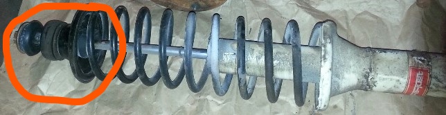

Just a few basic questions:
1) Do the rubber bushings I circled need to be changed? None are cracked or damaged, but are they just spacers or do they affect how tightly the car handles?
2) Plan on replacing shocks with Bilstein shocks. Can I reuse the top hardware shown or must I acquire new parts? If so, where would one purchase said parts?
3) Is there a recommendation for a rear trailing arm rebuilder in the San Diego area? I need new rubber bushings, new bearings, and my hubs pressed back in. I know many do it themselves, but after reading some of the recent posts I'm a bit intimidated.

I am pretty sure that you will get those bushings with the new shocks.
Posted by: 914Sixer Jan 7 2019, 11:32 AM
Nothing comes with rear shocks. Reuse everything.
Posted by: mepstein Jan 7 2019, 11:40 AM
QUOTE(914Sixer @ Jan 7 2019, 12:32 PM)
Like mark said, reuse it. New shocks only include a top nut and a clip for the lower spring cup. You will need the cups that hold the springs for the Billys. Give Bdstone a ring, he usually has a pair. think they are around $60 each new.
Edit - some of the Billsteins include the lower cup, some don't but great shocks.
Posted by: TravisNeff Jan 7 2019, 11:42 AM
I am almost positive my rear koni sports came with the cups and bushings. But that was a long time ago..
Posted by: dr914@autoatlanta.com Jan 7 2019, 11:50 AM
usually the bushings are good, and only gas shocks are available so do not need the shock pillow, hence rear Bilstein shocks and new factory duplicate rear springs

I just received a pair of new rear Bilsteins on Saturday. Here is what you get in the box: Shock, locking nut, 2 washers, a lower spring perch. There is also a circlip on the bottom ring that can be moved to adjust the lower perch location.

Getting ready to assemble the rear strut with Bilstein shocks and 100 lb springs from 914rubber. Just a few more questions:
1) Are parts 4 and 5 not applicable to Bilstein shocks?
2) Is part 6 orientated small hole up? It's been too long since I took it apart to remember.
3) If the top ring recess (furthest from the ground) is #1, is the #3 slot the correct slot for the clip (part 2)?
Posted by: bbrock Mar 14 2019, 04:02 PM
I just finished installing my Bilsteins like 30 minutes ago! Here's what I can tell you:
- #4 is definately for Boge shocks only and not used for Bilstein.
- I don't think either #5 or #6 is needed with Bilstein gas shocks. I installed them anyway, mainly for appearance. #6 goes small hole up. I believe there is a better pic of it in the Factory Manual.
- I mounted my lower spring perch in the highest ring but you will probably need to go one or two lower. I installed my factory springs which are rated at only about 52 lbs. and that's about where they tested. I just put the Bilstein shocks next to my old Boge I am replacing and chose the perch that best matched the Boge. I may need to readjust after the car is put back together, but that's where I started. With stiffer springs, I'd assume you would need to lower the perch to retain the ride height but I'll let the smart people who actually know what they are talking about chime in.
