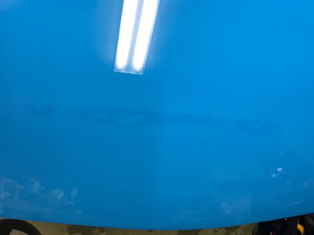

Here is a picture of the run:

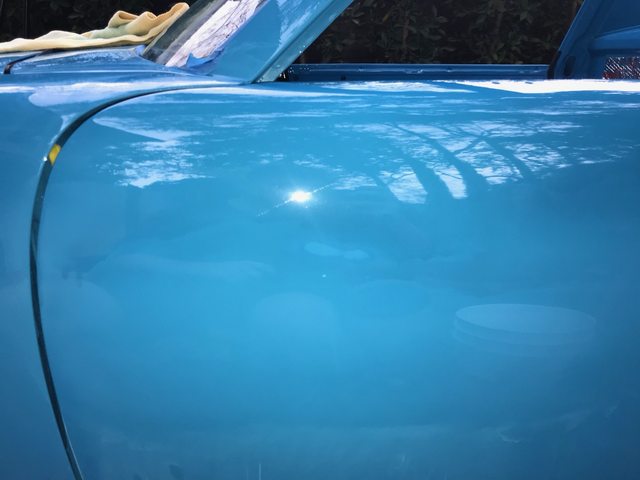

Here is a picture of the door. The light spot, to the bottom right of the camera flash, is where I've gone through the top layer.

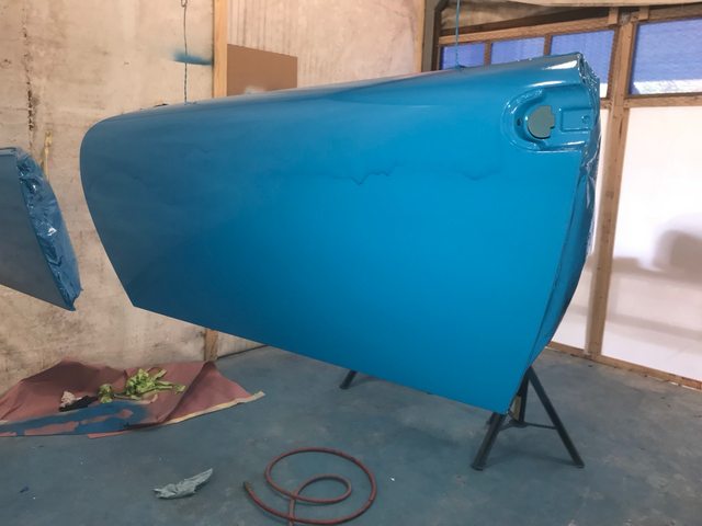

I've also rubbed through the top layer on an apparent high spot in my front hood. Here is a picture of that. You can imagine how happy I was with myself with I noticed what was going on.

Many people feel you don't color sand single stage. The solid colors tend to move to the top so if you sand it, you are removing the most important layer.

Our shop painter said 3-4 coats isn’t much. Especially if the paint isn’t top of the line. He said you don’t want to color sand single stage if you don’t have to but if you are a newbie, you might have to. Never sand metallic.
He suggested spraying some test panels with and without sanding so you can see the differences.
Single stage each layer of pigment deepens the color saturation. Light passes through and bounces back out. This is why different colors of primer give you a different hue of the final paint color. Sand off some and color will change unless you are really thick. You will get dark lines around the edges of the run as the pigment settles.
For a run you need something with zero flex so it only hits the high points. If a nibbler is possible I start with that and cut off some of the run then I use paper on a wood paint stick. I start with around 400 to knock down then get into finer grits for polish.
