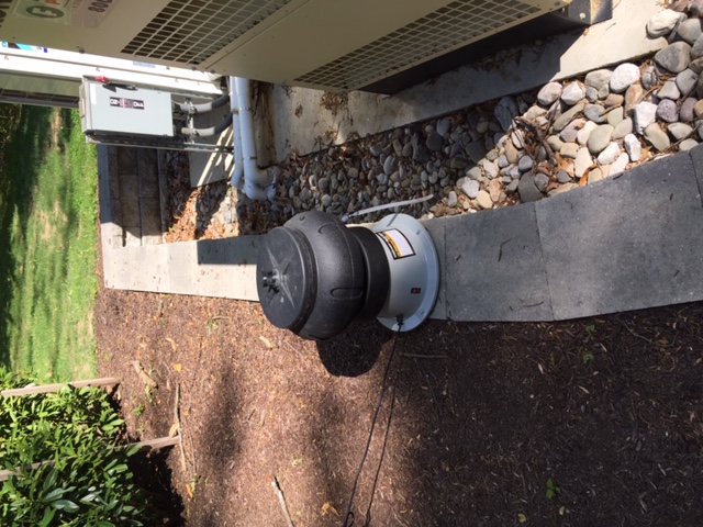

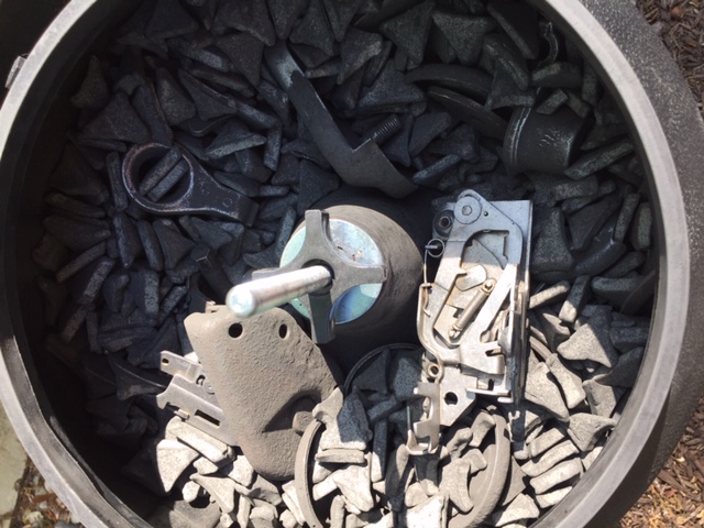

Does a good job cleaning up the parts but leaves a residue. I bought some kitty liter and home that will work to clean it up and give it a final polish. It’s loud but I found a place in back of the building so it’s not so annoying.
Posted by: burton73 Apr 29 2019, 03:00 PM
I got the same one and tried on a set of lugs. It left some crap on them. I have been to the factories that make this stuff. They use polyester casting resin and fill it with the grit and pour it in rubber molds of a pyramid shape and then pop them out but the millions. I think it leaves resin on the pieces. As Acetone should clean that off as it eats/thins resin

I've had pretty good luck with mine. Kitty litter didn't work for me because it pounded to dust too quickly. Might have gotten the wrong stuff. The pyramid resin chips have worked the best and like others have said, works better with some sort of solvent. I had the best luck with Pine-sol in the resin chips. Also as others have said, there are limits on how far it gets into recesses etc. For fine polish, filling the tumbler with walnut shells worked pretty well.

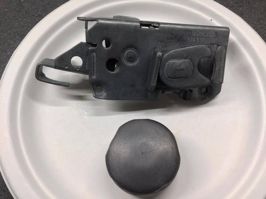

Here’s the parts after I rinsed off the kitty litter powder. No residue from the ceramic media. Left it smooth but dull. I’m guessing this will result in a dull finish if I zinc plate. @http://www.914world.com/bbs2/index.php?showuser=20845 will walnut shells actually shine it up or am I chasing my tail. Last year I bead blasted a 5 gallon bucket of hardware but left it in my garage so everything had a light coating of rust. I don’t have the patience to head blast again and I was hoping for a smoother finish than what results from blasting. Suggestions are appreciated.

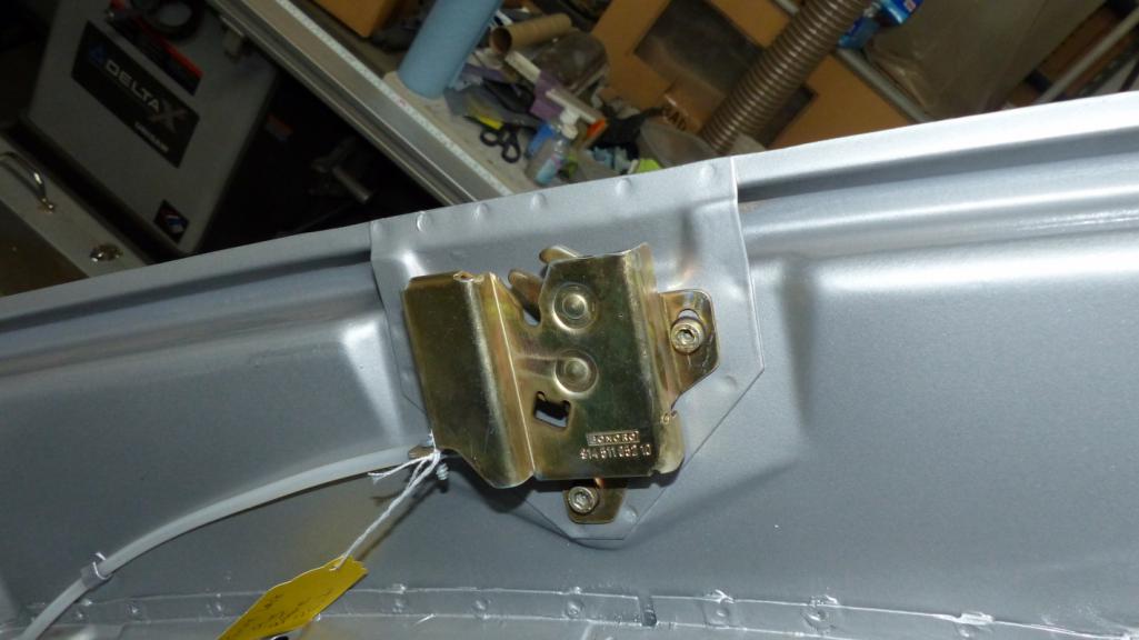

Quickest way to shine the big stuff like that is with a wire wheel. Should take less than a minute to polish off the latch. This was one of the earlier pieced I plated so not my best work, but not bad.
I used walnut shell mostly on stuff too small to wire brush. Walnut might polish the larger stuff, but I'll bet it would take a long time. As was already said, there are some good Youtube vids of people trying all kinds of things with different results. There are some good tips on prepping for electroplating in this one:

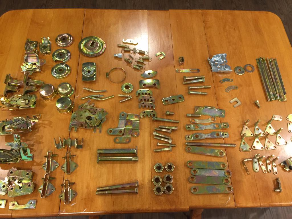

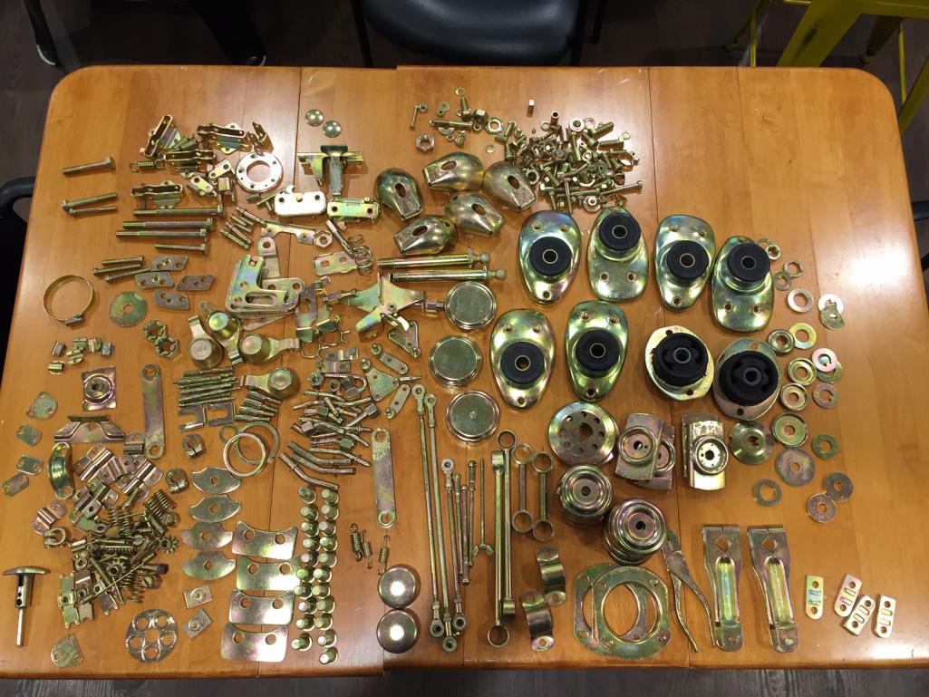

So the kitty litter was ok but not really and made sort of a mess. I took 76-914 advice and purchased steel shop off ebay (cheaper than amazon) 10lbs for $18 shipped. I didn't use stainless because I was using ferrous metal anyway. Stainless is good when you don't want to leave residue that can rust. So far the results look great. A couple bonuses with the steel shot; The tumbler runs much much quieter. It works quickly, I could see results in 15-20 minutes, not hours. It doesn't leave any mess. It last WAY longer than other media, like 1000x longer. The only downside is the steel shot is so much denser that 10lbs isn't enough to cover the pieces. I had to order another 10lb bag and wait until Tuesday for delivery.
Here's a pic of the first batch I sent to get plated.

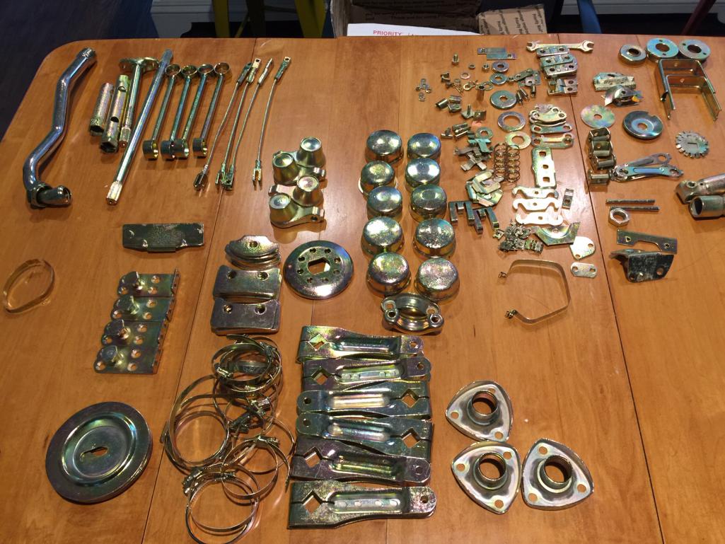

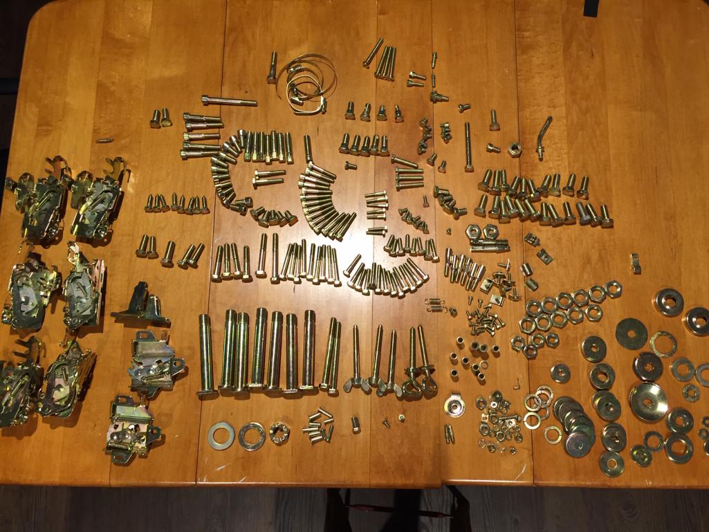

First batch is done and I’m very happy with the results. There is a time and labor investment involved.

I'll pass the compliment onto my sister in law. BTW, those look great!

Nice! My stuff is at the same shop waiting for plating now. I did not send the rear trunk receiver thank goodness.

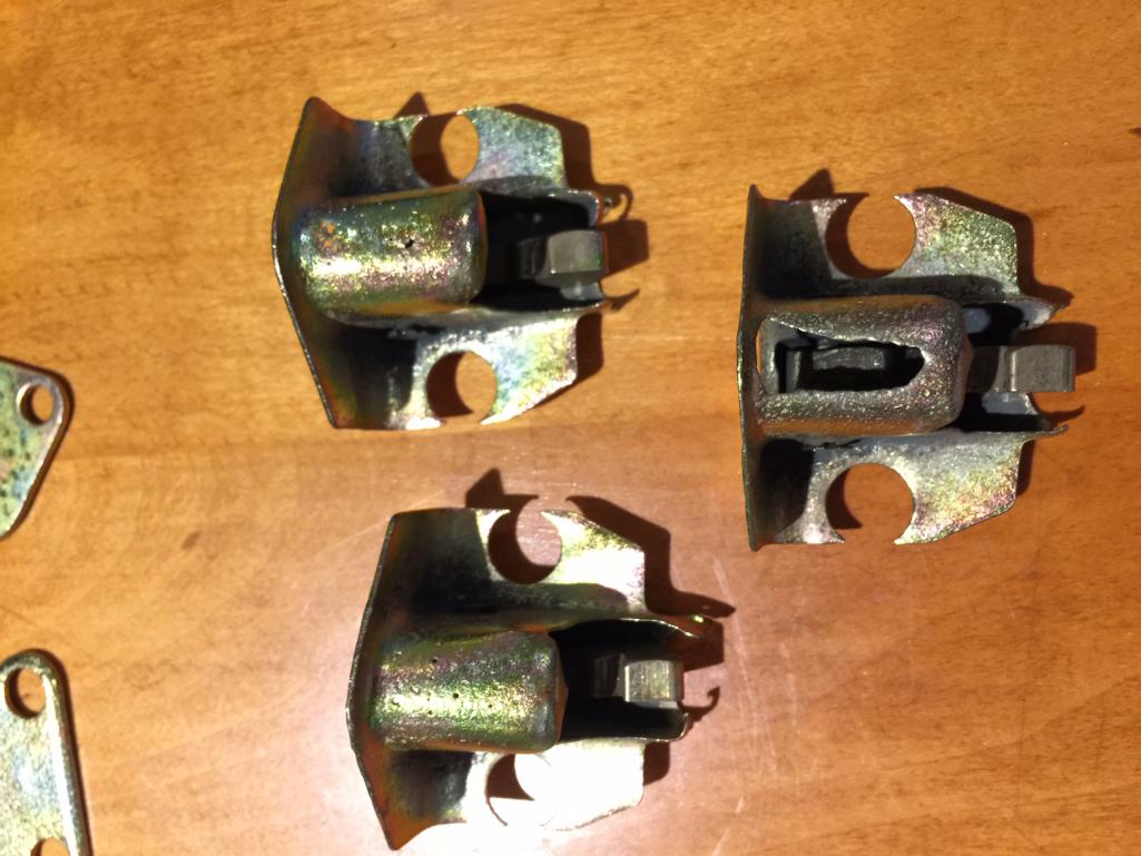

Add late type headlight pivots to the list of parts to not plate. Late type are steel posts inserted in zinc bases. See how yours got ate up? Note the hole size is enlarged on all but two which are early. Look at at the ends. Early all steel have a radius end. Late type have a flat end with a bevel.

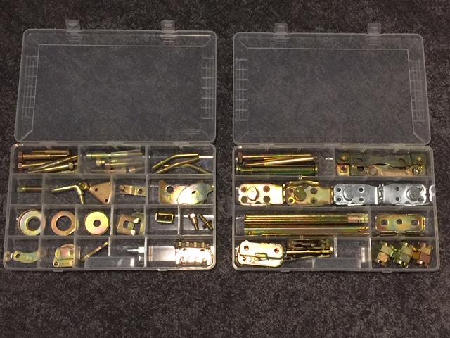

I went to harbor freight and bought a bunch of these plastic boxes. I’ll have more parts returning from plating and didn’t want to just keep them in a big box. These should let me find parts pretty quickly. Not as nice as the metal organizers at the shop but budget friendly for me. The larger parts will go into the hanging plastic bins. I’ll pick up another tomorrow with a 25% coupon.

I bought several of those organizers on the right from HF. My only complaint is that half the latches don't work or break off after a couple uses. I just stack them flat and they work fine though.
