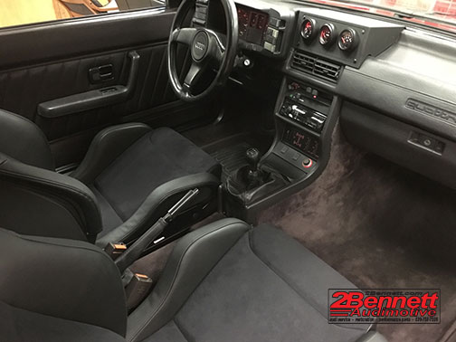

Looking to create an Audi style dash gauge pod. Has anyone tried this? Did a Google search with no luck. Not a fan of pillar mounted gauges. Probably going with Battery / Oil Temp / maybe a clock...or Cylinder Head Temp. VDO gauges, of course.

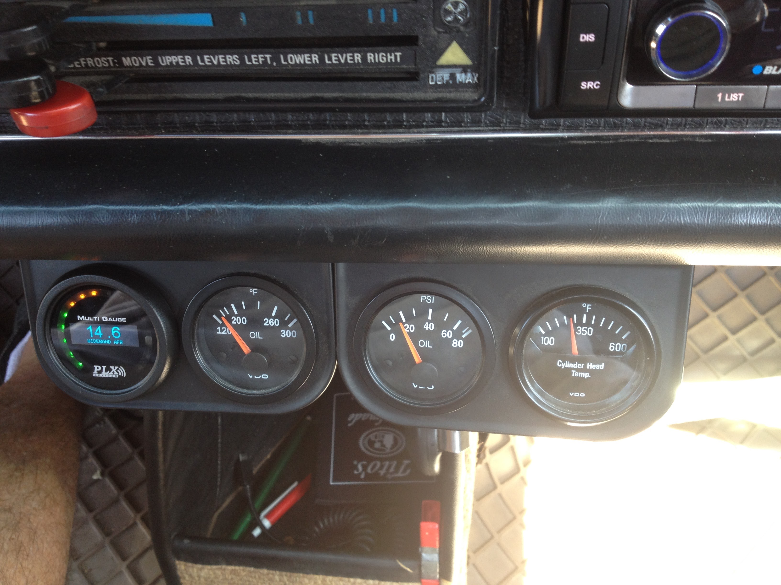

VDO stopped making the CHT.... so if you're going for pretty, they won't match. I like the "deposit box" the 3 gauge thing wastes so much space. So I bought 2 VDO type 2 hole "L" brackets and put them under the dash and at the top of the deposit box. Very functional. A/F OT OP CHT

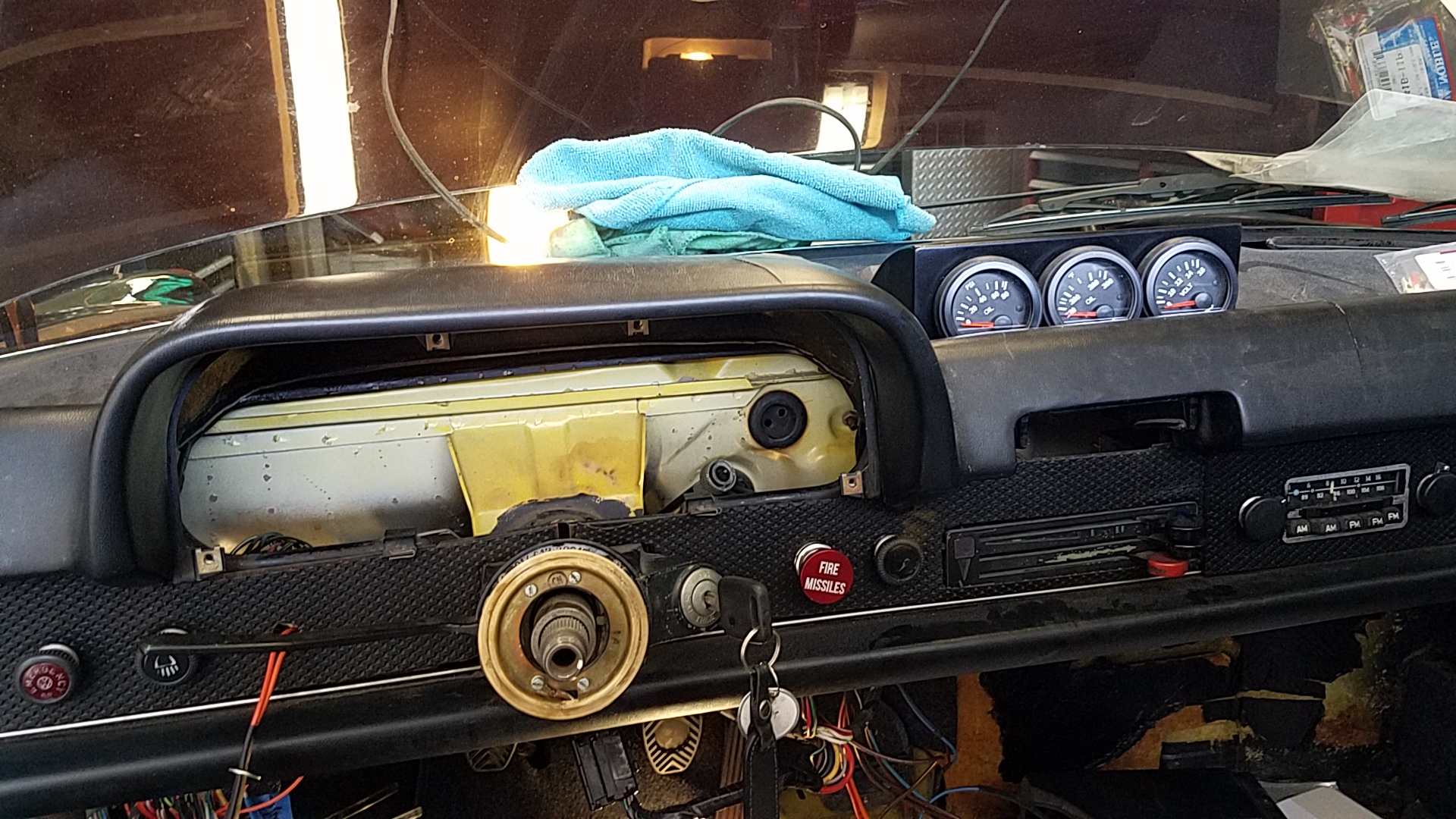

A friend wanted to add three gauges that would be in his field of view, not down below the dash. He did the basic aluminum shape and I did the welding and wiring. It has VDO oil pressure, oil temp and voltage gauges and also a USB port. It appears to be mounted a little low, but when in the driver's seat you can see the entire range of each gauge.
And yes, he has a sense of humor.

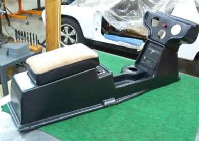

reminds me of the old amco console, Jeff bowlesby may have a picture of one installed. Has an armrest and a guage pod that sort of looks like the Audi pictured

Not installed, but you get the idea. I would love to find one of these.... I have 4 gauges tho. Don't remember seeing one with the rectangle gadget with the LCD. Wonder what that is. Plus are the rocker switches usually used for seat heaters or power windows?

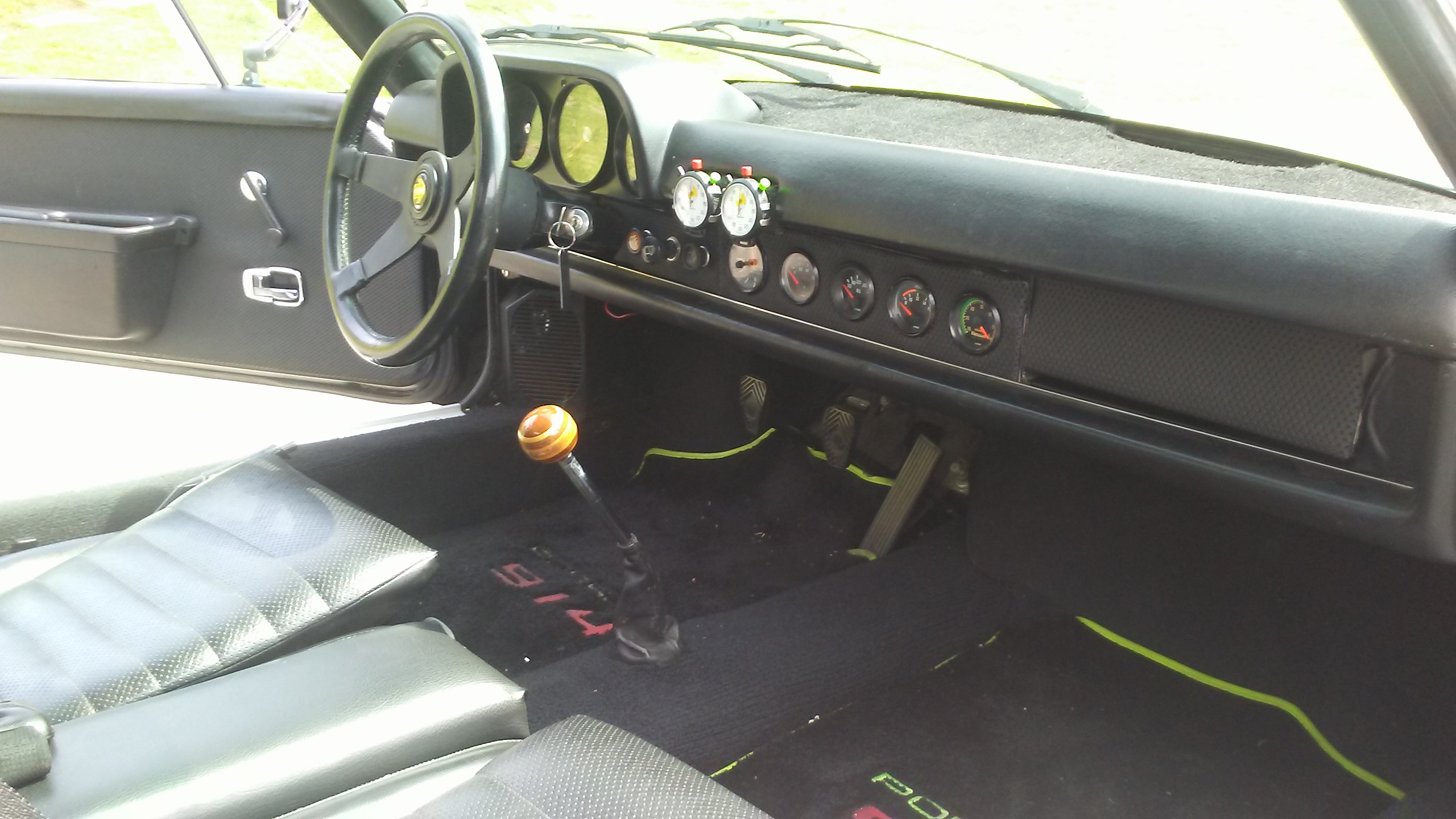

I did the dash....Ferrari 250 GTO style

CHT and OT has caused me to check around. A full size paper towel had been sucked into the fan and was covering 1/3 or 1/2 of the fins. OT went up to 260 on a 80* day. I knew something was wrong. CHT needle does not move as far for a 20* increase, but I noticed a change.
another time, my ALT light came on on a 3 hour interstate trip. The voltage gauge assisted in how close I could get to home before shutting it down..... 8.5 volts as I pulled into a Cracker Barrel parking place.... 45 minutes from home.
For some people they are nice to have, some look nice, and I enjoy the feedback. To each his own.... like brands of oil, tires, etc....

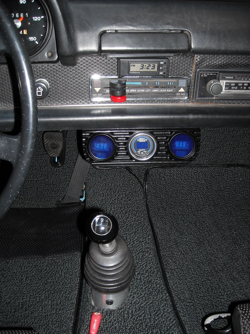

i have a 2 gage pod under the dash edge for CHT & oil P. Replaced the lighter socket with a dual USB that includes digital voltmeter. I'm going to replace the VDO CHT gage with a digital one . My phone sits nicely in the ash tray.

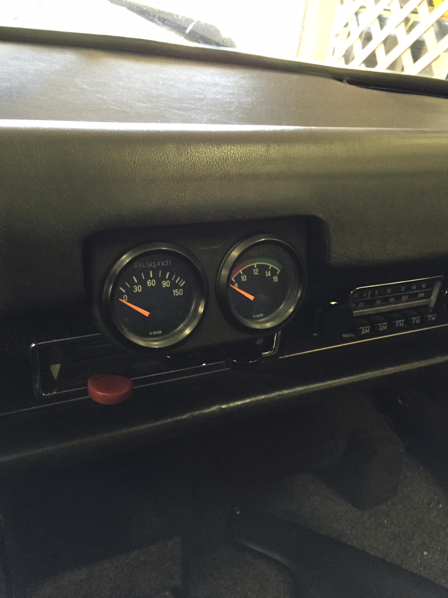

If you don’t use the ash tray, I found this a convenient location using a VDO rubber bracket.
Posted by: Superhawk996 May 16 2019, 07:01 PM
QUOTE(GeorgeRud @ May 16 2019, 08:55 PM)
Lots of great ideas floating around. This one blends in well.
Posted by: porschetub May 16 2019, 08:14 PM
QUOTE(GeorgeRud @ May 17 2019, 12:55 PM)
the best one yet,no holes to drill and a shitty old twisted ashtray gets recycled … excellent

I like that dash like that , you can do a hidden Bluetooth radio under dash, - also like the window crank, looks VW? where did you source that from? I am changing mine out I hate the cheap black plastic ones the late cars had.
Posted by: dr914@autoatlanta.com May 17 2019, 08:11 AM
yup that is it, Amco provided a lot of accessories to the dealers so they could install on the new 914 and make some extra money
shift knobs
that console
rear deck lid rack
bumper bars front and rear
among other things, anyone have an old amco catalog showing the 914 items?
