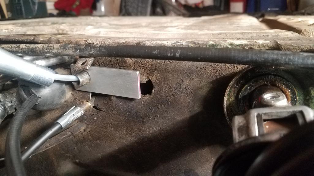

The silver cable with the red ends in this picture is just a stainless steel cable. It is being used as the ground strap.
The white and yellow wires are a home built wire setup for the license plate lights.
The green wire is to the starter.

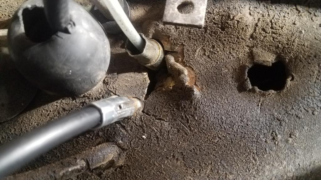

When I was checking the car, I was really happy with the lack of rust and good condition mechanically. the one area I neglected to check as well as I should have was the wiring. Some PO(S) did some seriously substandard wiring work.
Nothing that can't be fixed but it is still annoying.
The green wire goes to the starter.
needs a transmission to trunk floor ground strap (factory), and ground will be good,,, 1 down

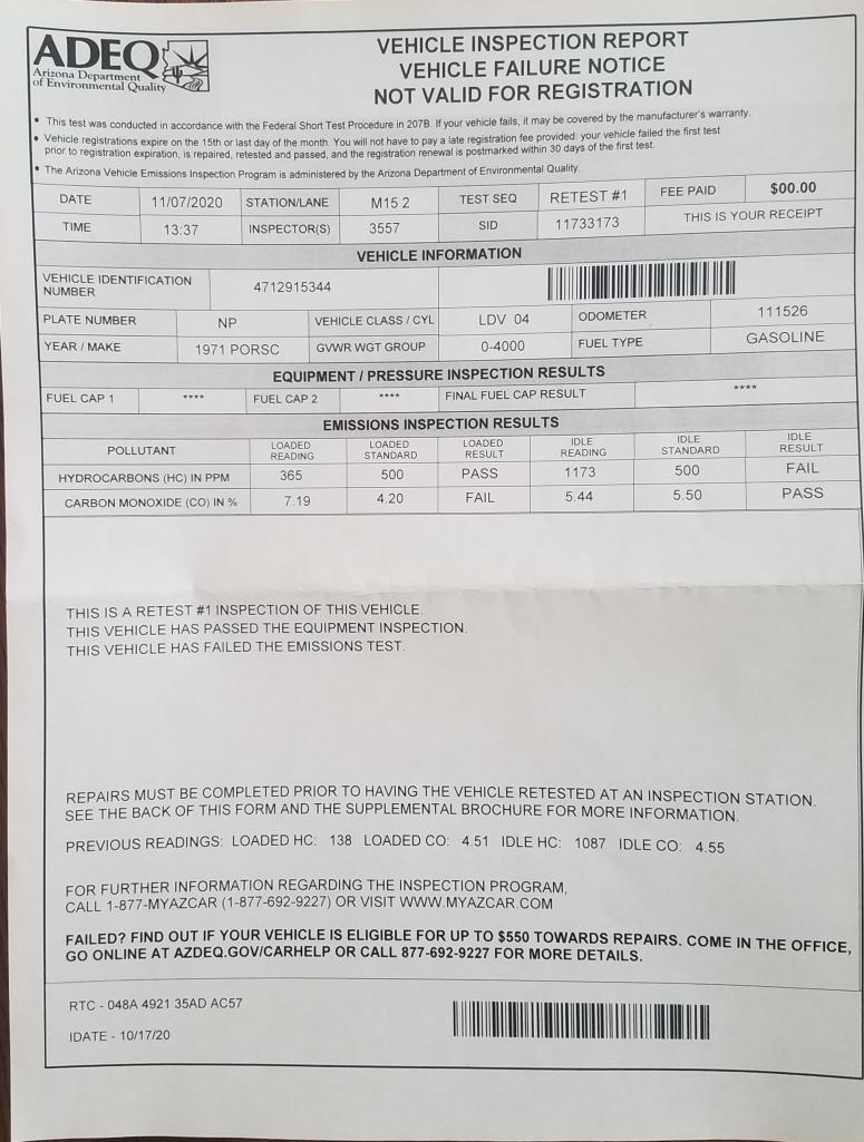

Working on a tune-up. Trying to get it to pass emissions.
Points, condensor, plugs, cap & rotor.

I am definitely having a misfire and unburned fuel. I am getting a backfire up through the carbs.
I replaced the points, condensor, cap and rotor, and the plugs.
I am going to adjust the valves and then check the timing.
If those things don't fix the problems, I'll start looking into the carbs.

I've been traveling a lot so not much has been done. It still doesn't pass emissions.
I've joked with my son that I am going to remove one of the spark plug wires to make it slower.

I tried spraying the starter fluid into the carb opening for each cylinder and found that spraying it into cylinder #2 doesn't do anything but spraying it into any other cylinder causes the car to bog down.
So now I know that cylinder #2 is a problem. I don't know if it is the only problem but it gives me a place to start.
After adjusting and/or replacing everything I could think of, I was not getting any differences in behavior so I dropped at Don Jackson Enterprises in Phoenix for a thorough checkup. His initial idea from driving it from the front of his shop to the back is that there may be something mechanically wrong in the engine (valves, seats, compression, rings, something along those lines).
If it is really bad, I have a spare 1.8 sitting in my garage. I'll swap that in and rebuild the 1.7. If I do a rebuild of the 1.7, should I go big? New cylinders, pistons, and heads??
When I was working on it trying to get it to pass emissions, I found that one of the spark plugs had some kind of insert bonded to it to the point where I could not remove it without destroying the threads of the insert. I looked all over and finally found a replacement insert at NAPA. I put it in, put in the spark plug and thought all was well.
What I did not find but DJ at Don Jackson Enterprises did was that the old insert had broken and part of it had moved down into the spark plug hole to the point that it stuck out of the hole enough to cover the end of the spark plug.
It was covering the end of the spark plug enough that the spark was not able to ignite the fuel which was why it was failing emissions.
DJ got it to pass emissions so I am going today to get it registered and a plate. I am thinking about getting "NARP" as the plate. My son likes it but my wife thinks it's dumb.

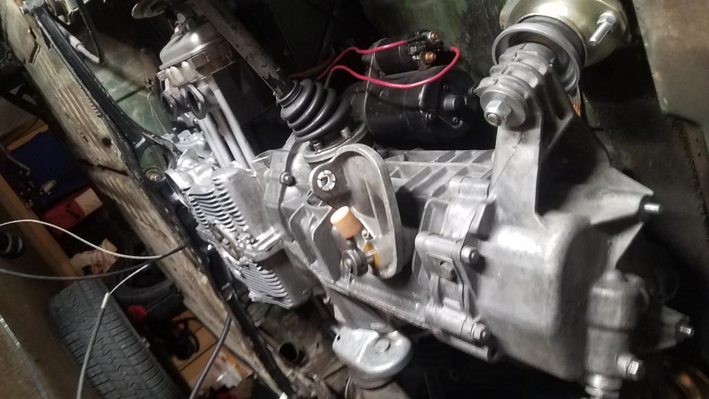

I am trying to replace all the old, worn out bushings from the shifter to the transmission but I can't find them on the 914rubber website. Does anyone have links for the bushings I need?
It is a 71 that has had a side shifter installed.
I got what turned out to be a dead end lead on another 914 for sale.
I did get a nice picture of my car out of the deal so it wasn't a total loss.

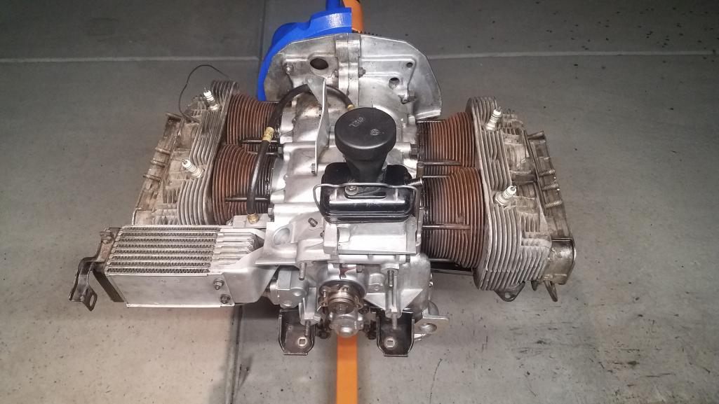

My son is out of school for at least two weeks and I have no work for two weeks so I guess we will get to some work on the car.

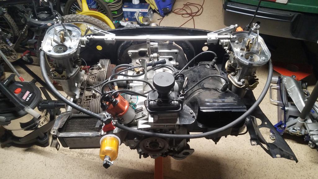

Pull the 1.7 with the messed up spark plug hole and install the 1.8 I got on the cheap from Patrick Motorsports.
SS fuel lines from Tangerine
New shifter bushings from 914Rubber and Tangerine
Clean up a bunch of wiring and misc items
Removed the engine lid and slotted the engine lid hinges. diconnected the throttle cable and the wires on the top of the engine.

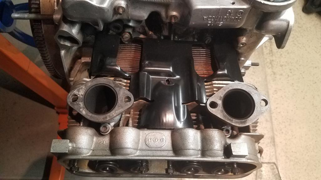

Found this for the fuel pump. How common a modification is this?
UUGGHHH,

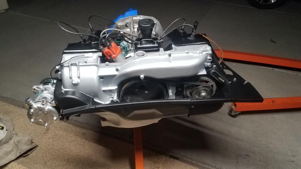

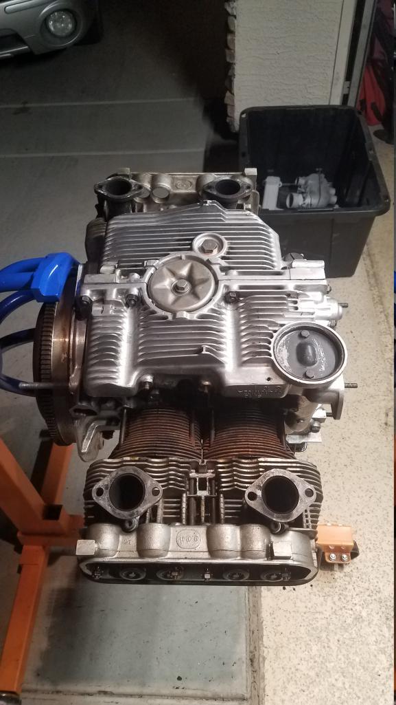

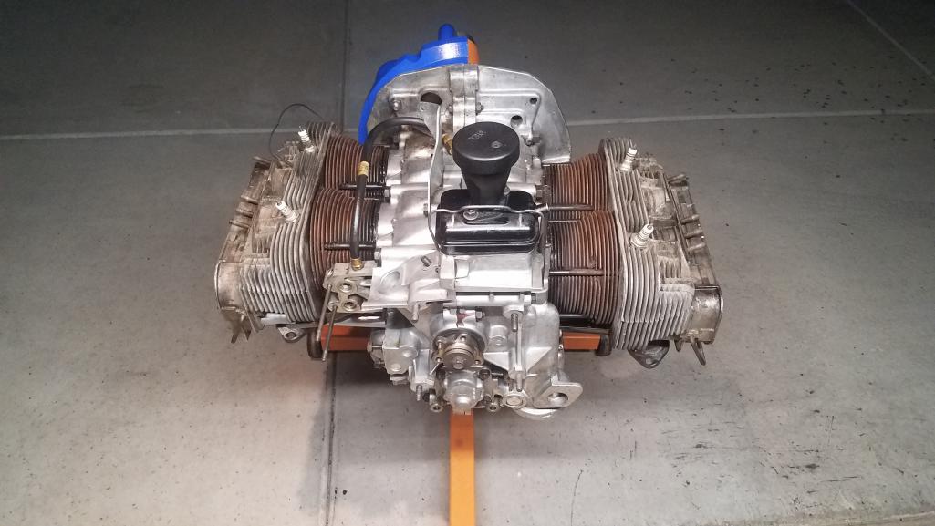

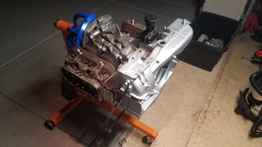

Cleaning up the replacement engine. 5 HOURS of scrubbing and scraping with degreaser.
Front main seal replacement tonight and start the install.
I plan to have it up and running by Friday evening.

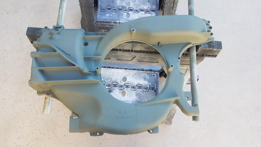

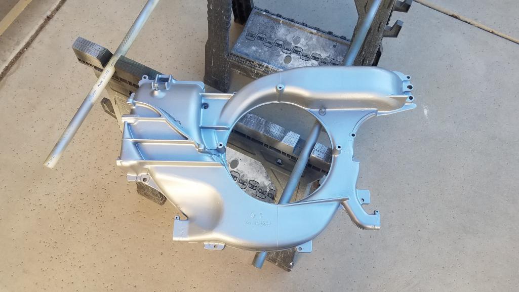

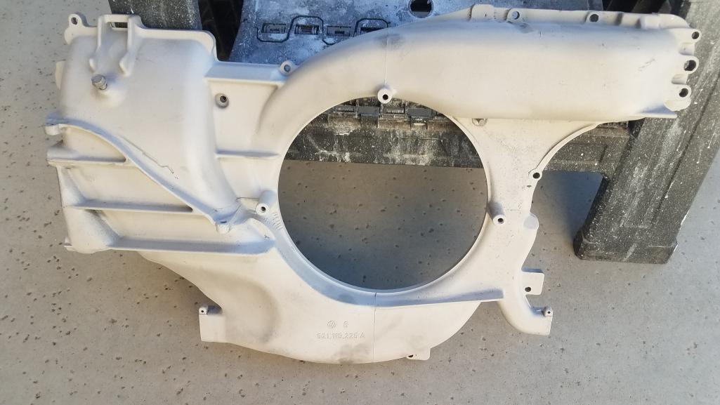

I got my HF media blast cabinet set up and spent some time cleaning up the fan housing. I am trying to decide if I should paint it or leave it raw aluminum.
What are the pros and cons of paint VS raw?
I did a clean up on my motor last year. Blasted the shroud and painted it a matte aluminum. The raw aluminum raw is porous and will trap dirt. I would put a finish on it to seal it.
Old Exhaust in the picture has been removed. I will be reusing the performance header system that was on the old 1.7 liter that just came out of the car. No heat exchangers but heat is the last thing we need in Arizona.
I also used stainless steel allen head bolts instead of the original cheese head screws on the shroud. Easier to install and remove if needed.

Our time at the Arizona emissions testing station was not as much fun. The car failed (again).
1.8 liter with dual Webers AFAIK it is stock other than the Webers. Stock cam, stock pistons, etc. It is at factory specs, idles at 900 and the timing is at 7.5.
The test report has the numbers from the previous test listed at the bottom. I'd like to think I can get it to pass with just an adjustment to the timing. Any suggestions on what I need to do to get it to pass?
I recommend you take it to a shop that has experience getting VW engines to pass emissions. Timing, idle speed, jets, accel pump setting, etc are all interrelated. Plus they know which stations have people that know how to drive the car to help it pass.
I ended up taking the car to Don Jackson and he got it to pass emissions and Nathan had some fun with it at college. He took his room mates out for some rides and drove it to the store occasionally.

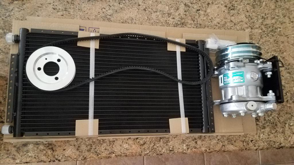

To go with fixing the oil leaks, we have been on a buying spree for AC parts(driving in Phoenix in the summer without AC is brutal).
We are building a custom AC system using an original under dash controller/evaporator unit with a new Sanden sd5h11 6333 compressor and a 11" X 21" parallel flow condenser mounted to the engine lid with dual high flow/low profile 10" fans.
The condenser is bigger that the factory condenser on my 1990 944 Cab.
I will be using R-134 and I am hoping the more efficient condenser design and larger size will offset the inefficiency of using R-134.
The biggest challenge was finding a mounting bracket for the compressor. I found a supplier out of Singapore that listed a top mount for a type 1 engine but no one had a mount bracket for a type four on any website I could find.
I've read somewhere here on 914world that Ed at gilmore-enterprises.net was building a 914 kit but when I checked his website, no dice.
The website did say to call if you have questions or want info about custom or future kits, etc so I called and Ed hooked me up with a mounting bracket and a pulley and all the mounting hardware.
There is a shop in Phoenix that specializes in rebuilding old AC lines and building custom AC lines.
I am debating the merits of having them make the lines vs buying a crimper and doing it myself.

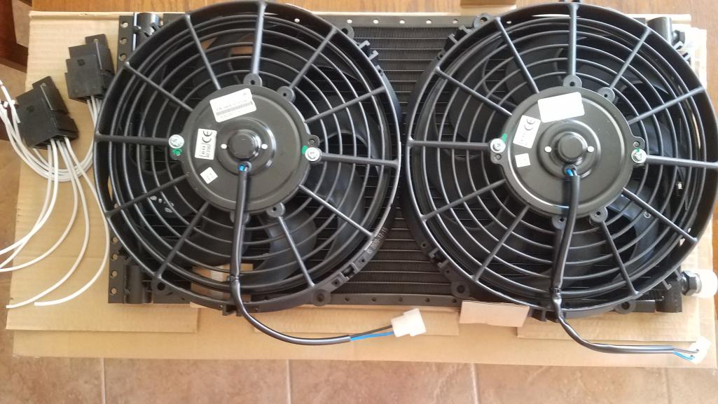

A am wondering if I need to create a shroud to block off the small area of the condenser that isn't covered by the fans.
The angle of the picture is deceptive. The fans hang off both ends by about 1/8 th of an inch. There is very little wasted fan space and uncovered condenser space.
This will be mounted to the underside of a GT style engine lid.
If I get creative I could set this up to pull air into the engine compartment or push air out. What is the normal airflow direction through the engine lid. I don't want to fight against the normal airflow.
Is it ok to use push rod tubes that have some small dings/dents from being removed?

Here's the engine after it came out of the car and had some parts removed.
914Werke powdercoated tins. The originals were so nasty and rusty, I didn't even try to save them.
I media blasted, cleaned, and painted the push pod tubes. What a PITA!!!!
Next time I'm just buying new ones. Halfway through the process with these I was tempted to scrap them but I am under a time crunch and don't have time to wait for a shipment. At least they look halfway decent.
I used the McMaster X shaped seals. I found that they worked best if I seated them and then pulled the tubes and seated them a second time. I used the sealant/gasket maker that Mark Henry recommended. if they leak, I'm going to Canada and kicking his butt. .
As usual, I spent twice as much time cleaning oil and crap of the various parts of the engine and refinishing things as I did taking it apart and putting it together.
It's true, just because you can't tell, doesn't mean it didn't happen.
Time to get off the computer and get this thing back together and back in the car.
In and ready to be buttoned up. I still had a lot of work to do on the AC system at this point but I was thrilled that it all fit with the AC compressor mounted. With the old York compressors, you had to cut out a section of the engine shelf.

Is there a good temporary fix for a broken clutch tube in the tunnel?
Sweet!
Based on the quality of the work I am seeing, one or more of the PO's of this car really liked to diversify when hiring companies to work on this car.
They apparently hired Barilla, Riscossa, and De Cecco, Inc. to handle a lot of the wiring.
They must have hired Sawyer, Krueger, and Voorhees, Inc. to create the access holes in the tunnel.
The holes in the tunnel are not very clean/neat but they do give me access to some parts of the tunnel.
My question is if I really need to have them closed up when I am done fixing the issues with the clutch tube.
The clutch tube at the firewall.
The cable housing is pulling into the tunnel every time I push in the clutch pedal.
Temporary fix. Leftover aluminum from the AC condenser mount project.
It keeps the clutch cable housing from pulling into the tunnel when I push in the clutch pedal.

I got the engine in and everything but the AC evaporator and wiring done in time to drop the car at Don Jackson Enterprises Tuesday moning. DJ tuned it to pass emissions and I picked it up early Wednesday afternoon(6/23/2021).
It was on the rollers at emissions testing when I noticed the fan was not turning. Not the AC fans but the fan that is attached to the crankshaft. The engine was running but the fan was not turning.
I first installed this engine months ago. I had replaced the front crank seal before that install but I did not properly tighten the bolt that holds the fan attachment to the crank. I tightened it but not to the correct spec. That allowed the fan attachment to shear the woodruff key.
I towed the car home from the emissions testing facility.
At 8pm Wednesday night, I started dropping the engine, pulling the fan, scavenging the woodruff key off the 1.7 liter that was originally in the car and then putting it all back together.
The clutch tube fix was part of the Wednesday night wrenchfest.
I got it all back together at 10 am.

I have started the disassembly.
This is my first time doing major work on a type 4.
Is it normal to have all the carbon and oil build-up where the heads and the cylinders meet?
From one degree of accumulation to another. Every old air cooled engine I have pulled apart has had some.
