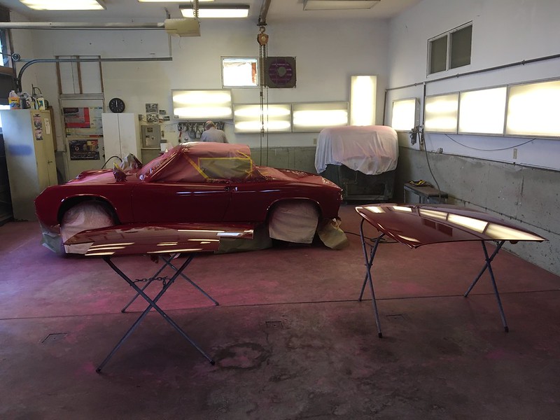

Thanks gents. I know I'm lousy at asking questions, but I'll try again. The question isn't about how the panels should lay for painting. I know they need to be the same as they will be on the car. That means trunk lids flat on stands and doors hanging vertically as they would be on the car.
The question is: how would you tackle spraying both sides of the lids given that clear coat MUST go on within 24 hours of the base coat?

For hoods and deck lids painted metallic I shoot the base and clear on one side at same time. I’ll do the bottom sides first then after 24 hrs flip them over and spray the top sides.

I just did the same with my 3 lids and 2 doors. Backside first. Takes forever!

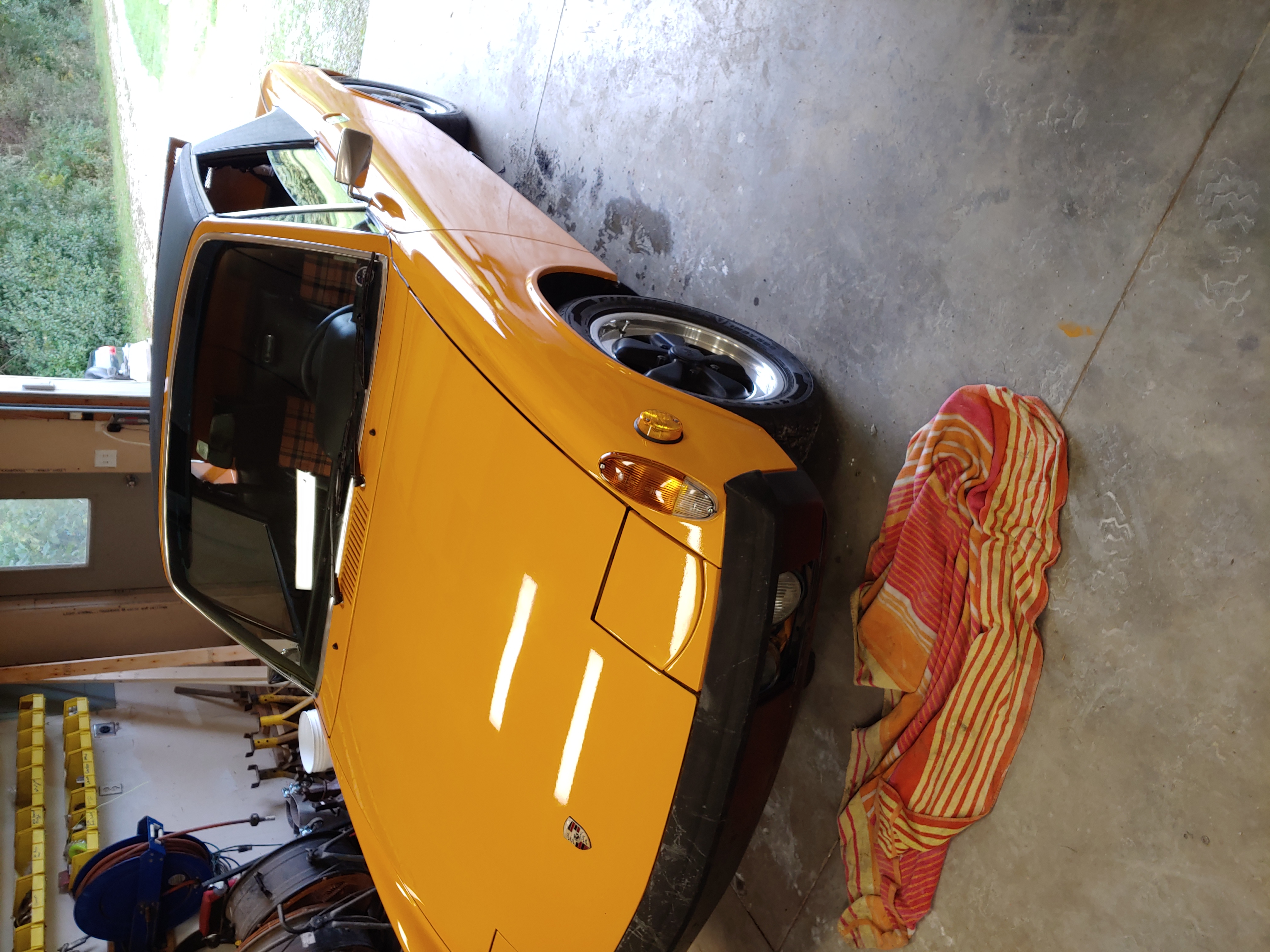

My concern is epoxy primer will gum up as it takes a while to fully cure which you don't have. The attached picture is a car I painted this summer with k36 wet sanded to 400 then epoxy as a sealer and right away base and clear.. Turned out niceAttached Image
Good point. I didn't think about that. I'll stick to the original plan of spraying epoxy as sealer over the K36 and just before base coat.
