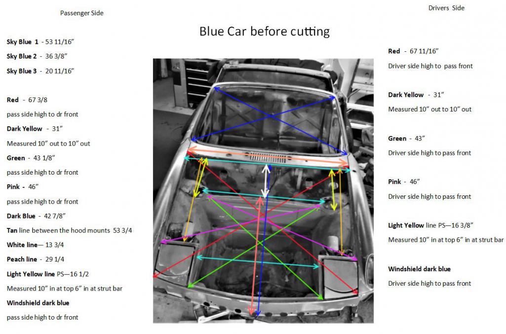

Here's a measurements teaser. You'll see I went overboard, this is just the top side.
When I get around to doing my trailing arms I should do this, the teenhulk needs the front A-arm pickups for his teen.
