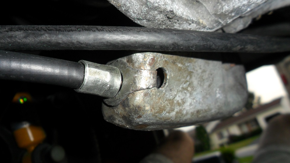

Short notice without digging.
914 World Shot.
Arrow points to the banjo stop plate. Mounts to cable tube. Then the leg gets bent
around the bearing bracket, then tip bent into hole on back side.
Hope it helps ...............
the back side of that is where the tail of the fastener curls around to then secure into the hole on the bracket

Or you could just do this....
You can also see it in my engine drop video
https://www.youtube.com/watch?v=FMesGrjgcvg
at 7:02
from my photo archive:
