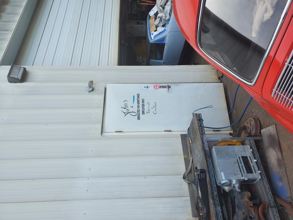

I walked in to the shop and the first thing I saw was my engine, still unfinished and untested. As I turned to see the car, my jaw hit the floor. Paint was bubbling on the deck lid, there were scratches from coarse sanding, and smudges and runs everywhere. I asked John how he could even set a delivery date when the two-month old paint had major issues and the engine wasn’t running. He didn’t really have an answer, but promised he would make things right. Here are just a couple of pics. Of course, I have video

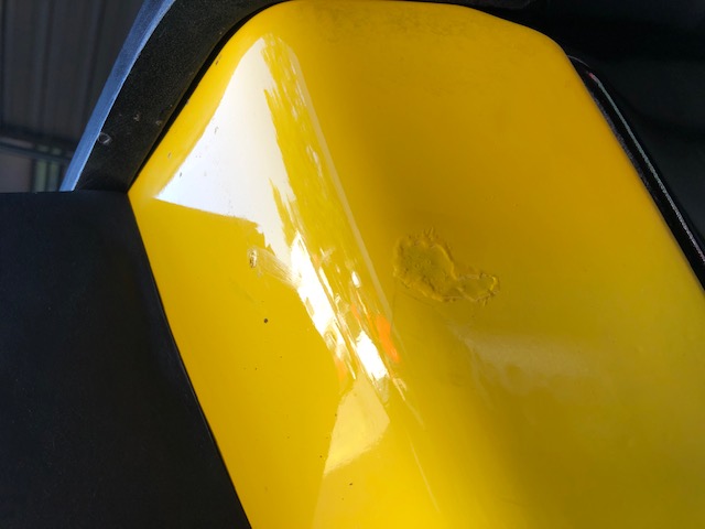

I sent the car off to my body and paint guy who literally shook his head when he saw it. I took inventory of all the parts and let John know which ones were missing (some LE-specific)…but it’s now May and I still haven’t heard back from him. I don’t expect to.

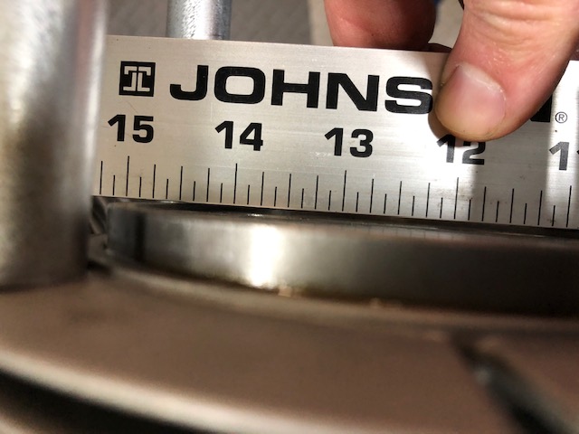

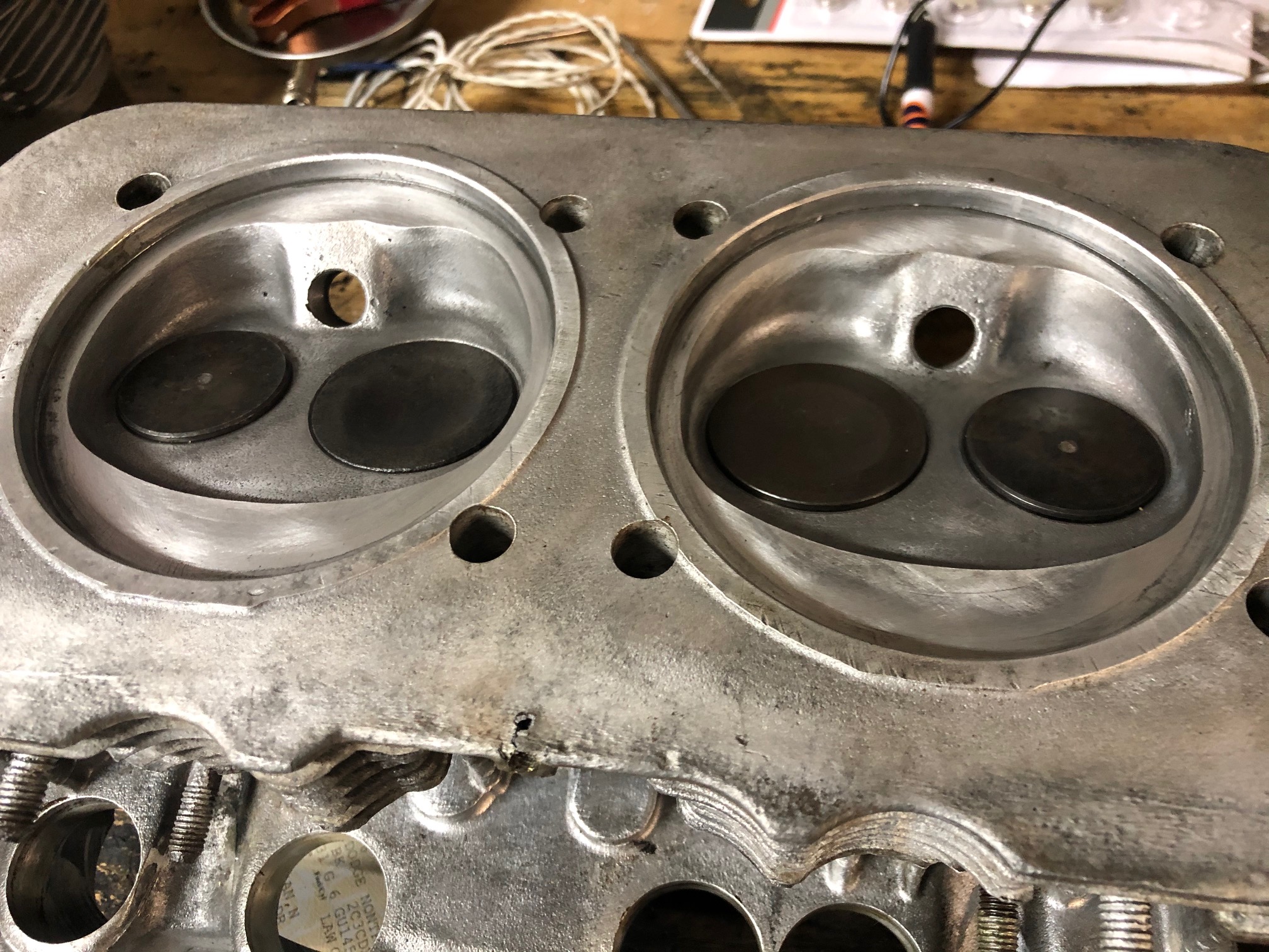

Given everything I’d experienced, I thought it would be a good idea to give the engine a closer look before I invested further time and money. I knew that John would be re-using some parts, provided they were in good shape, but I was pretty shocked at what I discovered….in order, and with some pics:
– The valve covers have gasket adhesive “webs” inside the cavities.
– The pushrod tube retaining wires are missing
– The 3-4 cylinders are not on an even plane, so no way the heads can seal.
– Head gaskets were installed
– The deck height is excessive and inconsistent (ranging from .080 to .100, not including the head gaskets.)
– The #4 register has dropped by about .020, causing the sealing issues and deck height variance.
– The cam shaft is worn.

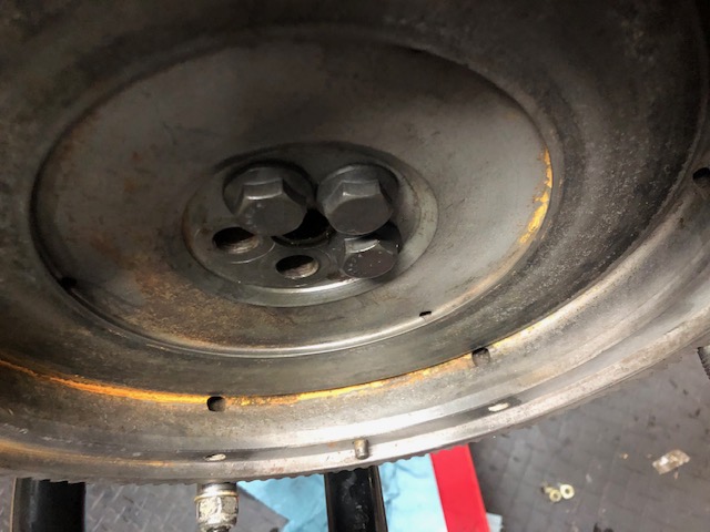

– No crush washer / felt ring was installed on the used, unturned flywheel. The brand new clutch and –pressure plate I sent were bolted up to this. Also the o-ring and bearing aren't fresh.

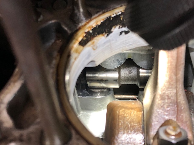

– The crank end play was basically zero. So tight that the shims are imprinted and concave.
– The MPS which came with the 2.0 engine is for a 1.7.
– Only about a quart of break in oil was in the engine.
As for the heads, it doesn't look like there are any cracks, but the valve job is poor. This pic shows the #4 intake valve sitting lower, which could indicate a bunch of issues and result in unequal combustion chamber volume.
