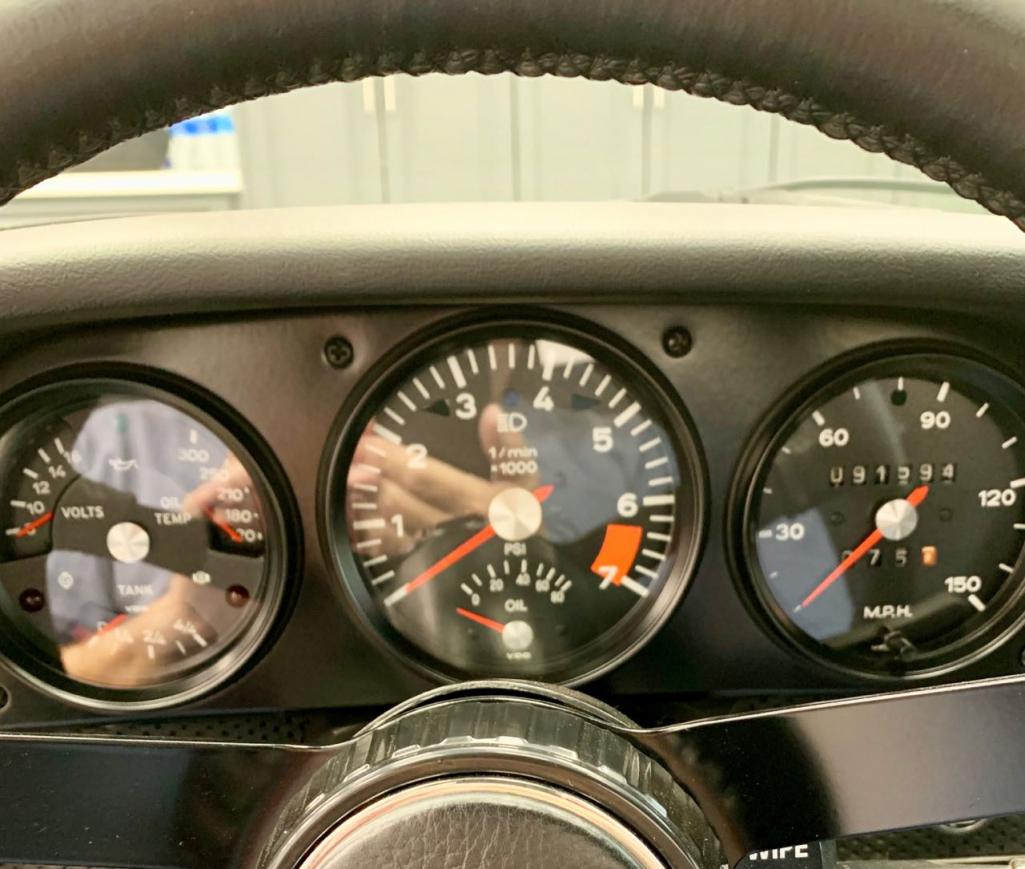

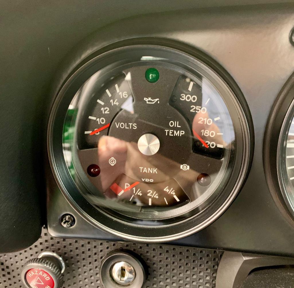

Here is what Hartmut at Palo Alto Speedo did for my car: I love them.

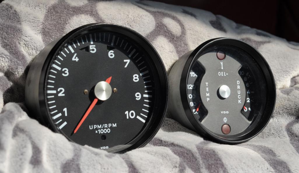

Another option: depending on how period correct you want to be on looks; I'll be putting this combo of refurbished gauges up for sale soon. Lettering, scales and looks as per original GT spec., with the 10K tach replaced with Bosch internals. Repainted bezels on both, tested and ready to rock.
Doesn't solve your fuel gauge or speedometer needs, but could be an option to consider.

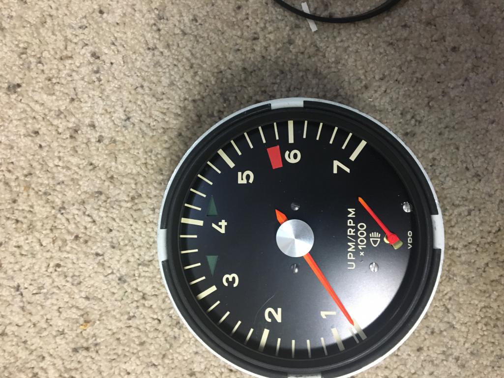

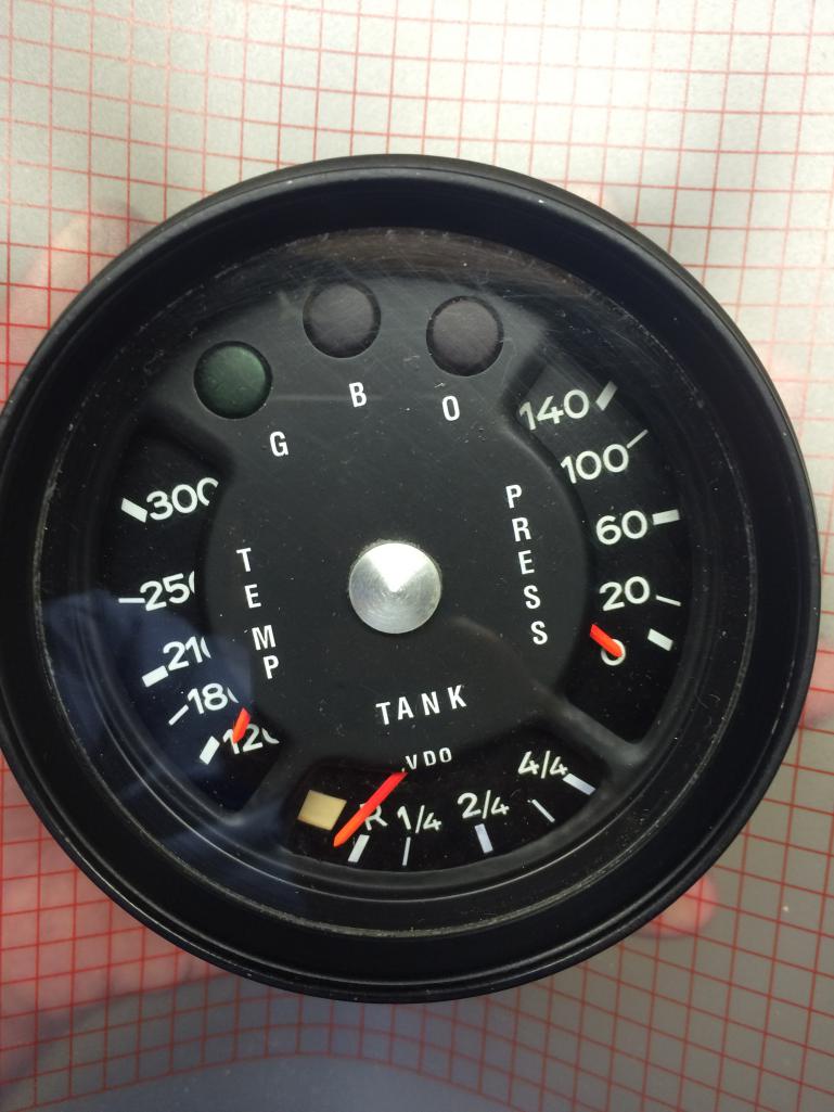

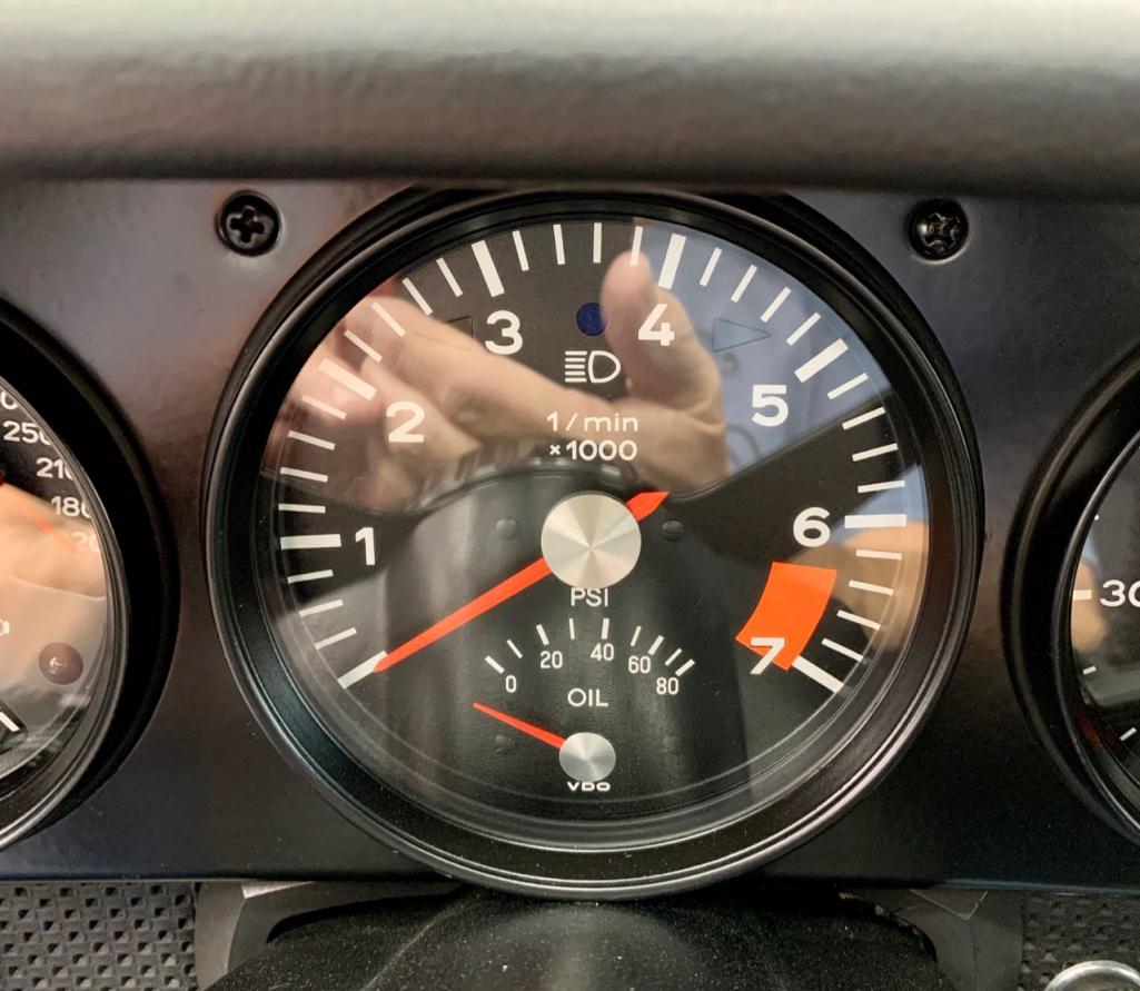

I used the stock 914 tach and fuel gauge guts. I had to trim part of the circuit board of the fuel gauge to get it to fit. I purchased some small 12V LEDs with the plan to put that in for the reserve light. Fuel gauge works in reverse with empty on the right. Need to move high beam indicator to top of gauge and re-label portion around fuel gauge.
john
@http://www.914world.com/bbs2/index.php?showuser=20392
John, very nice integration of the stock fuel gauge. Been wondering if this could be achieved by cutting the lower part of the tach with a similar opening as the stock fuel gauge, but I much prefer your cleaner approach. Any chance the movement could be reversed electronically? Also it would be nice to be able to get a small silver dot needle. Don't know if NHS sells them separately...
As for the high beam light, you could decide to use the one for the parking lights in the speedometer and replace the green gel for the blue one you got from your tach.
Cool mods
I am not sure it you could reverse it electronically. You would still need the spring to want the gauge to read zero on the other side. Could probably use a different movement and change the electronics to match the fuel sender.
john
