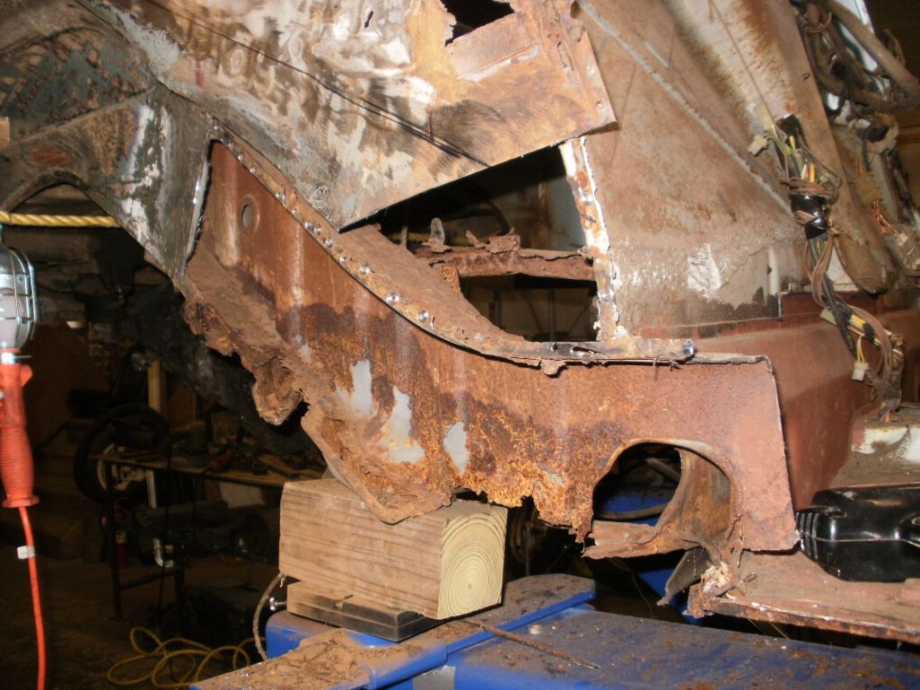

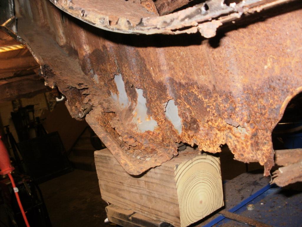

Got it, from what I can tell this one is a fair candidate. The frunt and rear trunks are decent, longs with front and rear connections are required as well as trailing arm mountings, ...... Yes, it's going to be an adventure

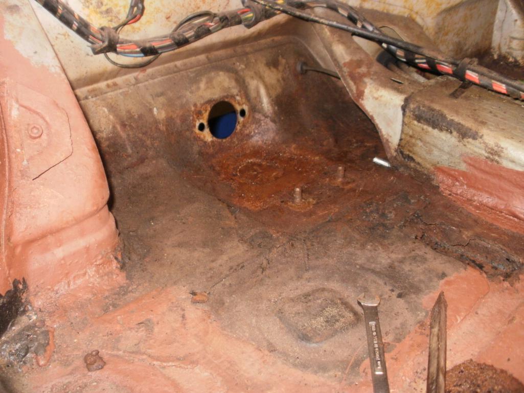

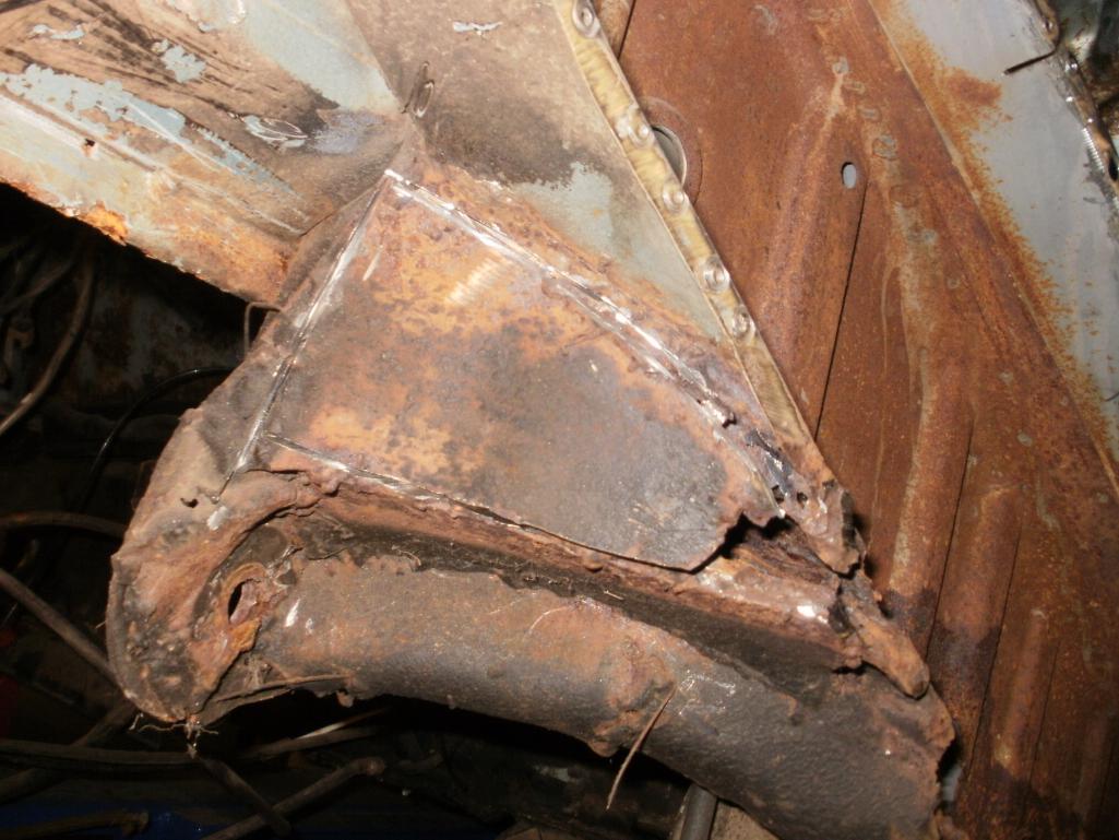

Is this whats known as the "hell hole", going to be a few hours in here
Posted by: Superhawk996 Nov 25 2020, 03:36 PM
Whoah! You got a project on your hands.
Posted by: mepstein Nov 25 2020, 03:40 PM
Sorry but that’s a parts car.
Posted by: bbrock Nov 25 2020, 03:54 PM
Looks a lot like mine did when I started my project.
Not a parts car but definitely a PROJECT car
Posted by: Superhawk996 Nov 25 2020, 04:10 PM

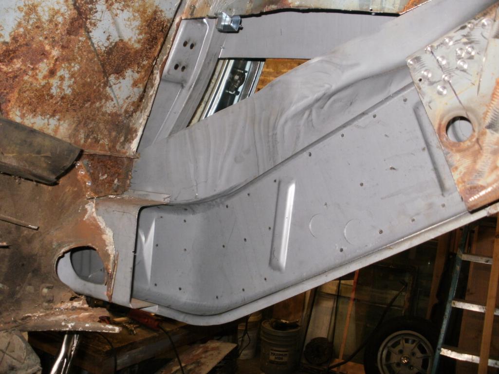

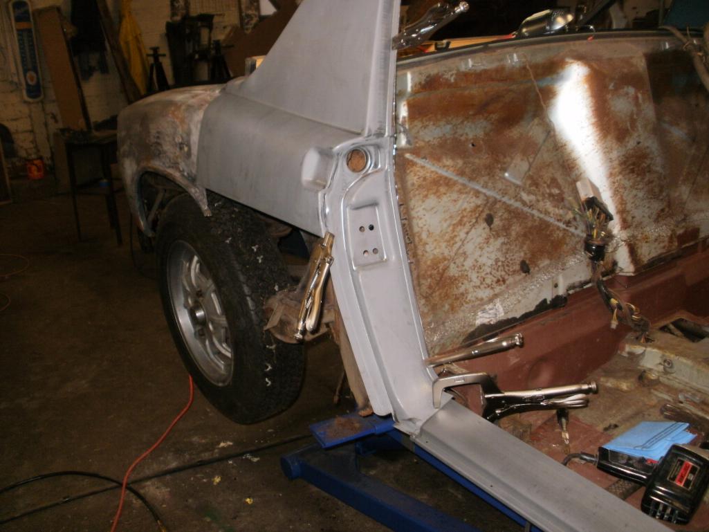

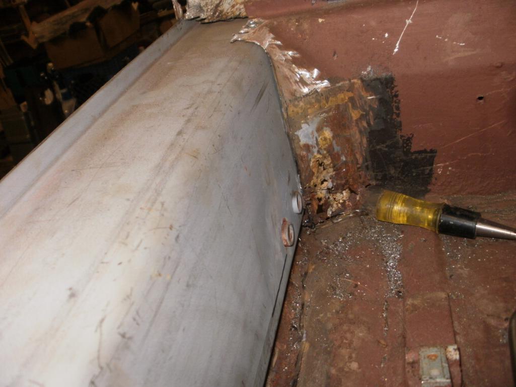

Posted by: 930cabman Dec 2 2020, 05:59 AM
QUOTE(930cabman @ Nov 30 2020, 01:14 PM)
Yep, I am in for the journey now.
It has been a few years since I have undertaken an ambitious project as such. My wife claims there is a pill ....

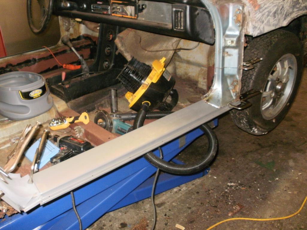

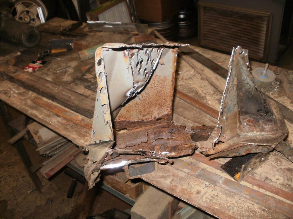

Had a few hours in the shop today
Posted by: Frankvw Dec 2 2020, 06:58 AM
wow, respect to you that you are so positive and optimistic about the project.
And the amount of time it will take.....and parts and money and blood, sweat, tears and excuses to buy new tools......
It will be an interesting post to follow to see how you progress.
At least you have a good lift so you are not down on your knees working away through the rust.
Good luck !!!!
Posted by: VaccaRabite Dec 2 2020, 07:57 AM
you need to brace the doors or you WILL twist the chassis while welding. There are lots of threads with that information in it. But for the most part people ar building stout rods with a turnbuckle in the middle you you can dial in the right amount of load to keep the car square.
Since these cars don't have a roof to add structure welding done along the longs will put a twist in the car. And you won't notice it until the very end when you are trying to re-hang the doors and the gaps refuse to line up, or worse the door refuses to close.
Zach

Posted by: 914_teener Dec 5 2020, 09:39 PM
Holy cow.
You should buy that tub from that guy in the UK...for $1,500.
Man...the entire long is kaput.
Posted by: 930cabman Dec 6 2020, 06:58 AM
QUOTE(914_teener @ Dec 5 2020, 10:39 PM)
Holy cow.
Why would I do such a thing, this is the fun part. Good thing we have RD at our disposal, it would be much more difficult without them

Love the attitude! I do have some concerns though. Your bracing is interesting, but I don't see any way to adjust. A big advantage of a diagonal brace with turnbuckle is it gives an easy way to adjust the chassis to keep the body measurements in factory spec. It's amazing how rubbery the chassis gets when the outer long is removed. I was able to dial my measurements in literally using only two fingers on the turnbuckle.
Also, as Mark pointed out, removing that inner long takes this to another level. There is no longer any structure maintaining the tub length. You can see in your pic that the floor is sagging which means the length has been shortened so you'll need some kind of fixture to make sure the dimensions are correct and the chassis is straight when the new structure is welded in. You may already have a plan for this and I'm not trying to be negative. Just trying to alert to possible pitfalls the way others have done for me on my build.
Oh, and your rust bucket definitely has mine beat in basket case status

Thanks to all for the (non structural) support. I have built my career on historic building restorations in Buffalo for many years, and all this stuff is the basically the same. Metal/wood/concrete/glass all behave somewhat different, but similar. My basic philosophy has been, "if it was built a hundred years ago, who says we can't build it today". That basically holds true, except the pyramids in Egypt, but thats a story for another day.
The last project I undertook was a 1985 Alfa spider with 12,000 miles and NO rust, great car, but got in the way of the hurricane Sandy flood surge. I removed seaweed from the rear view mirror, it was bad. It took a few years, but she is now alot of fun. Personally this stuff is therapy and I have fun with it. Prior to welding new structurals I will be checking and rechecking the body dimensions and door fits.
Thanks again to all, I will continue to post and am looking forward to running this beast around Buffalo next summer.

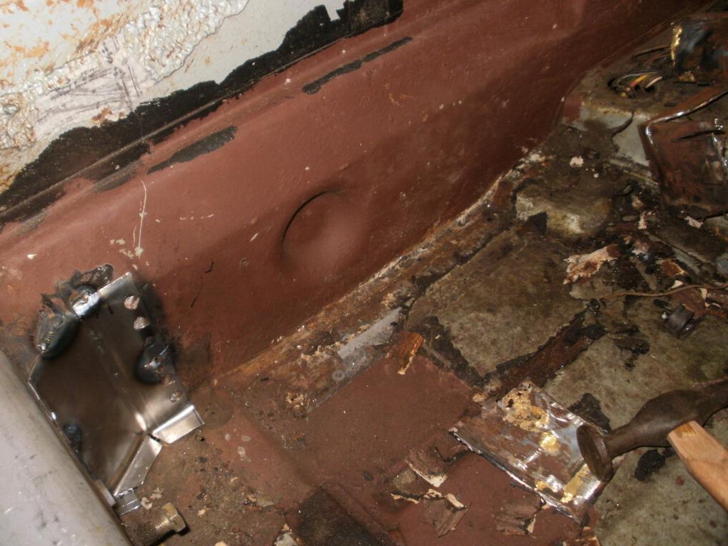

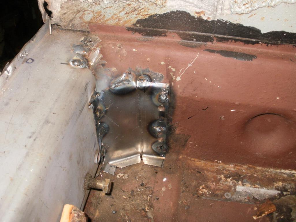

Had a couple hours today, cleaned up a prior "partial floor repair" completed with 16ga steel brazed in and sealed with gobs of tar. Getting the tub clean and ready for the new panels is a challenge. I am fabricating plywood patterns fit into the door openings that can be used in place of hanging the doors as rebuilding occurs.

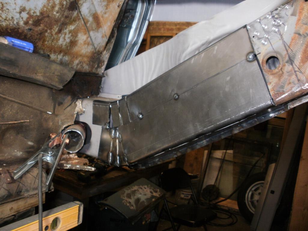

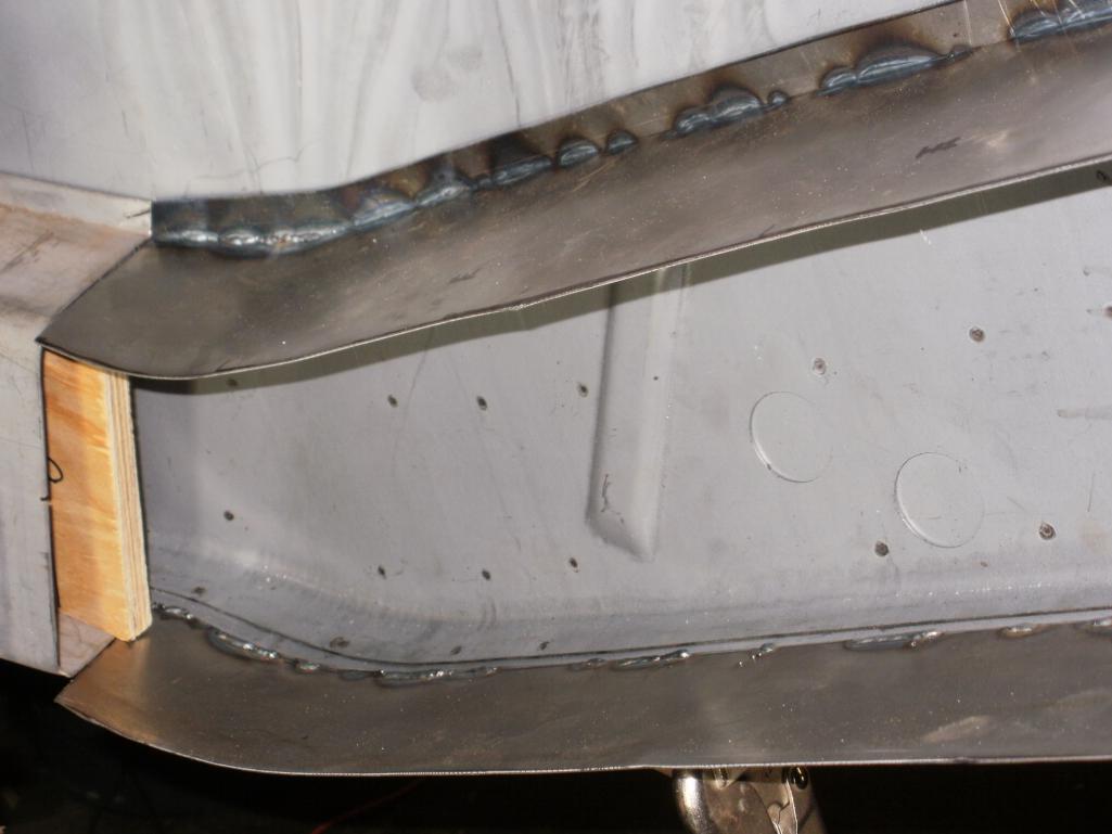

For my door brace, I found an "adjustable link" from Tractor Supply Co, cut it in half then welded it to a thick walled 1" square tubing.
The brace goes from the upper seatbelt bolt hole to a section of angle iron tacked into place on the inside of where the door hinges are, above the heater pipe. Not sure if it was the easiest/cheapest way to do it, but it allowed me to adjust the door gaps with the doors installed.
https://www.tractorsupply.com/tsc/search/adjustable%20link?

Posted by: 930cabman Dec 7 2020, 06:04 PM
QUOTE(draganc @ Dec 7 2020, 04:14 PM)
QUOTE(pencap914 @ Dec 7 2020, 01:00 PM)
What’s the deal with us 914 guys?!?!
I had the same view in my garage, 914, e class wagon and........black Cannondale bike.
Is that a "homemade" inner longitudinal? what gauge
Posted by: VaccaRabite Dec 7 2020, 06:10 PM
QUOTE(930cabman @ Dec 7 2020, 07:04 PM)
There are clamshells available and long stiffening kits as well.
Once you fix the longs, of your plan is to race the car or add a significant amount of power, consider adding in inner longitudinal reinforcing kit. (I think Mad Dog sells it, maybe others these days.)
Zach

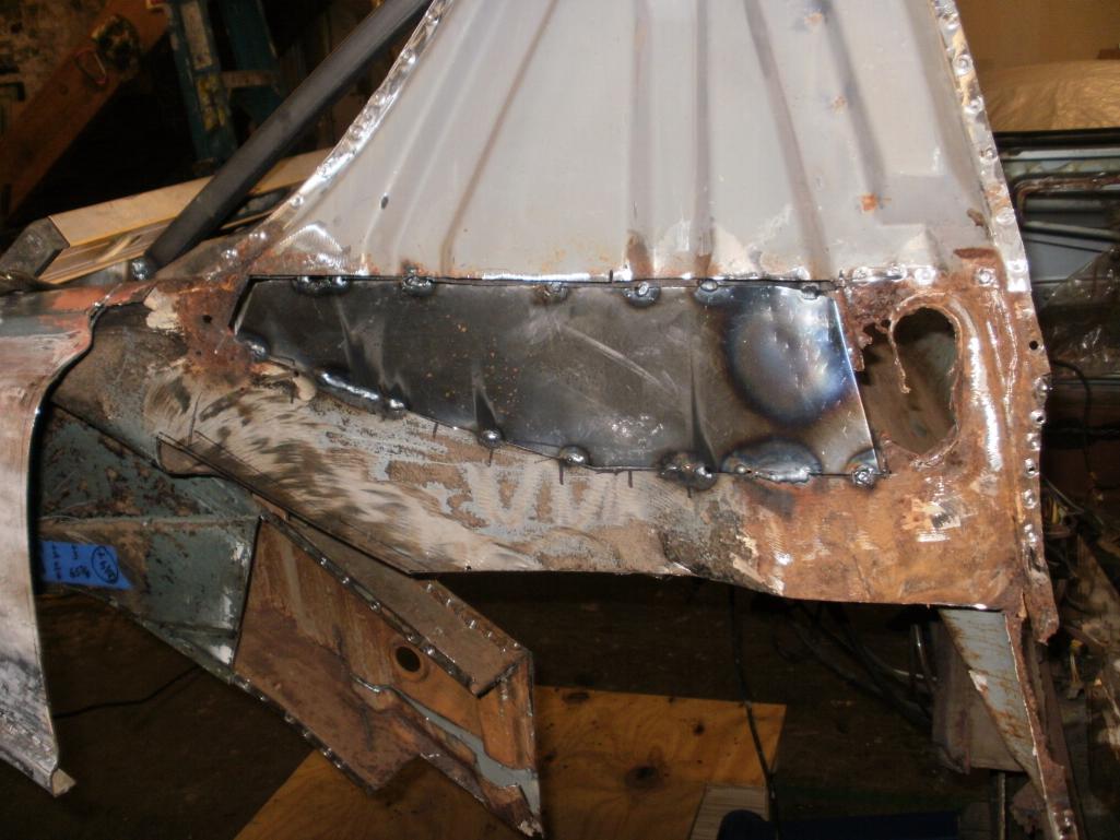

I'm overdue for an update. The driver's side long is ready to be buttoned up - the outer layers are assembled, fitted, painted, drilled for rosettes and ready to weld on. I have a heater tube on the way, as soon as it gets here, I will pop it in and button it up. I'll put some more pics up to get up-to-date... Honestly, I'm looking at a couple more years to get it on the road. Family, work, etc, you know the story. Dying to drive it, but having a blast with the metal work.

Your metal work looks great, life has a way of doing that often and if you have a wife and or kids spend the time with them. The 914 won't go anywhere

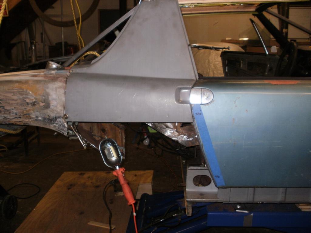

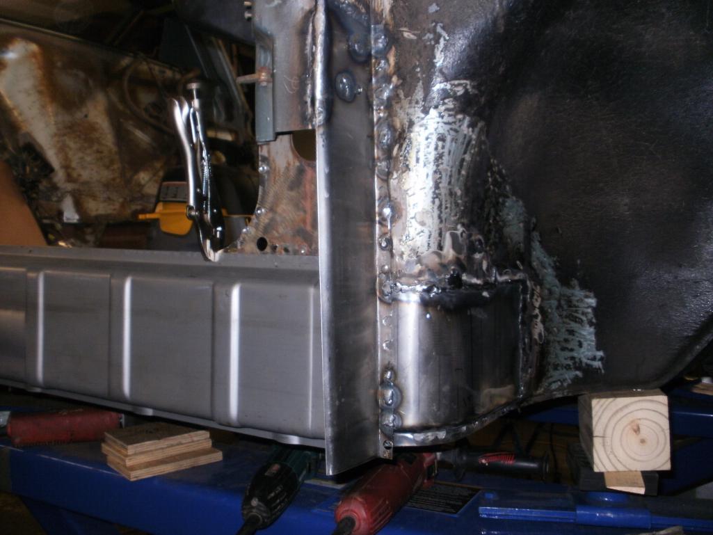

Test fit a few new panels from RD, we have quite a bit of structural work prior to these, but was looking for a little light at the end of the tunnel. I will be opening up the "rear box section" this weekend.
Posted by: Superhawk996 Dec 14 2020, 07:17 AM
Great work so far.
Indeed . . . . you are an optimist.
Posted by: bbrock Dec 14 2020, 08:56 AM
Did you drag that car out of a salt marsh? Wow! You are in Jeff Hail territory here.
Posted by: 930cabman Dec 14 2020, 10:14 AM
QUOTE(bbrock @ Dec 14 2020, 09:56 AM)
Not exactly, but there was no $$ exchange if that's any consolation! I am scratching my head with a few sections in need of replacement. But that makes the victory that much better.
Funny, I have read several rustoration threads and seen many rusted areas that appear difficult to form. Each car seems to rust in different places and to different degrees.
Thanks for the support, I read through your journey, great story
Posted by: 930cabman Dec 17 2020, 02:29 PM

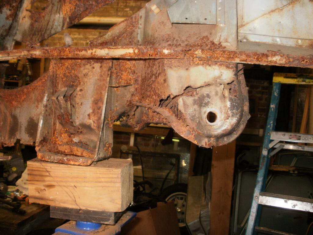

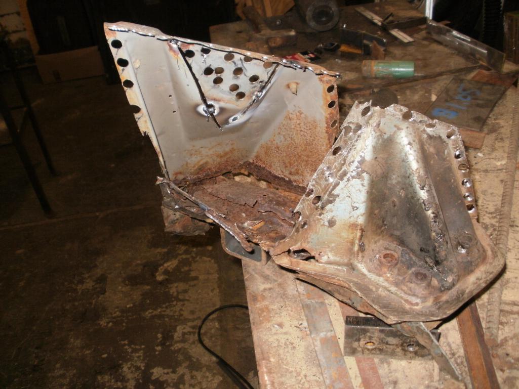

Getting into the real meat now:
Anybody have an extra?
Posted by: 930cabman Dec 18 2020, 04:43 PM
QUOTE(930cabman @ Dec 17 2020, 03:29 PM)

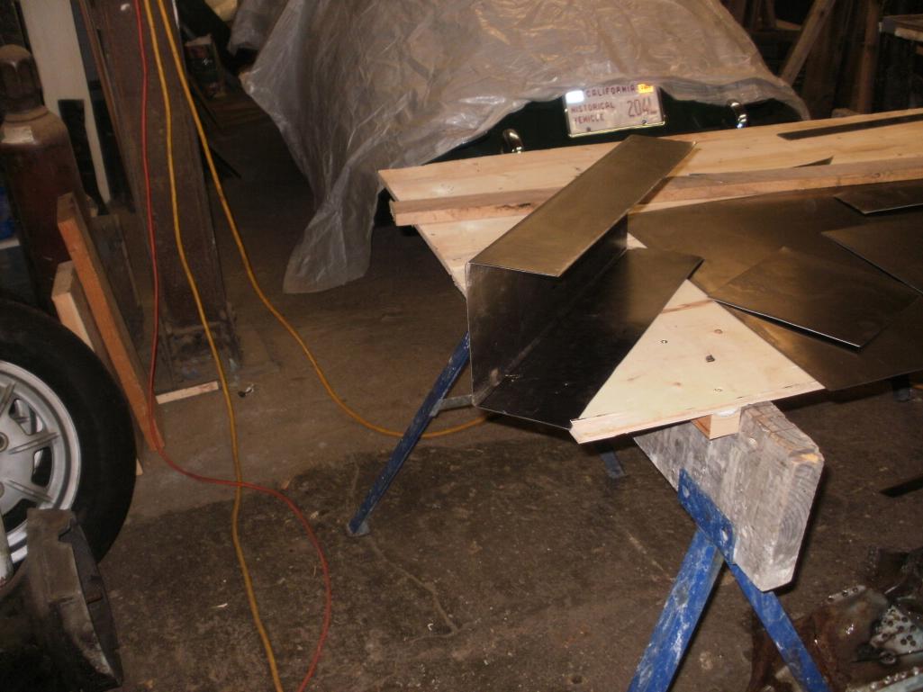

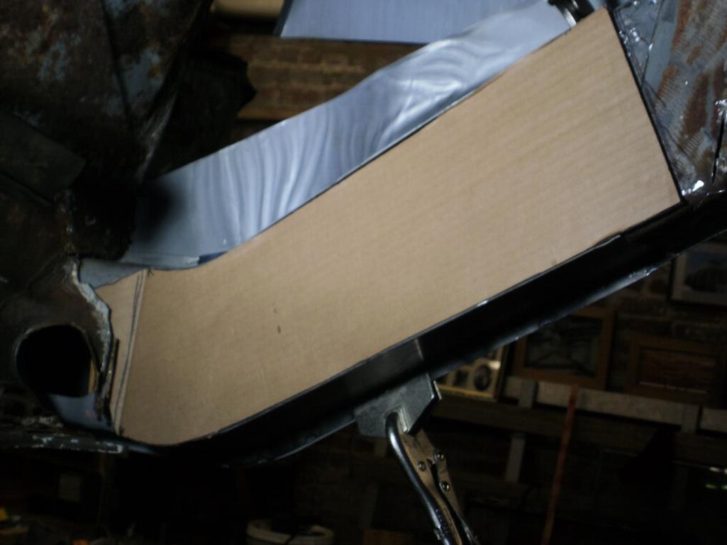

Going to start forming new metal this weekend. We do not have the Celette Bench, but from what I can tell it (simply) gets the chassis in alignment. If that's the case my dad has an awesome set of tools. Does that ring a bell? We are working off a HF scissors lift and have the capability to align the suspension/body points. Stay tuned
The shop where I used to work does their larger rustorations on Celettes. Its easer to keep all 3 dimensions true while work it done.

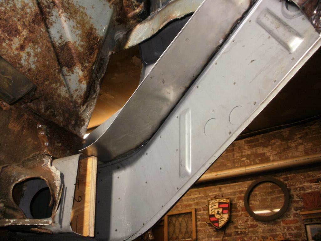

Posted by: 930cabman Dec 19 2020, 02:52 PM
A few hours in the shop today
Prepping for a new engine side "U"channel, directly under the battery. Thinking of relocating into the trunk or under the passenger floor boar
d
Posted by: EdwardBlume Dec 20 2020, 07:56 AM
Nice work!
I love fearless people. You rock dude!

Posted by: 930cabman Jan 7 2021, 11:10 AM
Getting closer to having the passenger side complete
I have been lucky to be able to sneak away from the office for an hour or so
Next up is completing the additional structural (double layer) to the engine side
Being careful to stagger the splices and fit everything reasonably tight. 18ga across the board
Posted by: 930cabman Jan 10 2021, 09:30 AM
Double layer to the inner half (engine side) of the long extensions
Time and patience
Checking, re measuring, re checking, got things within a 2mm. From what I gather from the factory book 2mm is the number
Posted by: 930cabman Jan 10 2021, 12:18 PM
Inner section all welded and primed
Got the double long section wrapped up, plug weld the outer and move on
Cover fit, ready for plug welds/primer and on to the next project

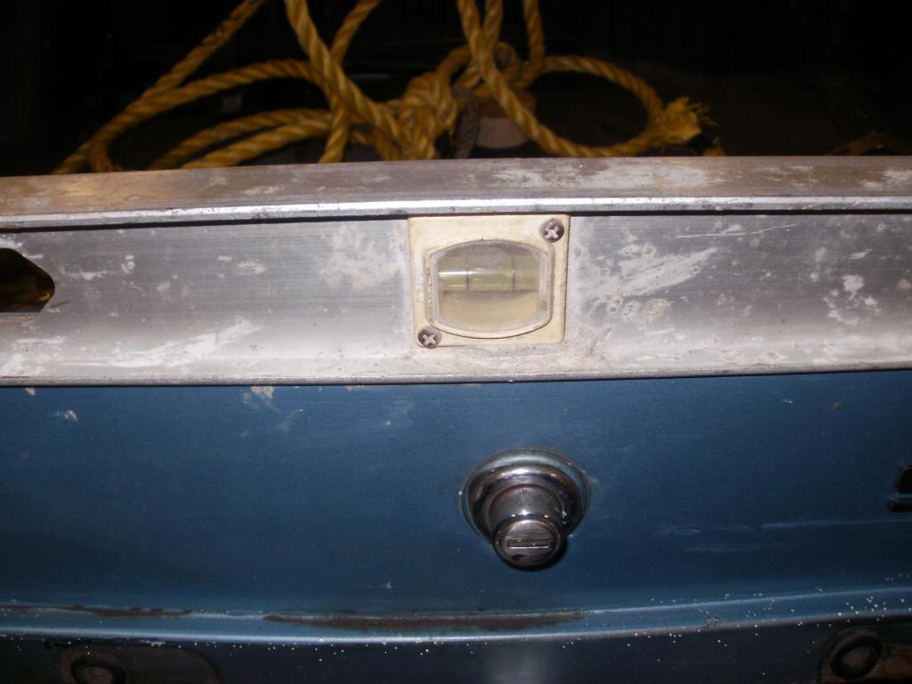

Posted by: 930cabman Jan 14 2021, 12:24 PM
Passenger long just about complete
Fitting the new RD door jamb and having the passenger door latch for the first time in 30 years, VICTORY
No photo yet, but I was able to test fit the targa roof panel, fits great. Also, I made a template fitting the windscreen frame and targa bar. Checked it from side to side, all is good. I used cardboard then 3/8" AC plywood. from what I can tell, this double checks several body dimensions/geometry

Posted by: 930cabman Feb 1 2021, 01:23 PM
And I was thinking the drivers side was in better shape, fooled again!!
From what I can tell, these trailing arm mountings are not being reproduced, if so please forward the contact information. Otherwise we are re creating from scratch
Not for the faint of heart, but none of this is
Posted by: 914_teener Feb 1 2021, 01:40 PM
Curious....no rust encapsulator for the internal parts or primer for the inside structural peices?
I think RD makes that peice but sometimes they are out and need to build inventory.
That as you probably know is one of the more important suspension tie in locations.
Posted by: 930cabman Feb 5 2021, 02:09 PM
I was hoping the drivers side would be not as bad, fooled again
The Mad Dog 16 ga. frame reinforcing kit is on the way to add some integrity to the structure. This 914 is for my own use with a 2.7 conversion and 185 tires. Will never see a track while in my possession.
I have been spraying the insides prior to closing things up. Rustoleum rattle can
