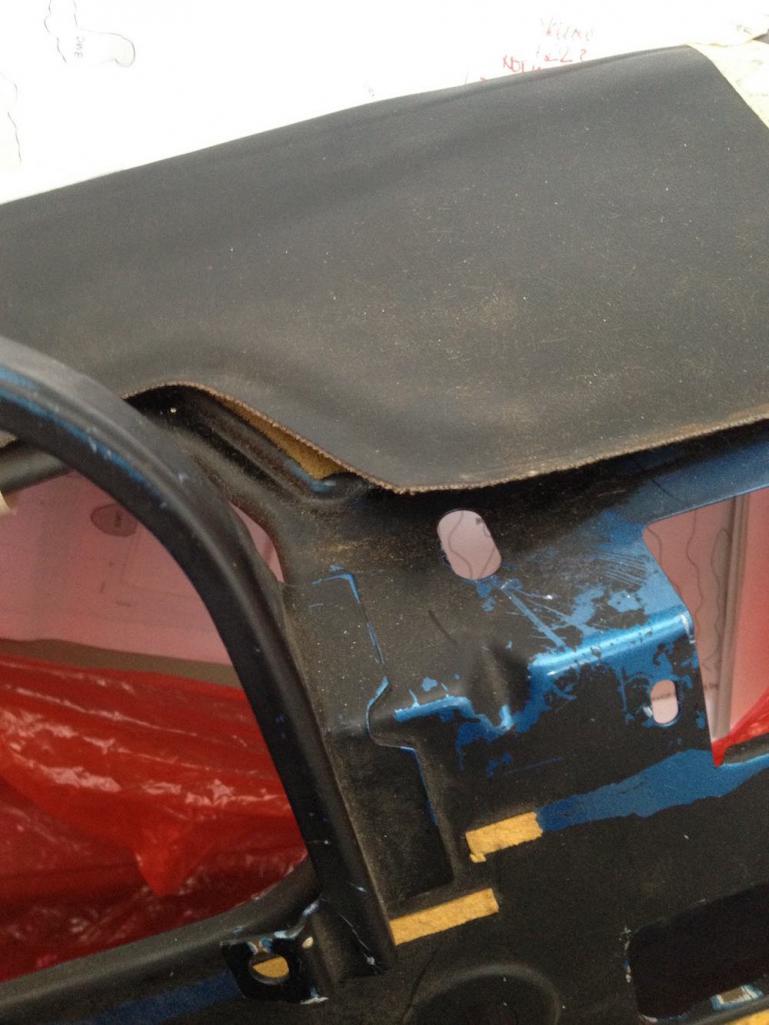

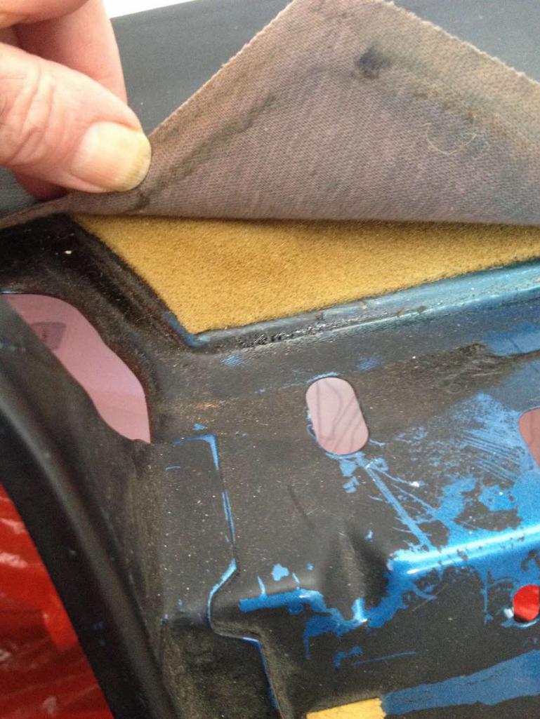

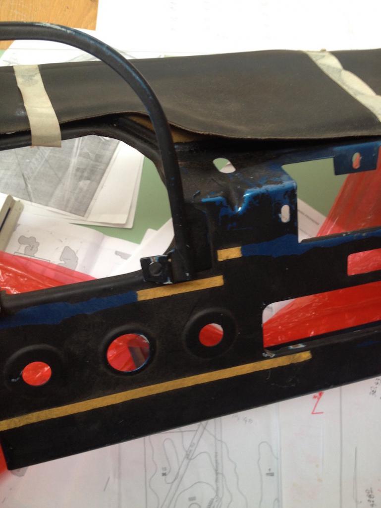

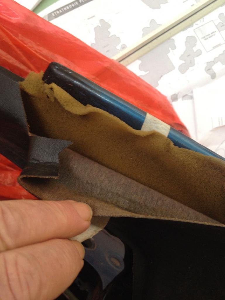

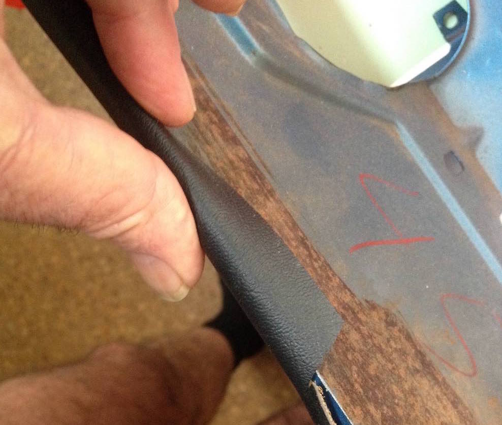

to help, i pulled out my old lhd dash took some photos.
mostly as per bkrantz guidance.
glue holding vinyl down on mine has long since aged and failed. but the vinyl retains its shapes and glue traces are still visible on the metal dash structure. foam is still mostly glued down. the vinyl was not glued to the foam. no trace or evidence of that anywhere.
foam is trimmed to the top of the step in the metal dash on the inner edge.
not a great deal of evidence of glue that would have held the vinyl down along its edge on metal below the step or on back of vinyl. but underside of vinyl shows it might have been. could have been just a few dabs along the edge if any.
along front edge (windscreen), vinyl was wrapped around edge of the metal and glued to the underside. looks like the person who made it used a 4 inch wide paint brush and just ran it along the underside of the dash! interestingly the vinyl was trimmed in the centre section and did not wrap under (see last photo). the wrapping and glueing under was from the left and right hand sides around the vents and in towards the centre a little further. don't know why that centre section was trimmed to edge and not folded under.
think the way they put it on might have been to glue the vinyl down along the inner edge where it was going under dashtop or perhaps even restrained it with dash top that was fixed on (could be wrong but i wonder if dash went in to car with top already fixed on during production). with the inner edge fixed or restrained you could stretch it towards front edge of dash and work your way along edge glueing and trimming and snipping in the right places. does that make sense. in other words i think the factory did it maybe differently to how most restorers would in terms of the steps. ie top might have been glued around front edge after dash top was fixed on. its a thought.
