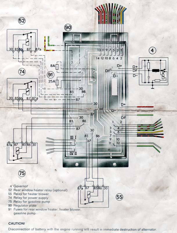

Going back to point #1, you don't have to test all continuity across the whole board, just those traces that handle the fuel pump, the ignition coil, the tachometer (which is also connected to the coil), and the ECU feeds (if fuel injected),

There's "Fuel Pump Circuit Troubleshooting Flow Charts" and "Fuel Pump Circuit Troubleshooting D-Jet only". Each is a pdf. Maybe these can give some suggestions as to a path for finding where the problem lies.

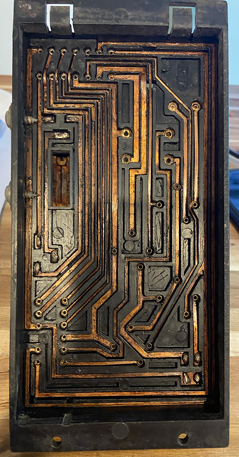

Here you go un-potted board. This is posted as mirror image of SirAndys that is looking from top of board down “thru” the board. This is the physical view from under the board looking up.
Note DAPO screws that are too long crossing trace connecting it to the voltage regulator housing

A relay board has no electronics. It is a buss bar to relay and connector pins distributor. If it is intermittent than one or more of these connections is failing. The staking is very good and normally shouldn't fail but if the board is intermittent then the connection IS failing. Locating the connection and soldering it is the best solution. One problem using a DMM is the fact that the meter uses very small current. It can measure zero ohms and the connection can still be bad under load. What is needed is a higher current setup for "Ringing out" the connections. If your card is measured with a DMM as ok but you know there is a problem remaining in the board then one way to ring out the board is by using a voltage source and a light bulb. A light bulb using some power would be best. Maybe a headlight could be used. You need something with at least a couple of amps for testing.

I assume the riveted/buss bar connection fails from time to time. Either this connection, the female sockets or a break in the copper buss bar can be the only potential failure
