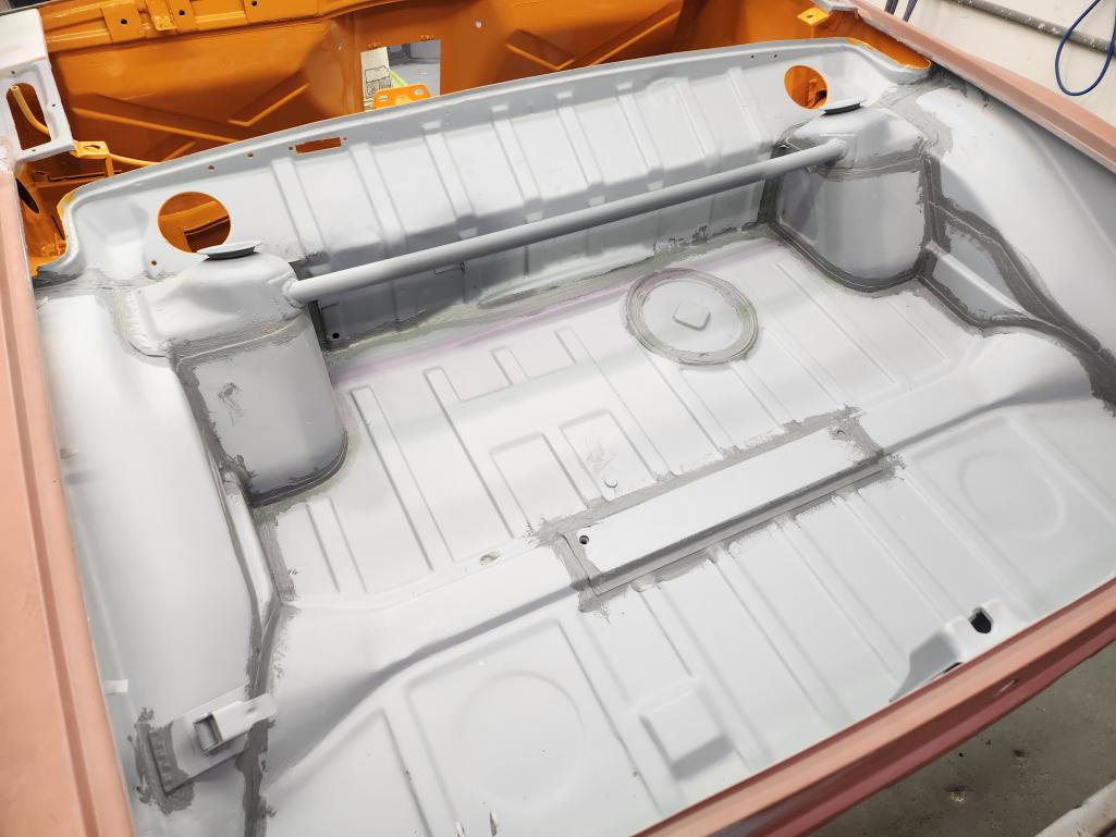

Pans looked decent before stripping, but were perforated all the way around. sad.gif Restoration Design to the rescue. smile.gif
Posted by: Bullethead Apr 1 2022, 10:58 AM
Same with the trunk floor... and it along with the taillight panel had apparently already been replaced at some point, the number was missing.

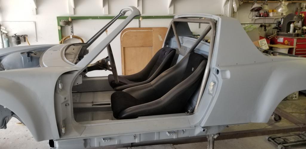

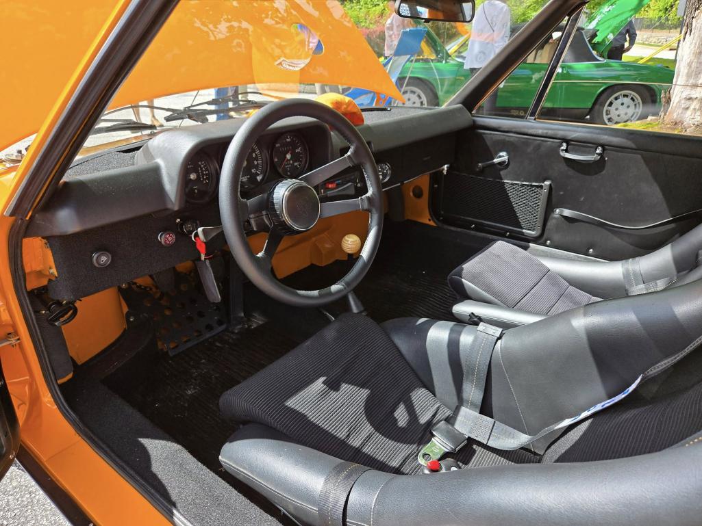

Cockpit floor completed, seat perches for the Scheels and handbrake relocation up soon.

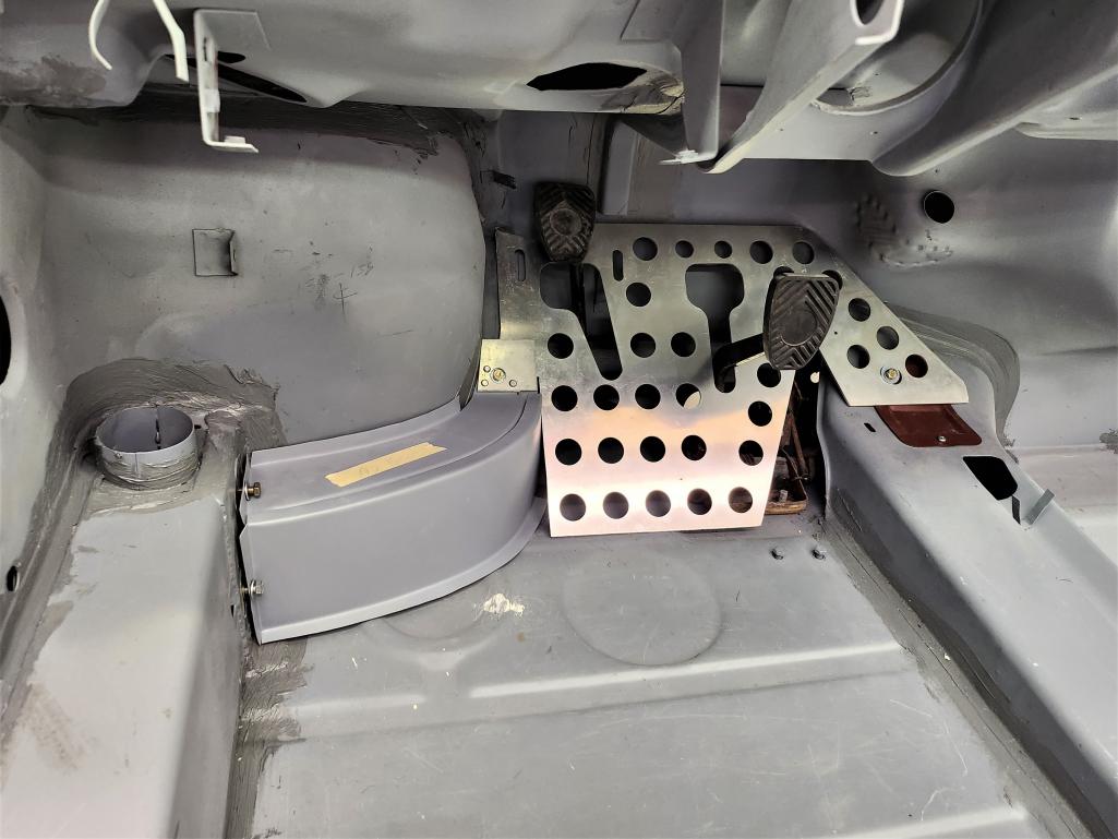

The shop's fabrication skills are exceptional... asked for a simple cover similar to factory GT's and they produced this Satanic detail:

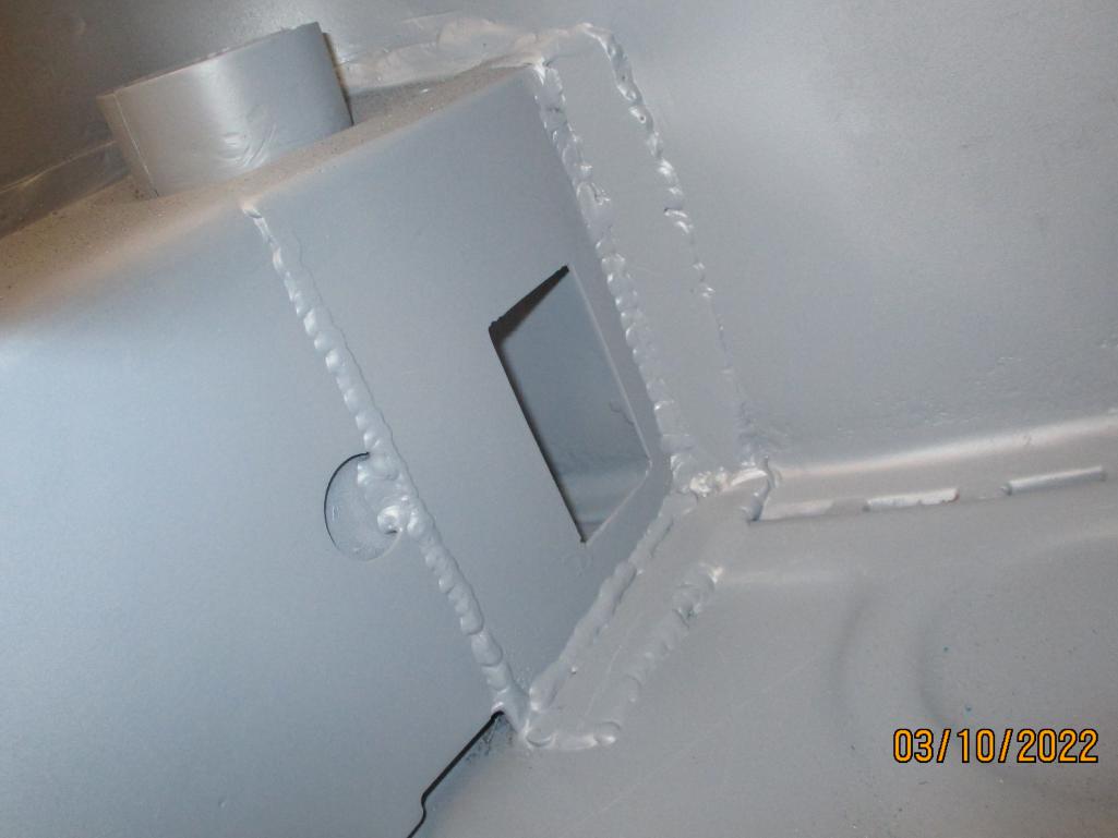

Engine mount and suspension reinforcements...

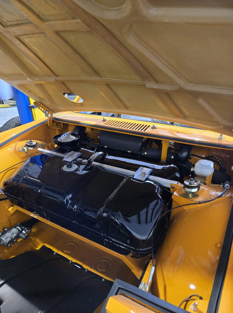

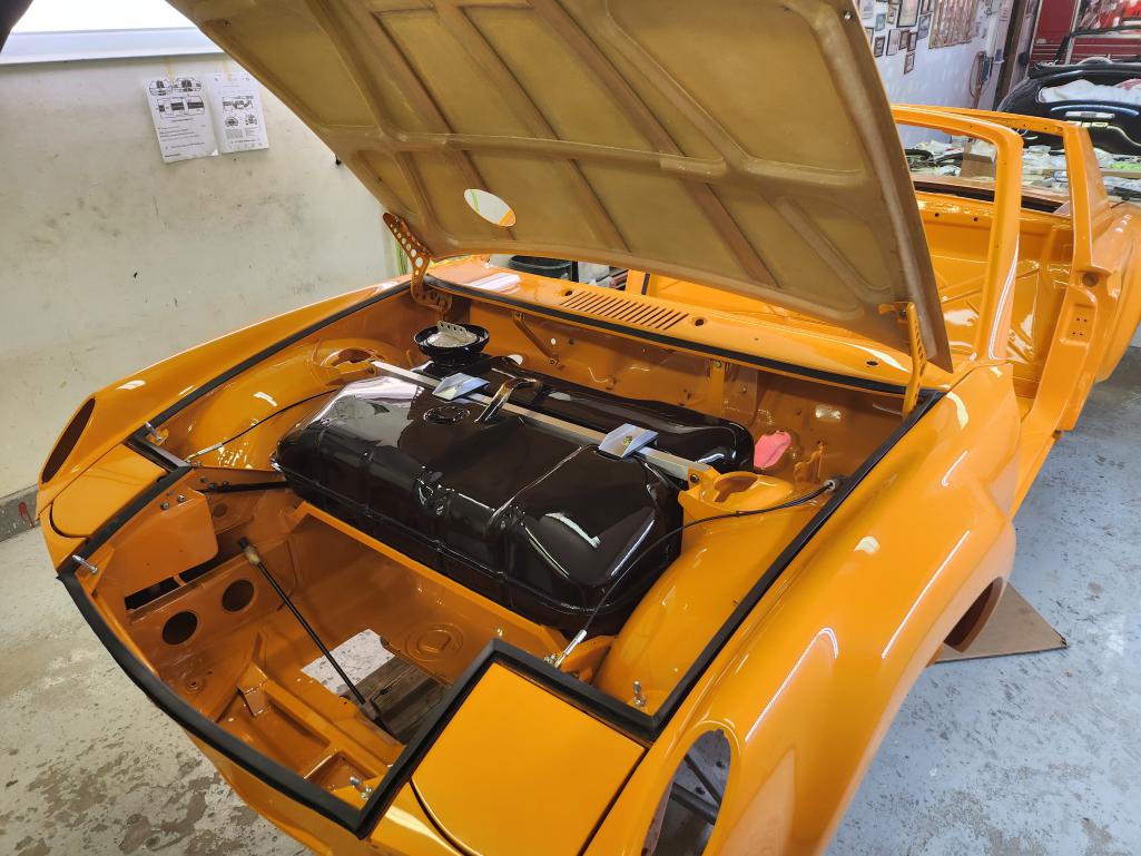

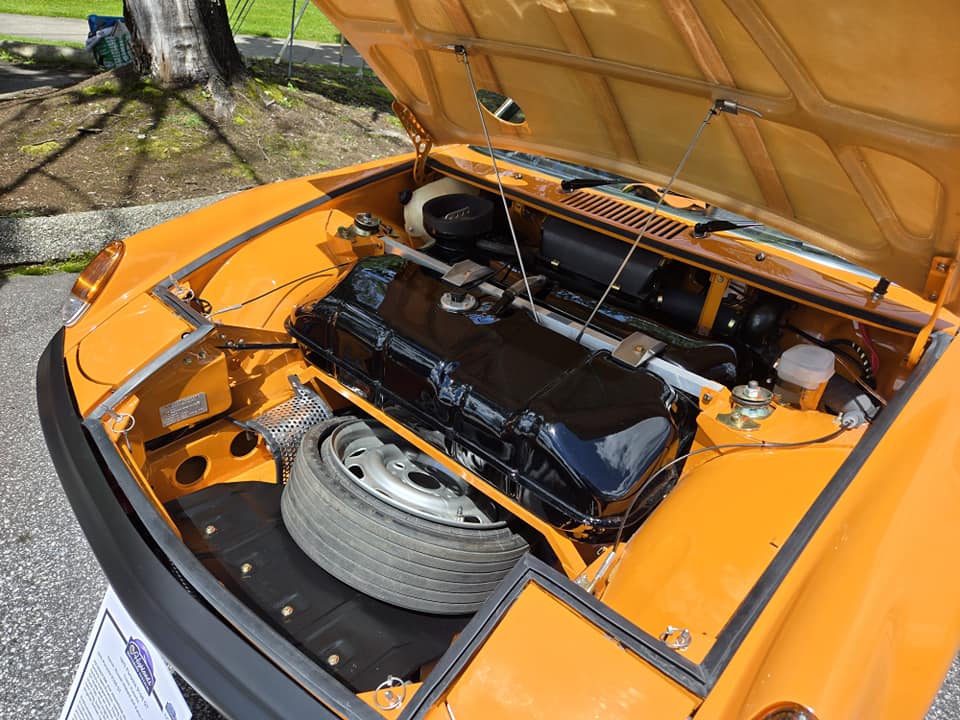

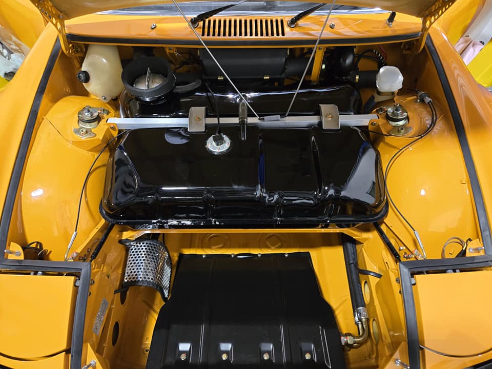

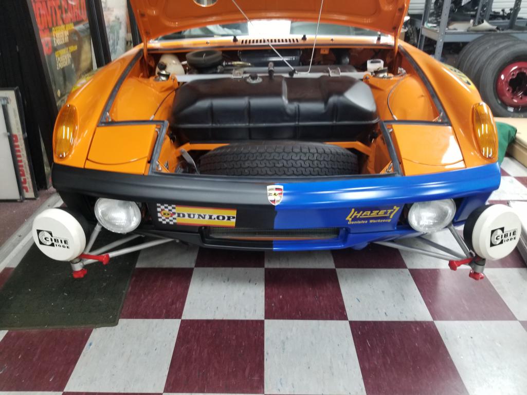

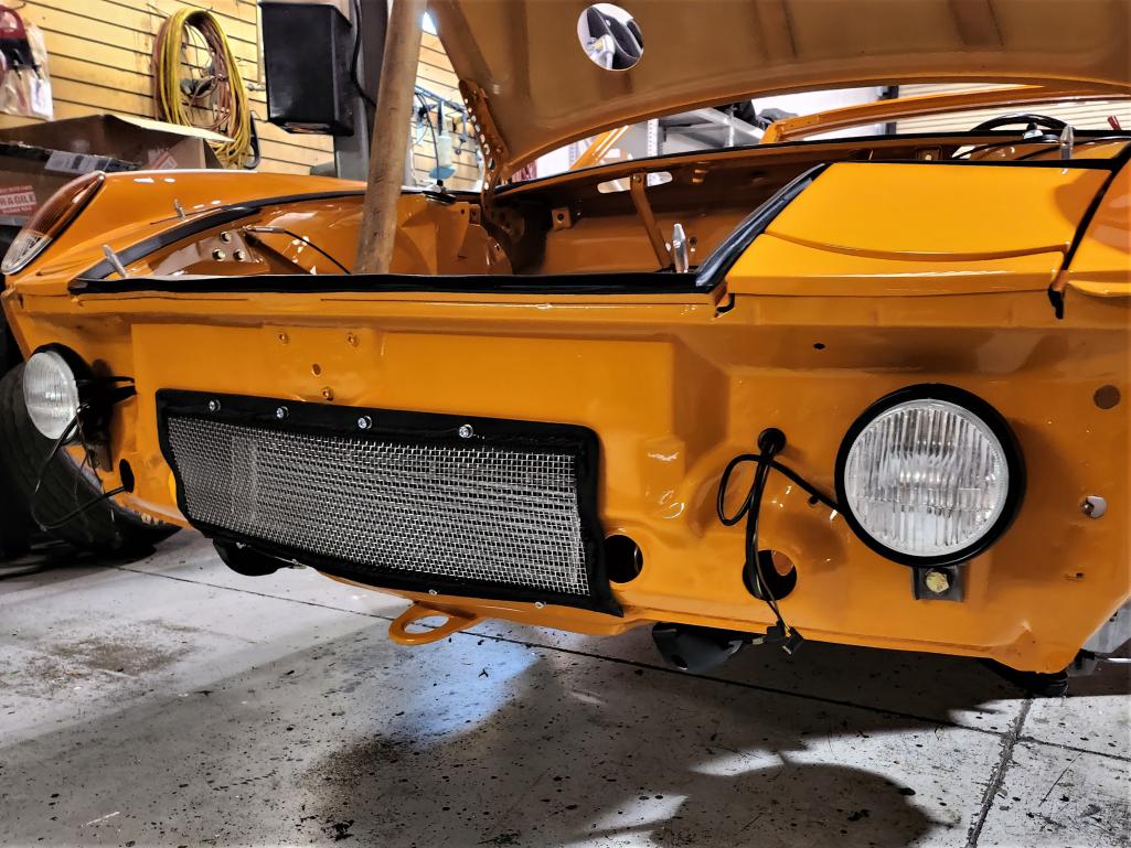

GT Fuel tank and oil cooler mods were straightforward...
Posted by: Bullethead Apr 1 2022, 12:44 PM
Test fitment: like buttah! Yes, that is a real-deal NOS GT tank. I sold a kidney.

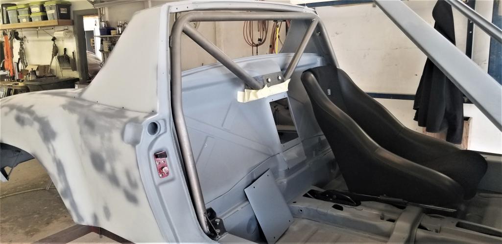

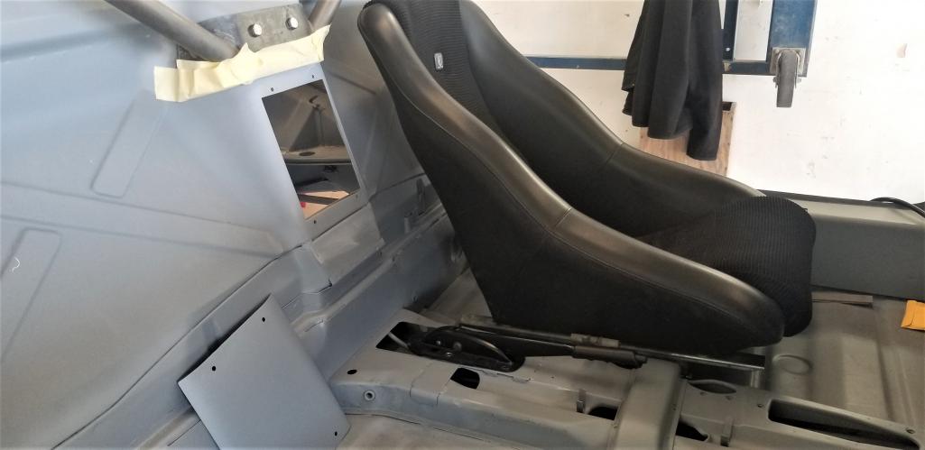

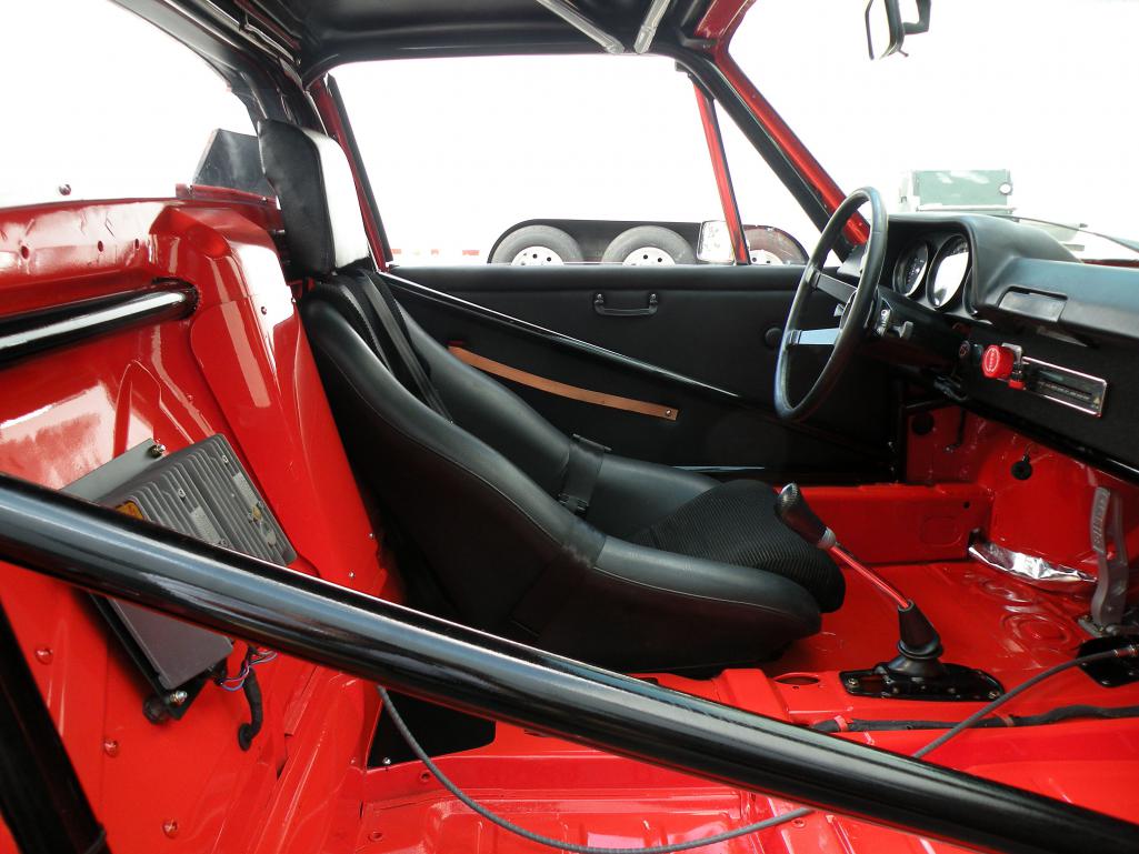

As of yesterday, determined seat locations with the bar installed. Some adjustments to do... also fitted the manual headlight kit from Mittlemotor. Cables are too short! Grrrr.

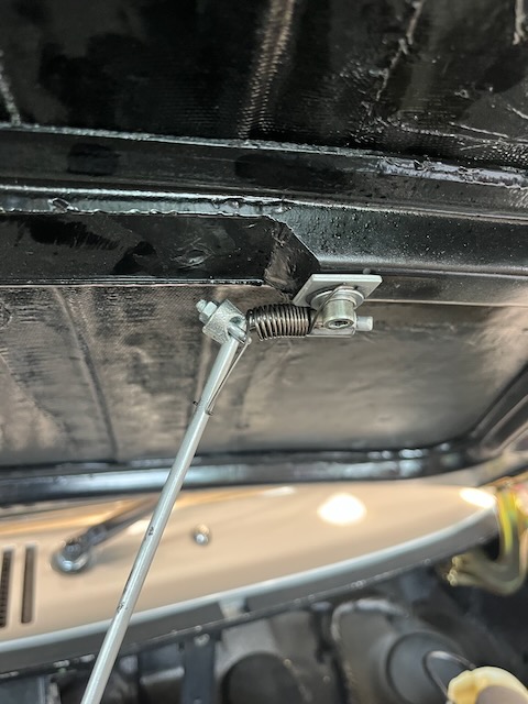

On the kit I saw, the cables were bicycle cables and housing. If so, go to a bike shop and get some high quality teflon lined housing. It's worth the money over the cheap replacement stuff.

Cheers Mark, but the buttons on the ends of the cables are really small. Have asked the kind folks at 914 Rubber to check with the supplier and hope they can solve it.
The cables are nearly a foot short, kinda hard to imagine that sort of quality control fuck up.
EDIT: Just looked at a half-dozen cable makes and MAYBE Shimano ends will fit. Fingers crossed for a simple solution.

Your roll bar looks way too short - too close to the helmet in tech inspection.
See this: https://pbase.com/9146gt/image/113481744
This will still fit under the targa top
Posted by: mepstein Apr 1 2022, 04:48 PM
Check the end of a derailleur cable.
Posted by: Bullethead Apr 1 2022, 04:59 PM
No worries. The bar is an exact reproduction of the factory piece fabricated by one of the best-known Porsche race car restorers in the world (who sold me the car in the first place).
I'm building an accurate replica, not a track car so we're not concerned with the current rule book. It will be a streetable GT for rallye use mainly.
Biggest difference from a period GT is the engine; I'm using a twin-plug 2.8 RS motor with Webers.

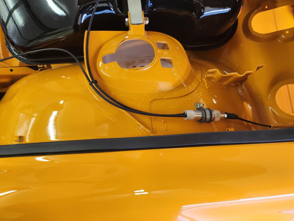

So you'd think the bike cable sizes would work, but the smallest barrel available is 4.5mm dia x 5mm long. Some fiddly filing is in my near future: they need to be 3.8mm dia x 4mm.

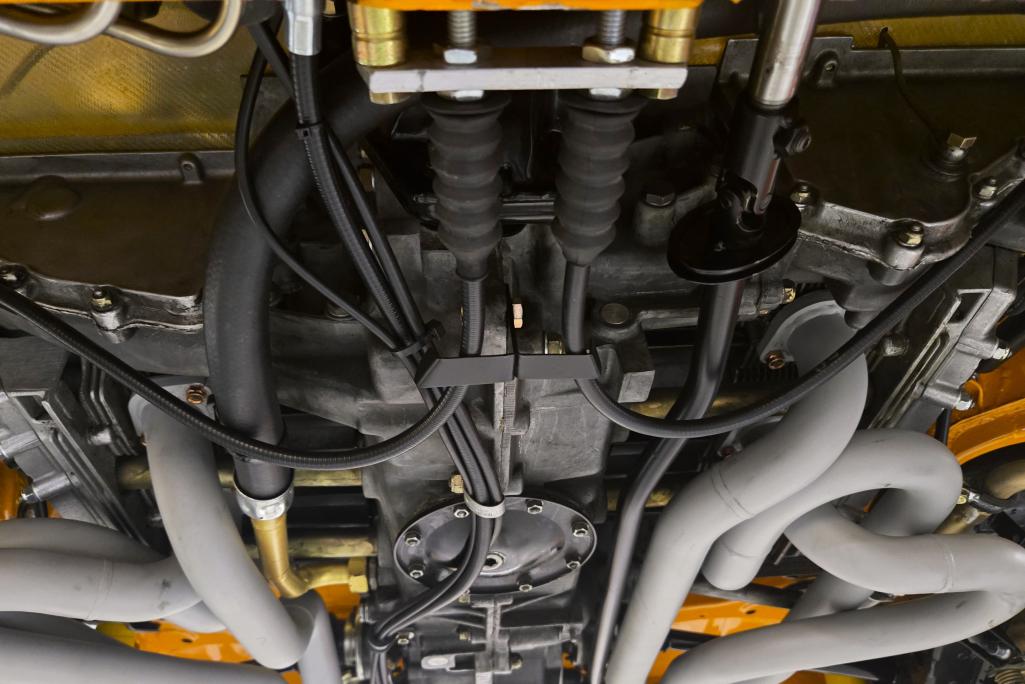

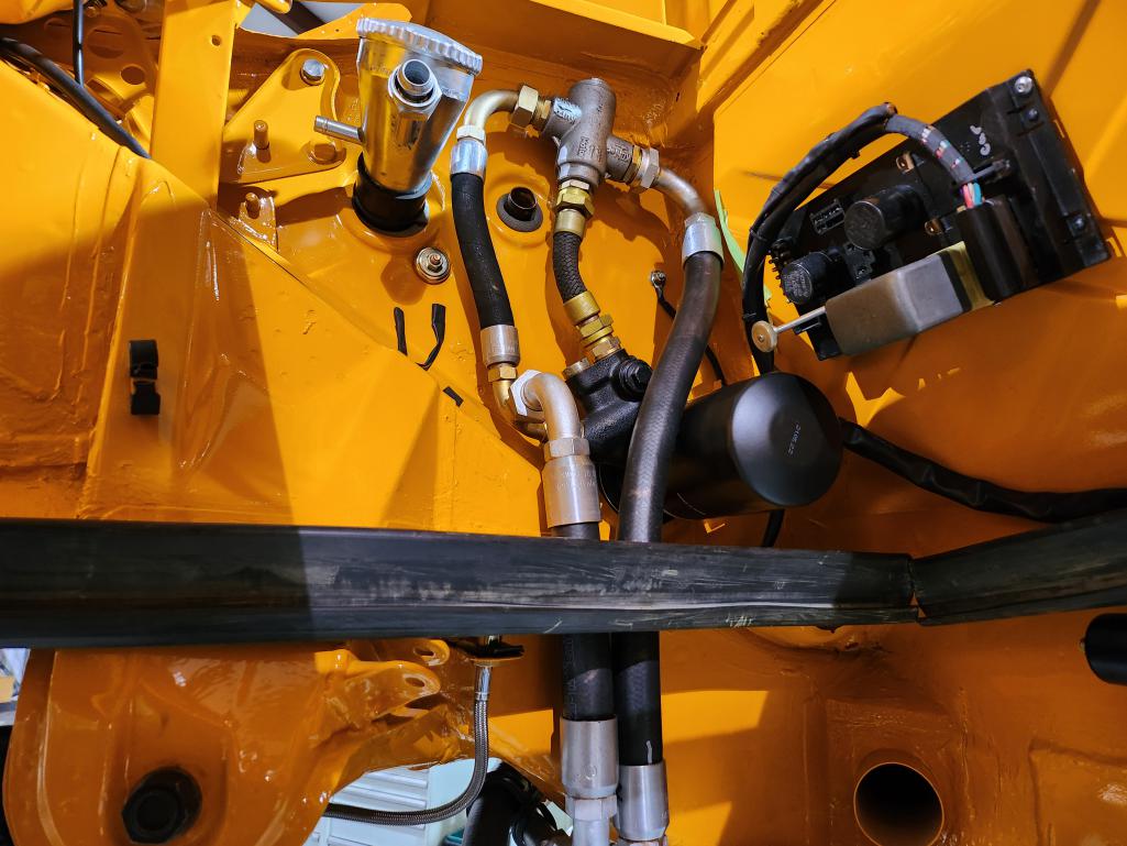

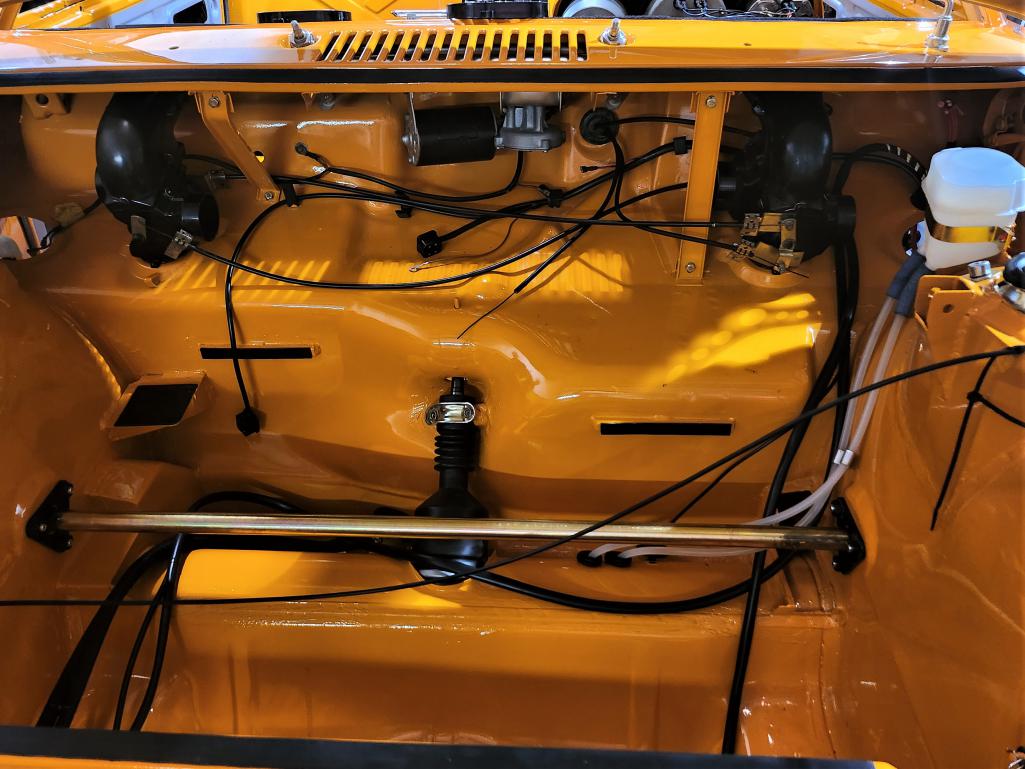

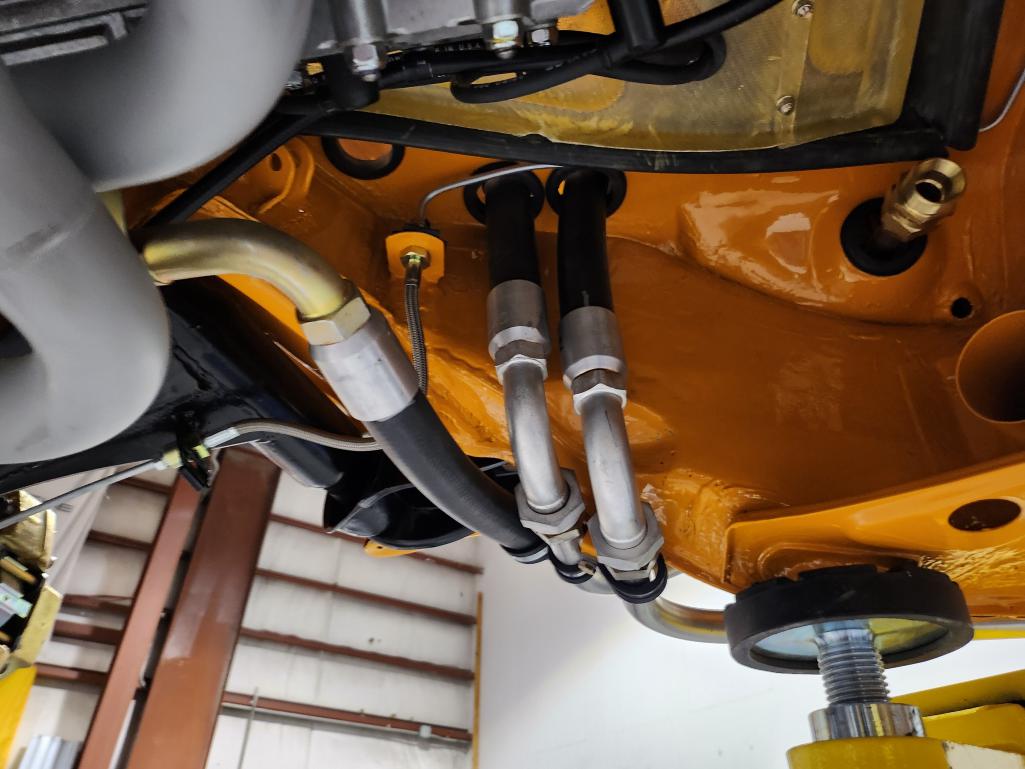

A few more detail shots of the oil line cockpit routing.

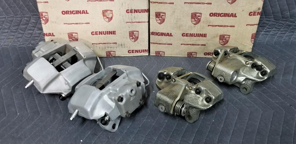

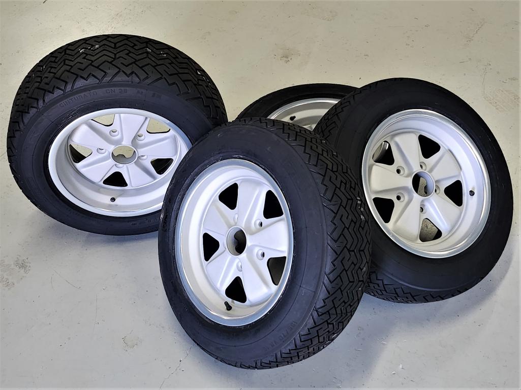

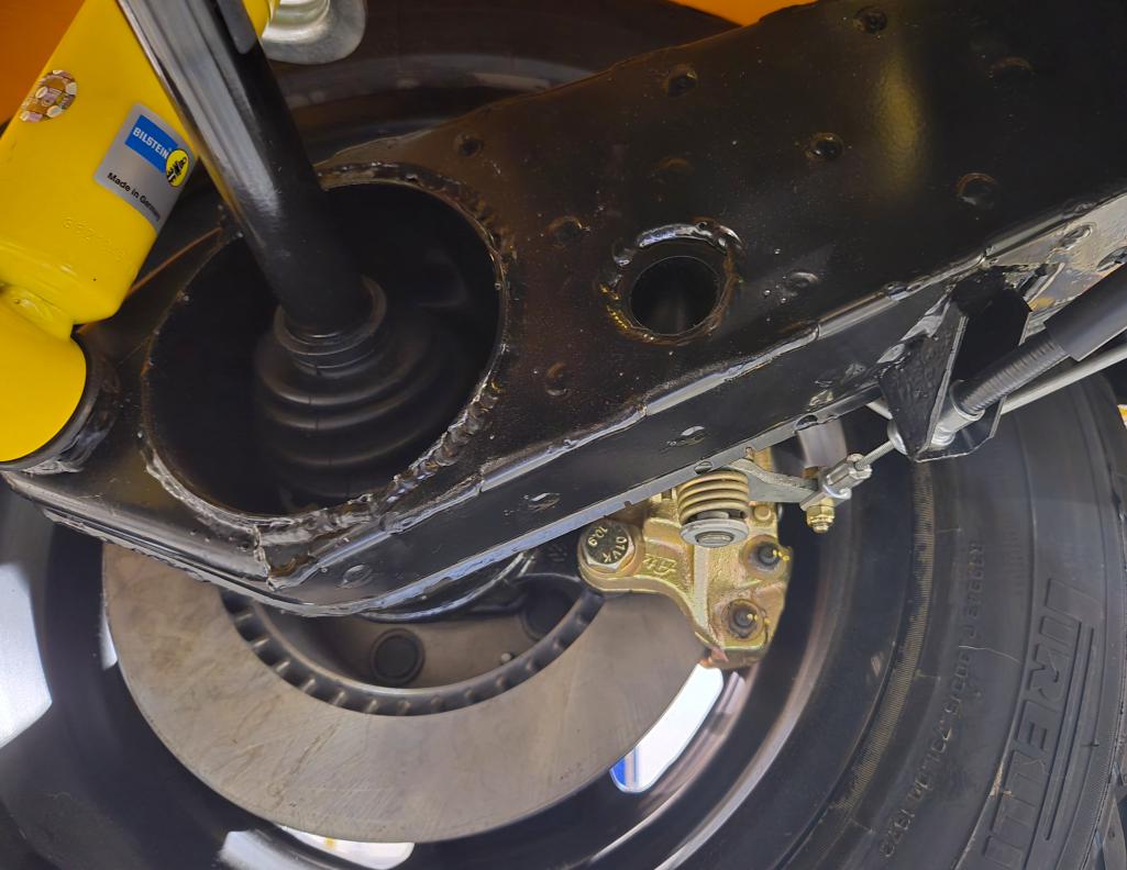

How about some brake porn? NOS vented GT rears plus calipers... lucky to get them and the 908s. Thanks Bernie!
Posted by: mepstein Apr 4 2022, 04:05 PM
Posted by: Shivers Apr 4 2022, 06:14 PM
QUOTE(Bullethead @ Apr 4 2022, 01:48 PM) *
drooley.gif Very nice.
Posted by: Dion Apr 4 2022, 07:35 PM
908’s!!! LeMans here we come. Quick change time, That is sweet! beerchug.gif

We used to have to smooth out the ends sometimes if they had a bit of flashing on them. A bench grinder does it in seconds. I would see if you can enlarge the hole to 4.5 so in the future, any derailleur cable will fit. Then keep an extra pair in the toolkit.

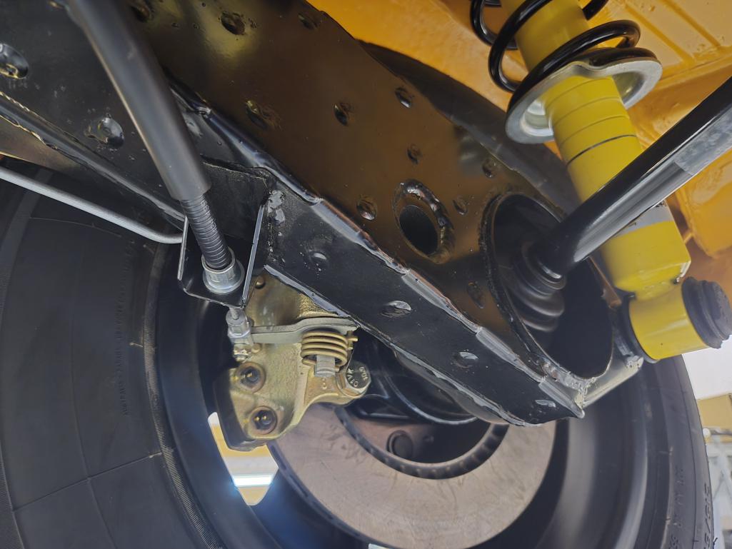

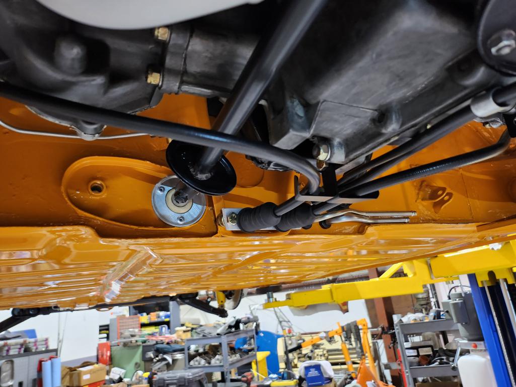

Posted by: Bullethead Apr 8 2022, 02:32 PM
Thanks to the fine folks at 914 Rubber for contacting Mittlemotor about the cables: longer ones are on the way. You're right Mark, filing the bike barrels to size was easy, so now we have a bunch of spares.

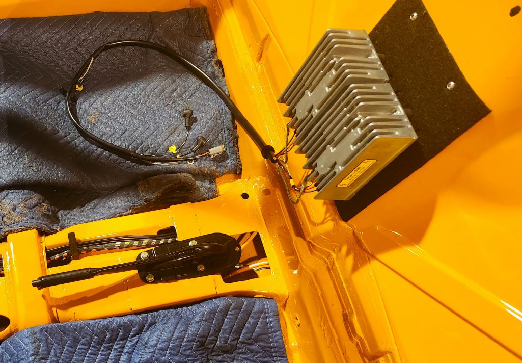

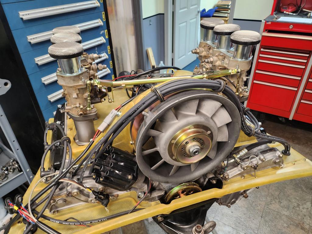

More progress this week: engine access cut, handbrake relocation and driver's seat rails complete, body got mud and some finish sanding, and just for fun the engine grill was dropped into place.
The next 4-6 weeks will be little stuff like harness brackets, auxiliary lighting mounts and paint prep. Moving along nicely.

Thanks Dan, moving the handbrake was much easier than you might think, and regular 911 cables run through existing (heat flapper) tubes. At first I was unsure but since they're equal length it looks like no other mods will be needed. Update on that at assembly time.
Almost forgot: remove the old e-brake tube and handle mount to the left of the driver's seat. BTW, for windshield defrost I'm using a small inline heater... no cabin heat otherwise. At least that's the plan. idea.gif

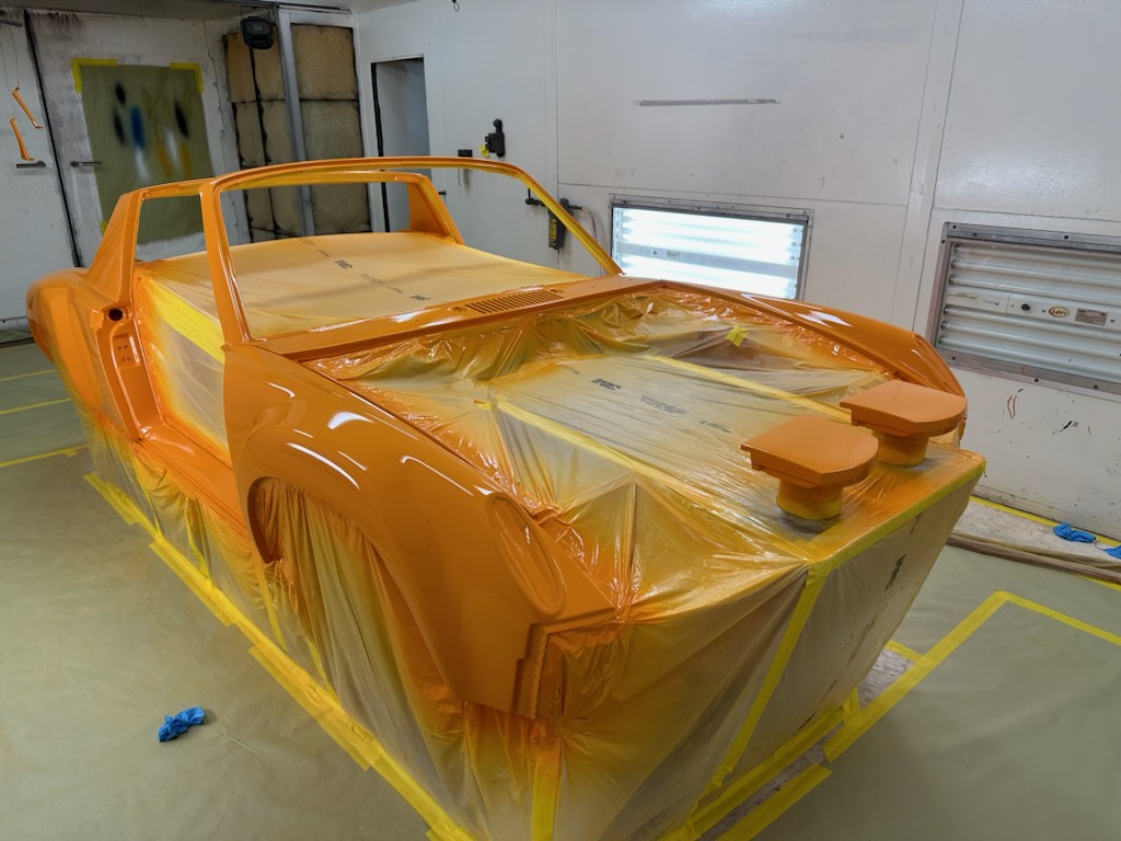

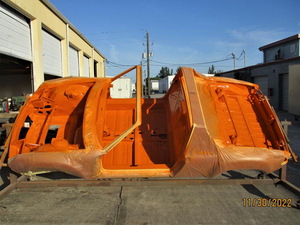

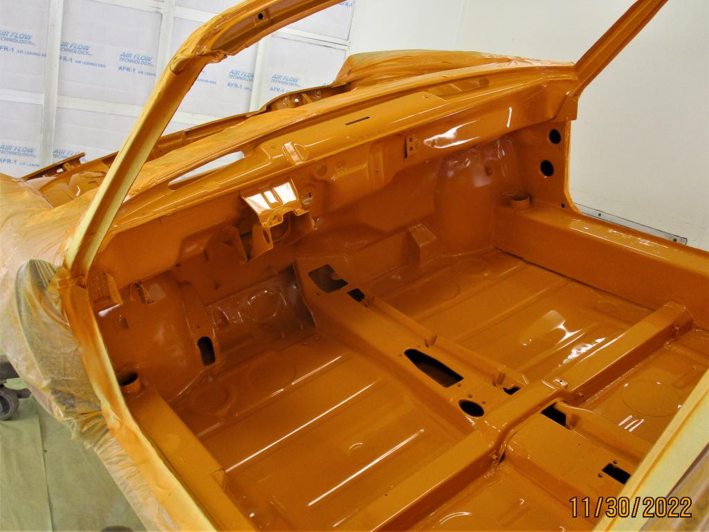

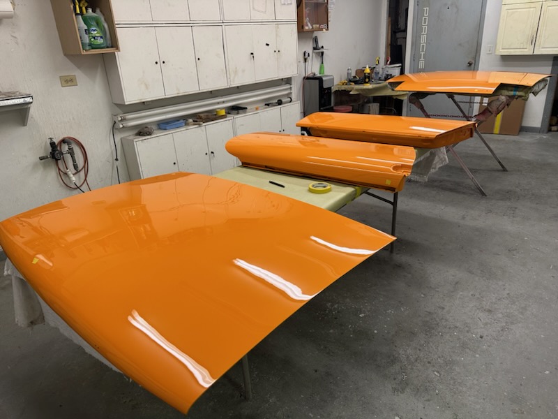

Posted by: Bullethead Oct 2 2022, 12:53 PM
Slower pace of work this summer, but now much closer to paint. Final fitment of all panels and mucho blocking time... color cards sprayed and approved. Next post it'll be orange again.

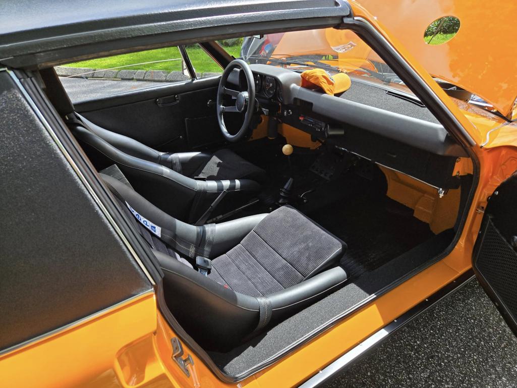

Are you planning to add a headrest? If this is display only thats fine but unless wearing a helmet or adding a headrest (or both) this is dangerous. Most any back or forward accident force will have occupants smashing skulls on the rollbars. That design is meant for a fully caged track car.
Posted by: Bullethead Oct 3 2022, 12:13 PM
Obviously... looking for Scheel 914 headrests now, but will have something by the time it's rolling. Will also wrap the bars.
And believe it or not, the factory GTs weren't fully caged. The roll hoop plus chassis reinforcements were it... as we all know, everyone added more and more. My old car:

Ok good to hear and for sure safety took a back seat (pun intended) to speed back then.

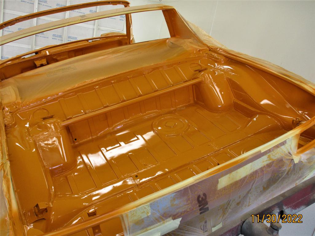

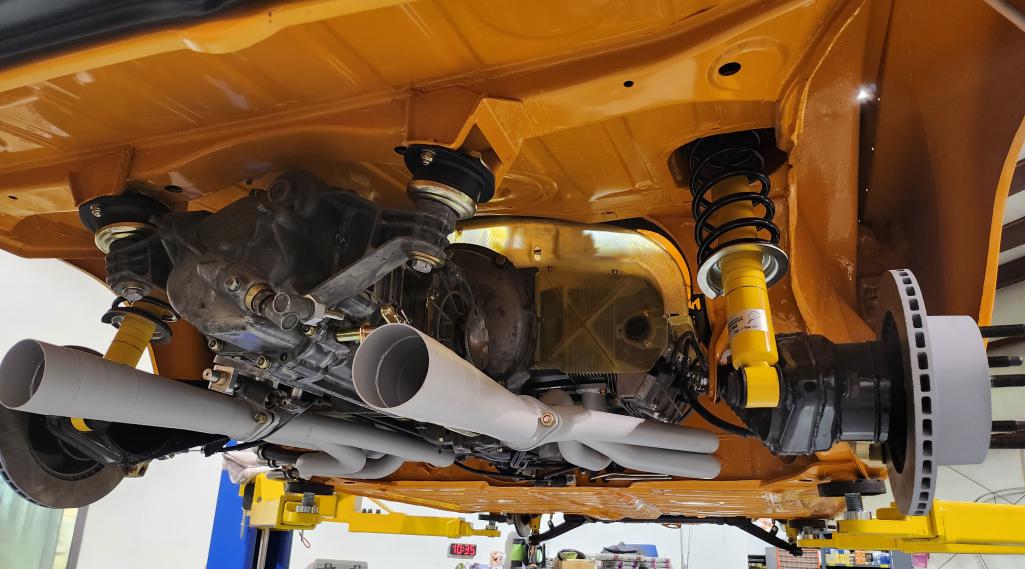

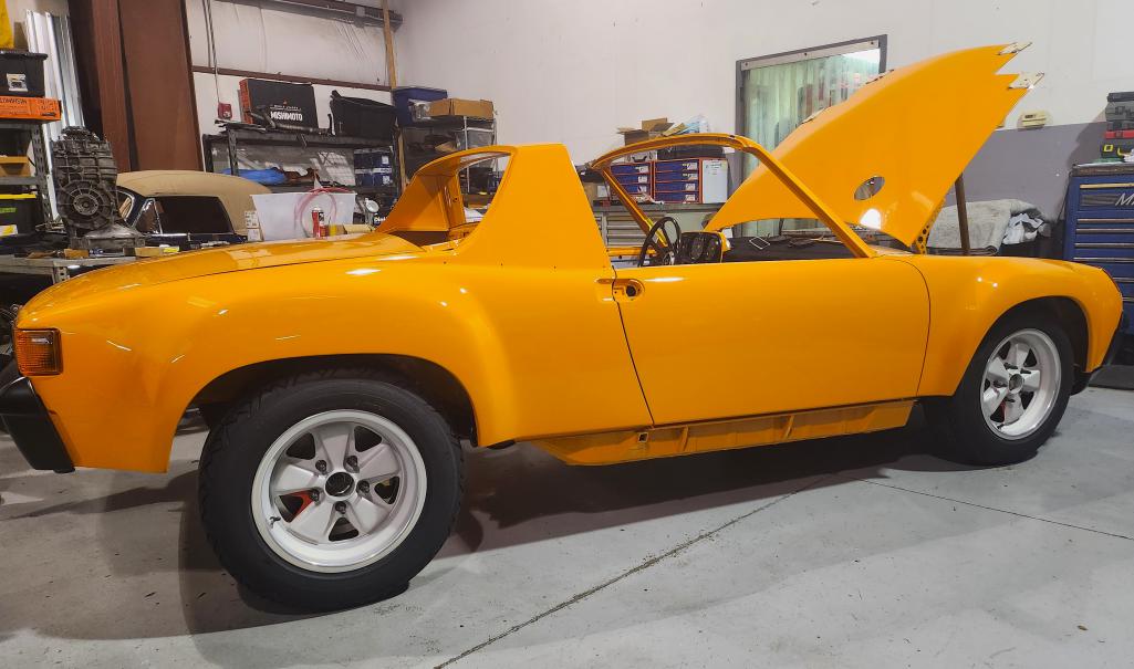

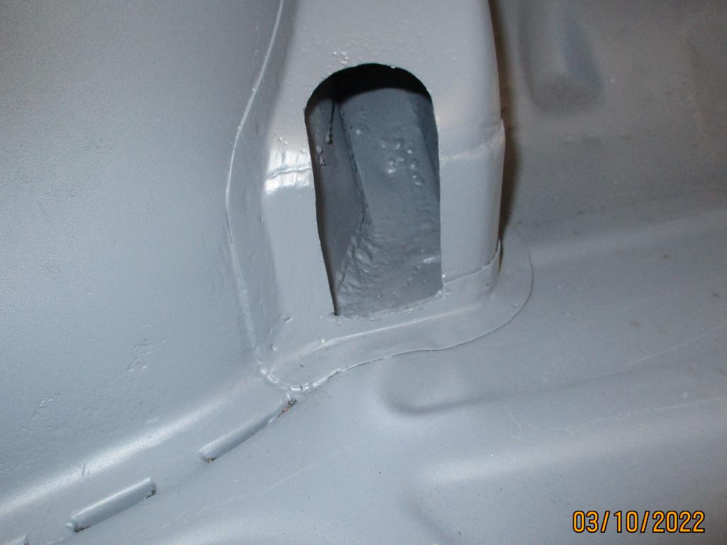

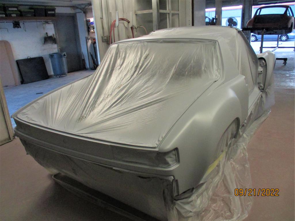

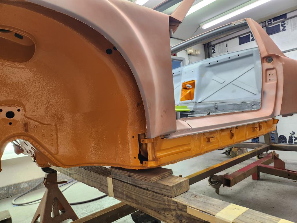

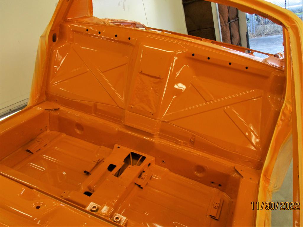

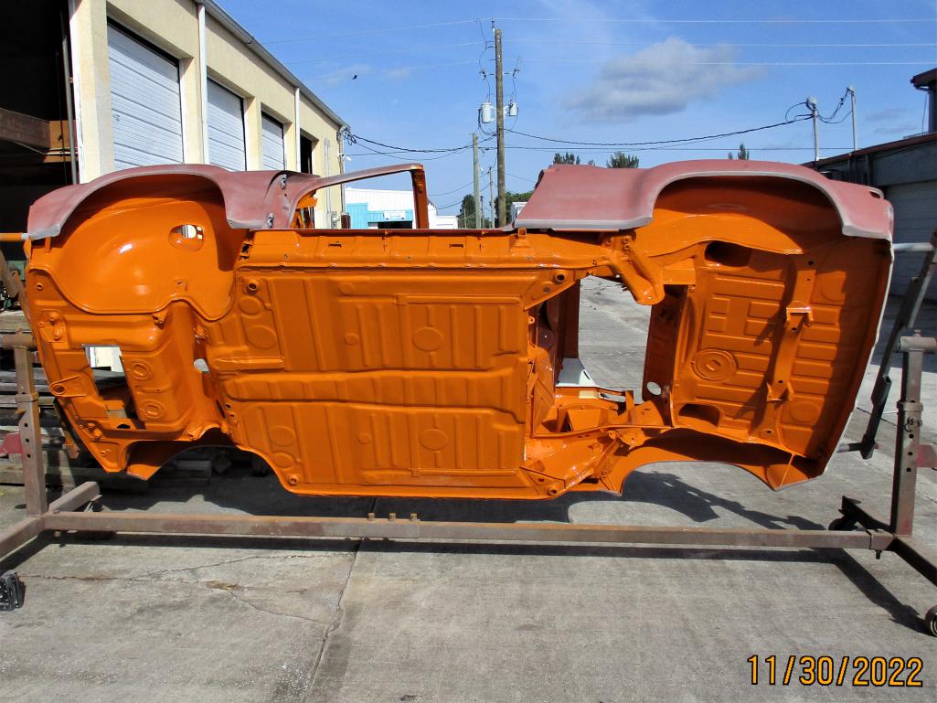

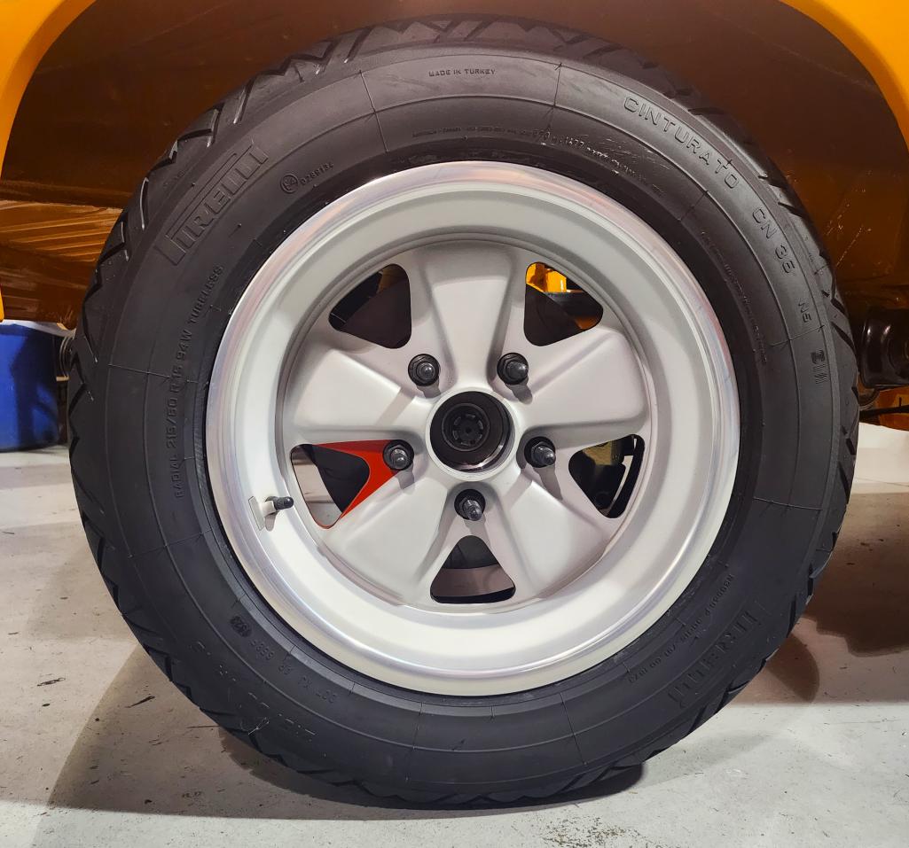

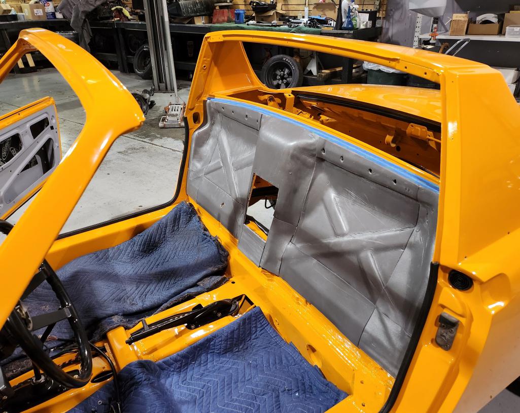

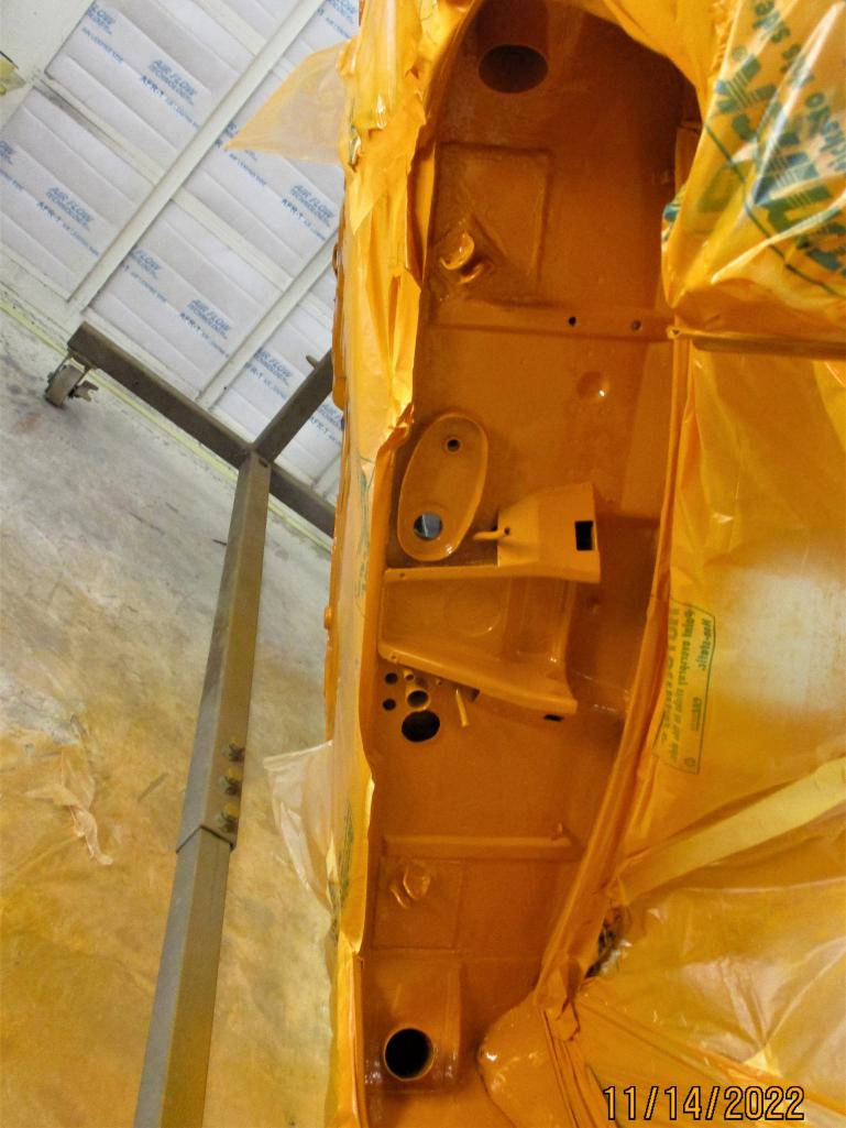

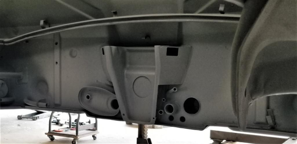

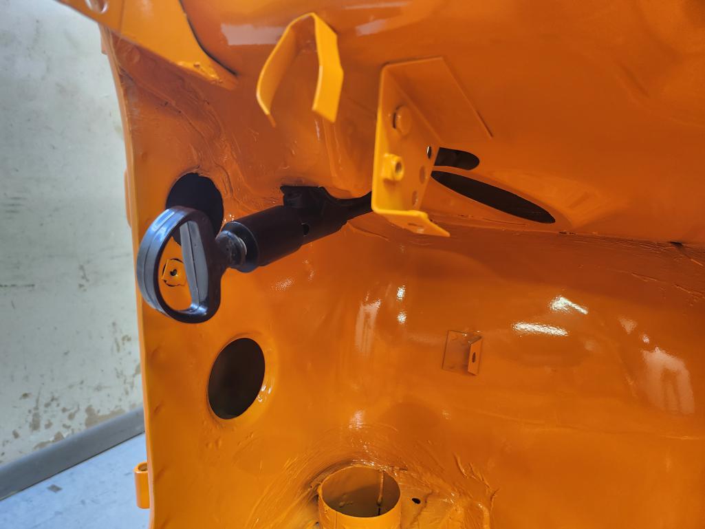

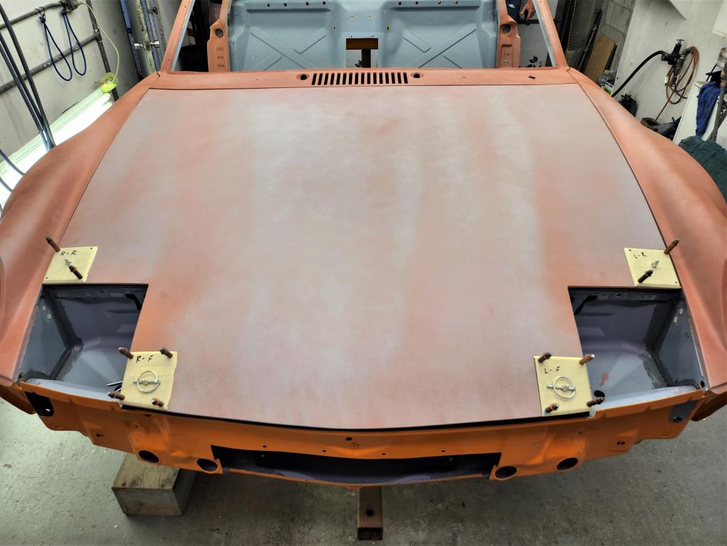

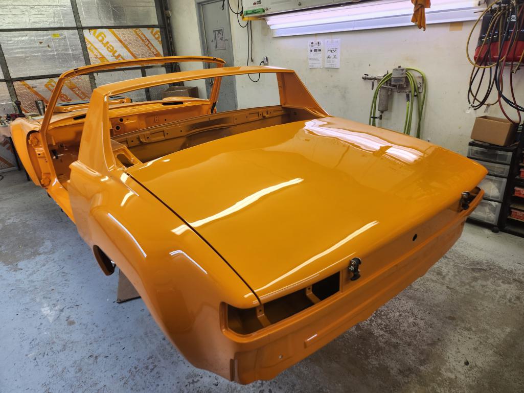

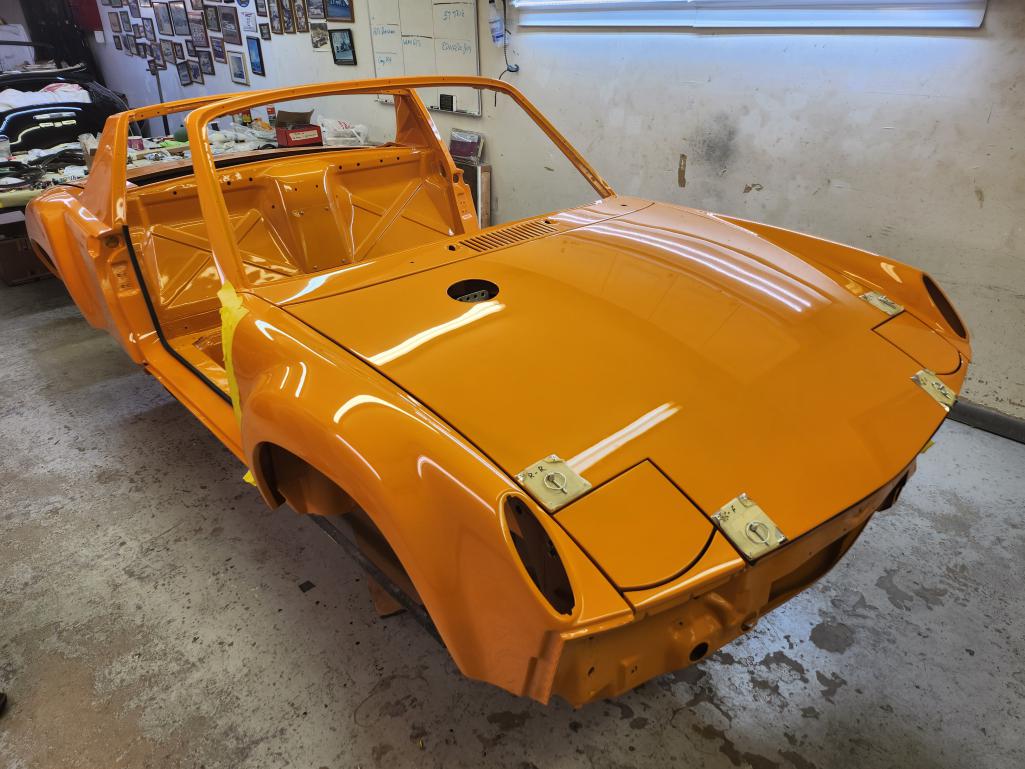

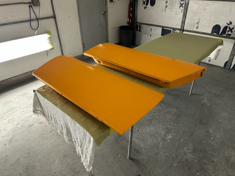

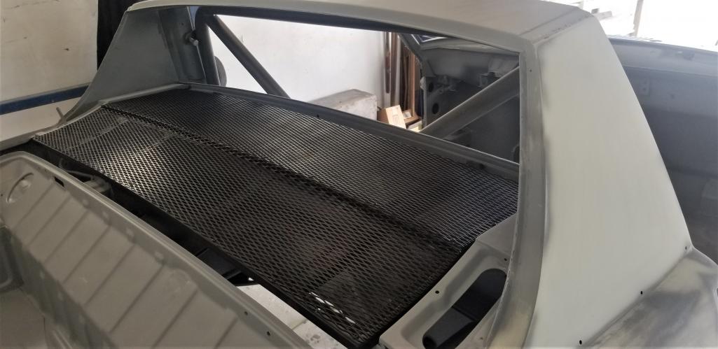

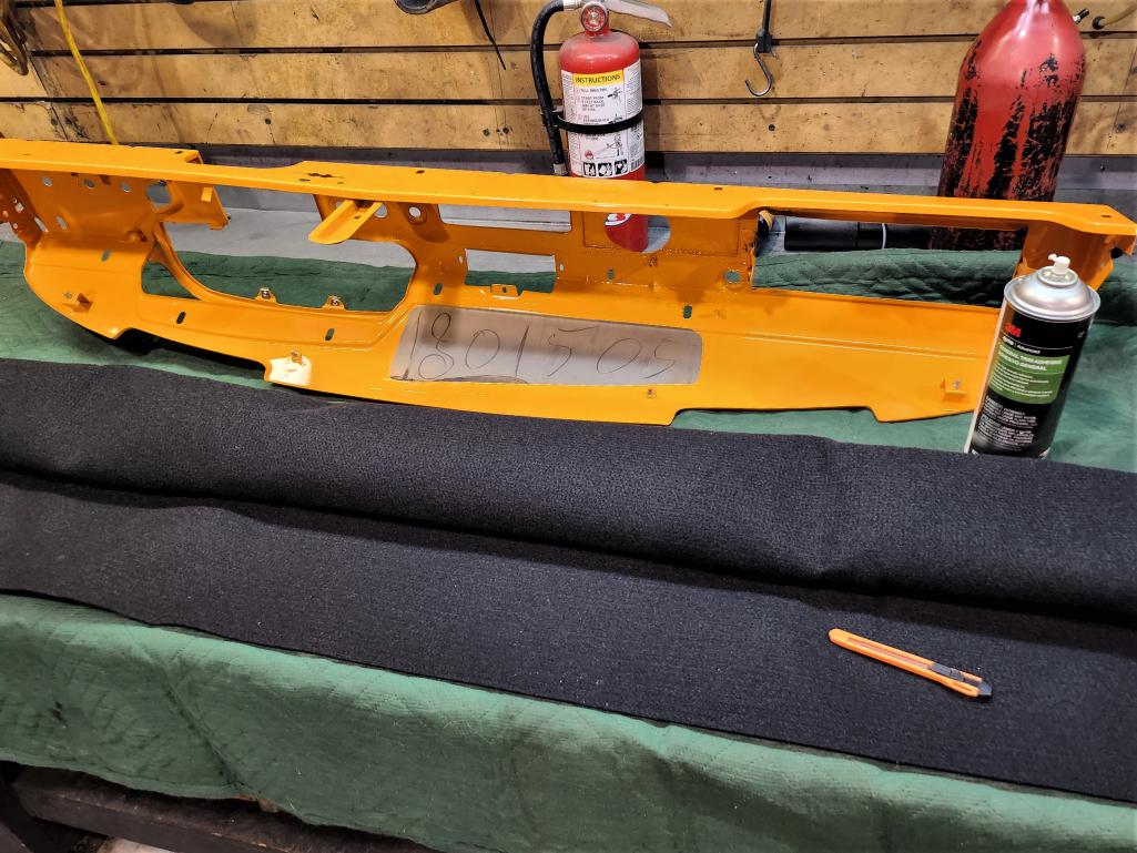

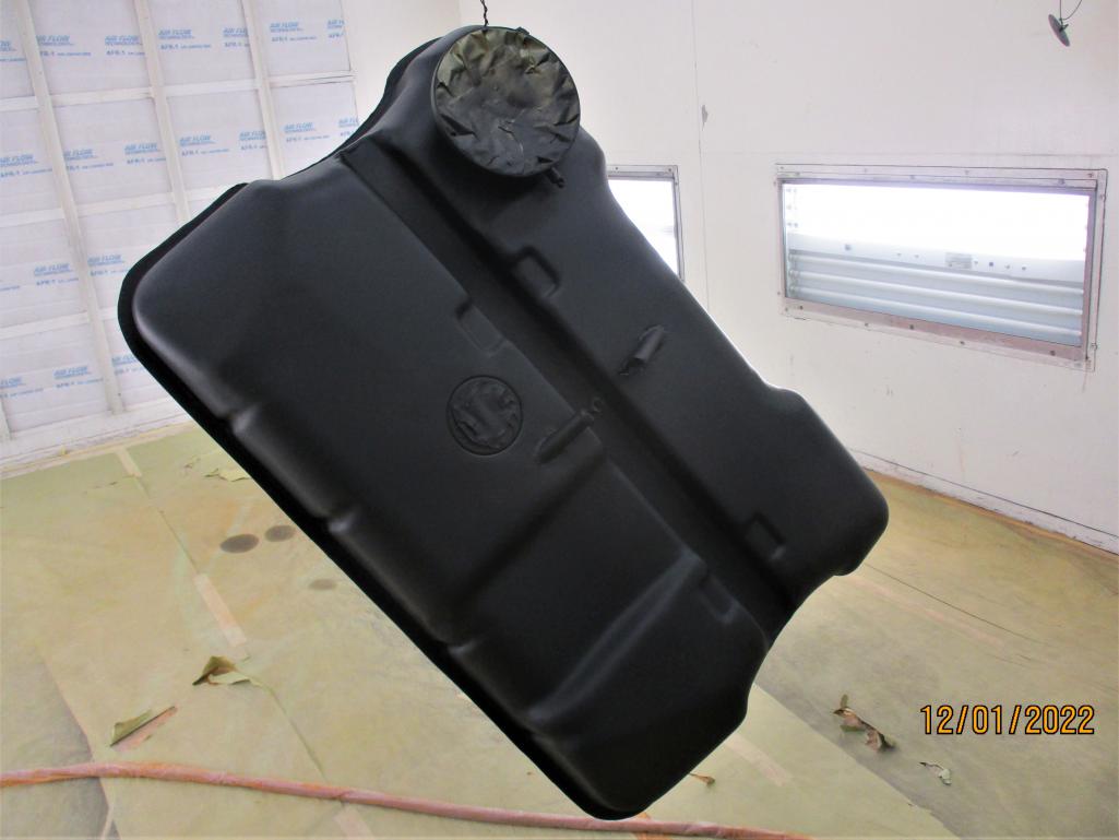

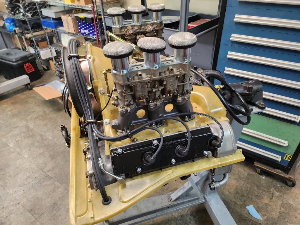

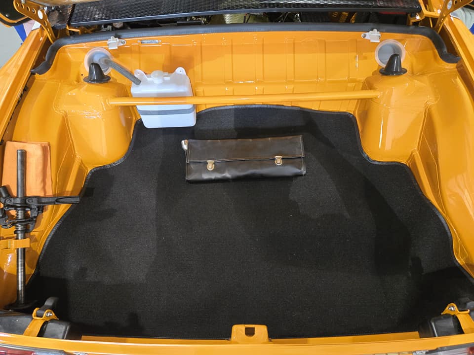

Posted by: Bullethead Nov 2 2022, 08:01 AM
Seams sealed, underside schutzed and painted, hood pins fitted. They'll probably cut the fuel filler today. Very close to final paint, and finally back to Klub Sport for assembly.

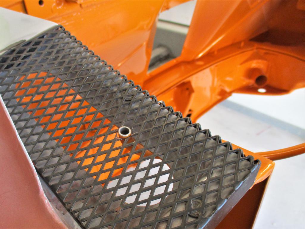

Posted by: Bullethead Nov 2 2022, 08:05 AM
Posted by: Bullethead Nov 2 2022, 08:13 AM

I am doing a center mount brake set up as well. Could you possibly post some pics of what you have done to your car? I was looking at a more elevated set up but yours looks really clean.

Grant, I'll take a few detail pics of the handbrake with dimensions. Or you can go to Armando's site for that and much more. He's devoted a huge amount of time and energy covering all the nuanced details of both factory and privateer GT builds.

Posted by: Bullethead Dec 5 2022, 02:59 PM

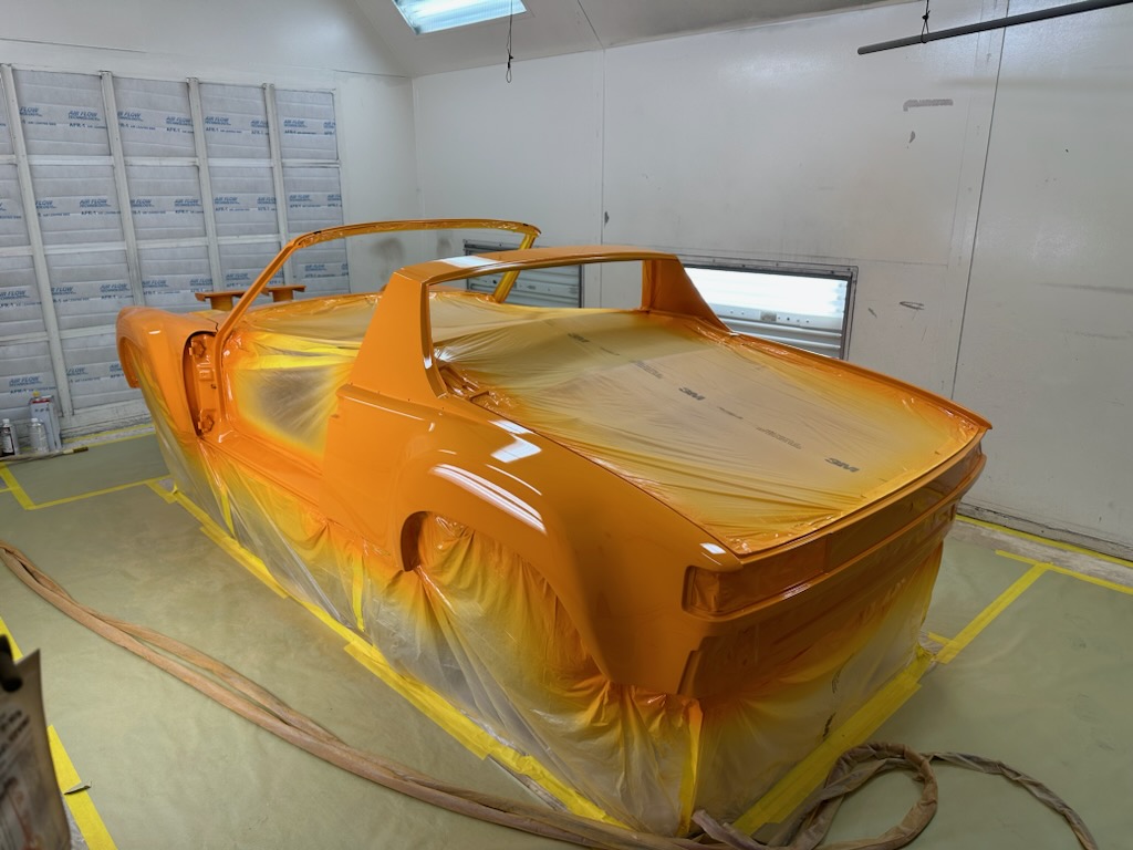

More paint done... lots of details to address. Underside, cockpit, engine compartment and trunks are all single stage. It's hard to get even color when cutting and buffing final, so the exterior will be two stage. Very close to reassembly time.
Posted by: Bullethead Dec 5 2022, 03:00 PM

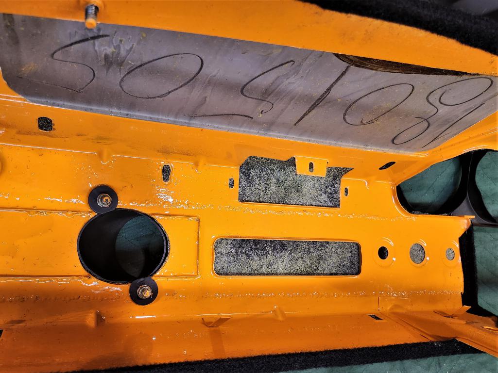

The old foam in the tank was dust, so it was boiled out and refinished. Haven't stuffed the new foam in yet but should be fun.
[attachmentid=858784]

Posted by: Cairo94507 Dec 5 2022, 03:49 PM
Very very nice build. Looking forward to seeing assembly. popcorn[1].gif beerchug.gif

Posted by: Bullethead Dec 29 2022, 08:03 PM
Paint is finished, the resto shop will bolt the doors and lids on next week and we'll start assembly soon after. Glad I didn't change the color much as I thought about it, really digging the classic safety orange after all.
We probably won't get the FG engine tin from F-S-H in Germany until late January, so if it's completed by March it will be a miracle. Interior details are gonna be fun!

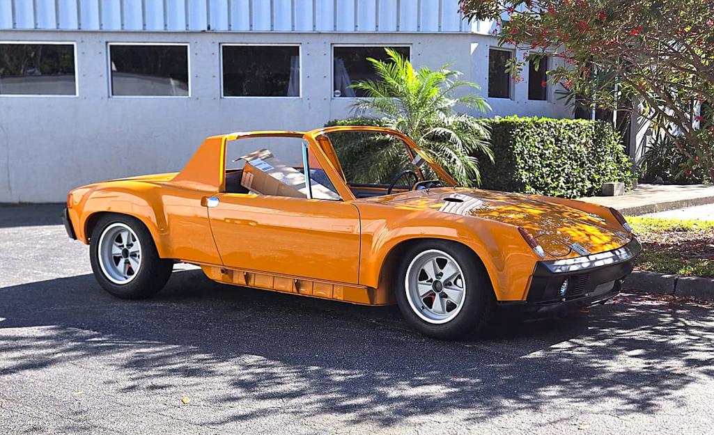

Posted by: Bullethead Jan 26 2023, 04:24 PM
QUOTE(Krieger @ Dec 30 2022, 11:26 AM) *
WOW, that looks amazing! Don't rush the reassembly.

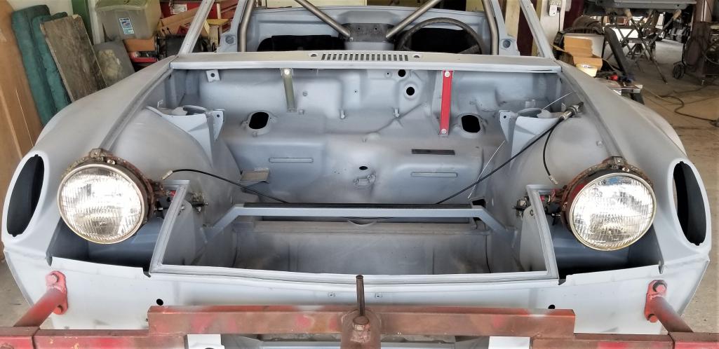

Of course, you're right. Steady progress... lids and doors fitted, headlight actuator works great, soon back to Klubsport for the drivetrain.
Still waiting for some parts from Germany, but finally got good news that the brightwork is on the way, and all of the rubber has been accounted for. Time to polish some glass.
Posted by: Bullethead Jan 26 2023, 04:26 PM
Panel fit and paint is near perfection... these guys do exceptional work.

Used the same "D" handle for the lights as for the engine lid. Cheap and easier than adapting the hood release part.

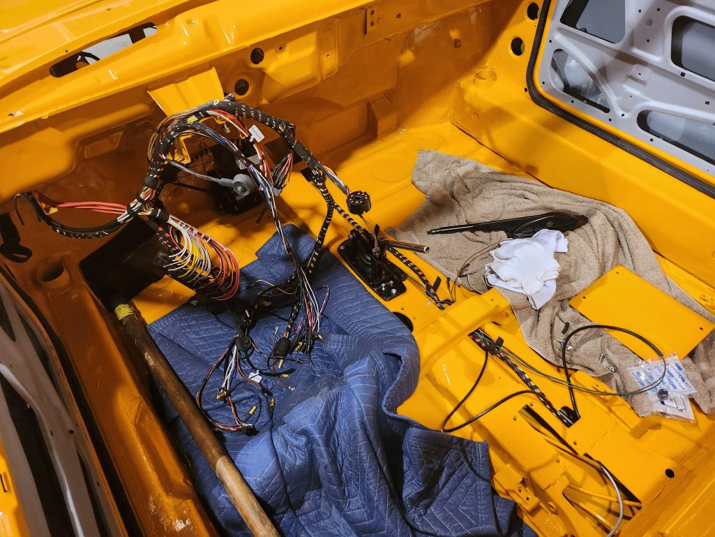

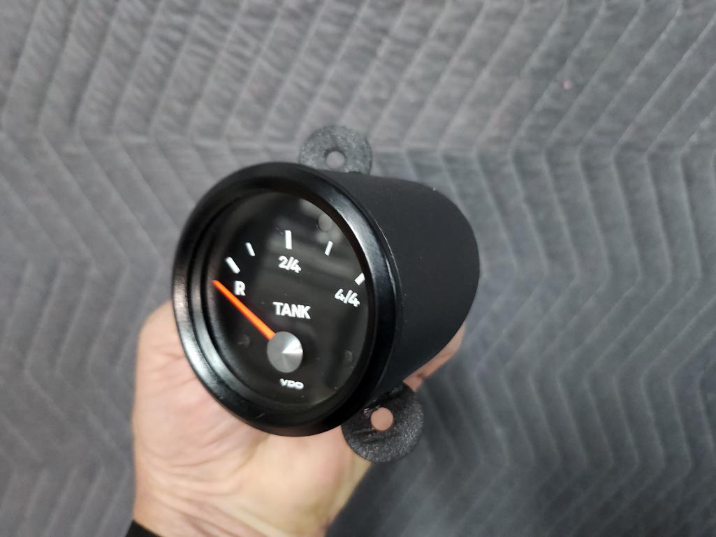

Making progress, harness is in, suspension is on, and while waiting for some parts restored the wiper system and started on the defrost/blower. Also fabbed up the fuel gauge binnacle which came out pretty nice. 60mm exhaust pipe cut on a 30 degree angle, tacked on a couple of washers as mounting points and sprayed with a little bed-liner paint.
Posted by: Bullethead May 15 2023, 07:44 PM
[attachmentid=876551]
Posted by: Bullethead May 15 2023, 07:45 PM
Posted by: Dion May 16 2023, 12:14 PM
That fuel gage looks perfect! Nice fab work.

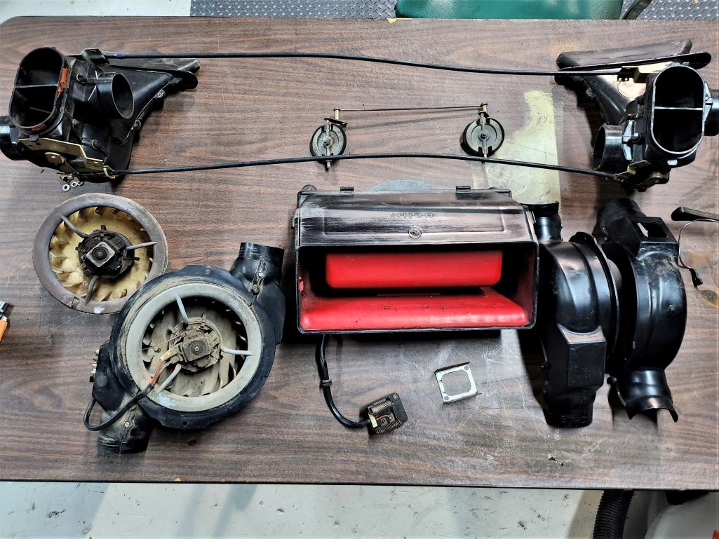

Posted by: Bullethead Jun 12 2023, 02:15 PM
Posted by: Bullethead Jun 12 2023, 02:22 PM
Not digging the fresh air / defrost job at all. I have two complete sets in the stash, and MAYBE half is usable because of cracks and broken tabs. The good airbox has overspray that won't come off, so semi-gloss black rattlecan is gonna happen.
At least the blower motor is available.

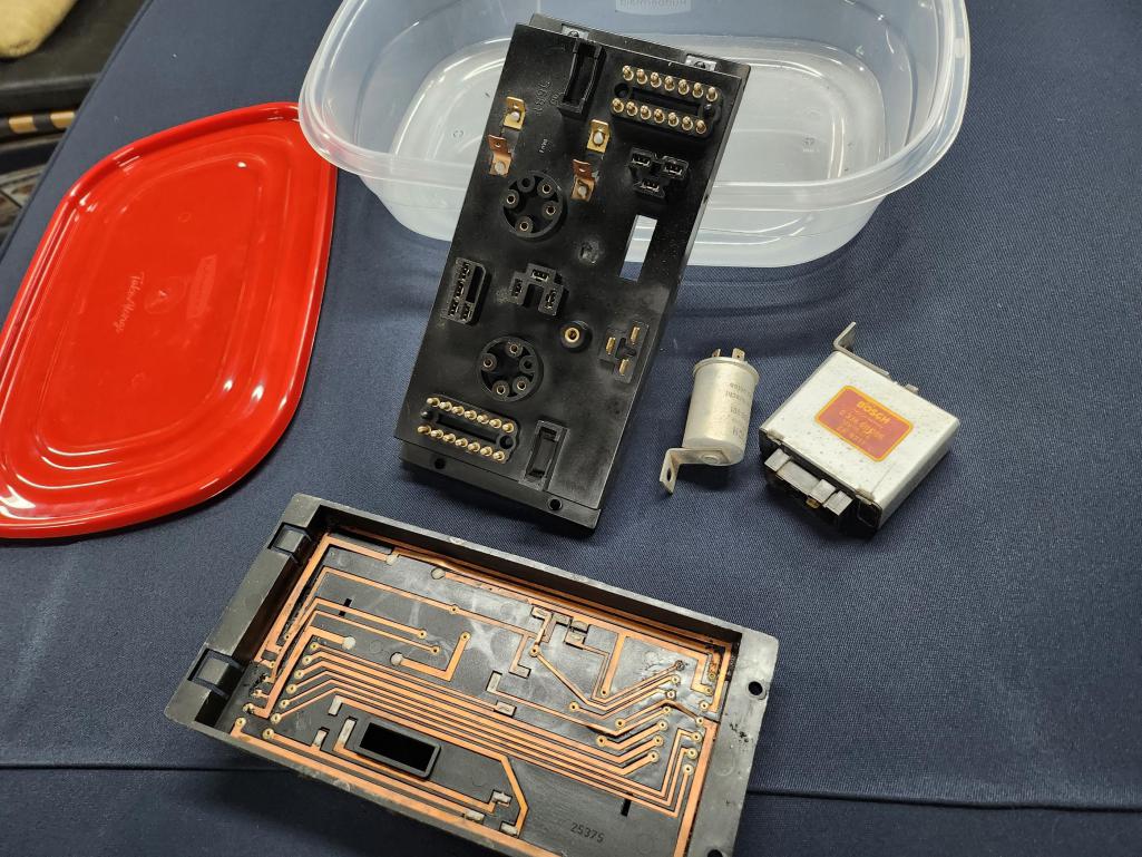

Posted by: Bullethead Jun 12 2023, 02:30 PM

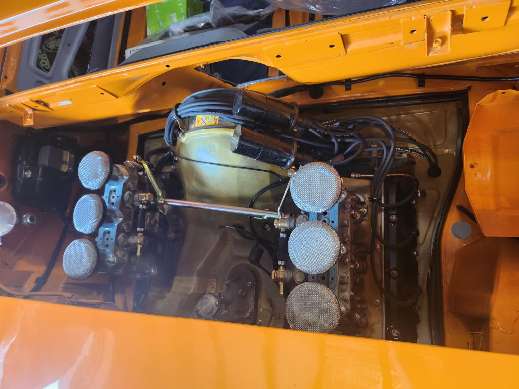

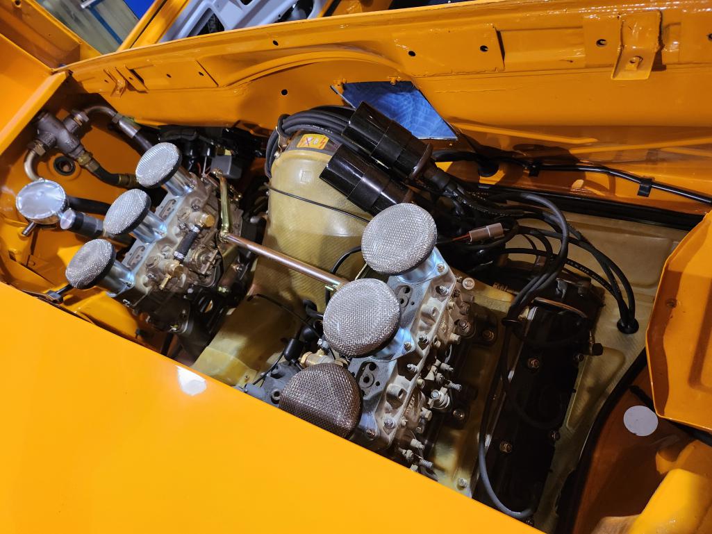

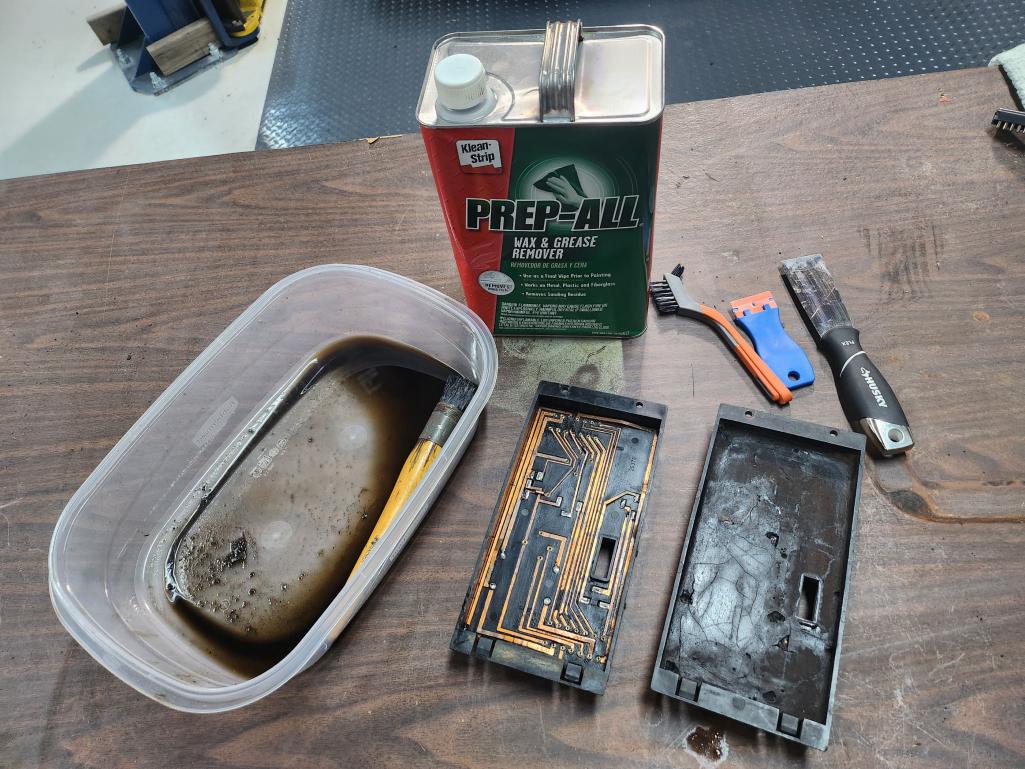

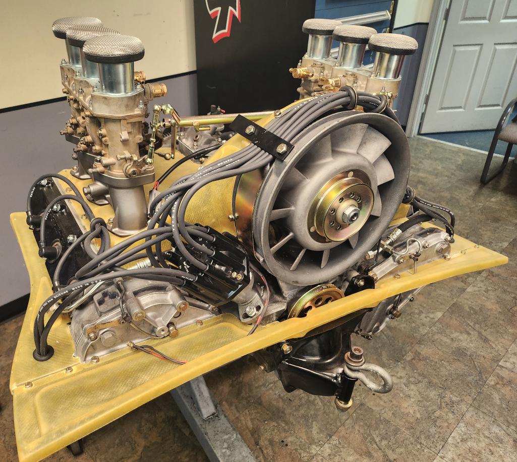

Bought an engine board without knowing that I had one already, so cleaned, tested and sealed the pair. One might be for sale in the near future.
Posted by: Bullethead Jun 12 2023, 02:39 PM
Engine is 2.8 twin-plug with S internals and cams, 46mm Italian Webers backed by an LSD 901 transaxle. All fresh, carbs rebuilt and dressed with new FG tin... looking very nice.

Posted by: BillJ Jun 12 2023, 02:49 PM
Where did you find those velocity stack covers?
Posted by: Bullethead Jun 12 2023, 05:33 PM
QUOTE(BillJ @ Jun 12 2023, 04:49 PM) *
They're from BBR Filters, a couple of eBay stores sell them, or try https://www.carburetion.com/Products/ProductDetails.aspx?Part=CUSF64
A pair of rain hats goes on too. We're still a ways off from drivetrain installation.

Posted by: rgalla9146 Jun 12 2023, 06:22 PM
QUOTE(Bullethead @ Jun 12 2023, 04:39 PM) *
Rainhats may be an issue with tall intake manifolds
My passenger side interferes with the front wall of the trunk

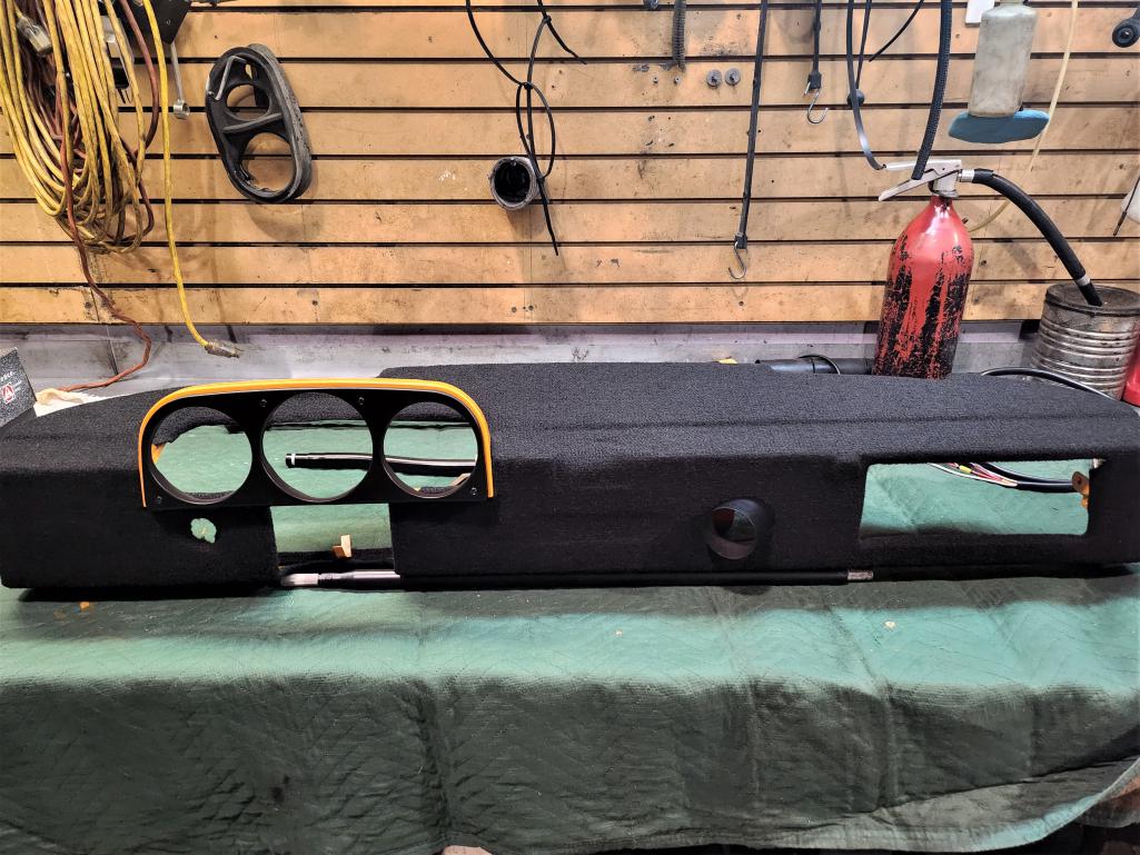

Got the dash covered and the fuel gage mount installed... will cut out holes for switches and controls as needed. The fuel gage mount came out very tidy.
Posted by: Bullethead Jun 20 2023, 06:09 PM

Also got the cooler and shroud installed... unfortunately, we didn't fit the fog lights + grills when the bumper was, so quite a bit of trimming is in the works. Stupid oversight. Thankfully, the horns WERE fitted, so no issue there. Pics to come.

Posted by: Bullethead Jun 20 2023, 06:32 PM
Hey Mark, got it from FSH in Germany along with the engine fiberglass. Gotta paint them black and not cheap, but the fit is good.
https://www.f-s-h.com/Oil-cooler-pit-grille-for-914-6-GT

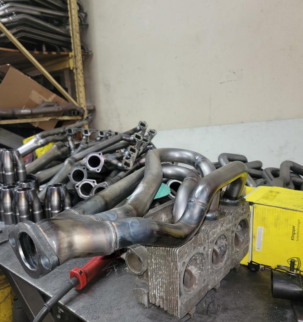

Posted by: SixerJ Jun 23 2023, 05:36 AM
Nice progress
Other good off the shelf option is Mittlemotor (steel), still spendy, but what is your time worth or metal dude cost per hour?
https://www.mittelmotor.de/racing/de/914-6-zubehoer/478/5411/0-08-914-6-gt-teile/0-081/2-0-08124-neu-detail
Posted by: Bullethead Jun 23 2023, 05:53 AM
I think Volker at FSH sells his stuff to Mittelmotor, or at least they come from the same producer.

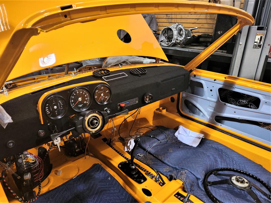

Posted by: Bullethead Sep 4 2023, 04:43 PM

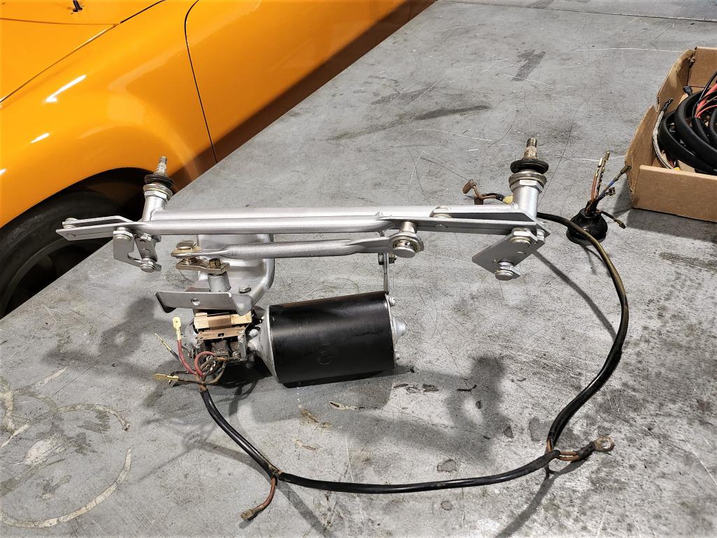

A little more done on the dash wiring, wiper system in, blower/defrost is next.
Posted by: Bullethead Sep 4 2023, 04:57 PM
After trying all year to secure a set of Michelin TB15s for 7s & 8s, I gave up and waited just 7 months for some Pirelli CN36s. I have these on my '67 S and love them, they'll do fine here.
Mr. Weidman anodized these in his signature RSR finish, no painted petals. Thinking of just the valve petals in a small flag of color... or maybe the lug end. Suggestions appreciated! beerchug.gif
I have a line on a spare set of 8s & 9s, hopefully the Michies will be available at some point.
Posted by: horizontally-opposed Sep 4 2023, 06:36 PM
Car coming together really nicely, in typical Russ fashion. That interior is a stunner. Now I am curious—were the insets under the door cards done that way on some or all cars?
Wheels definitely want for something…I'd do the dayglo red at the least, clear anodized petals to match the lips with RSR finish as you have it at most…but I know that's a hassle. ONS / "Recaro" 914-6 GT shows the way...
Posted by: Bullethead Sep 5 2023, 10:22 AM
agree.gif Exactly Pete @http://www.914world.com/bbs2/index.php?showuser=2058 . Like the ONS/Recaro fire car, or Larousse/Perramond #0141 which both painted the flags red. What about green or safety yellow?
What's odd is why they DIDN'T paint the petal facing the valve. Never really noticed that until now. confused24.gif I will paint the flags on the valve petal, safety yellow is likely...

Posted by: Bullethead Oct 10 2023, 06:02 PM
Posted by: Bullethead Oct 10 2023, 06:04 PM
Bruce has the motor ready for install, but we hit a snag on the transaxle: DAPO someone drilled out the speedometer drive.

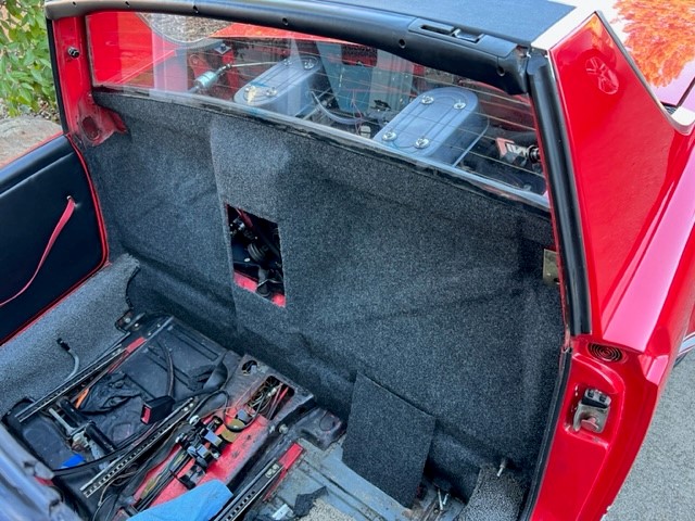

Posted by: Bullethead Oct 11 2023, 02:11 PM

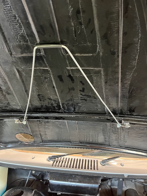

Did the insulation today... combination of one layer of Dynamat covered by Siless Liner, a closed cell foam sound and heat barrier. Doubled up, hoping for a tolerable cabin.
Also test fitment of the Perlon that didn't inspire confidence. I don't want to fuck it up so will likely bring in a pro to do it.

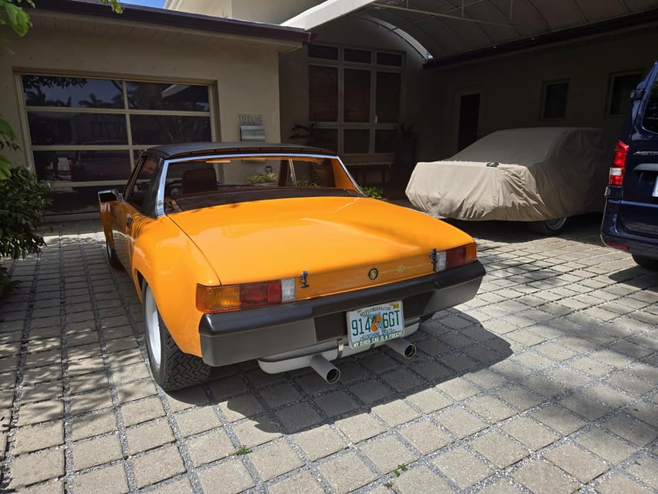

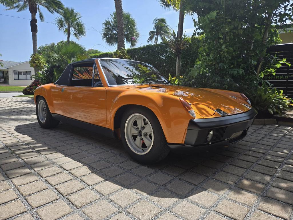

Posted by: Bullethead Jan 31 2024, 10:01 PM
Engine and gearbox are in...

QUOTE(Bullethead @ Oct 11 2023, 12:11 PM) *
Nice build!
I just did my own perlon, its not too bad just get it not backed. Start at the top and go down. Then the part that stretches over the firewall hump (middle) will stretch out. Nice thing about the perlon is if you do mess up you can cut out the wrinkle later. You cannot detect patches. Just don't over glue it so the glue comes thru.
One thing I will say is once it's done you can see any changes in the firewall that are 1/8" or bigger. But it's not bad though because you only see them at certain angles and the seats cover most of the view of the perlon.
Posted by: Maltese Falcon Feb 3 2024, 10:14 AM

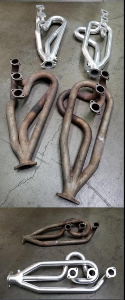

Pair of Proper 1.625" competition 9146gt exhaust headers coming your way
Posted by: Justinp71 Feb 4 2024, 12:53 AM
I will agree those headers are amazing, I have them and they make a ton of power smile.gif.
Posted by: BillJ Feb 4 2024, 07:51 AM
Marty equipped my car as well. Very well done.
Posted by: Bullethead Feb 4 2024, 03:53 PM
Posted by: Maltese Falcon Feb 4 2024, 04:30 PM
Thank you @http://www.914world.com/bbs2/index.php?showuser=2922 @http://www.914world.com/bbs2/index.php?showuser=15610 @http://www.914world.com/bbs2/index.php?showuser=11875 & many others for representing the World of exhaust scavenging with our brand !
Marty + the MSDS crew

Posted by: Bullethead Sep 19 2024, 10:52 AM
Sorry for the delay... this went on the back burner for awhile, as my wife got really sick with something called Polymyositis. Sucked for several months, but her treatment is going well enough that we're planning to do some car events and maybe a rally in Colorado next spring.
Anyway, the oil lines were slow going but thanks to the expertise of Brad @911Rennen and Marty's generosity, they are finally finished. Also completed the handbrake, solved the adjustment issue with a simple plate... they work perfectly.
So, engine and transmission are in, we might actually finish this thing before the end of the year.

Posted by: Bullethead Sep 19 2024, 11:28 AM
Handbrake cables location, simple solution that works great.
Posted by: Bullethead Sep 19 2024, 11:32 AM

Posted by: flyer86d Sep 19 2024, 02:16 PM
So what is the engine? It’s pretty!
Charlie
Posted by: Cairo94507 Sep 19 2024, 02:20 PM
Posted by: Bullethead Sep 19 2024, 02:31 PM
QUOTE(Cairo94507 @ Sep 19 2024, 04:20 PM) *
happy11.gif Me too... will post that when it happens. It's a twin-plug 2.8 built on a 5R mag case, S crank, cams and heads, 46mm Italian Webers, real Bosch dizzy. We lightened the compression to 9.3/1 so it'll be happy on pump gas. Probably gonna be louder than expected.
Posted by: Shivers Sep 19 2024, 04:08 PM
QUOTE(Bullethead @ Sep 19 2024, 10:36 AM) *
Sweet!
Posted by: Maltese Falcon Sep 19 2024, 04:45 PM
Looks & will sound Great ! probably not dB friendly at Laguna Seca biggrin.gif

Posted by: Bullethead Oct 16 2024, 09:46 AM
More detail of handbrake install. Thought we may have to modify 911 cables, but stock ones fit perfectly. This mod was way easier than anticipated, mounting plate for adjustment and a small bracket to keep the cables away from the headers.
Will also be wrapped with heat barrier.

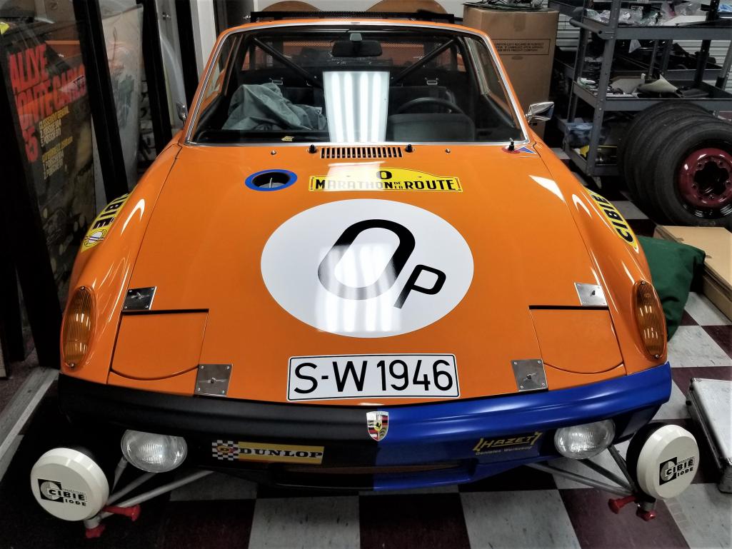

Posted by: Bullethead May 19 2025, 03:29 PM
All of the niggly bits are being completed, will post photos as the punch list is addressed.
Hit an unfortunate snag with the roll bar: factory GT roofs are bolted in place, I thought it would be nice to take the roof off occasionally.
So we need to modify the bar because the latches aren't accessible, not sure we'll get that done in time for Highlands next month. Stay tuned.

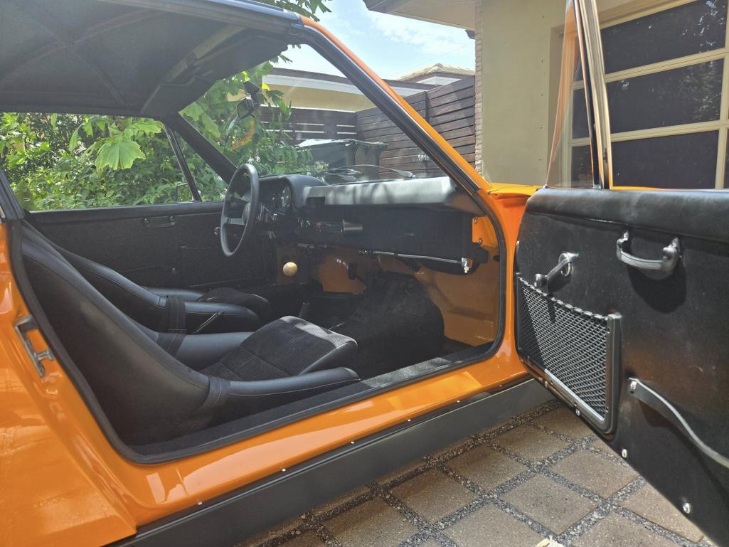

Door cards and rubber mats came out nice, will fit the Perlon next.
Had planned to make a box for the passenger door, but found these mesh pockets on Amazon for cheap so applied to both doors.
Posted by: Maltese Falcon May 19 2025, 05:06 PM
@http://www.914world.com/bbs2/index.php?showuser=11875 ...Russ, have your fabricator make these compound bends of the Left + Right ends on the top bar, a bit of work>> but I like it when the 914 tops can be removed. OE latches work with this design.
Posted by: Bullethead May 19 2025, 05:36 PM
smilie_pokal.gif Thanks, was just out for an evening drive and something similar jogged in my head. Moving the top tube inward a couple of inches will clear the latches, and the cross tubes can be moved down to accommodate.

I am using Chris Foley's (Tangerine Racing) GT roll bar. Test fitting seemed to indicate that there will be enough room for the rear Targa latches. Fingers crossed on that.
Posted by: Bullethead May 24 2025, 07:53 AM
Trunk is done, fancied up a bit with a Perlon mat. Restoring the jack. Installed Porsche crest, new wheel. Off to a four-wheel alignment next Tuesday...
Posted by: Bullethead Jun 5 2025, 05:47 PM
Both trunks are done and tomorrow the rest of the interior will be finished. Need to put some miles on before it's shipped to Highlands on Monday. More images then.
Meanwhile, the engine grill is high on the right as can be seen in the photo. Anyone have an idea of how to get it even? Feels like the springs are holding it up.

A question on the GT front hood prop: The springs on the one I bought from PMB are not strong enough to hold the prop against the inside pf the hood when closed. Did you have any issues with yours?
Posted by: morehills Jun 6 2025, 02:51 PM
I struggled with the same problem Tom. I wound the spring an extra time to get enough tension but it would pull off the bend in the bar, so I hacked a little cable clamp. Not the most elegant, but it works. John
Posted by: Tom1394racing Jun 6 2025, 05:35 PM
QUOTE(morehills @ Jun 6 2025, 04:51 PM) *
Thanks John
I figured that some type of clamp or clasp would be the solution.
Hey Tom, PMB's prop worked fine in it's OG configuration... but won't for a GT tank! It's symmetrical, and the GT tank has a fuel hose smack in the middle, so what works is asymmetrical. I made a new one using their springs and it's inadequate. Will re-do when we get back after next week in NC.
