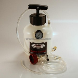

So, with excitement, filled the brake fluid. First, I bled the left front lower bleeder, gently pushing the brake pedal. Filled fluid again, and used the Motive Speed bleeder. (which I thought is impressive, btw.) Right rear, bottom, then top bleeders, worked my way around the wheels in the correct order. (I should say here, I have triple checked the rear brake pad clearance, and it is spot on) I did this bleeding process about 4 times, overall.

How much pressure in the motive bleeder?

I always struggled to fully get all of the air out of the lines until I started using the Motive pressure bleeder at the reservoir to push fluid through the system paired with speed bleeders on each caliper. (The Motive alone wasn’t enough)

The Motive I was using first at 5psi, then bumped it to 10psi. Read some worries about going higher.

Regarding the motive, I just did my whole car at 15psi no problem. With the exception of your reservoir, the brake system sees waaaaay more pressure than 15psi. So unless you have a leaky res, those “worries” are unfounded IMO.

Use Motive bleeder and vacuum on the bleed screws (Mighty Vac or HF pneumatic vacuum bleeder. You want lots of brake fluid velocity to pull along entrained air bubbles . This is accomplished by having a high pressure differential between inlet and outlet. i.e. pressure over the reservoir combined with vacuum at the bleeder. Again - use physics to your advantage.
