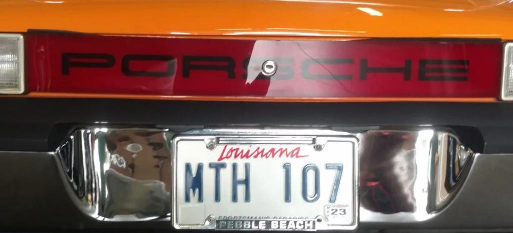

Posted by: JamesM Aug 6 2022, 04:31 PM
QUOTE(wonkipop @ Aug 6 2022, 01:49 PM)
on + side current seller is not trying to hide front right corner replacement.
(or more total front replacement???)
conveniently concealed in older BAT ad by not going there with photos.
Im wondering if they just didn't notice it as they did seem to strategically leave out a lot of other standard shots (that were in the BAT auction) that give away the history/condition of the car. (battery tray shots from the BAT auction showing clear overspray and weld repairs to the rear trunk hinge piviot, anything showing the size of the engine that was also not mentioned in the ad, etc)
Given their careful wording in the ad and selective representation of the car in the photos I was curious if the dealer themselves were involved in the initial forgery or if they are just passing along a bad deal...
So my wife reached out to them with interest in the car
Long story sort still dont know if they are part of the fraud or just got caught in a bad deal, but they do seem to be very careful about directly incriminating themselves while at the same time hiding the reality of this car. They answered my wifes first question about the motor size and did state it to be a 1.7 but follow up questions around condition/history and they just outright stopped talking to her.
Notice how they dont directly state anything in the ad text itself. rather just post pictures of (most likely fake documents) of someone else saying how original and amazing the car is. SUPER fishy
i suspect they are looking to drop this on a sucker sight unseen who doesent ask questions.
what is most amusing is that pebble beach organisers didn't have a clue back in 99?
Given all the other BS and forgery surrounding this car I have to wonder the legitimacy of that claim as well. Also worth noting only the BAT ad states:
"The seller reports that the car was invited to participate in the 1999 Pebble Beach Concours d’Elegance, and a badge affixed to the dashboard is depicted above."
Which again was just the statement from the seller and the current seller doesn't mention that at all. Also that was 23 years ago, the car could have been in perfect condition back then? Who knows. My guess though is that the badge on the dash is just more added flair to try and represent this car as something it is not.
because they dont seem super hard to come by
https://www.ebay.com/itm/204015680353?hash=item2f80483b61:g:VsMAAOSwrCVe~BZL&amdata=enc%3AAQAHAAAA4KzfmQ6MtxeddGrrM1TO1PE43FlTNdYdnDpOYVY7AigHfwiU11ZEYuVt1NuA%2FFjQUGdMpY2kgpaIXZT04uW4BI7lj0s%2B21GzOAme4BZZSTa6dCHsSeIhruJyjfLC%2Fj%2ByPbCgbZI43HPwEgR6YMPecNCcKmwK%2FNFrc6Rnt5ui0T4mq2lNLdgDkW2Cwxabtz868SoPA5RnXwt4qIQifFzNM3yuA8A9jacbw7GzE%2FVlOYgYnfPz3BmHtUXKTzzCV279F07fReD5iS7fhGPdHIdn35Hu6%2Bj6mfAfhwKiQOfKZYQb%7Ctkp%3ABFBMhou41M5g
Unless someone out there has documentation or photographic evidence of the car being there. I was unable to find anything to substantiate the claim.

Posted by: jrmdir Aug 7 2022, 11:14 AM
Yes, that's not a '73 speedo - should be 150MPH. Also, FWIW, '73s had silver PORSCHE lettering on the engine grille.
I was hesitant to think someone went to all the trouble to forge documents, but there's just too much wrong - including the way "Dick Barbour" was always inserted with a different font - even in the welcome letter. So George Duncan had so many new members to welcome (in 1973) that he pre-typed a supply of welcome letters and had them on hand to add names & dates? Using a different typewriter. Also, suspicious amount of extra info re: the Chrome Plated card holder and where you might put it.
But what finally convinced me is the proportional spacing.
Ron

Posted by: aturboman Aug 7 2022, 04:03 PM
QUOTE(Aerostatwv @ Aug 6 2022, 09:26 AM)
Isn't that a 120mph 72 or older speedo?
Yes, and lots of other inconsistencies for a 1973.
Posted by: wonkipop Aug 7 2022, 05:23 PM
QUOTE(aturboman @ Aug 7 2022, 04:03 PM)
not least being dick barbour speciality package item - rear reflector.
the rear reflector does not appear as a porsche feature until the 74MY G series 911.
commencing production 08/73.
alleged d b window sticker is dated 2/73.
the car is a 04/73.
