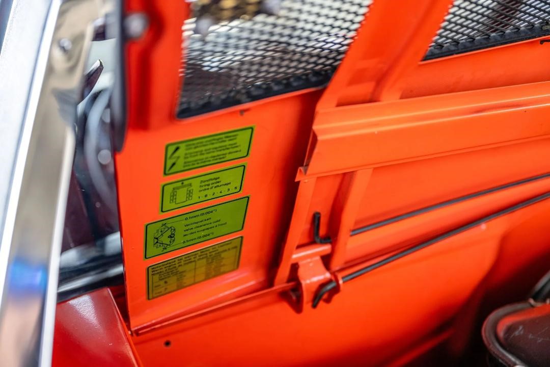

I am restoring a 1971 six and I hope someone can help me with a question about the paint color on the torsion bars that hold up the engine cover. The ones that came with the car are painted black and this appears to be the original color. However, I have seen some sixes with these torsion bars painted body color. Does anyone have a six with original paint that could verify the paint color?
Posted by: jrrobertson Dec 21 2022, 09:41 AM

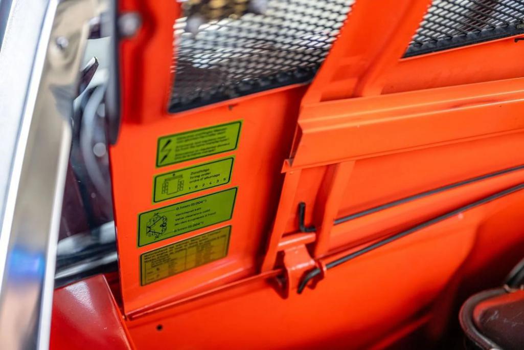

Sorry, the picture of the black torsion bar got added twice. I am new at this.

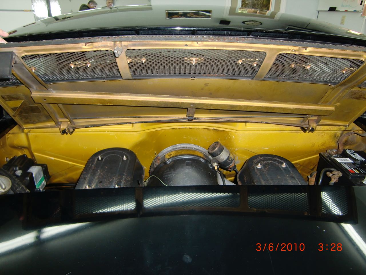

My '71 Six, which was gold from the factory, had the black torsion rods for the engine lid. That is the way they came. Though it looks like at some point they got a bit of overspray on them, they were black.
Additionally, engine lid torsion bars on a 6 were smaller/thinner than on a 4 as the 4 cars had a rain tray which added weight. The 6 never came with a rain tray so lighter rods were installed so the lid would not fly open and bang the rear of the targa bar.
When we repainted my car we did them in body color. In hindsight, I should have done them in satin black. Maybe I will address that in the future. beerchug.gif

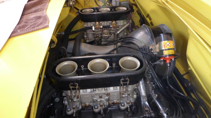

Good morning, just wanted to say something which might be considered contrary to Cairo's advice but having owned my 6 for 50 years and I know for fact that my engine cover torsion rods are body color Canary Yellow. My car is a1970. Never discount the fact that changes were made between the years. Trunk torsion rods are also body color too. Besides yours look much nicer body color.

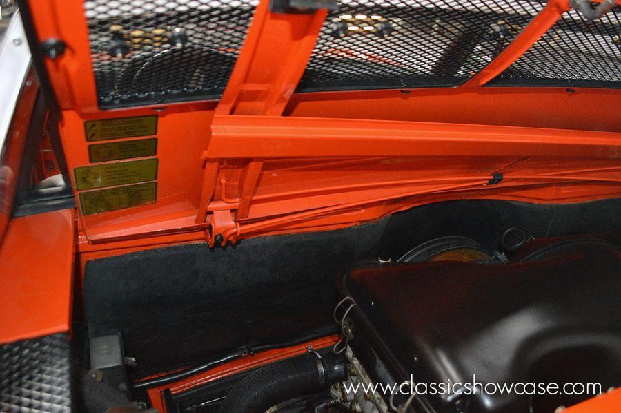

Posted by: 914043 Dec 21 2022, 02:57 PM

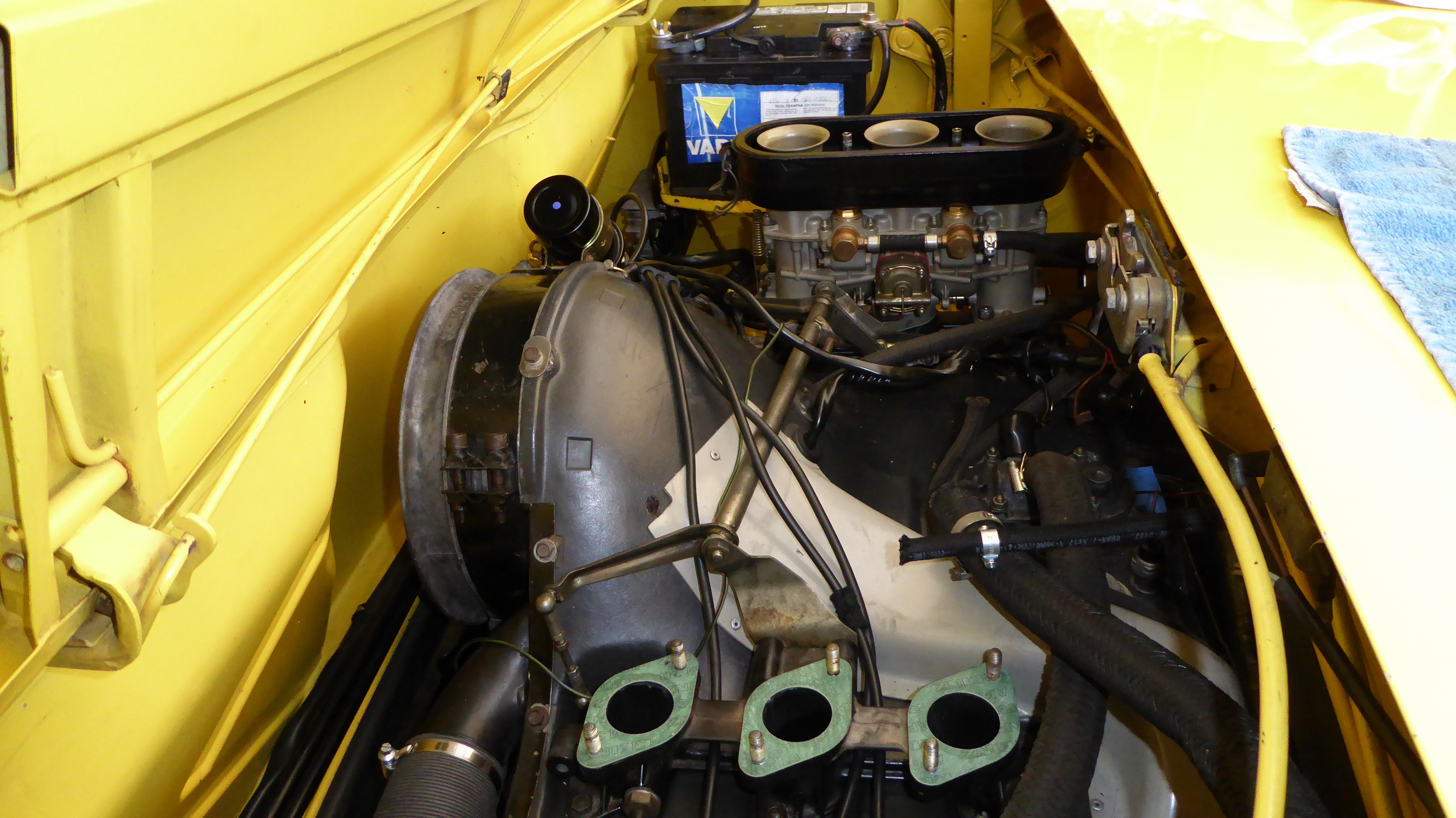

Thought I might include these as a point of reference.Attached Image Attached Image

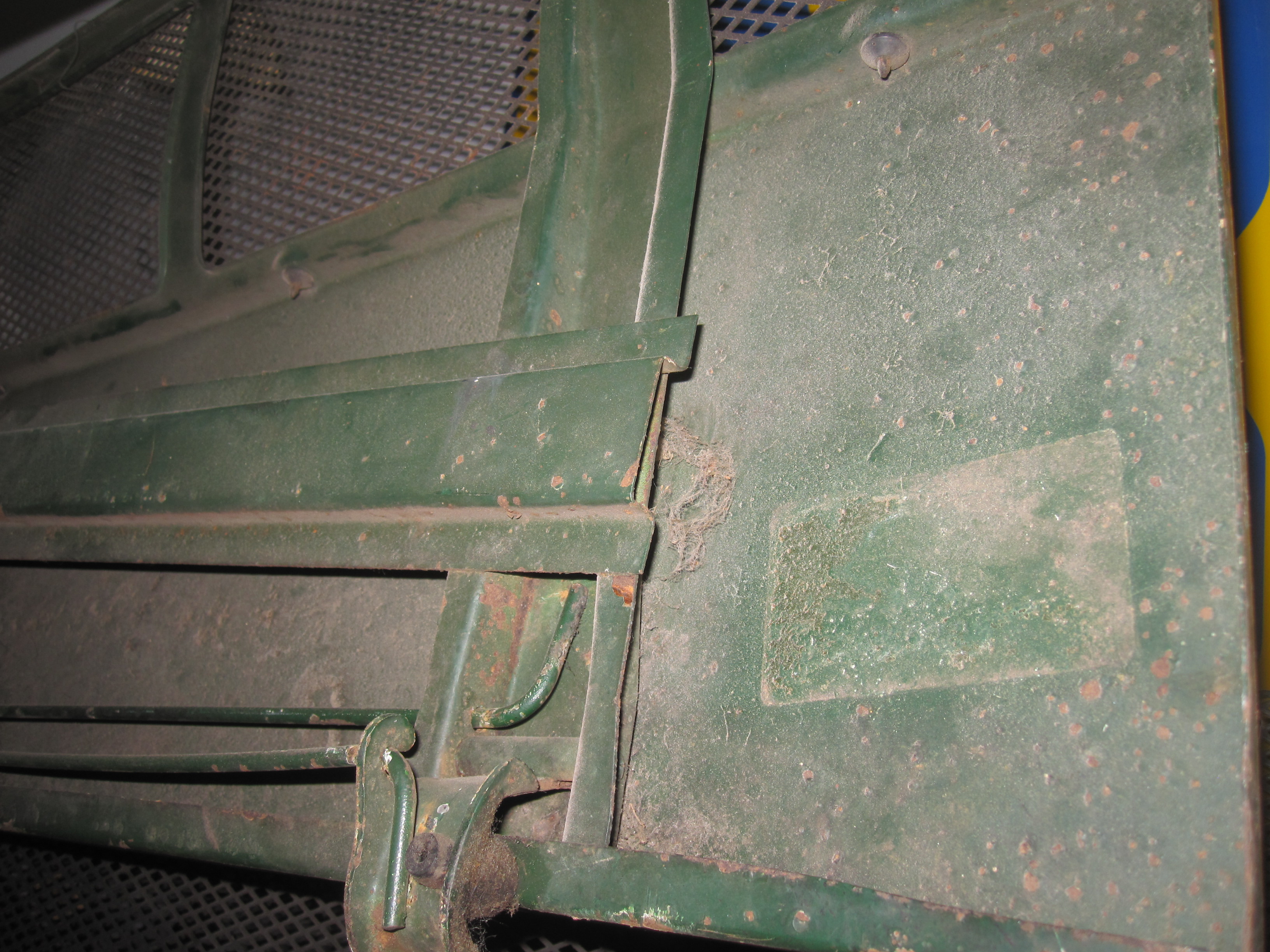

Posted by: fixer34 Dec 21 2022, 05:34 PM
March '70, factory -6.
Both deck lid and trunk torsion bars are body paint color, in my case, Irish Green. per another thread, the brackets and nuts holding the trunk torsion bars are also body paint color.
Posted by: rgalla9146 Dec 21 2022, 06:15 PM
Original 6 engine lid. Body color torsion bars. Oh, 1970. Only had '70s
