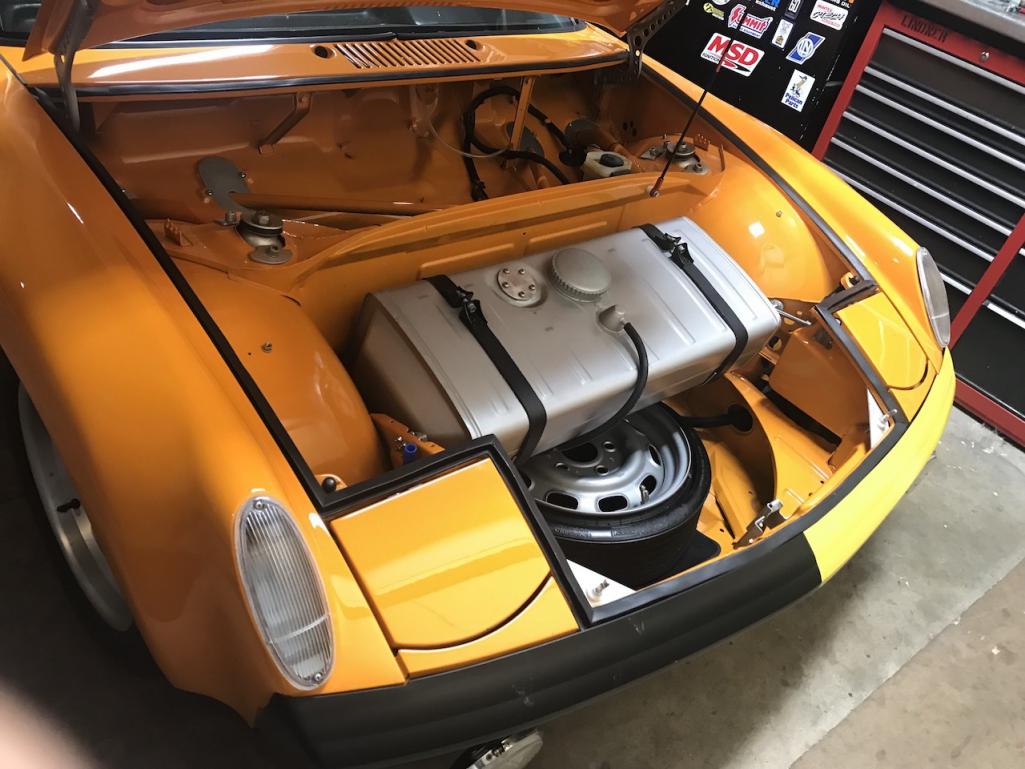

Posted by: mlindner Feb 3 2023, 05:18 AM
914racer, I went this direction so roll cage could go to the suspension points.

Posted by: gnomefabtech Feb 5 2023, 11:47 AM
I don't want to be one of those safety know it alls, but I'm not sure it's a great idea to move the tank to the crumple zone of the car like that. Is that an FIA cell with foam and a bladder etc?
BTW the build craft of that car is really beautiful.
