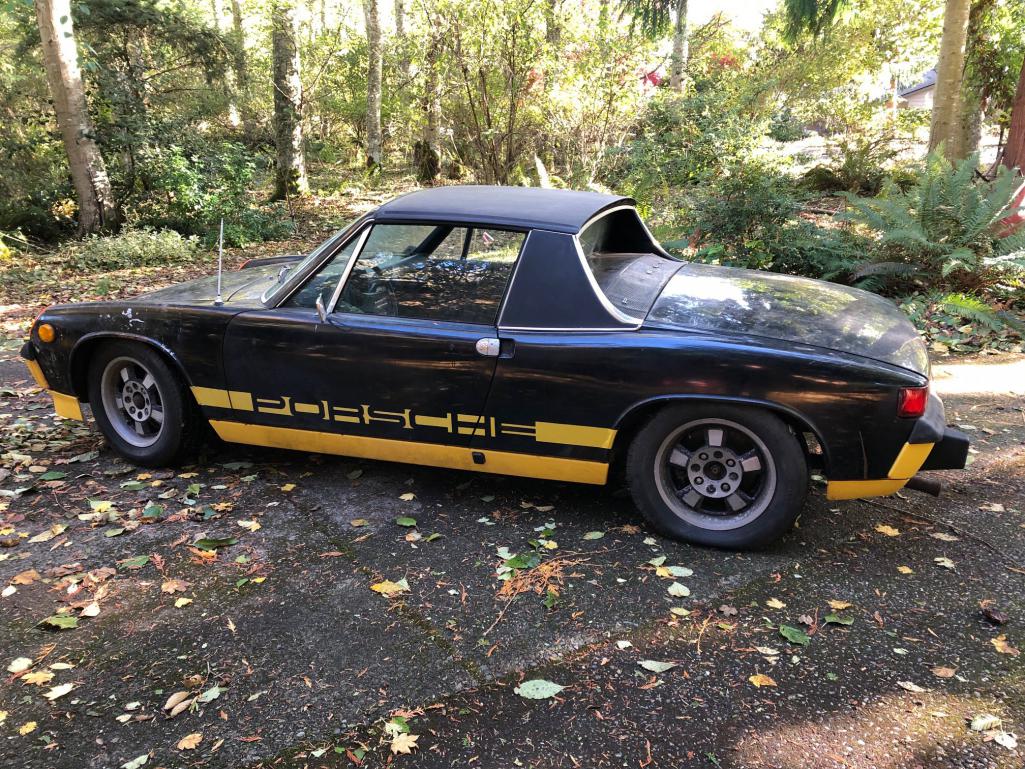

Posted by: KELTY360 Feb 5 2023, 08:01 PM
So it's time to get off my ass and deal with this rare gem that has wandered into my garage. Much to the skepticism of some, it's an original 21,000 mile LE that was parked by the original owner in 1988 and didn't move til his heir's sold the car and the new owner moved it from Honolulu to Pt. Townsend, WA in late summer 2022. My somewhat accidental purchase is documented in a previous thread: http://www.914world.com/bbs2/index.php?showtopic=361903
For those who don't know me, I'm a longtime 914 believer since purchasing a Sunflower Yellow 1.7 brand new in 1973. I've since owned a variety of these little cars, currently holding a '74 2.0 and the LE. I've also encountered a couple of major oral surgeries over the last year that have put me in a state of slow recovery that leads to my personal resurrection. I didn't really intend to buy the LE but that ship has sailed and I'm trying to bring it back to life for my own resurgence, with the help of some friends of course.
The car is very solid and straight with minimal corrosion, as verified by @http://www.914world.com/bbs2/index.php?showuser=2105 and @http://www.914world.com/bbs2/index.php?showuser=3013 . My plan at present is to get it sorted out mechanically and some cosmetics, without performing a complete restoration. I do not plan on keeping the car when the plan is done. So, anyone who's interested in a very original, documented and compete LE is welcome to contact me. In this thread I'll be posting a list of parts needed and pictures and descriptions of work planned or completed.
I'll end this long post with an obligatory pic so I don't get the dreaded TTIWWP emogi. Many more pics to follow as I progress.

What a great find! Sympathetic resurrections take patience but the results are so rewarding... watching with interest.
Posted by: Beach914 Feb 6 2023, 08:37 AM
Can't wait to see the progress! Looking forward to lots more pictures.
I like that you will keep it as original as possible!

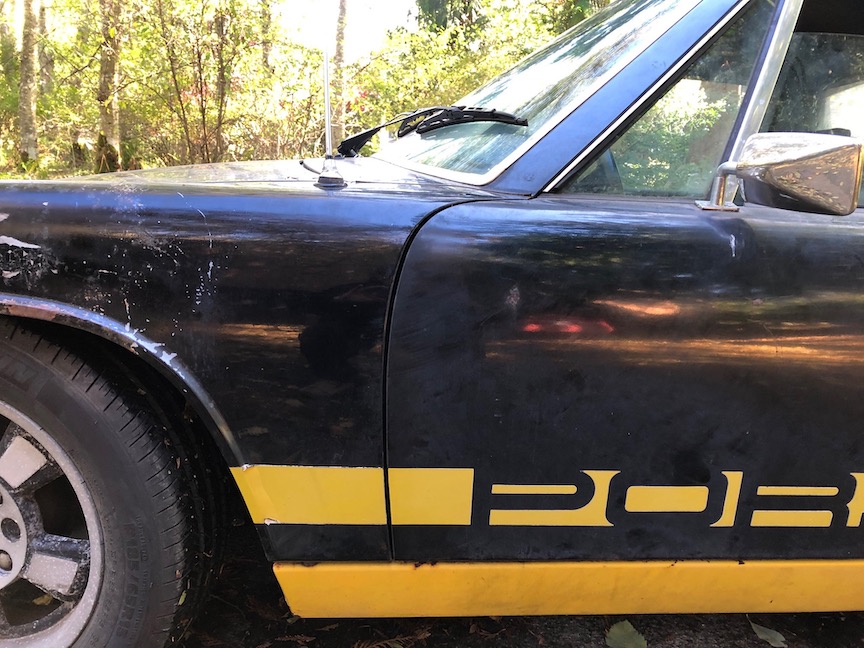

Congratulations!!! Great find as this LE survivor appears to have "good bones" and yes, the original VPC front spoiler.
When I had the yellow accents repainted, Mark at Eurotech Bodywerkes found the correct Sunflower Yellow paint listed with Glasurit as Summer Yellow with the same paint code (Sunflower Yellow became Summer Yellow for the 1975 model year). And the same mix was used by the vendor who restored all five Mahle wheels. We had the Porsche script for the sides custom made to a paint swatch.
Your side script seems to be mounted a little high. There are actual Porsche specifications for the location of the script and I think I might have seen them on Jeff Bowlsby's site.

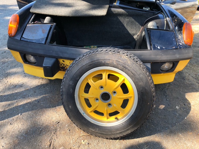

looks like the spare still has the o g dunlop SP mounted on it.
speaks volumes.
good luck with the both your resurrections.

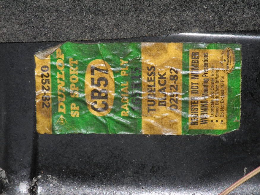

Posted by: KELTY360 Feb 6 2023, 07:49 PM
QUOTE(wonkipop @ Feb 6 2023, 04:18 PM)
speaks volumes.
Good eye! 165R15 Dunlop SP57, Made in Germany. Found this sticker firmly attached on the back wall of the spare well. Probably put on at the factory, although it might have been applied at the dealer. The Mahle on the spare also has SP written on the back of the wheel.

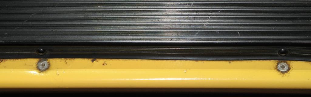

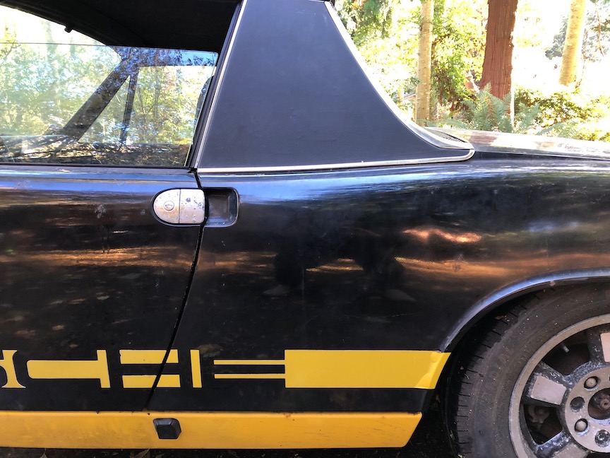

A couple of clarifications. THis appears to be an original finish car. Everything is original.
Great to see the factory spoiler which was not made by VPC. VPS made an afermarket spoiler emulating the factory spoiler.
The side stripes look original like they have been on the car for 49 years. On my original paint BB they were also mounted high like that. As I understand it, the stripes were mounted on the dealer lot (assuming the customer did not reject them) because the cars shipped coated in cosmiline for the ocean voyage which would damage vinyl decals, so the side stripes could be mounted in any number of ways. The package o aftermarket stripes that dealers sold over the counter has mounting instructions, but that does not mean the lot boys followed them.

@http://www.914world.com/bbs2/index.php?showuser=104 Just to be clear, are you saying that the sail panel vinyl and accompanying britework is stock on this LE? I didn't realize that any LE had either of these features. I also thought the two rear trim pieces were supposed to be black.

No, Im not saying that about the Targa vinyl and bright trim. They were added along the way and are a previous owner modification, just like the Riviera wheels
What I am saying is that unless a full resto would be undertaken, some things are too hard to change back and the original patina would be lost. Sometimes its better to just leave unoriginal things be as they are. Change the wheeels - sure, easy. Leave the Targa vinyl and buggered paint for a full resto in the future.

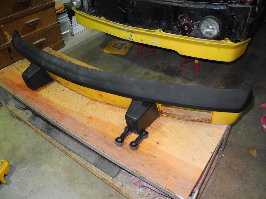

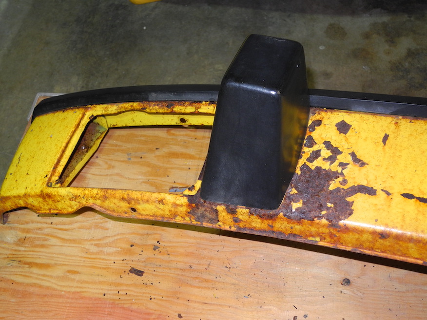

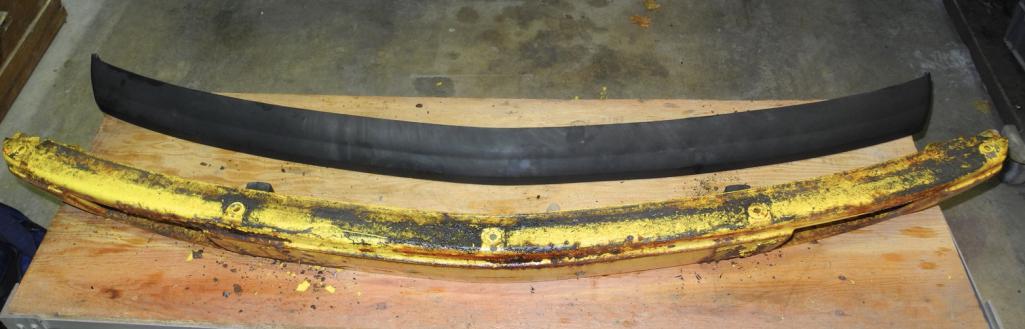

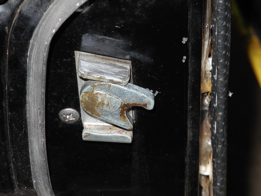

Posted by: troth Feb 9 2023, 02:48 PM

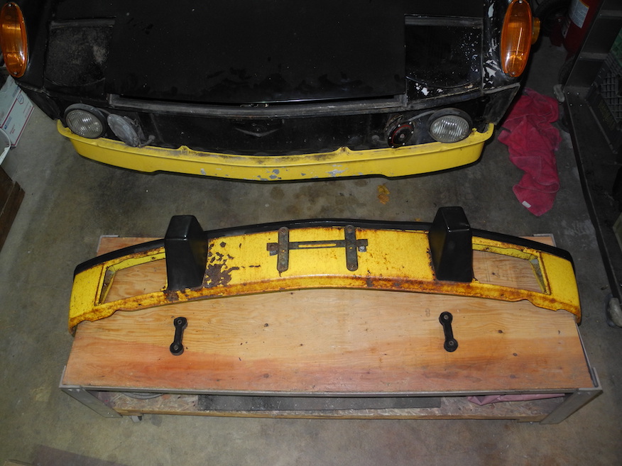

Seems to me you could very carefully cut the nut off with a dremel without damaging the threads so you can save the bumper top in case that’s what you decide. Although it might look silly with a fresh painted bumper. Definitely want to stop that rust before it gets worse. I’d be surprised if there isn’t some Swiss cheese behind the bumperettes after blasting.

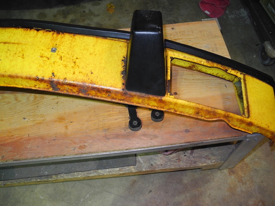

Posted by: troth Feb 9 2023, 02:52 PM
Looking at the pictures it might not even be worth saving that bumper. Paint makes it easier than chrome, but it will require work either way. I’d lean towards putting it back on and driving as is. Source a solid core bumper and paint it when you’re ready. Probably for less than it will take to repair that one. Good news is the front clip looks great.

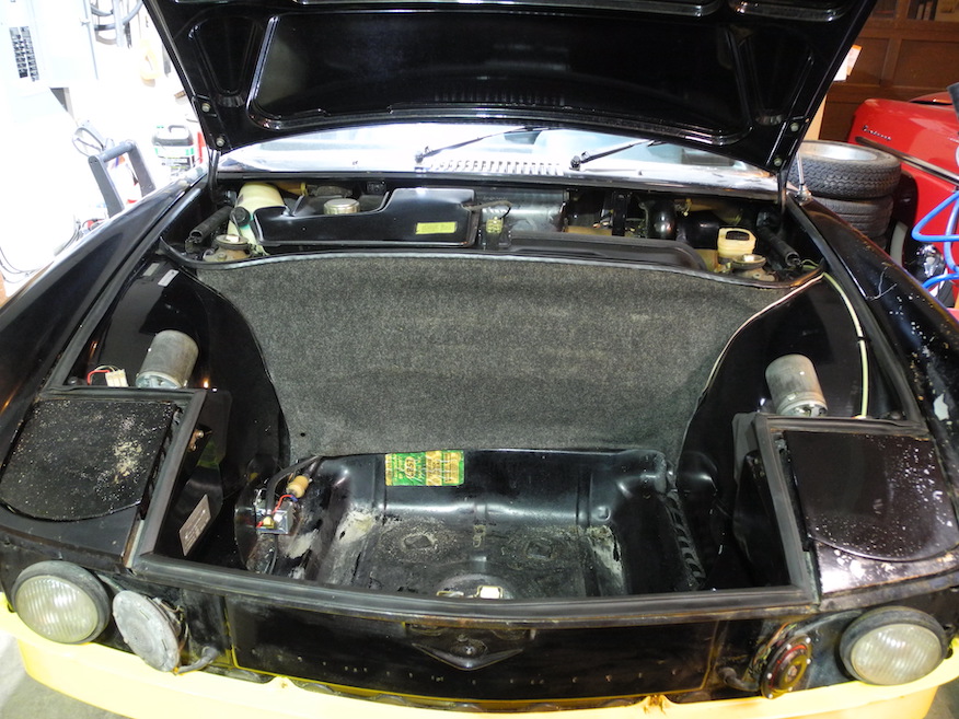

@http://www.914world.com/bbs2/index.php?showuser=5344 ..............and @http://www.914world.com/bbs2/index.php?showuser=104 .
i just noticed something in the photos above.
the horn is on the right hand side front.
and.......my 74 1.8 has it on the left hand side.
am pretty confident mine is original. 99% confident given the car.
and i'm thinking this bumblebee also might be very original.
so........did they change the position of the horn in 74?
mine is end of jan 74 build date.
i'm thinking of this in the context of all the chaotic changes along the way we have discovered with 74 model cars.
or did LEs have twin horns and one is missing?
i know you know the answer to this already mr. b!
Posted by: JeffBowlsby Feb 12 2023, 12:39 AM
Dual horns on LEs, infact all 74s I am prettry sure, at least the harness supports both horns. This DR side horn has been replaced.
Posted by: JeffBowlsby Feb 12 2023, 12:42 AM
Posted by: wonkipop Feb 12 2023, 12:43 AM
QUOTE(JeffBowlsby @ Feb 12 2023, 12:39 AM)
thanks mr. b
i feel sure the lowly 1.8 of which i am the owner did not get the special "duwal" autobahn blast units you describe as coming standard on the LEs you blokes own.
i have only a single unit and i am fairly certain the original owner was not the type who liked to customize in order to be a loud american.
but that does indicate what is going on in above photos.
ah yes i am seeing that the lhs blast unit is black and not an original roadrunner "meemp meemp" type unit like the one on rhs which is like my single unit from the wile e coyote era.
Posted by: KELTY360 Feb 12 2023, 08:17 AM
QUOTE(wonkipop @ Feb 11 2023, 10:23 PM)
Correct. I believe the horn on the left side was replaced when the fender needed repair, which was poorly done at the Porsche dealer. I have found the correct horn in the spare well and will be testing it to see if it operates. Otherwise, I'll be looking for one in the classifieds.

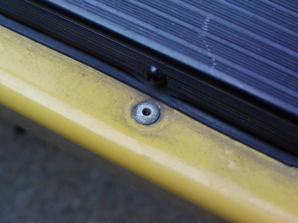

Nice car. Were it mine, I would pull the rocker covers and see what's what. If nothing else, I would want to clean everything up and get any/all the dirt and more out of there. Additionally, if there is rust, I would want to know the extent so I could decide how best to address it.
As for painting the yellow bits, I would shoot them all at the same time- even the rocker covers.

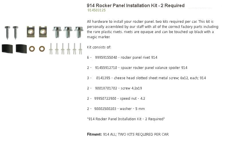

+1 most buyers would want to know that the rockers are solid, and the new plastic rivets are identical to the originals. I would also pull the script off and after having the minor parts (door and headlight cover) repainted, would wet sand the car and buff back the paint. I suspect that you will be surprised how well that single stage will come back.

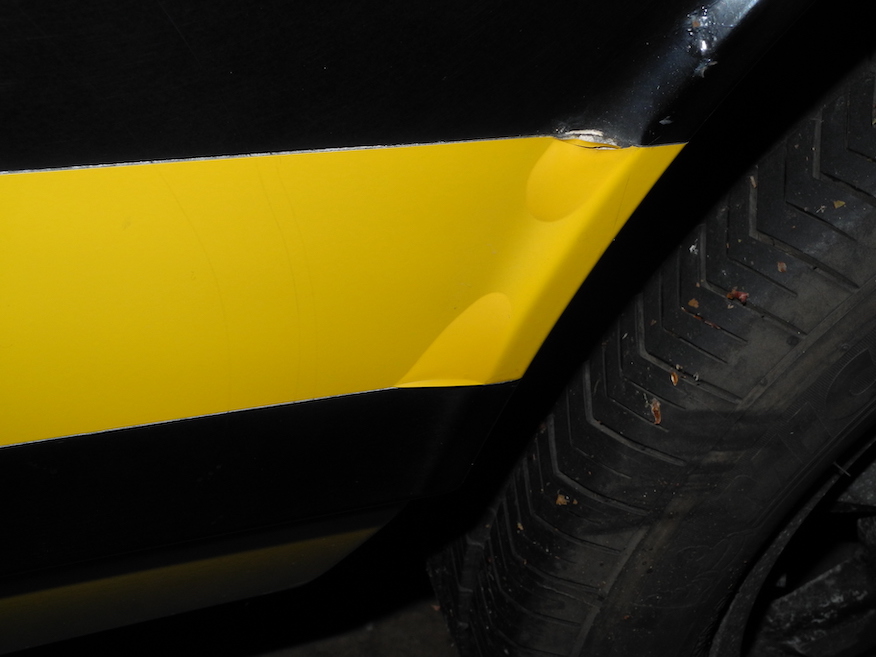

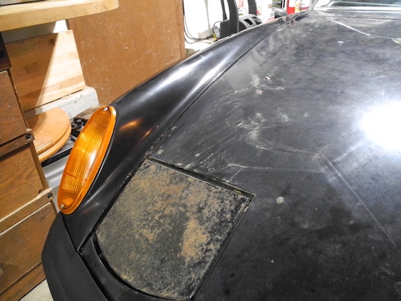

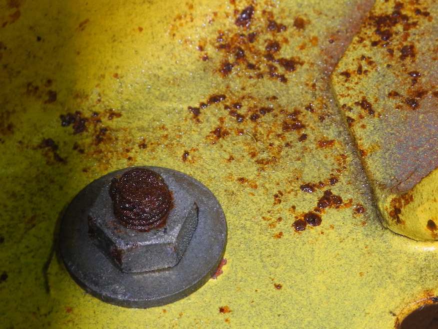

Posted by: KELTY360 Mar 6 2023, 11:28 AM

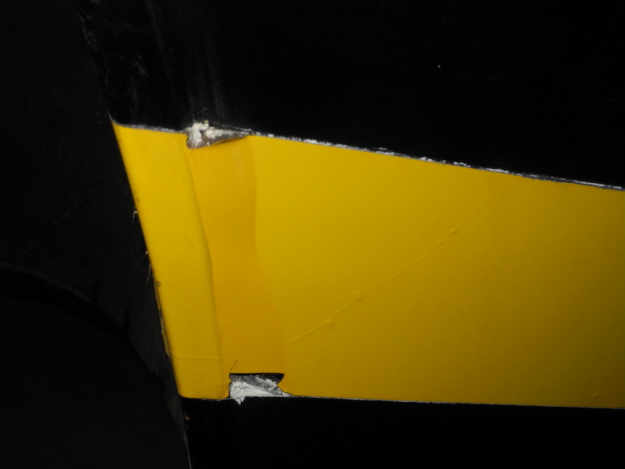

In true slacker fashion, I haven't updated my progress in the last few weeks. Not only has it been hectic with medical appointments and an epic road trip to Colorado, but I can't seem to get my photo app to perform the way it previously did.
I have successfully removed the bumper top with all studs intact. Huzzah!
I've completed the first phase of cleaning the interior, which consisted of clearing out all the debris from 35 years of sitting. That also included visors, driver's door storage box, coco mats, busted inside mirror and assorted screws, bolts and fuses left in the console storage box.
I've taken pics of the aluminum rivets in the rocker covers and the newly separated bumper top, but alas I can't seem to post them at present. I know, I know, if there's no picture it didn't happen. You'll just have to wait til I get it figured out.
Trust me...lots of foolish people have.

Posted by: 914werke Mar 6 2023, 11:37 AM
QUOTE(KELTY360 @ Mar 6 2023, 09:28 AM)
I've taken pecs of the aluminum rivets in the rocker covers and the newly separated bumper top, but alas I can't seem to post them at present.
Ok call me foolish if you will,

Posted by: KELTY360 Mar 6 2023, 11:50 AM
QUOTE(914werke @ Mar 6 2023, 09:37 AM)
@http://www.914world.com/bbs2/index.php?showuser=7418 George care to chime in?
Ok, you’re foolish, but I promise it’s true: bare aluminum rivets on both sides holding the covers on. Strangely, the threshold plates are secured by Phillips screws, but they show signs of being turned at some time. Once again, pics to follow.
Posted by: JeffBowlsby Mar 6 2023, 12:10 PM
QUOTE(JeffBowlsby @ Feb 12 2023, 06:58 PM)
Nothing precious or sacred about common aluminum rivets, I encourage you to R/R the rivets .

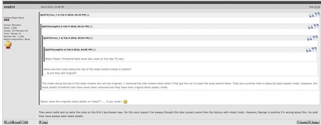

Mill finish aluminum rivets were factory stock on the 'rocker panels'.
NOPE

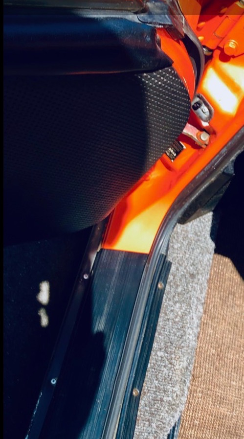

Ok Rich, tell me what you know. What I know is that the photo below shows aluminum rivets (with a peculiar head shape not available in todays marketplace from any place that I have found anyway) in the 'rocker panels' and black plastic riviets in the threshold plate as correct for a 1974 car. i *think* the clear plastic rivets are for 1973 and earlier cars.
Car acquired with ~40Kmi from the orig owner who told me the rocker panels had never been removed. VIN 4742914536

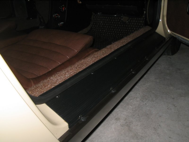

Posted by: KELTY360 Mar 6 2023, 08:52 PM
QUOTE(JeffBowlsby @ Mar 6 2023, 10:10 AM)
NOPE
Mine look just like Jeff's:
Question?: If there is no precise replacement for the rivets, what is the preferred fastener?

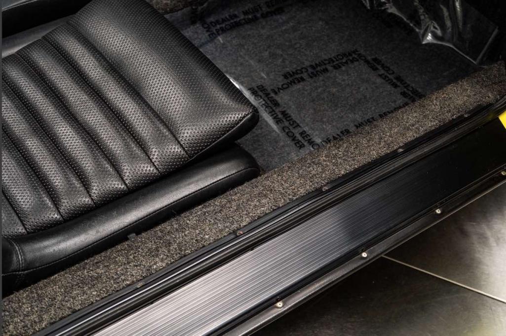

Posted by: 914werke Mar 6 2023, 09:10 PM
The OE fastener is the Plastic rivet also used on the threshold.
I looked for an isolated image I may have taken of my car but didnt find one.
Id take one post it, but car is remote.
Perhaps this will help -

mr b will be right about those rivets. he is rarely wrong, and even his speculations/guesses are pretty good.

not one i can answer with certainty as i took the rockers off my 74 30+ years ago to clean in behind them and check out the sills/jack points. have alum rivets now same as kelty360. i can't really recall what was on the car back then. too long ago.
what i can say is when it comes to rivets or rust, i know which one i could care less about.
black plastic thresholds have never been off.
either a black plastic rivet or a black coated alum rivet that fixes those on.

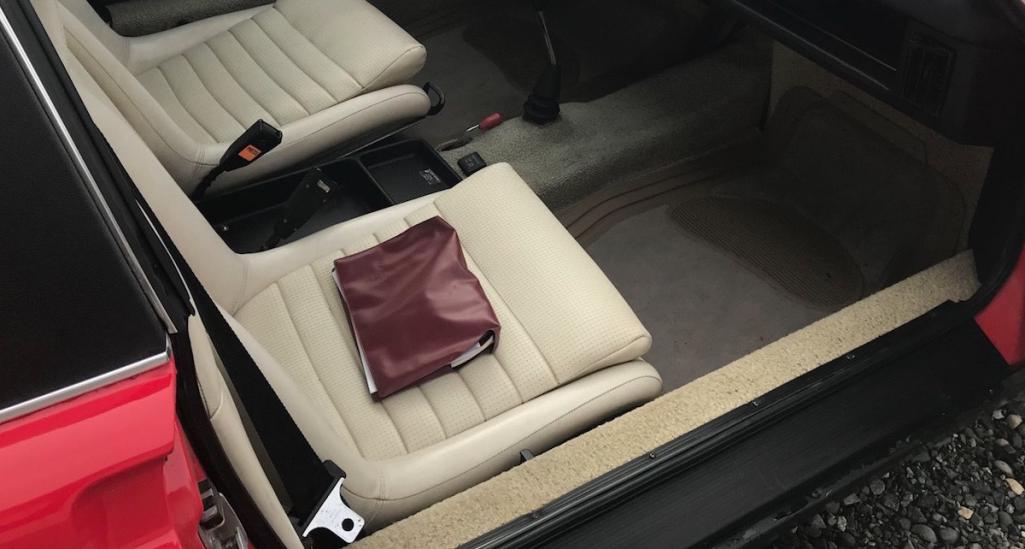

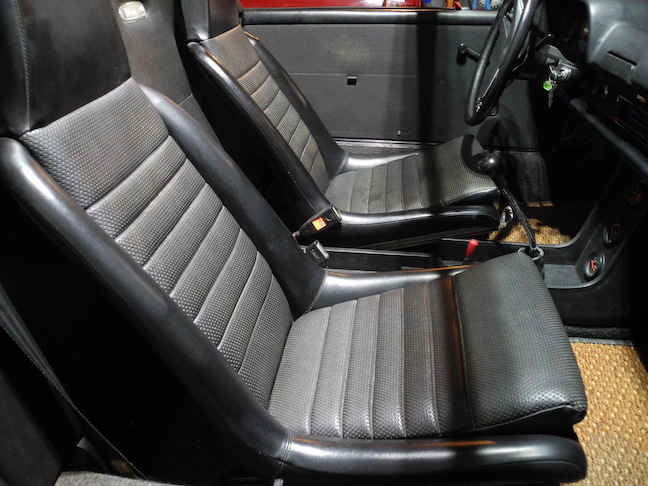

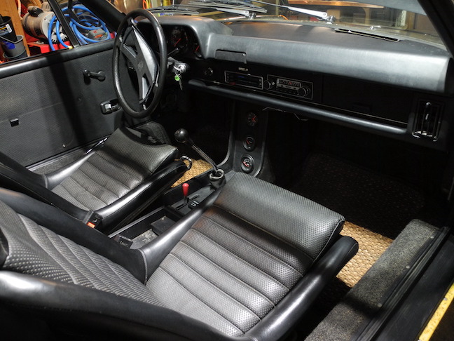

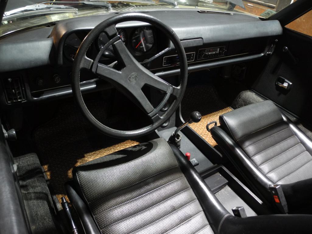

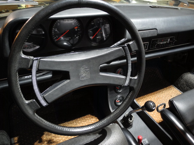

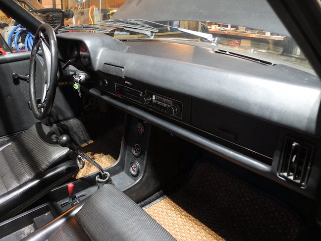

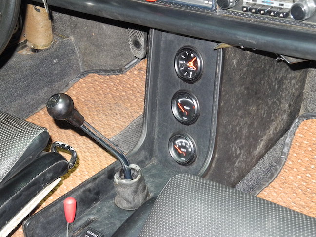

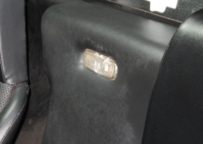

@http://www.914world.com/bbs2/index.php?showuser=5344 - that interior is minty. steering wheel factory fresh!!!!
i've got
exact same cocoa mats in mine (but a little more worn
that particular "natural" brown color = the fashion item back then?
also remember my interior light when i got it back in 89 had the same melt droop in the middle top. someone had fitted the wrong bulb. too hot.
pretty funny.

i think you are on to something mr. b
its maybe an extensive change in mid 73 when they change the inner threshold plate from alum to plastic?
i've done a bit of searching back through the L jet files i have which are all 74 and 75 1.8s.
i know this from my own car (and PET data).
when the thin inner most threshold piece was changed to black plastic the screws changed too. the screws received additional cupped raised washers to help with distributing the load and keeping the plastic straighter. very few cars seem to have the correct screws surviving. i have the original screws on mine for those very inner most thresholds and a few of the ones i have on file have them as well. that helps with knowing you might be looking at something trustworthy throughout sill area. the earlier cars pre mid 73 just have a screw into the aluminium earlier inner most threshold.
they changed the outer sill threshold piece to plastic at the same time and the rivets in that changed to black. all the examples on file match mine.
they had been white in the pre mid 73 cars to fasten the alum threshold.
i looked up my first addition restorers guide to authenticity.
its getting a bit old now (out of date?). i don't have the more recent edition.
down the back on page 78 is a photo and description of the earlier alum threshold. also shows rocker panel. the rocker panel is held on by the same white plastic rivet. so i believe
@http://www.914world.com/bbs2/index.php?showuser=453 is right about that.
when it comes to earlier cars.however there is no detail or description on the post mid 73 in my edition of R G.
but---everything i have on file from L jet research which are in some cases drawn from BAT archives has silver alum rivets fixing the outer sill rockers. i think i have got at least two original examples i would trust to a reasonable degree on that. they could have been black rivets that the paint has worn off. but they are silver now which indicates alum not plastic.
it could be interesting. they might have changed the rivets in the outer rockers from mid 73 on. your example you have posted where the owner assured rockers had not been off and the rivets are silver alum seems to agree with everything i have collected on file.
i can't say for certain what i did back in the early 90s when i took the covers off was a like for like replacement. but i used to be fairly careful with detail like that and i feel sure i would have replaced what was there to match. but who knows.
i guess the doc will have the full answer.
but there appears to be something in the differences being brought up and contested.
@http://www.914world.com/bbs2/index.php?showuser=453 is definitely correct about the early cars pre mid 73.
@http://www.914world.com/bbs2/index.php?showuser=104 may well be correct about the later cars post mid 73. something different appears to be going on there.
a 74.
not mine but identical to mine.
from L jet archive. a pretty original car in all respects.
not a restoration
correct inner threshold screws and seems to have alum rocker rivets. look silver.
matches
@http://www.914world.com/bbs2/index.php?showuser=5344 's rockers and your example of a 40,000 mile car.

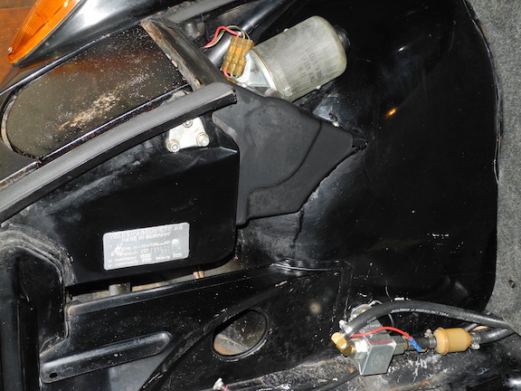

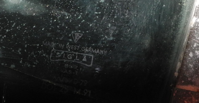

Posted by: KELTY360 Mar 8 2023, 06:38 PM
QUOTE(wonkipop @ Feb 11 2023, 10:11 PM)
given it is so original whats the windscreen in it.
mind taking a photo of that etched data down in the bottom lhs?
there is a little thread going in the originality section covering original windscreens for 914s. am betting this baby is a good candidate for having one.
The windshield looks to be original but this is the best pic I've managed so far. I'll keep trying to get a better one. The garage lighting has to be just right.
Posted by: wonkipop Mar 9 2023, 04:22 AM
QUOTE(KELTY360 @ Mar 8 2023, 06:38 PM)
yep thats farken original for sure.
whats the date on the build of this baby.
all good data. i only give a sh$t about 74 1,8 914s. but i will make an exception for a bumble bee or a vanilla icecream with orange sauce.
get a good shot when you manage it and post it but don't fret. glass and reflections.
