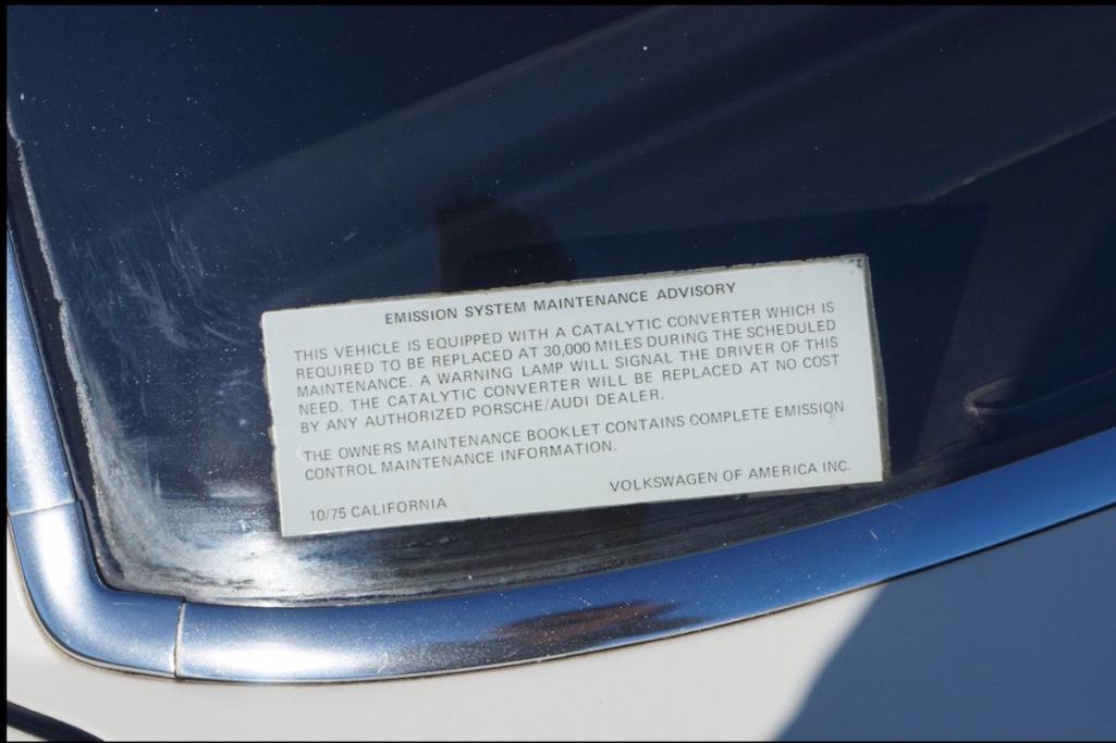

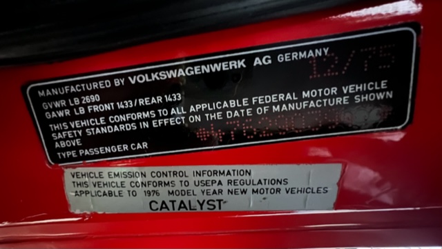

Still have the drivers side clear windshield label? That may tell if you if its a CA model or not.

You can also check the VECI label (vehicle emission control information) and it will say "This vehicle conforms to US EPA and California regulations applicable to the 1976 model year new motor vehicles."

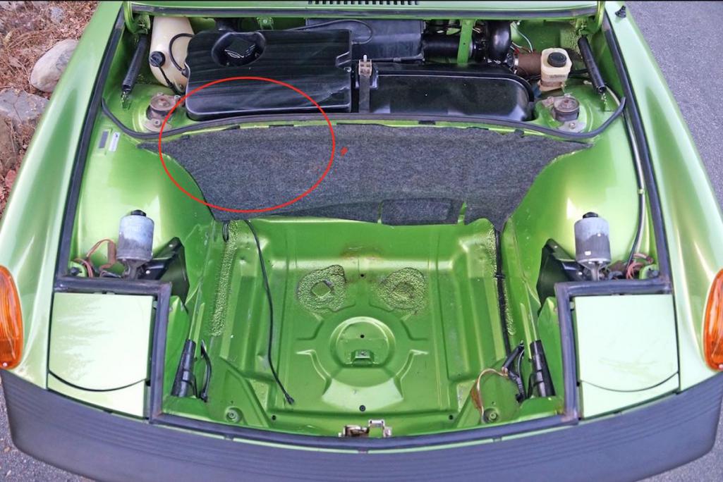

QUOTE(rgalla9146 @ Mar 13 2023, 05:24 PM)
A 1976 California car will have a EGR lamp on the dash and a EGR reset box under the
passenger footrest
and something like that on the drivers side in the rear trunk. If you have these and they are not plugged in to something it's a 49 state car.

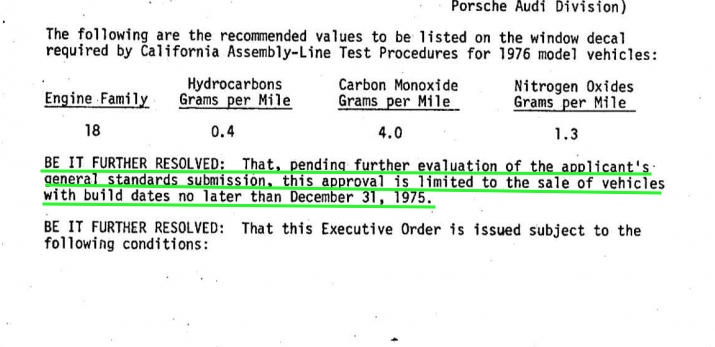

ah, i just figured out how porsche got away with not having cats on MY76 49 state cars.
they ceased production at the end of 1975 calendar year.
end of calendar year 75 was the final deadline - after that all cars sold USA wide had to be fitted with cats.
most car makers that intended to market a car for the full 76 MY installed cats.
porsche knew they were finishing this baby off.
they ran that to the wire!

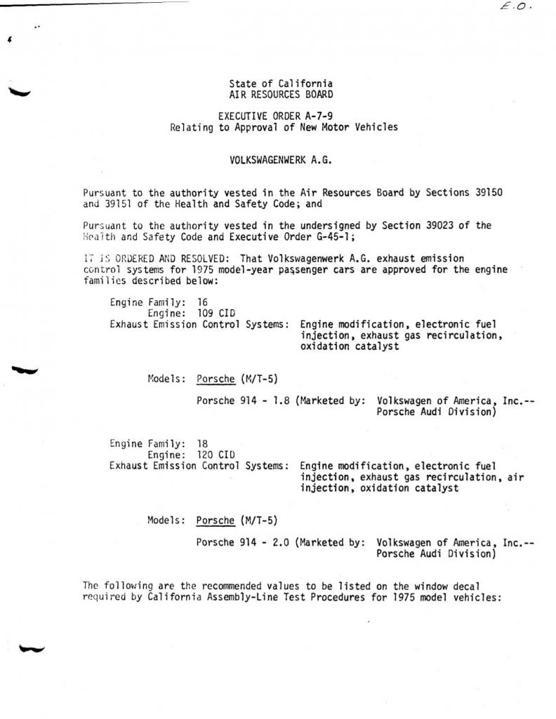

Posted by: JeffBowlsby Mar 14 2023, 10:18 PM
Got proof or is that speculation? We’ve heard that the emissions reqs ran with the model year, not calendar year. Here in CA, 76s require bi-annual smog cents, even though made in calendar 75.
Posted by: wonkipop Mar 15 2023, 12:29 AM

its not exactly a speculation mr. b.
i dug a lot of stuff on the EPA for the 1,8 EC-A, EC-B research.
i'll dig up the specific EPA thing again. i know its on file somewhere in the EC-A/B material i have.
there was a specific date laid down for all cars sold in the USA to have Cats.
and like most things EPA related it is a calendar date.
in terms of a final deadline.
and i do recall the year is 1975.
and thats for USA wide. not just california.
thats the year before.
many of the domestic automakers in the USA staggered the introduction of the cats across their model ranges during the model year. not necessarily at the commencement of the model year.
supply of catalysers was the issue. gearing up production of them from suppliers.

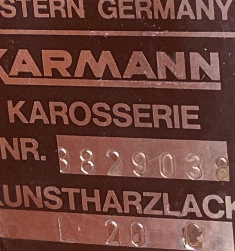

Posted by: type47fan Mar 15 2023, 12:53 AM
QUOTE(JeffBowlsby @ Mar 14 2023, 09:18 PM)
VIN 4762903947 MFG 12/75
Supplemental driver door silver label states "
1976 model year".
Based on the chassis tag (5029038) in the driver side door jamb, my car probably began assembly on Tuesday, December 16, 1975, during the final week of formal assembly for the model.

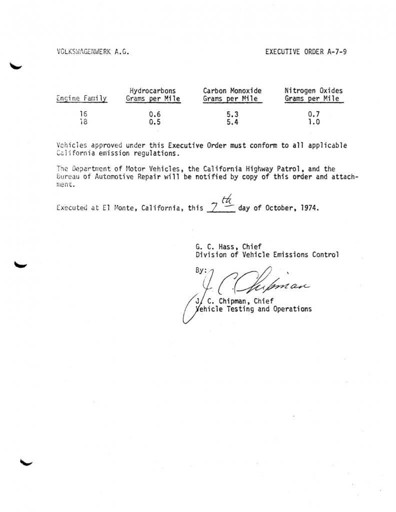

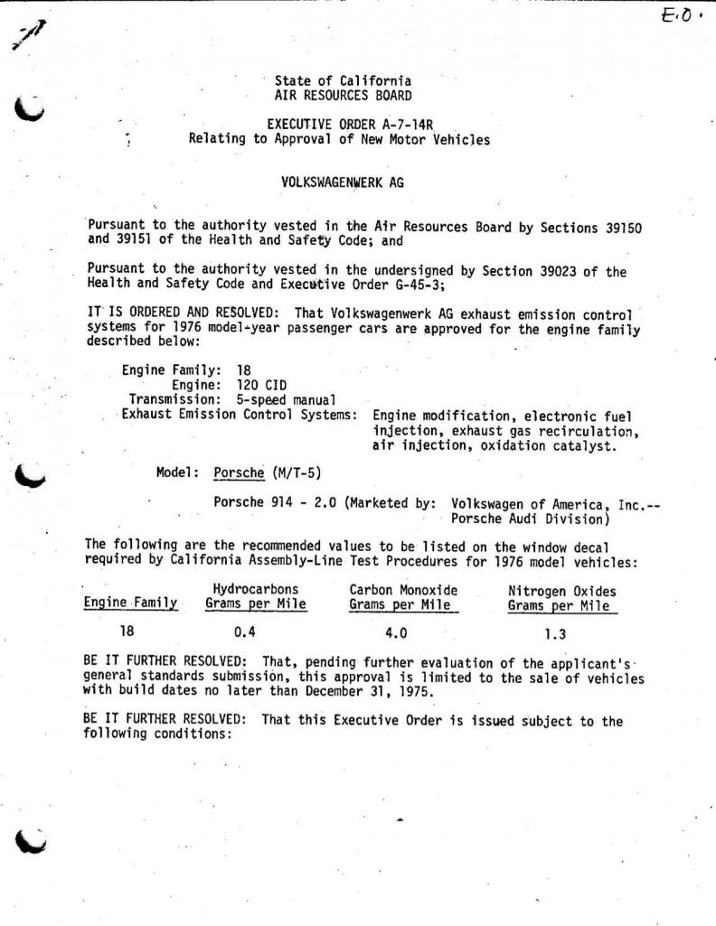

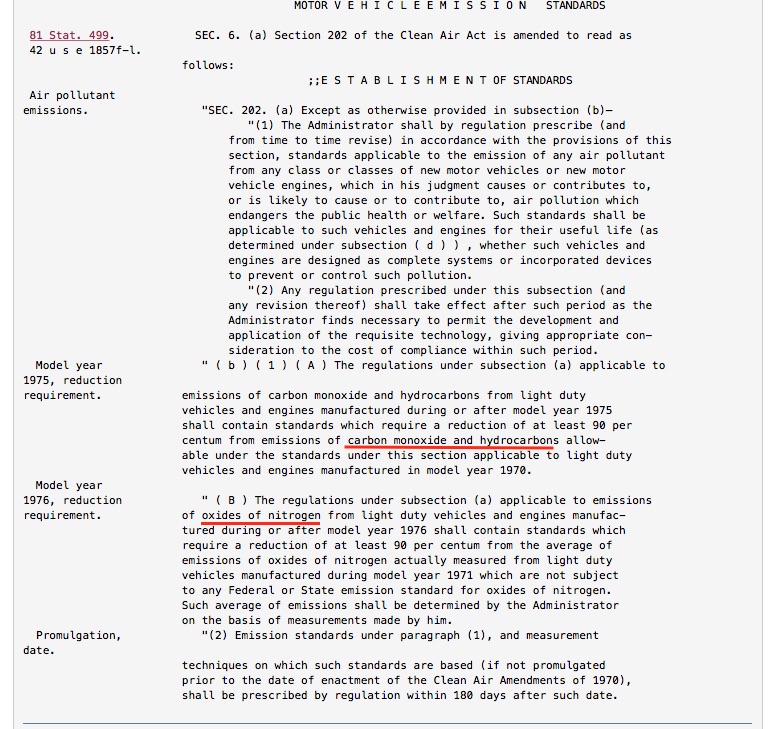

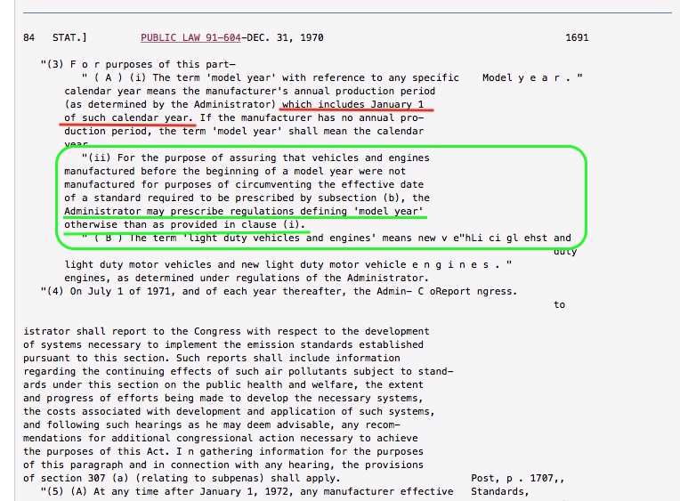

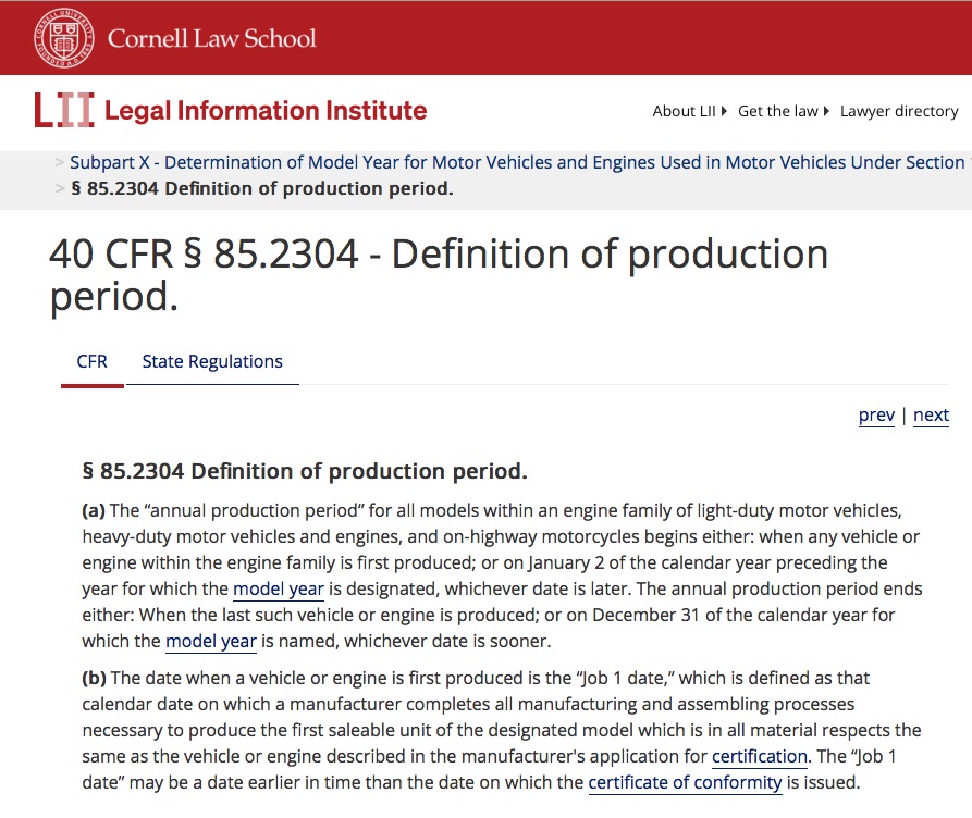

Posted by: wonkipop Mar 15 2023, 02:20 PM
@http://www.914world.com/bbs2/index.php?showuser=994 fan
not what jeff is talking about.
jeff and i are talking about the 49 state cars.
i had not realised the 76 49 state cars did not have a cat.
as everything was required to have a cat by 76 MY usa wide.
........so how come a 76 914 got away without one?
jeff's asking for proof about my statement that they slip through the net because they stop production in dec 75.

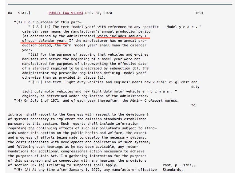

the summary version is the clean air act by nixon administration in 1970 is a way bigger act than vehicle emission regulation. the act is not written in model year terms.
model years are an automaker convention. the act has a date on it. 1975 period.
it was the auto makers who negotiated with the USEPA in terms of model years.
thats how automakers introduced styling changes and more importantly major engineering changes.
jeff wants the date of the act.
he may not think so.
but thats what he is asking for.
i'll find it again.
its the clean air act by the nixon administration.
it was passed in 1970.
am well aware that everything in california has a cat from 75 MY on.
am also aware that everything in the USA wide was supposed to have a cat from 76 MY on. (ie from fall 75). thats how the USEPA and CARB implemented the clean air act via the auto makers. they staggered it from 73 on. to stage the introduction of the tech and assist with the scale of the implementation. cal first, then rest of USA following year.
for insight into this one of the surprises was that Ford achieved fitting of cats to all models, USA wide by the end of the 75 MY. slightly ahead of schedule.
the other two of the big three did not make it until the start of the 76 MY.
and it turns out porsche did not make it at all when it came to a 76 914 49 states.
interesting little duck and weave by the germans if you ask me.
they don't have to? they end the car in 75? same time as the act has the final deadline.
which is actually a year. not a specific day. the act had a bit of lattitude in that sense.
if they hadn't ducked and weaved, and you owned a 76 914 49 state car and it was still intact with pollution gear - it would have conformed to californian standards. thats the year that the emissions standards come into conformity USA wide. that was the EPA big plan.

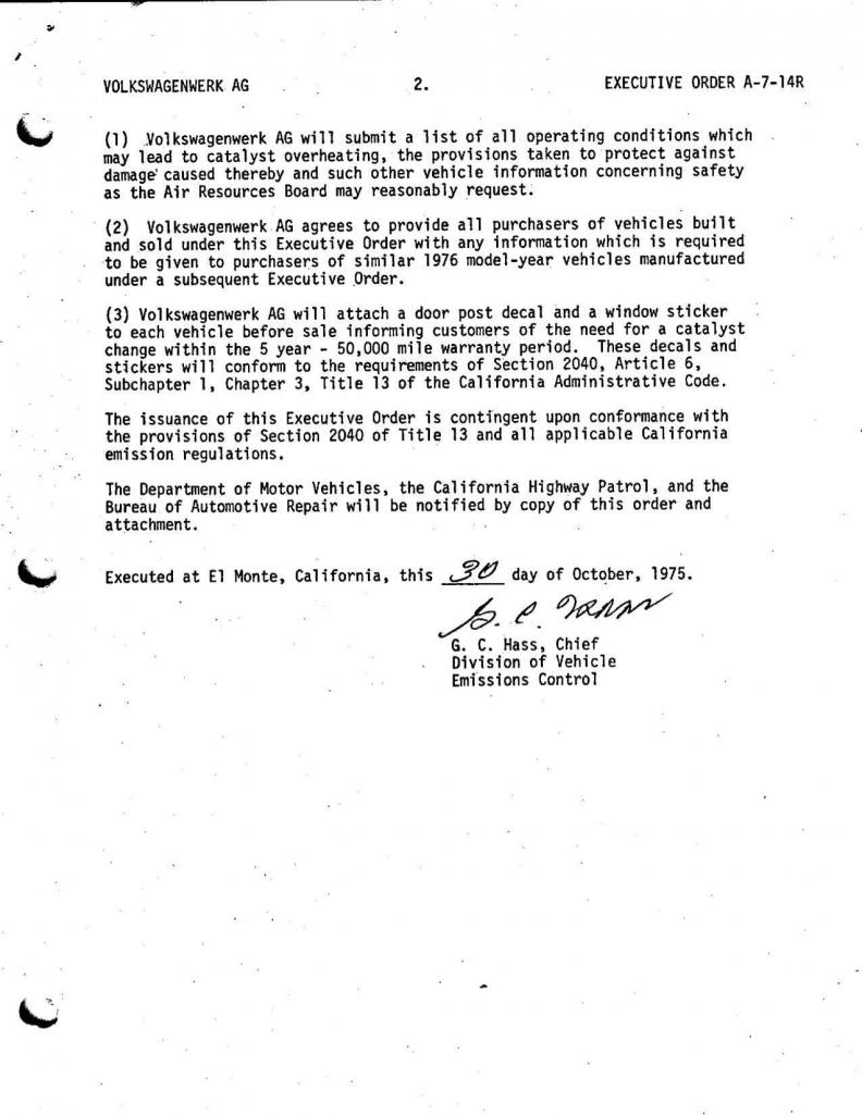

yeah - when you look through the CARB archive there is no approval for 1976 MY porsche 914s. don't exist. wasn't applied for? or least i couldn't find it.
i had to think about that again when you guys brought up this idea of californian and USA 76 models.
basically as far as officialdom was concerned no such thing as a 1976 MY 914?
they are all "1975"s. california and USA. like the 70&1/2 ford falcon. (which i might add is a pretty car, we kind of got an evolution of that falcon in our early 70s australian falcon - which went on to spit out the lovely "mad max" falcon hardtop GTs.)

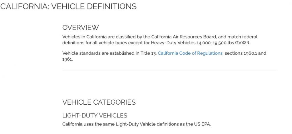

Posted by: JeffBowlsby Mar 15 2023, 08:58 PM
There must be some other CA law here that overlaps the 75-76 model years. In CA, 75 914s are exempt from bi-annual smog testing, but 76 model year cars are not exempt. This requirement is not exclusive to 914s.
Considering the effects in hindsight at this point in time, P should not have marketed the 76 cars. We’d be better off if they had just extended the production as 75 model year cars but maybe there were other laws that prevented that. No 76 model year 914s were sold to Europe.
Posted by: wonkipop Mar 15 2023, 09:09 PM
QUOTE(JeffBowlsby @ Mar 15 2023, 08:58 PM)

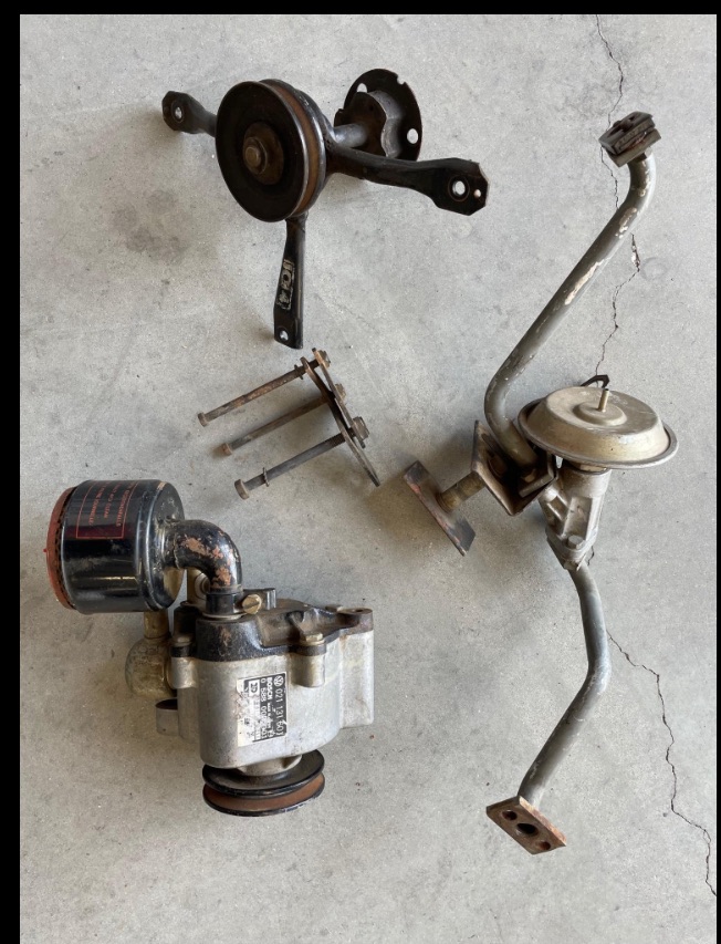

The Smog Pump is the is the most difficult to deal with. first the heads must have threaded holes into the each exhaust port only on 75 76. Next the pump brackets and pully usually have been removed along with the EGR.

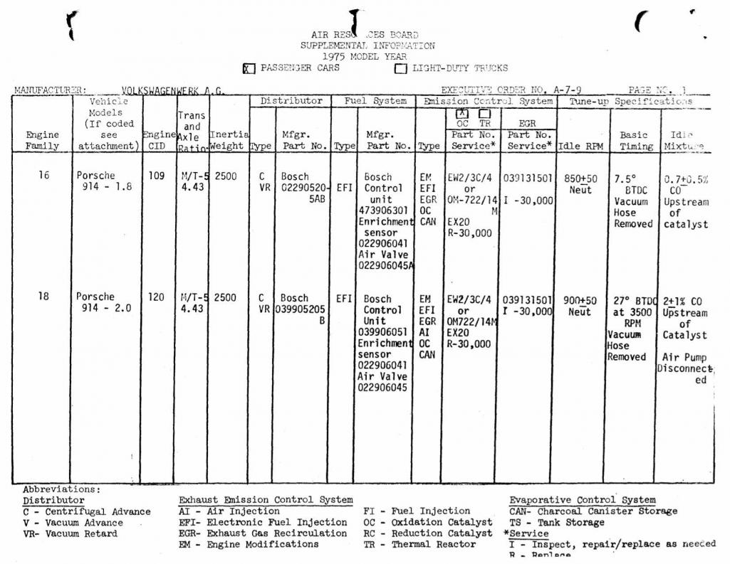

your thinking is correct re 76 being built from the same parts as 75.
with exactly the same pollution gear and settings.
the CARB executive orders prove/confirm that. zero difference.
gives you slightly wider scope for sourcing missing bits for the 76.
you can go shopping for 75 cal spec 2.0s in junkyards etc for those missing bits.
it strikes me the EGR might be a tricky beast. its got a vac operated valve.
a bit like decel valve and fuel pressure regulator, the diaphragm can fail, spring weakens etc. i am unsure how the EGR kicked in on a 2.0 but i know for a fact how it worked on a 1.8. it only activated via the vacuum port above the throttle plate. its vac connection was only to that port. it used the same vac connection that 74 49 state 1.8s used for vacuum advance on distributor. so it only opened at high vac steady state running at cruise. part throttle open. did not open at idle or wider throttle openings while accelerating. i could be wrong but i would imagine the 2.0s were similar? not sure what the contemporary smog tests are like in california, but they are not going to pick up a functioning EGR with an idle test. but they might pick it up with a steady state higher rev test. but if its only a visual examination it has to pass, ie original equipment is still installed you might get over the line. as far as i know the EGR lowered NoX at cruise/
and assisted the engine to run cooler at cruise and slightly assisted fuel economy. it helped to offset the hotter temps around the exhaust valve due to the slightly retarded timing at cruise.
maybe it might have burned a few hydrocarbons but the CAT was supposed to take care of those along with the psuedo thermal reactor heat exchangers.
interestingly the 1976 912 E with the same 2.0 engine and L jet fitted did not have a CAT, instead it was fitted with "proper" thermal reactors (same as 911s of that era). these were an alternative to CATS. they were like two cylindrical cans that the exhaust stub pipe outlets fed directly into and hung under the car. those cans get very hot but worked ok on the rear engined porsches as they hung under the car in the airstream. 912E owners have got a similar problem in california. thermal reactors are unobtainable except by finding one on a junked car that might still be not corroded out.
interesting side note on the clean air act.
by end of calendar year 1975 they had not achieved the 90% reduction in NoX, HC and CO that the act originally set as the levels for the deadline. they just got as far as they could get to and the USEPA agreed. there were small incremental tightenings each year all the way to 1980 because the EPA understood that the last bit could not be achieved without the EFI systems going closed loop.
they had to wait until Bosch finished developing the O2 sensor. which they did in 1980.
at that point the USEPA and the automakers resumed the process to work towards the 90% reduction the 1970 act aimed for.
all interesting stuff in the context of air pollution.

Posted by: gnomefabtech Mar 18 2023, 07:28 PM
Well I finally got the car in my possession and it's pretty complete minus the throttle body that was removed and lost. And no smog pump. So I'm in the market for a throttle body and all the air injection parts.
Does anyone know how the Cali DMV decides the year of the car? The bill of sale says it's a 75 but the vin is clearly a 76.
I'll post pics tomorrow. It's a bit dehydrated from sitting in the nevada heat but zero rust!
Posted by: wonkipop Mar 18 2023, 07:46 PM
QUOTE(gnomefabtech @ Mar 18 2023, 07:28 PM)

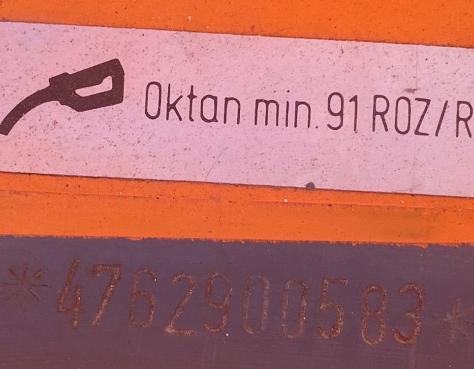

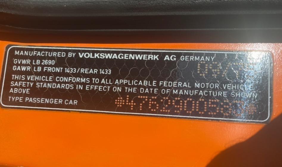

bill of sale probably a typo?
there are original condition 76s on BAT archive with sales docs.
window stickers and sales receipts from dealers. all are marked as 1976.
the DMV will go off the VIN sticker in the door?
in the USA that is the legal manufacturers plate the Fed DOT mandated for all USA cars.
they ignored the manufacturer's plate in the frunk.
only the USA got those Vin stickers and thats why there are there.
i guess it depends on how smart your DMV guys are.
naturally its going to say 75 but a later month.
i imagine they work off model year convention.
and i suppose if he looks up the actual Vin number itself it might give a listing as to what model year that is? interesting?

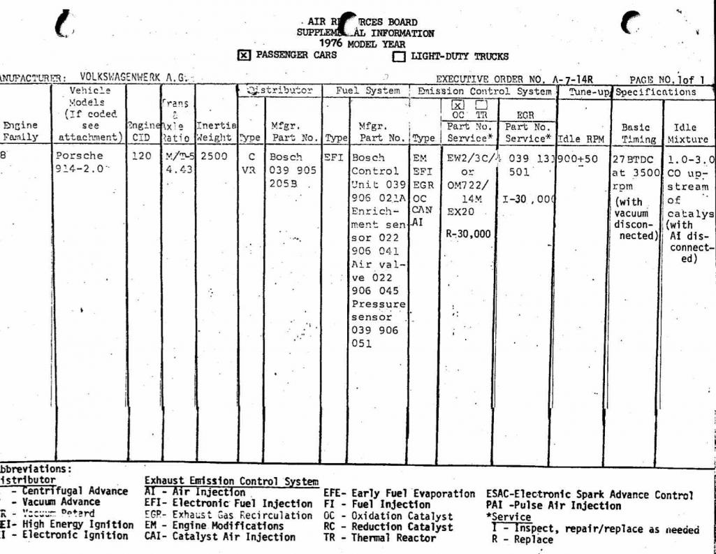

Posted by: wonkipop Mar 18 2023, 07:51 PM
i'm not sure mr b. @http://www.914world.com/bbs2/index.php?showuser=104 has one of these in his collection of labels and plates on his website.
its the sticker specifically mentioned as a condition in CARB executive order for 76 model 914s. advises of cat replacement requirement at less 50,000 miles. only on 76 cal cars it seems?
manufacturers had to warranty all emission equipment for 5 years or 50,000 miles.
looks like VW/Porsche could not get them to last that long and this had been established before the end of the 1975 model long term testing?
Posted by: JeffBowlsby Mar 18 2023, 08:57 PM
The 76 plate omission is known but you highlighted the justification for it. Subtle changes like this started with the mid-1974 Porsche acquisition of the 914 project. The change of the chassis plate to the front trunk in late 74 cars and forward, etc.
Posted by: L-Jet914 Mar 18 2023, 09:00 PM
@http://www.914world.com/bbs2/index.php?showuser=24231 I see you figured out how to navigate the CARB website to get to the EO numbers for New Vehicle and Engine Certification for CARB standards lol. Not easy to find, let alone navigate the website haha. I only knew about the section when I took an Smog update course to keep my smog license up to date.

Posted by: wonkipop Mar 18 2023, 09:52 PM
QUOTE(JeffBowlsby @ Mar 18 2023, 08:57 PM)
except strangely they are not porsche practices. at least those little plates.
ie the production plate (or as it is termed by a lot of folk as the karmann plate) is pure VW practice. it brought the 914 into line with everything else made by VW.
those small riveted plates were on all VWs in the early 70s in the front trunk.
it might be more to do with karmann ghia production ending and the 914 assembly aisle being moved in with the beetle cabrios to take their place. to make room for the sirroccos. its kind of clear that the factory was being reorganised at that time too.
certainly the VIN sticker thing is entirely unique to USA cars.
the registration guys here were not even interested in looking at that vin sticker on my car. as far as they were concerned it could be anything. a nothing.
all they were interested in was the manufacturer's plate.
boy, its a lucky thing i never bought a 76 to try and bring back to australia.
i would have been in a world of pain worse than JORACERS californian smog test torment.
Posted by: wonkipop Mar 19 2023, 02:23 PM
@http://www.914world.com/bbs2/index.php?showuser=24815 and @http://www.914world.com/bbs2/index.php?showuser=27063
this may be of interest.
re definitions used by CARB.
apparently they use the USEPA definitions derived from the Clean Air Act.
there may have been an update to model year definition under the Act.
but it doesn't change things.
its just a more verbose wording of the original definition.
model year still = production period.
the way i read this is that the 1976 914 2.0 is defined by its production period,
not its title as given by porsche.
under the definition:
start date = Jan 2 1975 or Aug (? day of first car produced) 1975.
later = Aug (?) 1975.
end date = Dec 31 1975 (last unit produced) or Dec 31 1976.
sooner = Dec 31 1975.
therefor the model termed the 1976 914 2.0 by its manufacturer is in fact a 1975 model year car as defined by the Clean Air Act, the USEPA and CARB.
i am unsure how cars are being caught in the 1976 and onwards net in california in terms of smog testing. but if they have worded it that 1976 and newer MY cars are required to be smogged then i believe that the 1976 914 does not fall under the requirement.
i'm no lawyer. but i think there might be something to this.
it appears to me that porsche for the purposes of the USEPA either produced a 1975 model for 18 months, which is perfectly possible under the definitions or it produced two 1975 models one after the other within the time period defined by the act.
this applies equally to both the 48 states car and the californian car.
Posted by: wonkipop Mar 19 2023, 03:07 PM
i looked up the DMV california.
they say model year. 1975 model year and earlier cars do not need to be smogged.
https://www.dmv.ca.gov/portal/vehicle-registration/smog-inspections/
i reckon the case of the 76 914 can be challenged.

I can give a couple of tips on emission control: The EGR system was developed solely for the reduction of NOX via introducing an inert gas (without oxygen-could have been anything) into the intake to dampen the temperatures achieved. A small amount of exhaust gas equaled a large combustion chamber temperature decrease. If you keep the combustion chamber below 2500F oxides of nitrogen are significantly reduced.
The air pump was utilized to add additional oxygen to the cat to allow the cat to burn the HC and CO out of an extremely rich mixture. (by today's standards). Without the supplementary oxygen the cat will stop functioning earlier.
Air pump keeps cat alive; it doesn't dilute the exhaust.
Damned interesting that cat cars got an automatic replacement at 30K.
Replacing a cat every 30k would get old quickly...

The secondary air injection pump was added to help introduce O2 into the exhaust upstream of the catalytic converter to help it light off quicker and as stated help the catalytic converter start oxidizing the HC and CO being produced by the engine earlier. The Toyota Tacomas with the 2TR-FE and 1GR-FE engines still have secondary air injection pumps and diverter valves to this day. Grant it the 1GR 4.0L was phased out on the Tacomas which is now a 2GR-FKS 3.5L no EGR valve/EGR cooler or secondary air injection system. The current 4 cylinder Tacomas still utilize it. The 2UZ-FE 3UR-FE/FBE engines also utilized the system. All in the name of emissions control and getting the catalytic converters to light off earlier. It seems manufacturers have either decided to add them or remove them over the years depending. Hell even today the new Toyota A25A-FKS/FXS and M20A-FKS/FXS engines now have EGR valves and EGR coolers tacked back on to lower combustion temperatures again. Toyota used to use there VVT systems as EGR holding the exhaust valve open longer which acted like EGR. I guess it's not enough anymore haha.

brilliant dave.
there must be something in the CARB files. (and the EPA).
that condition on the executive order which states explicitely the 31 dec 1975 cut off date is the pointer to whatever is hidden in the files.
i understand the wording of the definition of model year for the clean air act.
its to facilitate the commencement of production of the next calendar year models in the year before after summer..
the definition actually dates back to the 1930s.
president hoover signed it into law.
at the request of auto makers.
but i think porsche used it in reverse.
which is unusual and unique.
i think the lads who own 76 914s in california, and are caught with the cars so to speak, need to ask the question? esp those who can prove a long ownership record in california.
it seems to me this smog law business is discriminatory. oh no. there is that word.
discrimination.
its a big word that one, i understand, in do gooder california?
i agree, all others would be well advised not to take on the hassle when it comes to a 76 in california.

Posted by: wonkipop Mar 22 2023, 05:11 PM
a very tidy 76 is up on BAT at moment.
calif spec. with emissions equipment removed and no california smog cert.
the removed emissions equipment is going with the car in a box.
if it sells you might be able to get the buyer to sell it if they are taking the car out of calif?

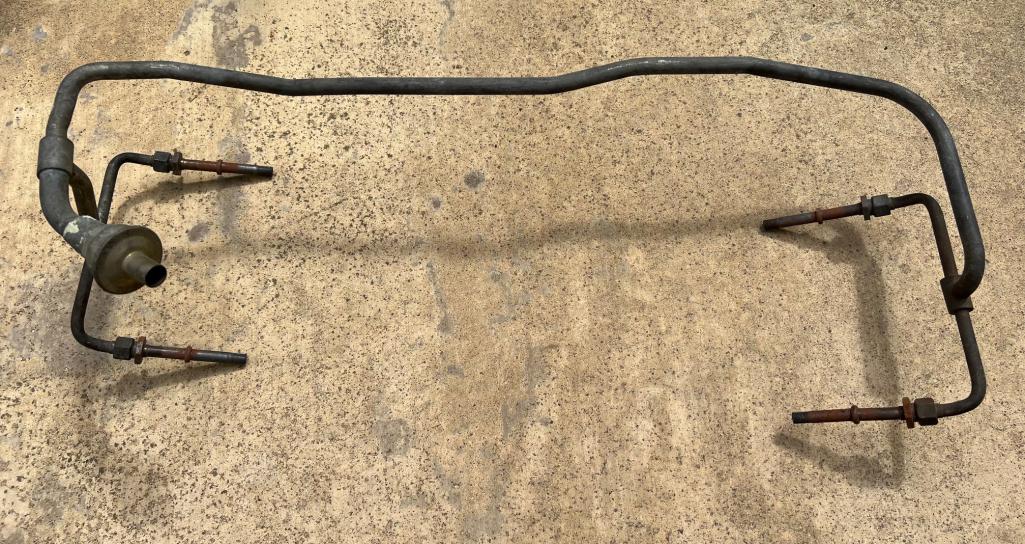

looks like its got everything except the long pipe that connected the EGR to one of the rear mufflers.
https://bringatrailer.com/listing/1976-porsche-914-51/

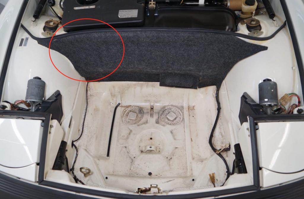

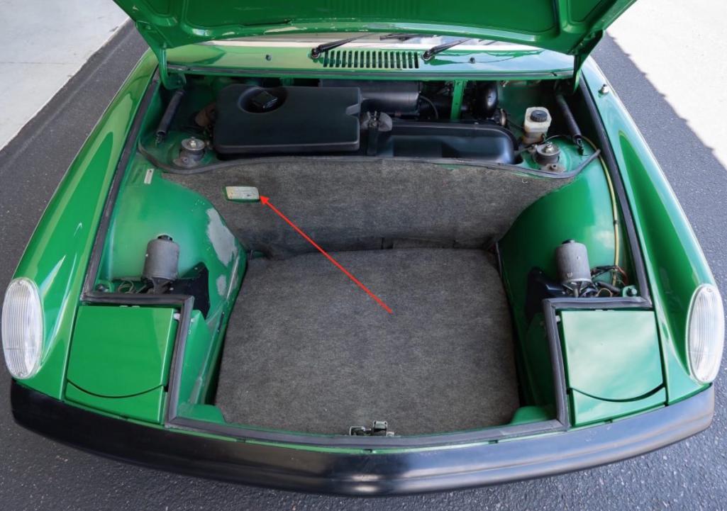

He'll also need this assembly . . .
Posted by: 914werke Mar 23 2023, 04:25 PM
Oh but there is more....
There is a specific airbox top, special trip counter, special speedo cable, special footwell foam, Dash gauge bezel with indicators, multi-chamber muffler with CAT, CAT mounted sensor & relay....as well as the defacto charcoal evap components & plumbing.

Posted by: wonkipop Mar 24 2023, 02:27 AM
QUOTE(914werke @ Mar 23 2023, 04:25 PM)
yeah
but our friend is just bringing a 49 state car in.
and even in the case of a calif. car.
none of that is on the CARB certification that dickhead down at the DMV uses to do his/her/they's check.
they are just looking for the bits on the CARB certification.
which i posted above earlier. thats the documentation they are using.
in the case of a actual car.
pump.
egr.
cat.
these pricks are just going through the motions.
they are signing off on a visual.
and then an insert up the tail pipe.
correct me if i am wrong?
there is nothing about counters etc in the CARB documentation.
its all lost in the mists of time.
and besides its irrelevant, its tied into the manufacturer's warranty.
50,000 mi or 5 years. long since expired. that is why the counter is there.
thats all over when the initial emissions warranty ends.
they just want to tick boxes? yep the cat is there. etc. tick.
