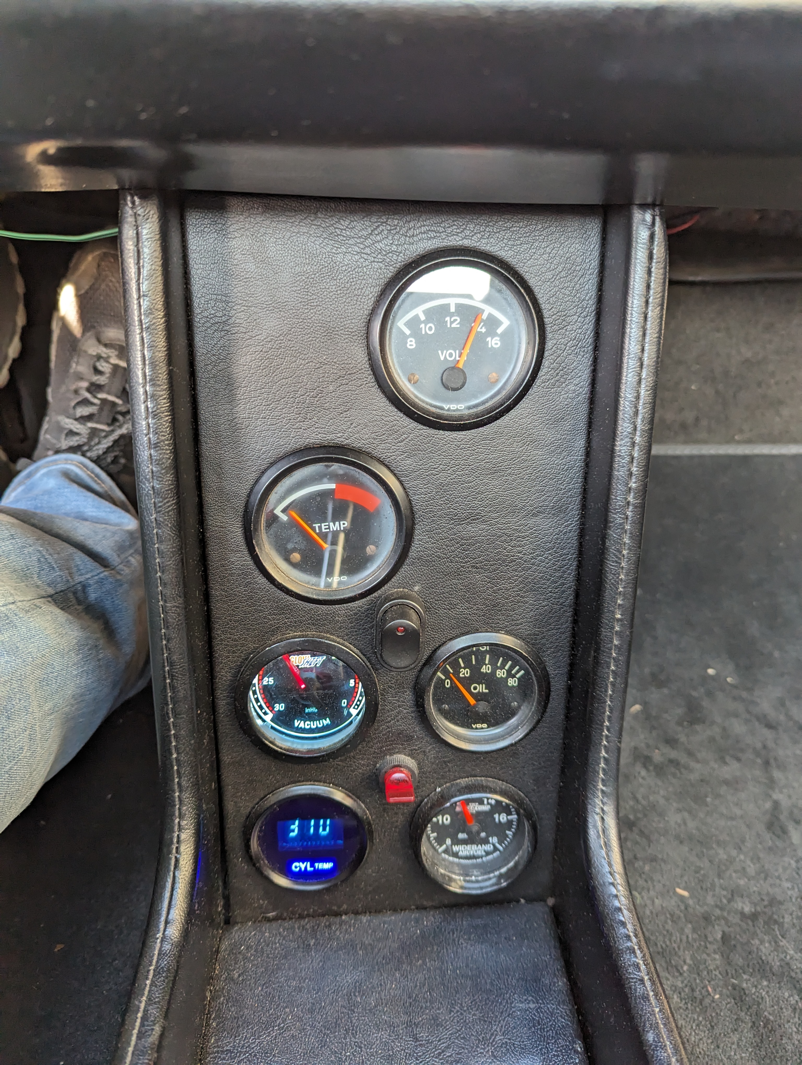

Here are my gauges after I got off the highway waiting at the light (that's a 310 on the cht).
