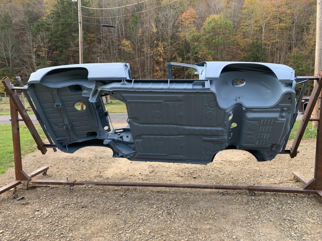

Started no-expense spared restoration in 2014. Paint and body work done by Kirsten Rillos at Rillos Restoration, Kent Wa. Interior by Steve Shepp, Classic Interiors, Ballard Wa.
- Full repaint in original Tangerine (23)
- Only minor surface rust repair needed in a few spots (above left rear taillight, below windshield frame, etc.).
- No structural rust or other body damage.
- New battery tray - the only body part that warranted replacement. No damage to longitudinal, underneath.

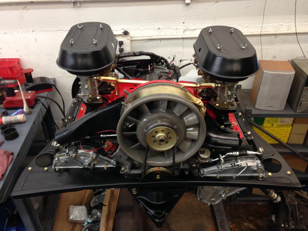

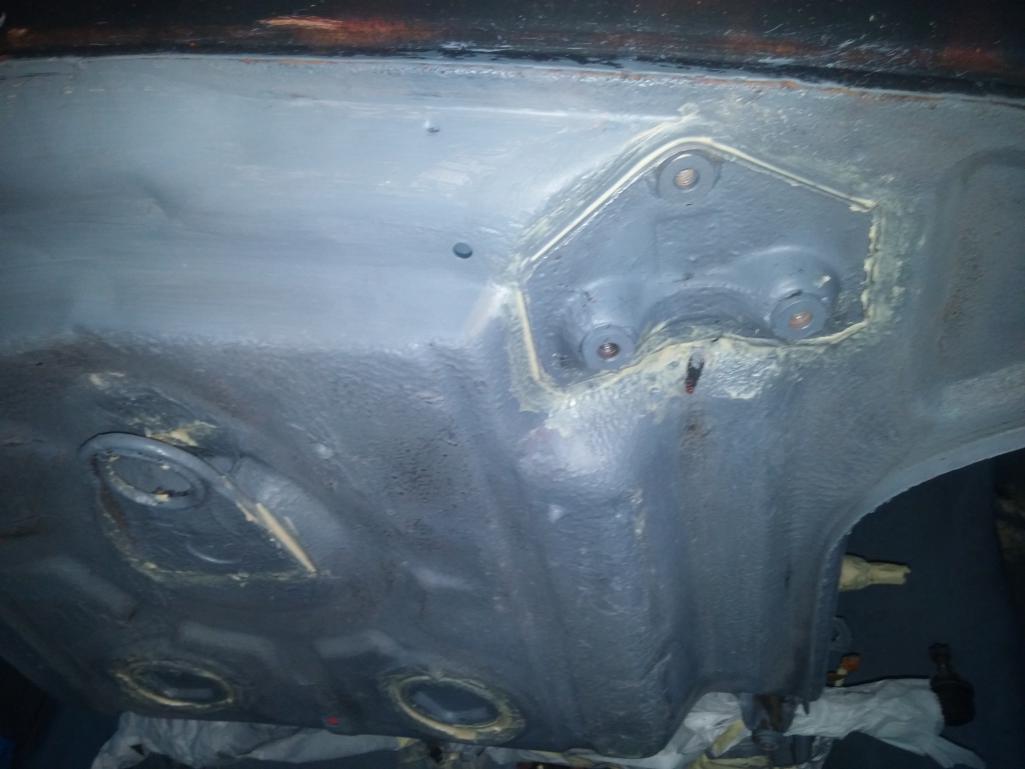

A couple of PRE-restoration and engine ready for re-install pictures, below.

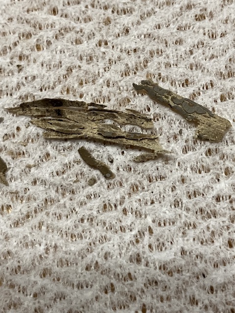

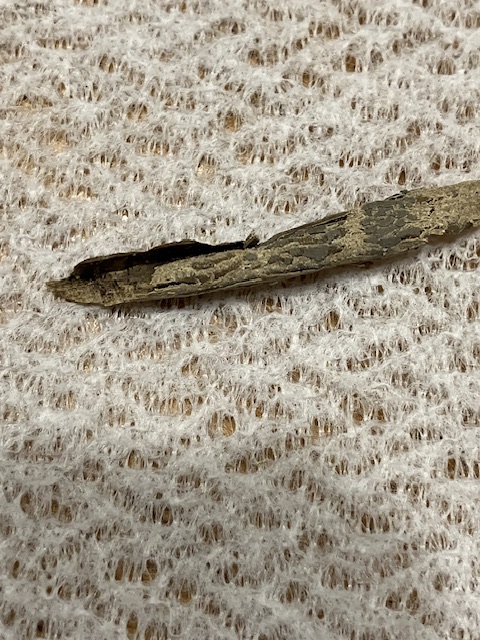

Headlights & high beams malfunctioning; metallic chunk of debris (solder?) lodged in column switch.
RF turn signal inoperative; bucket connector receptacle damaged / broken.
License plate lite inoperative; wiring connected wrong causing short.
Parking brake adjustment improper.
LR brake venting clearance off.
Shifting; worn rear firewall bushing.
Fuel vapors entering cabin & noticeable to both of wife’s 2 adult daughters in walking through the garage; rubber of SS braid hose quickly found to be leaking near shifter (from use of gas with ethanol?) w/$135 Rigid combustible gas “sniffer”.
Carbs: sediment / debris in floats, inlet filter torn causing unacceptable drivability.
Throttle linkage set to achieve WOT; but set incorrectly for idle to be on carb stops, or to avoid excessive side loading of throttle shafts at WOT.
Gas tank: sediment (paint flakes?) & rust inside, outlet sock filter broken. SS braid hose with 2 worm drive hose clamps on tank inlet pipe.
There have been other “disappointments” along the way, but since I don’t have documentation, shall be excluded from this thread.

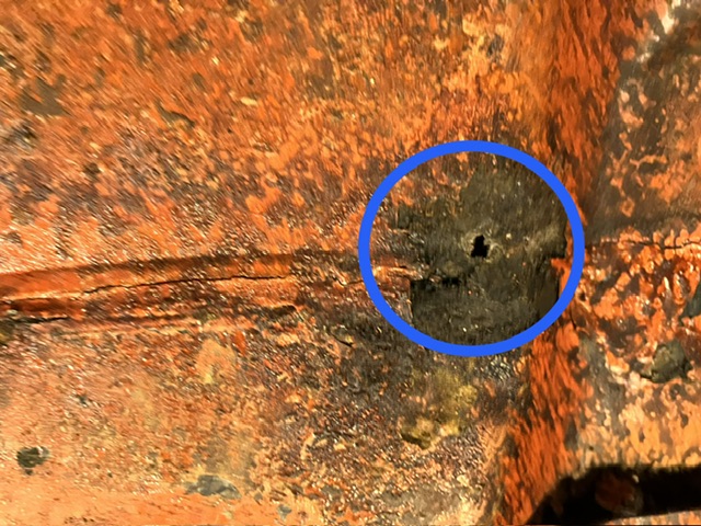

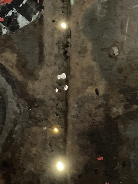

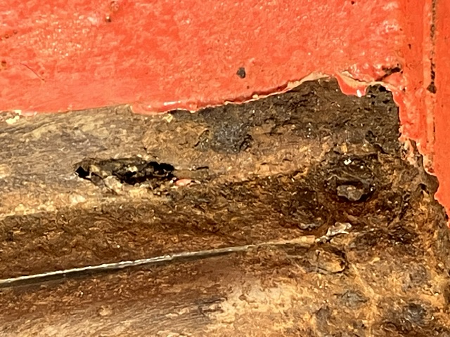

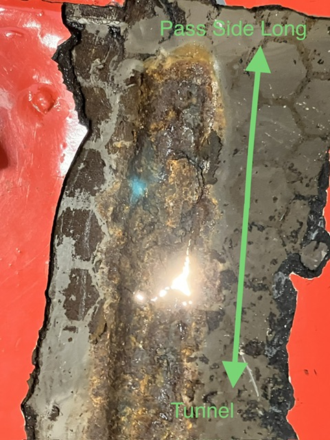

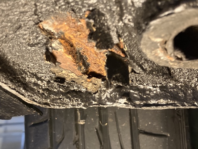

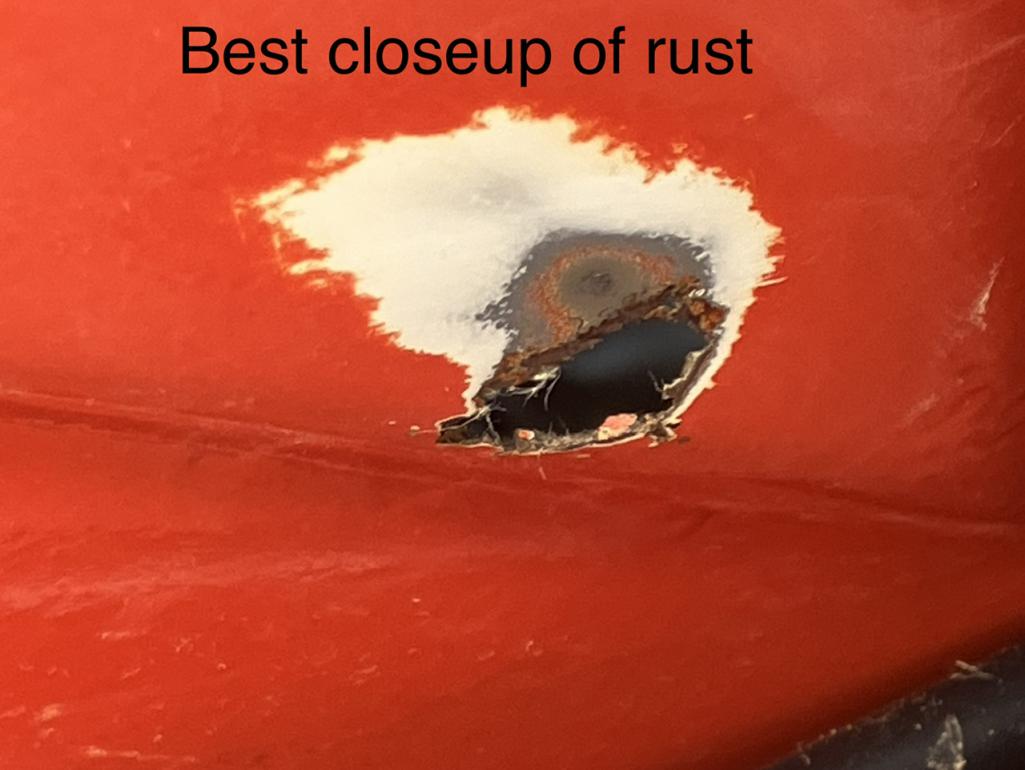

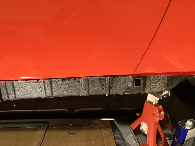

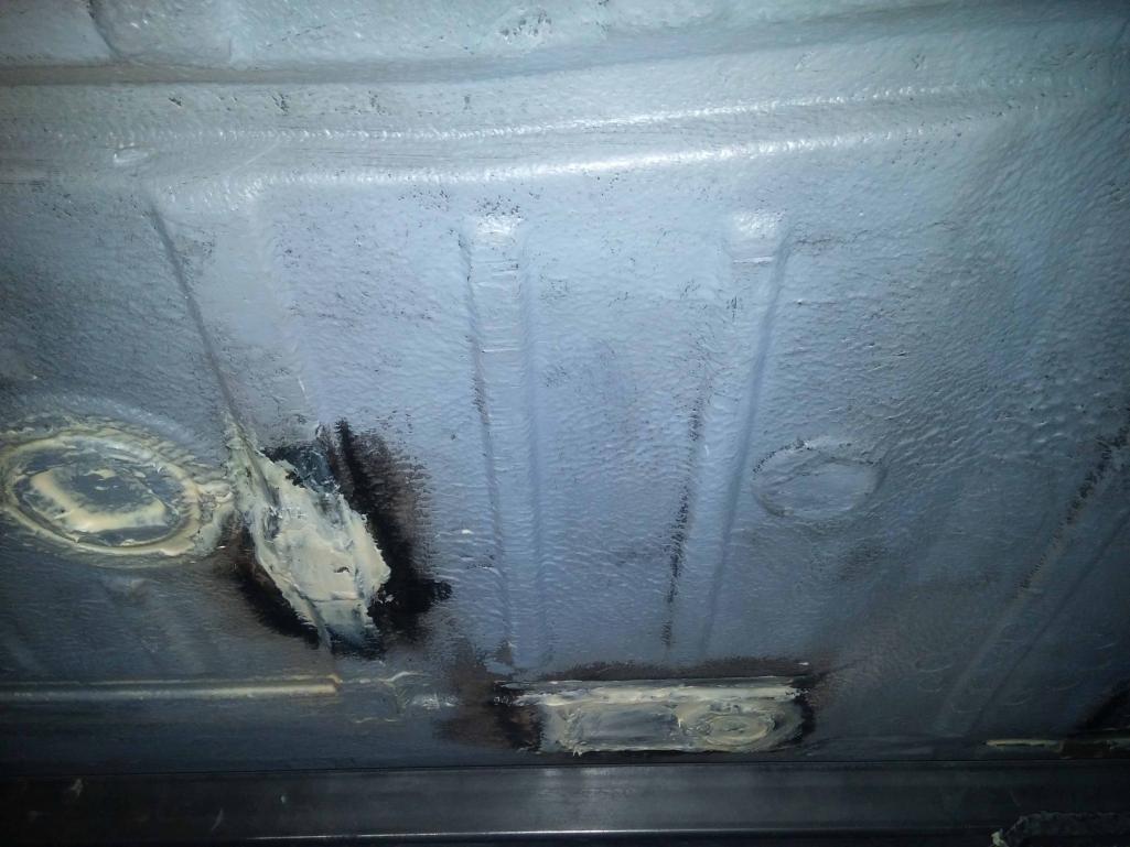

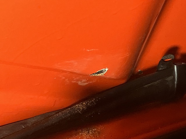

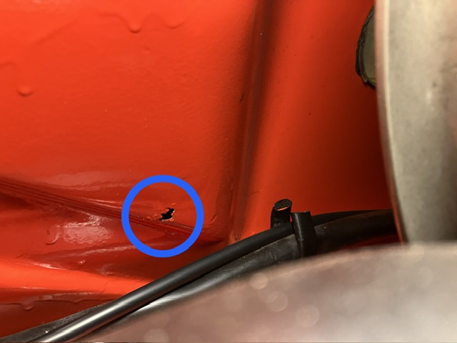

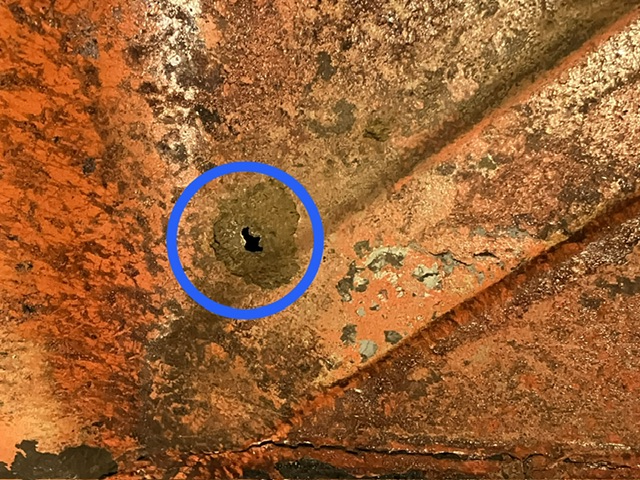

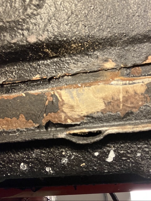

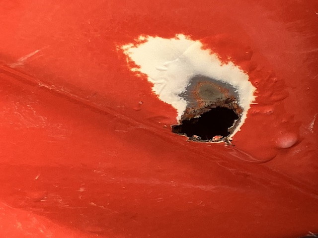

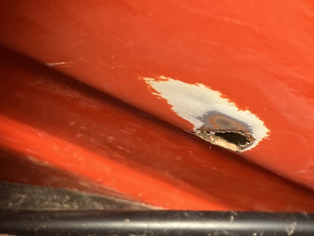

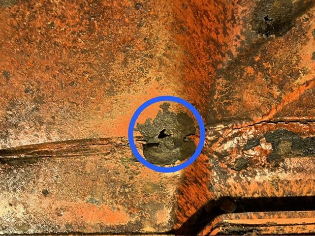

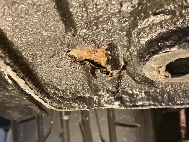

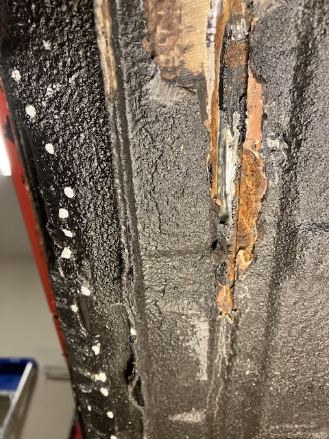

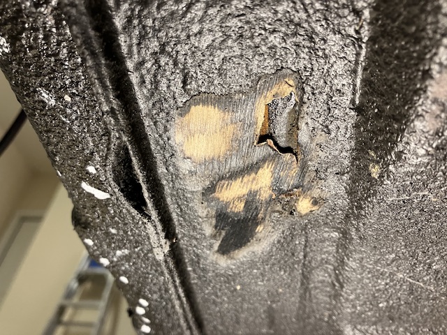

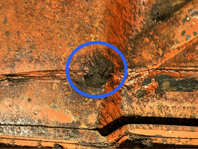

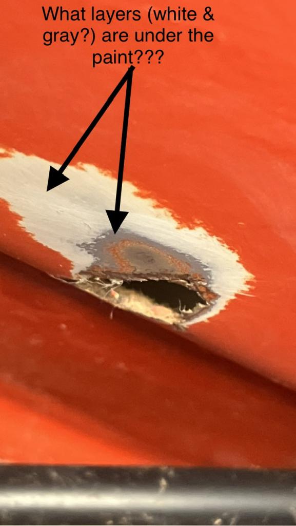

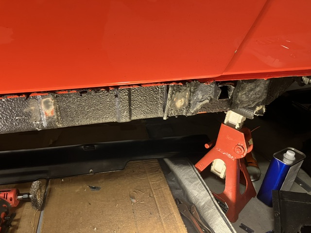

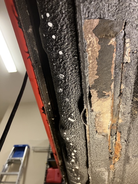

This’s my most recent discovery earlier today:[attachmentid=899960][attachmentid=899960]Attached Image
Posted by: 930cabman Jan 19 2024, 04:42 PM
All sounds and looks great, until the last photo.
Looks like possible heavy rusting in the floor.

Broken fuel tank screen sock:

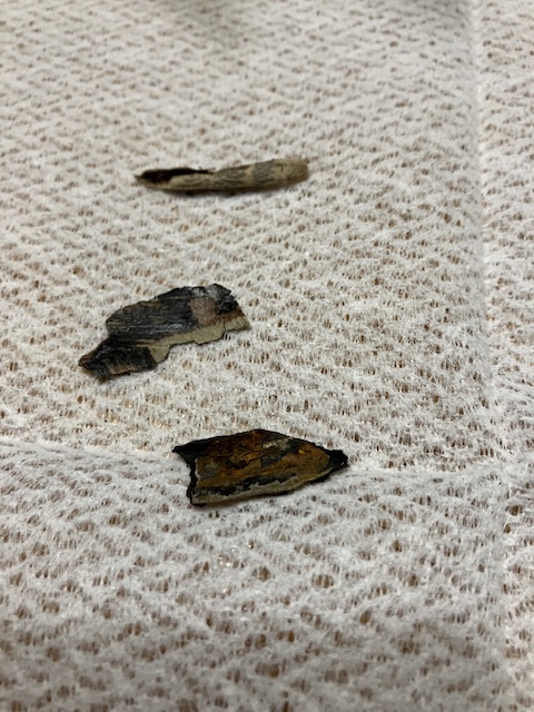

Carb debris (the first possibly a piece of Porsche fabric reinforced fuel line), sediment and torn carb knitted nylon mesh inlet filter.
Attached Image Attached Image Attached Image Attached Image Attached Image Attached Image

----------With what we see now, this statement is not even close. Your car will need a new floor pan put in. Hopefully it is only that. This is a real investment and if this was my factory 6 I would want it perfect. That is just the way I am. It may be curse but a spare no expense restoration is just that. An open checkbook------ These pictures kind of make me sick to my stomach. Try to find some light in this, at least you would make sure your clutch tube is right on.
Never give up on finding the original Engen case, you never know. It took me 17 years to find mine and I was lucky that one of our 914 brothers saw it was possibly for sale.

The braided stainless fuel line and two clamps are incorrect.
The geometry of the throttle linkage starts at the toe board and ends at the two
drop links at the carbs. Necessary parts include a good gas pedal, a smooth
cable, good bushings and all correct 914 6 linkage parts.
You have the correct fuel delivery tube between the carbs but it appears to have
been modified. It should also be attached to the bulkhead by three
nylon snaps.
Your transaxle is a rear shifter converted to a side shifter.
Be sure to get the correct conversion bushing for the firewall.

For my 6, I decided to do a full rotisserie restoration. I (ultimately) put my 6 in the talented hands of Kent Simmons, (Auto Art Customs, Torrance, CA) Jim Geer and crew. The end result was a 6 awarded a Blue Ribbon at Werks Reunion in 2022. first.gif . You can see my "build" threads in my signature.
We are now getting ready to drop the 9K mile 3.2, (for sale in the Classified) and with the help of some great, talented, knowledgable friends, put my '95 stock 18K mile 993 3.6 motor in. I will document the entire process and post for anyone interested to follow.
I am into my car a good chunk of money, but I love it. I have had 3 offers to buy it, all over $100K. I can't imagine ever selling my 6 while I am still able to drive. It is just a joy to drive and worth every dollar. beerchug.gif
At the end of the journey, it was all worth it and I learned a lot. I post everything about my 6 in the hope others learn from my experience. Life is too short to look in the rear-view (mostly laugh.gif ). beerchug.gif

If only the floor pan has rust and the rest is solid and the powertrain is strong, I'd say you still got a good deal considering its a real six. People are asking $80k plus them now.
If the floor pan rust is severe, the PPI surely should have caught that.
If the car makes you sick, sell it. If not just go make it right. After loosing tons of money in my 401k with swings in the market, having to spend a or loose a little on a car seems insignificant to me anymore.

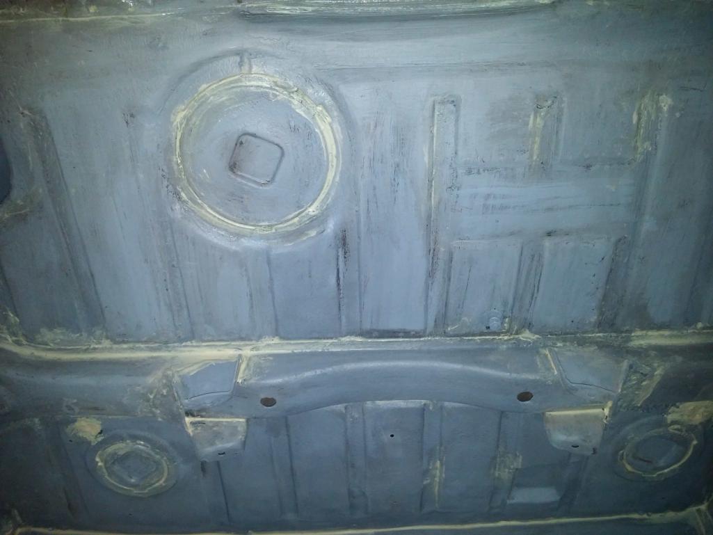

I saw this car at Rennsport IV in 2011. Have a couple photos to post.
Posted by: lalee914 Jan 20 2024, 09:19 AM
It was for sale at that time.
Posted by: lalee914 Jan 20 2024, 09:21 AM
This photo is from July 2013. Don't know where it was taken.

I see that you paid a significant sum for a PPI. The work that was required to repair the car was much more extensive than the PPI would would suggest.

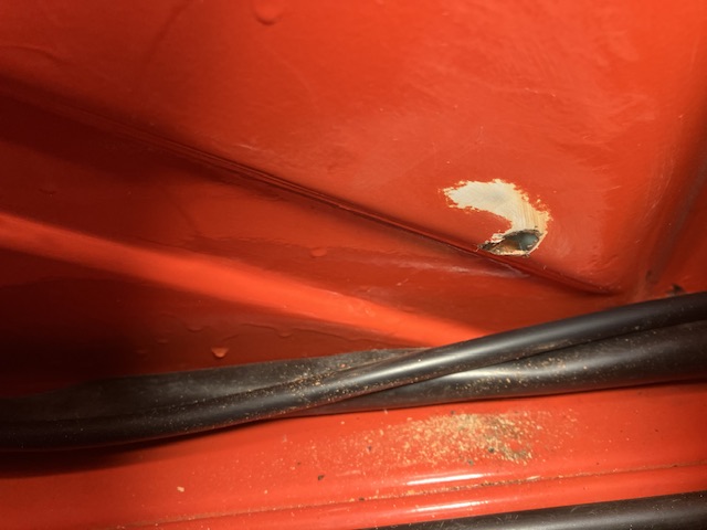

For comparison to PPI and seller’s 914world advertisement description & photos. (Maybe not that unusual or awful for a 50yo 914, but unknown to me before making purchase decision & negotiating a deal. A similar photo was provided by PO, between finalizing the purchase and taking delivery.) Again, please draw your own conclusions.

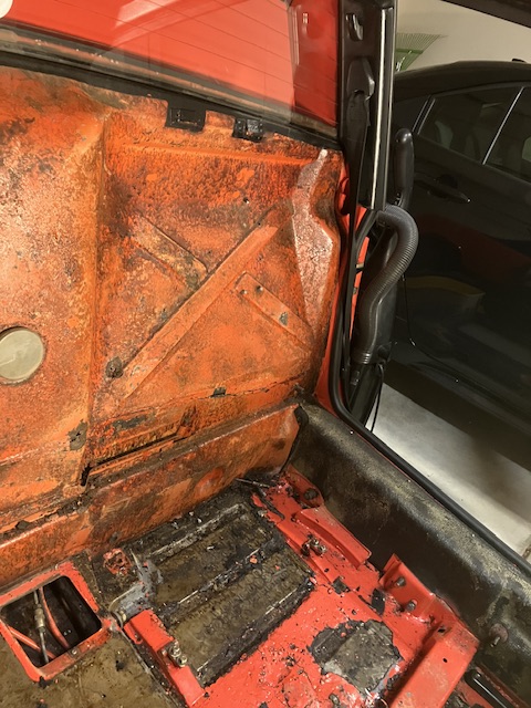

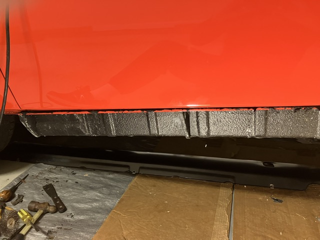

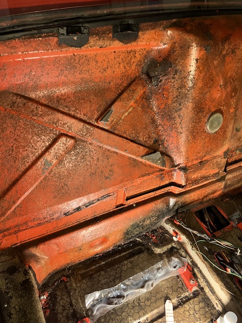

I should have been clearer. Seeking thoughts on if and how complete rust repair can best be accomplished (if no metal removal or welding is required) within these constraints:
1) removal of only those interior items necessary to expose the entire floor surface; seats, backpad, carpet, seat belts, while covering the dash & gages and door panels as necessary, and without affecting exterior car surfaces. In the past I did an acceptable limited rattle can rocker panel repaint with an Automotive Touchup brand color matching paint and thorough masking in my garage.
2) work cannot create a hazardous, noxious or dirty environment in the garage.
And would it be a good idea to remove the undercoating to inspect for rust there too? Remove entirely? … or just spot check in the most likely rust prone areas?
Finally, if floor pan section(s) need replacement, what extent of disassembly will be required?
Posted by: Superhawk996 Jan 21 2024, 06:10 AM
QUOTE(Rufus @ Jan 21 2024, 12:42 AM) *
No.
914 floor pans typically rust from inside out from water accumulated inside by leaking rear window, leaking side window seals, and if the top gets left off in the rain. That moisture gets under the tar and does its thing over time.
Working on underbody is a PITA without a hoist or rotisserie. Can be done but it’s not terribly fun.
By removing the factory tar from the interior, you’ll know what you’re dealing with. If you have heavy rust that has perforated, you will be able to tell after the tar is removed.
Once you see what you have underneath the tar, you can come up with an action plan.

Posted by: burton73 Jan 25 2024, 10:40 AM
@http://www.914world.com/bbs2/index.php?showuser=5840
These pictures make it look easy but, here is what the pan replacement looks like. When you open up the bottom, you can fix of reinforce the clutch tube that has or will go out. It is just a matter of time for all 914s. Do it right because no matter what the documenting of this work is very important for resale and you want the comfort of knowing it is right. Mine was done on a lift. Mine is a real 6, the 30th one down the line
Best Bob B

Posted by: Rufus Jan 25 2024, 12:33 PM
QUOTE(burton73 @ Jan 25 2024, 09:40 AM) *
Best Bob B
Thanks Bob. The result looks awesome!
Definitely not within my skill set.
Is floor pan replacement advisable, or even possible, without completely stripping the car down? (I’m totally ignorant of body & paint work.) Things like wiring harness, shift linkage gotta come out 1st, or not?

The first 10 minutes of process of exposing the driver’s side floorboard:
Posted by: 930cabman Feb 4 2024, 07:03 PM
Progress.
I am just about 99% convinced there is no rust free 914.
Either way, great example
Posted by: mate914 Feb 4 2024, 07:38 PM

Just to indicate how long it took to make this much progress removing what covered the metal footboard. 10 minutes so far
Posted by: Craigers17 Feb 5 2024, 05:43 AM
Those floorboards look really solid so far. In a best case scenario, every floor I've ever seen underneath that coating looks similar to yours...a little surface rust and dirt. While I understand some of your frustration that this should have been addressed before paint, I'd say your car looks very solid. Congrats!
Posted by: mb911 Feb 5 2024, 05:45 AM
Looks like it will clean up nicely
Posted by: VaccaRabite Feb 5 2024, 10:48 AM
Those floors are pristine.
You have started so you may as well finish stripping them of the tar. Then clean them and paint them and put a modern sound insulator on them (Dynamat or similar) and forget about them. They are fine.

Posted by: Rufus Feb 5 2024, 12:50 PM
And after a little wire brushing (under the driver’s knees) today with my Milwaukee M12:
Posted by: 930cabman Feb 5 2024, 02:14 PM
Looks quite pitted, got to be some section loss
Posted by: Superhawk996 Feb 5 2024, 05:28 PM
Very typical of rust under the tar.
Better to get the tar off so it doesn’t continue to hold moisture.
Ditch the screwdriver.
Oscillating multi-tool with a scraper will make quick work of it. Dry ice also works well if you have somewhere convenient to get it in bulk.

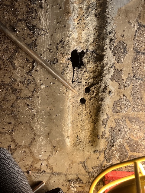

@http://www.914world.com/bbs2/index.php?showuser=5840 : I don't know what to tell you. Certainly not great, but I still don't know how bad that is. Is the pan soft or perforated, or is the Wurth undercoating compromised? Hopefully, the unbiased here will chime in.
Bottom line: I certainly would've had that fixed if Rillos hadn't assured me it wasn't an issue.
Below are a couple of underside pics prior to Wurth undercoating for reference:
- MR
Posted by: Rufus Feb 15 2024, 06:08 PM
QUOTE(mountainroads @ Feb 15 2024, 04:57 PM) *
QUOTE(Rufus @ Feb 15 2024, 11:11 AM) *
@http://www.914world.com/bbs2/index.php?showuser=14145
- MR
Light from a drop light underneath
Posted by: mountainroads Feb 15 2024, 06:14 PM
The second pic:
- MR
Posted by: mountainroads Feb 15 2024, 06:23 PM
One more. Unfortunately, I can't tell exactly where underneath the car these pics were taken. They were all sent to me by Rillos as work was in progress.
- MR
Posted by: mountainroads Feb 15 2024, 08:50 PM
Here's a copy of the PPI I received when I purchased the car. Please note on Page 3 (circled) that the underbody was inspected and no mention of rust issues. I believe Rufus has the paper copy.
- MR
Posted by: bkrantz Feb 15 2024, 09:07 PM
QUOTE(mountainroads @ Feb 15 2024, 06:23 PM) *
- MR
This is the driver's side floor, about in the middle, looking from the center tunnel at the top of the picture towards the outer long. Front of the car is to the right. The internal cross member sits above the rib that looks wider. The driver's seat is about the larger circular plug on the left.
Posted by: Superhawk996 Feb 15 2024, 11:00 PM
I guess i’ll be the bad guy . . . Shame on Rillos for just rubbing seam sealer over that and then spraying undercoat.
$60k ? hissyfit.gif sheeplove.gif it has become almost impossible to find real craftsmanship in this world.
I just feel terrible for both of you.
The good news is that it is is a /6 and its a survivor and there isnt anything there that hasn’t been dealt with before.

That is a nice 914-6. All floor pans rust. Don't take it back to any shops for work. Do work your self. You will spend your money much wiser then a shop.

Some basic input here after going through all of this
I think the only people to blame are the shops. I don’t think that floor pan would have been discovered in a ppi as it appears it was well hidden.
Only step forward is to properly repair it which if it were in my neck of the woods I would fix that area for around $1000 and it would be undetectable. I hope to see this thread move in a positive direction now.

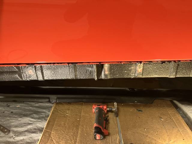

Upon closer inspection now, it appears Rillos might've (I can't tell for sure) used body filler to "fix" the floorpan from below (Post #127). If so, I don't know why he did that instead of welding and he never said anything to me about it at the time. Had he said "This should be welded up.", I would've immediately said "Do it.".
Frankly, I didn't look at the pictures he sent too closely then and simply thought "Oh, he's just cleaning up the bottom before undercoating". I trusted him to take care of what needed fixing and to do a good job. Perhaps that's why he didn't want to do anything from the top side of the pan. IDK.
I again refer to the initial PPI (Post #128, page 4). Although numerous mechanical defects and the front panel repair were noted, they inspected the bodywork and underside and no rust issues were pointed out. I would've gladly shared all the restoration pictures I received and the PPI with any prospective buyer or inspection shop, if requested. Perhaps those items would've informed a different purchase decision.

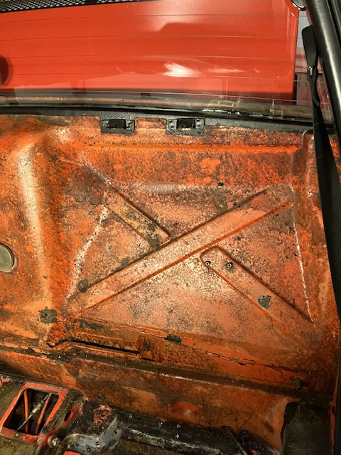

Posted by: Rufus Feb 20 2024, 11:32 AM
Firewall after 30 seconds of wire brushing by hand …
Posted by: mate914 Feb 20 2024, 11:38 AM
QUOTE(Rufus @ Feb 20 2024, 12:32 PM) *
How does the firewall look in the area right behind the passenger seat? Can we see a picture of that spot? That is usually the spot that’s worst.
Matt
Posted by: Rufus Feb 20 2024, 11:49 AM
Other side

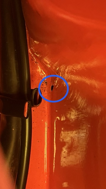

Posted by: Rufus Feb 20 2024, 11:54 AM
Firewall behind driver’s seat
Posted by: Rufus Feb 20 2024, 03:44 PM
Again after 30 seconds of wire brushing by hand (behind driver’s seat)

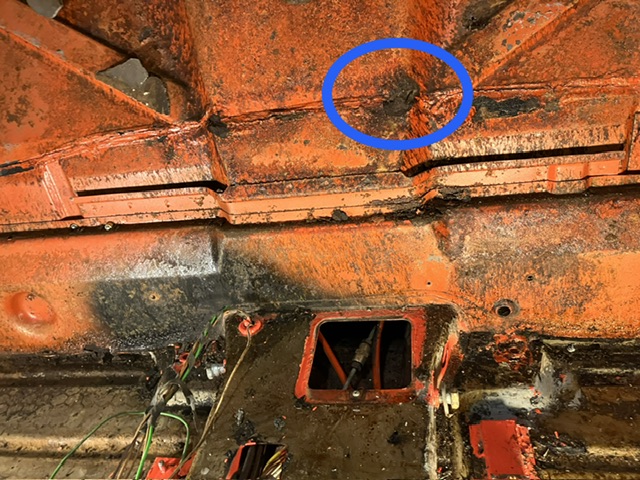

Posted by: Rufus Feb 20 2024, 05:30 PM
Behind passenger’s seat. As found; I.e. no wire brushing
Posted by: 930cabman Feb 20 2024, 05:45 PM
Looks like, maybe tastes like, maybe smell like, must be .......
Great example, but the tin worm has taken residence
Posted by: Superhawk996 Feb 20 2024, 06:23 PM
Whatever you do. . . Don’t panic.
Typical 914 rust location and perforation.
You are probably at a point to stop and take stock of the situation.
Either keep digging and you’ll find more rust. It is not a joke that there is no such thing as a rust free 914. There is ALWAYS rust somewhere unless the car was acid dipped and e-coated. Even then, after a couple years, I’ll bet I can find some minor rust between seams.
Or
Clean up the floor pan tar, fix the minor rust there, seal it up and enjoy the car.
I guess you could also hit pause and do a full blown restoration. Usually I’d be all for that on my cars. I’m screwy.gif that way. But I can do all the work myself and my labor is “free”.
But given how much time and money is already in this car, why not just enjoy it for a while 1st? Especially given how hard it seems to be to find a shop doing quality work based on this thread as well as another thread that’s going on.
confused24.gif My random thoughts. I’m sure others will chime in.
Posted by: 930cabman Feb 20 2024, 06:54 PM
I have .02
Assuming you are not 20 or 30 or even 40 years of age, patch things up and enjoy this beauty. A full scale restoration is a major project with major $$ and major setbacks/delays.
Posted by: mate914 Feb 20 2024, 07:23 PM
Good thing the rust is not too bad on the firewall. That you should be able to treat the rust in the floor pans is a different story. I would suggest sealing the floor pan from both sides. Enjoying the car as much as you can over the summer. Next winter, find a 914 enthusiast or learn yourself. Most of the floor pan welding can be done from above, you don’t need a lift. You will crawl in the floor for a while, if you’re damaged goods like me, try to do it while it’s warm outside.
It’s not fast. It is humbling. We are here to help.
Matt
Posted by: bkrantz Feb 20 2024, 08:17 PM
So far, you have shown us nothing that is significantly structural. The floors might be almost a concern, and to fix them right would mean welding in new sections. But you could make a temp repair with some patches. Same with the firewall.

Posted by: Superhawk996 Feb 21 2024, 12:43 PM
Guys above have covered it.
I’ll answer as if it were my car.
Short term (this coming year): it is clear that to be a high dollar $100k type car it will need restoration - pans, patch panels work on firewall, and other areas to some degree. This isn’t saying there is anything outrageous. It just has some typical rust in typical areas that weren’t addressed by Rillos for whatever reason. Appears to have some paint runs in engine compartment - not sure if that was paint over of old paint or if Rillos did that?
I would stop digging for more rust. At this point, each time you find a new perforation, it’s just another area needing to be sealed or repaired properly (ie weld in metal).
I would finish removing floor pan tar. I would seal the small perforations with Wurth seam sealer. Epoxy paint interior floor pan with SprayMax 2k. Reapply undercoat to any exposed perforated areas underneath.
Then I would drive it - enjoy it. Sort out whether there are any other unknown mechanical issues & document any you might want to address in future (gear box, suspension, seal leaks, etc).
Get to know the car and decide if it is the car to keep (I would) or if you want to sell it after you know it better. At this point, given the selling price and what you have in from Rothsport, you’re probably at or around a break even point. The longer you keep it, drive it, and enjoy it, the more value there is for you.
Long term - strip it down and go full bare metal rotisserie on it. When it goes back together that’s the time to take care of any of the mechanical issues you would have noted.

Do your own survey of the car. Relax, take your time, be thorough. Probe around with an ice pick. Not stab, probe. If the pick should go thru, it only leaves a tiny hole. Grinders leave scars. The car looks good. If it runs and handles, enjoy it. Convert any rust you might find with a converter product like Mar-Hyde. No one will know unless you point out the flaws.

If you haven’t, take a look at Cairo's restorations thread, then his most recent post “evolution”… these cars are never done when getting to one’s own liking. Also note the new welding that’s about to occur, it can be done, and I’ll bet it’ll end up being an invisible upgrade.
Your car is perfect for your desire, fix the firewall, treat the topside of the floor, add undercoat below and tar above and drive… youll have a car that you wont necessarily worry about road rash. Finish the other projects then get back to this car…. At this point the goal should be to preserve, better the car if you can, stop the tinworm, it’ll retain its value just fine.
Posted by: mb911 Feb 22 2024, 05:19 AM
I must say the thought that the current rust situation on this car is a big deal on a 914 which litterly rusted the minute they left the factory is a bit comical. That said I do understand you bought this thinking these issues don’t exist. For a 914 it’s pretty easy to repair what you have found so far. Find someone local to repair it professionally and you will be all set. Martin mid engines Ben Martin would be on my list to contact if I was in your situation.
Ps you should look at my build thread as there probably is only 1/3 of the original metal left on my car.

Posted by: Rufus Feb 23 2024, 01:20 PM
A little sanding with 400 grit, followed by rubbing with acetone soaked Q-tips & paper napkins
Bottom pic after Evaporust gel applied
Posted by: Superhawk996 Feb 23 2024, 01:28 PM
Interesting.
So I don’t see a second coat of paint under that one. So are the paint runs from Rillos?
I don’t mean to be insensitive by disregarding the rust.
It’s just that I’m amazed by the bill for bodywork, only to get runs like that.
Posted by: Rufus Feb 23 2024, 01:41 PM
QUOTE(mountainroads @ Feb 16 2024, 02:03 PM) *
@http://www.914world.com/bbs2/index.php?showuser=5840 : I feel your frustration and disappointment. I'm still confused why you started poking around under the seats in the first place though, unless it was a quest to find everything possibly wrong with the car? Did your subsequent scraping and wire brushing remove the "repair" that Rillos did, and that exposed the holes?
- MR
Probing after cleanup from a couple of days soaking with Evaporust gel. Numerous (5) probe (awl) pushes in different spots; two perforations

Posted by: KELTY360 Feb 25 2024, 11:23 PM
What did the longs and jack posts look like when you pulled the rocker covers?
Posted by: Rufus Feb 25 2024, 11:33 PM
QUOTE(KELTY360 @ Feb 25 2024, 10:23 PM) *
TBD … tried removing today, but couldn’t get ‘em off.
I’m where the car is at my wife’s home. My Haynes manual’s at my house 60+ miles away. Haven’t been able to remove them after removing the screws on top near the sill plate, bolts along the bottom, two screws at the front and rear ends inside the wheels wells, and razor cut all the heads off the two rows of plastic (rivets?) thingies on the sill plate surface. My first time obviously, what am I missing? Thanks for your help

Couldn’t find any soft spots in probing with an awl on outside or bottom surface.
Pics of left long outer face; before & after Milwaukee M12 wire brush in different spots. Looks to me the reddish color isn’t rust; and is Tangerine paint …
FWIW: valance panel stuck on with tar along top. Very little dirt or debris found
Posted by: Rufus Feb 26 2024, 10:00 AM
Bottom left long surface …

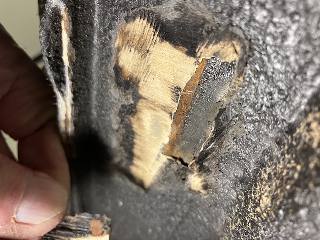

Curious about white plastic(?) like material along a portion of long. It’s kinda tough and resists scraping, prying, etc.. Look normal? Thoughts?
Posted by: mepstein Feb 26 2024, 10:16 AM
Fiberglass patches?
Posted by: Rufus Feb 26 2024, 10:20 AM
Ooooof!
Posted by: burton73 Feb 26 2024, 10:35 AM
That is Wurth put on from the factory. Same on my 6.
It better to view the right side under rocker because it catches water and gets trapped at jack post on a number of cars.
Bob B
Posted by: Rufus Feb 26 2024, 10:44 AM
Will do. Not sure if today or tomorrow
Bob B., think there’s any possibility the Wurth is new; that’s what MR’s advert said?
Posted by: 930cabman Feb 26 2024, 10:57 AM
I'm seeing rust, but perhaps not catastrophic
Posted by: Rufus Feb 26 2024, 11:05 AM
Agreed 930cabman. Thinkin I might attack the white layer next. Concerned it may not be good news underneath
Posted by: mountainroads Feb 26 2024, 11:53 AM
QUOTE(Rufus @ Feb 25 2024, 02:25 PM) *
And kinda like believing everything your local body man / painter says without checking yourself, huh? After all, he reassured you, right?
Yes, I know, I said I was done posting to this thread. The following occurred to me last night so I'm adding now.
Yes Rufus, that was my mistake. I trusted Rillos to identify and properly fix what needed to be fixed. I trusted him to say "This should be taken care of." I didn't think I needed to observe every move or stand there and watch every step or part that was installed. I hired pros because they were supposed to be the experts, not me. You missed the part where I said I regularly checked on progress. By regularly, I meant at least once a month, and often weekly.
Not once did I tell any shop not to do something because it was too expensive or I didn't want to pay for it.
- MR
Posted by: SirAndy Feb 26 2024, 12:05 PM
QUOTE(Rufus @ Feb 26 2024, 08:44 AM) *
The white coating is from the factory, that's what they used to protect the underside of the car.
The weathered black coating is probably from way back when and dealer applied.
The fresh black coating is aftermarket, which is most likely what the seller referred to.

Posted by: Rufus Feb 26 2024, 08:16 PM
I’m closing out this segment of the story.
Attached pics show two chips containing the Porsche white PVC undercoating (most visible in edge views) removed from the bottom left long surface. There’s also a curled up section that was shaved off by razor blade. And finally some minute material shavings on the razor blade. I see no evidence of reinforcing fibers which leads to my conclusion.
This doesn’t point to the possibility of something intentionally applied for nefarious reasons. But the longs will be stripped bare to confirm all is well. The PVC coating is damaged, and may not provide protection different than a modern epoxy anyway.
On to the next step …

Any sort of applied undercoating ???
This is almost ALWAYS (at least 99%) a sign of some sort of coverup. Should be a major red flag for a problem.
Indeed. And I learned that myself. See my build thread.

QUOTE(Rufus @ Mar 5 2024, 07:05 PM) *
That’s all factory there . Barking up the wrong tree on that

Posted by: Rufus Mar 6 2024, 10:42 AM
QUOTE(mb911 @ Mar 6 2024, 08:34 AM) *
Good to know, thanks Ben.
Anyone have pics of this on other 914’s. Its purpose?
Posted by: Superhawk996 Mar 6 2024, 12:39 PM
QUOTE(Rufus @ Mar 6 2024, 12:42 PM) *
Rufus,
I’m trying not to take this post the wrong way but it seems that you’re questioning the legitimacy of Ben’s response.
Giving the benefit of the doubt, the drain hole(s) is/are on OEM floorpans. There are several of these on the pan. You will not find them in the aftermarket reproduction pans.
Not sure I’ve ever seen a photo of 914 dip tanks for phosphate / degrease but you get the idea.

Posted by: DRPHIL914 Mar 6 2024, 01:30 PM
QUOTE(Rufus @ Mar 6 2024, 11:42 AM) *
the seam sealer on those areas can be thick and was placed on all the seams like the round holes like in the floor pan, and as ben said then it looks like orignal seam sealer and then the undercoating over the top of it. sometimes that would develop a gap or separation as it aged and then moisture made its way behind it and you find surface rust under or along it, i did on my floor in a couple spots. My hell hole had big gobs of it along the fire wall , at first i thought it was a bad repaor or caulk by someone but as i cleaned up the area a piece broke loose and i discovered this was original to car but had some layers of repaint and caked on under coating that was sprayed on by dealer! so even though my floor was bad in some spots from leaking windows letting water get in and rust out the pan uder driver seat, my hell hole was actually rust free!. This goes back af few years ago to when i was cleaning it up to get the floors repaired and have the car prepped for paint.
Like me when i really dug in and looked i found some stuff, that would not be found with superficial inspection. you will find more, no fault of anyone, just bite the bullet and get it done,
Phil
