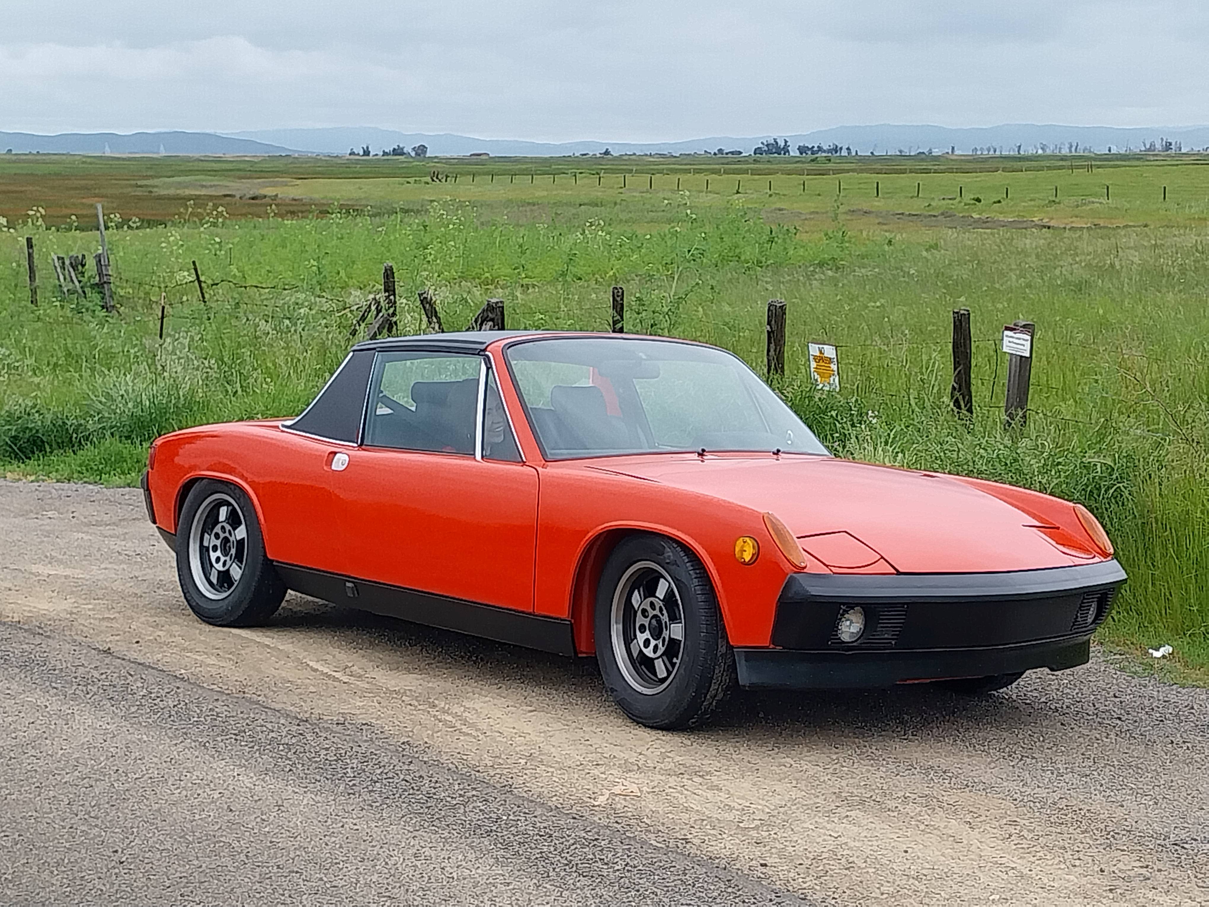

Nice job! A big huzzah for getting another one back on the road.
what a beauty.
