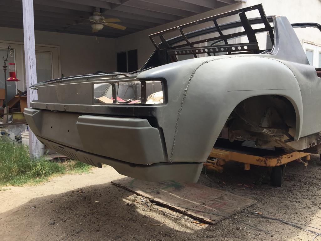

Have any of you guys made a front valance out of metal for GT flares and cooler cut out?

So far I have done the rear. Not a bad job.

Hey Shivers, I love the custom rear valance! Swear to G..goodness I've been planning the same and would be incorporating a venting section from an old vw. I did something very similar (but not as nice as yours) at the front end of my '71 Volvo P1800 a few years ago. I stole that idea from a nicely modded Mercedes gullwing. Anyway good job - I'd love to see it all painted up - got a build thread?

Thank you. No build thread yet, I post all this stuff in the "What did you do to..." thread
