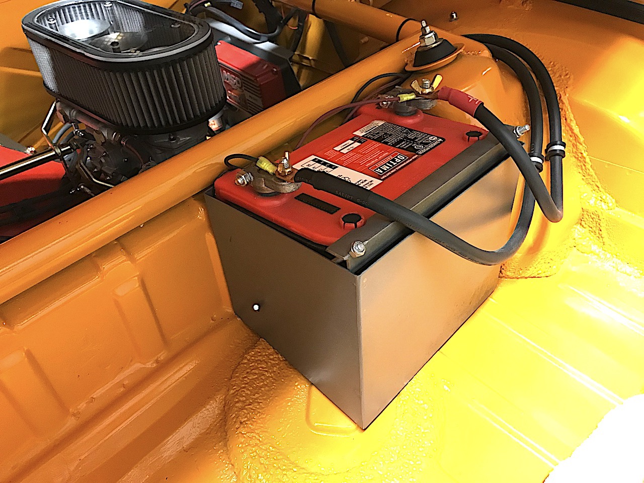

To give you all an idea. I will make sure the wiring is cleanAttached Image
Posted by: mlindner Jun 13 2024, 04:42 AM
Nice job Ben, talk about clean and organized. The best I've seen. Mark
