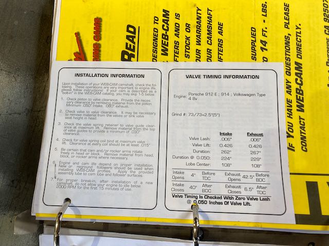

Thanks for the help everyone. This is the cam card. I believe that it was Rich Towle who suggested it, but it was quite some time ago. I rebuilt the motor because of excess smoke from rings and valves and added this web cam order.
Note: I ran the car and autocrossed it for a couple of years with this cam. And yes, I had to tweak the MPS and buy and use an inductance meter and A/F gauge and monitor head temps. It leaked oil though, and with the motor out I found that the body needed a lot of repair. So, this is the awakening of a motor rebuilt to fix oil leaks and set aside for 4 years.
I hope that settles the cam part. Also, the motor has run recently. But it seems to be less and less willing to start.

Interesting, so definitely run diagnostics on the MPS and verify the injectors are firing at the command of the trigger points. That should lead you to the next step. Did you put a new harness on it?
