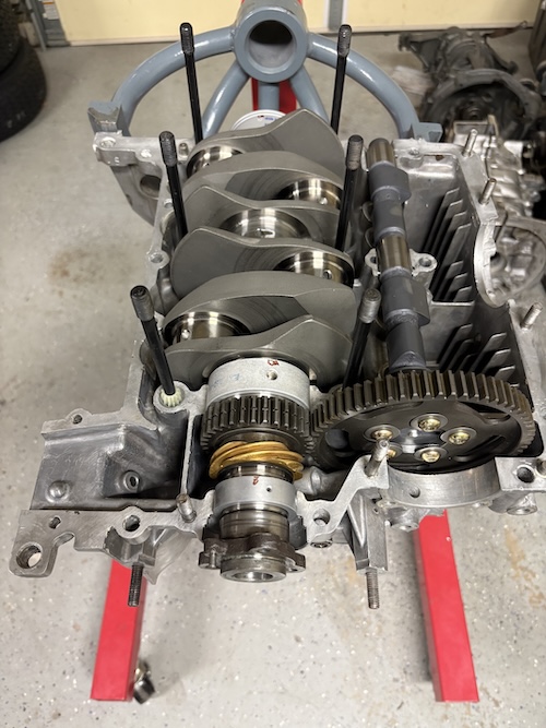

Posted by: friethmiller Jun 27 2026, 05:16 PM

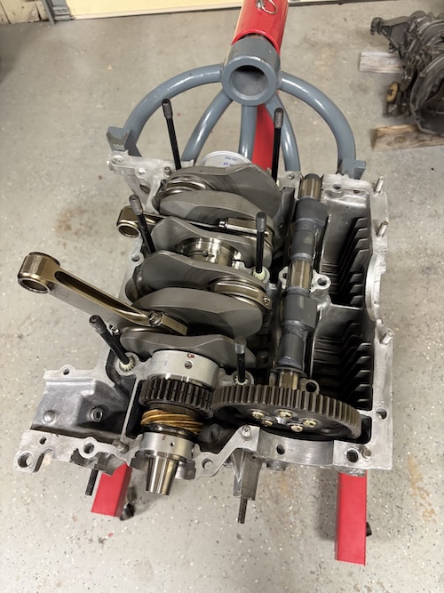

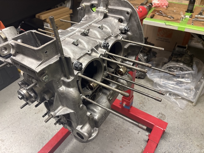

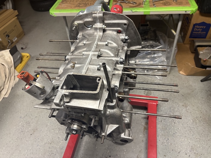

Initial Layout (6/27/2026):
After about 5 hours of driving to go get my engine parts, I got home just after lunchtime today. I started laying things out in an attempt to get things organized. I took a few pictures. As I mentioned earlier, my original EA case will not be used on this build. Instead, I will be using my back-up W-case that I had machined late last year. The problem with the EA case is that 2 of the mains are too tight. So this case probably needs align bore. I'll do this at a later date. Hell, I've got the LE case getting worked on at the moment. The machinist bill is high enough at the moment - thank you. blink.gif
Here's a pic the W-case on the stand. This was align-bored .20, oil-galleys tapped, with the cylinder openings just cleaned-up (no need for decking). Work was done by EMW in 2025.
The dual-spring 1.8L heads were cleaned, inspected, and reassembled. These heads were previously reconditioned [back in 2020] and checked out fine. They are port & polished with 44/38 valves.

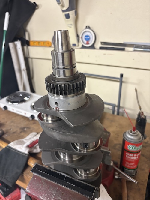

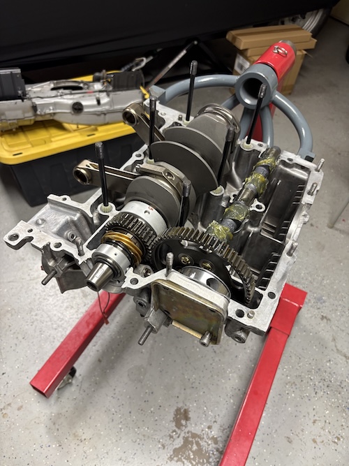

Going with a new 78mm crank. This is why my 2.3L will become a 2.2L.

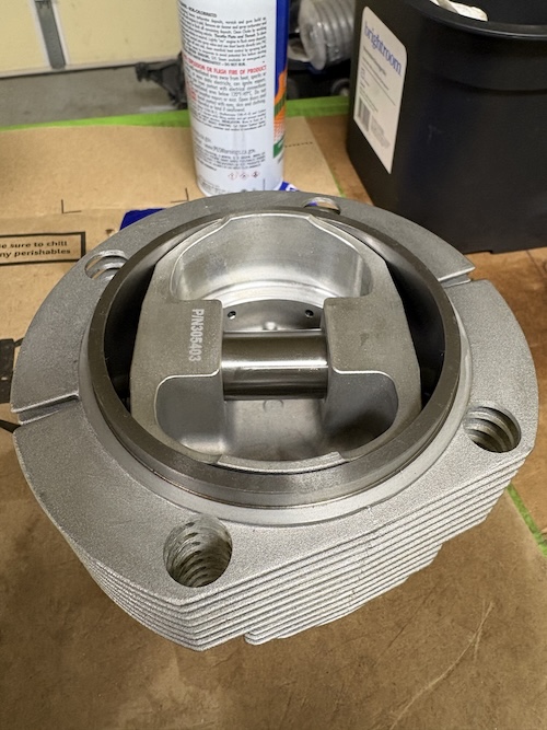

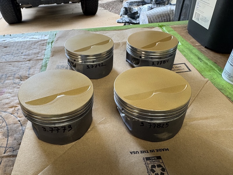

Pistons are new 96mm forged JEs with ceramic coating on the sides and top. Rods checked out fine but were modified for better oiling. Note off-center oil grooves.
Cylinders are original German 93mm, 1.8L units that were sandblasted, painted with flat black paint, and then bored to 96mm

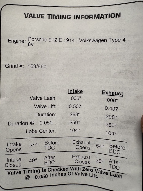

During this layout I ran across two different cams that I had purchased last year for this build. I think I'd like to go with the 163/86b for this one. We'll see. Would like input from others on this choice. More to come soon. Cheers! beer3.gif
Posted by: seanpaulmc Jun 27 2026, 05:57 PM
1. Who’s crank?
2. Is that oiling groove on both sides of the connecting rod?
Cheers,
Sean
Posted by: Jack Standz Jun 27 2026, 06:05 PM
Hi Fred,
Me thinks that's a great cam choice. It's pretty much what Raby developed and sold (maybe with a different LSA, not sure?).
Might want to run it a little advanced. We have two new ones (163/86b) in the boxes for upcoming projects, but was a little disappointed that we could only get them with 104 degrees lobe separation. But, understand that "custom" cams are months and months and months away. mad.gif
Webcams makes good cams, so hoping you (and we) are happy with them!

Posted by: friethmiller Jun 27 2026, 06:40 PM
QUOTE(seanpaulmc @ Jun 27 2026, 06:57 PM) *
1. Who’s crank?
Cheers,
Sean
1. I think this is a AA performance forged chromoly crank
2. Yes. The machinist has a lot of experience with VW engines. He said he prefers an offset 'U' groove on both sides of the rod. He mentioned better directed oil spray at the bottom of the piston. I assume the groove would need to be on the top but will verify with him before assembly.

So, 2258 with flat tops and the 1.8 heads.
Have you figured compression?

Posted by: friethmiller Jun 27 2026, 07:16 PM
QUOTE(Ninja @ Jun 27 2026, 07:55 PM) *
Ah, meat and potatoes...
Thank you!
Parts look nice!
Yes. I'm targeting 9.1 - 9.2, depending on deck height. The chambers are 60cc with a 0.9cc valve pocket in the pistons.

Posted by: friethmiller Jun 27 2026, 08:35 PM
QUOTE(914werke @ Jun 27 2026, 08:43 PM) *
Curious , why offset as the published description of this mod was centered ?
Rich, I think it’s a matter of cooling the piston vs the wrist pin. Not 100% sure. I’ll get more details on Monday.
Posted by: friethmiller Jun 27 2026, 08:59 PM
QUOTE(Montreal914 @ Jun 27 2026, 08:49 PM) *
All this to say that your LN lifters may be WebCam ones.

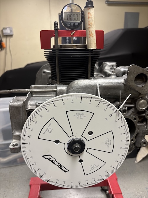

Right! I will find out. Here are the cards from both cams. 104 lc on both.
FYI, my intake/exhaust valves are 44/38 and my exhaust is a full 1 5/8” tangerine header + muffler.

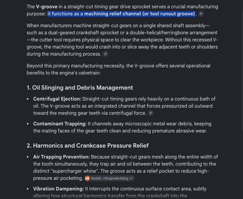

Trying to verify dimensions here. What is the standard case bore for the type 4 engine? AI says 2.559”. That seems too small. I’m measuring roughly 2.768 for the rear main on a case with a .02 line bore. Why am I off a decimal place? idea.gif

Posted by: cgnj Jun 28 2026, 06:06 PM
@http://www.914world.com/bbs2/index.php?showuser=22863 AI is not your friend. That is for a type 1 motor.
Type4 Saddle bore is 70mm or 2.756. 2.768 is correct
Posted by: friethmiller Jun 28 2026, 07:15 PM
QUOTE(cgnj @ Jun 28 2026, 07:06 PM) *

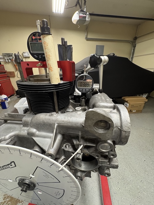

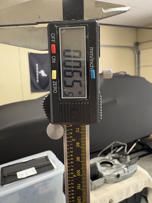

Posted by: friethmiller Jun 29 2026, 06:08 PM

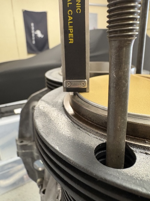

Ok, I've confirmed two things.
  1. My EA block is too tight on #1, #2, and #3 saddles, as identified by my machinist.
  2. [Thankfully] My W-block checks out at .020 line bore
Working from a STD bore of 2.756" + .020 bore = 2.776". I used the 2-3" micrometer to set 0 on my bore gauge for #1-#3 saddles. Adjusted tips to set zero on my 1-2" micrometer for the #4 saddle at 1.9685 + .020 bore = 1.9885.
Photos of my work to measure each saddle in multiple directions. Will proceed with verifying my brand new crank next before preparing for assembly. So far so good. aktion035.gif
Thanks again to @http://www.914world.com/bbs2/index.php?showuser=403 for the specs!

Update:
I spent a lot of time this weekend in the garage attempting to get good measurements on both my EC and W cases. While I measured the EC block's saddles a little tight, the W case measured a little loose from the .20 bore specs. However, once the .50/STD bearings were installed in the cases things changed a bit.
The saddle measurements where taken in relationship to a book value of 2.776 +/- .0004. I basically adjusted my 2-3" micrometer (zeroed with a 2" standard) to 2.776" and locked it in a vise. Next, I took my bore gauge and zeroed in the micrometer. From here, I measured roughly in the 9-3 o'clock and the 12-6 o'clock positions.
To determine the bearing clearance, I first measured the crank main journals with the digital 2-3" micrometer. From my measurements, all 3 main bearings were 2.3616". Locking in this value, I then clamped the micrometer in the vice and zeroed the bore gauge to this value. From here I measured several times in each of the clock positions on either side of the oil groove for each bearing. I did this multiple times throughout Saturday and Sunday to come up with a set of clearances for each of the first 3 mains on both blocks. These numbers represent the "tightest obtainable value" in and around the measurement areas using the bore gauge.
Not that these are set in stone. I want to continue working the instruments till I'm satisfied with all the numbers I'm getting. Repeatability is the word, I guess.
Including other photos I took while measuring the cases. Note the arrows showing the oil relief in the rear main of the EA Case as well as the "relief" areas that were required to handle the previously installed 82mm crank. We will be switching down to a more manageable 78mm unit with this build. smile.gif
Posted by: friethmiller Jul 6 2026, 07:56 AM
W Case Measurements:
Went out to the garage this morning, pulled the bearings, re-torqued the case, and took the following saddle measurements of the W case. FYI, this case was line-bored back in January of 2025 by EMW. Note: Anything in red is out of range, yellow is borderline, and green is within tolerance. Positive numbers are larger than mid-range spec. Negative are smaller than the mid-range spec.
So, if my measurements are accurate, I'm unwilling to use this block as-is. I'll do the same work-up on my EA case at lunch. Let me know what y'all think. TIA.

Posted by: friethmiller Jul 7 2026, 06:26 AM

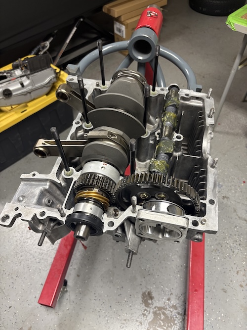

Initial Mockup
Used a light coating of assembly lub on the bearing surfaces and installed the crankshaft into the EC case. I checked for good rotation throughout the process. Installed the other case half, checked rotation, and then torqued the case in sequence. Final test was just the same. The crank moves freely 360 degrees by hand - no issues.

Oil Pump Checks:
Measured my Schadek 30mm pump that I had used on this engine previously. After measuring it, I can feel a little better that my low pressure problem might have source from this housing. I couldn't get any measurement to hit the 70mm mark. My new, o-ringed, 30mm Schadek pump does. When I set the micrometer to 70mm, I can get the it to pass over the first pump without much of a problem. Whereas, I can't do the same with the new pump.
If i go with the new pump I'm going to need to source at little bit of a stand-off or a thicker gasket to pull the o-ring back into the bore just a bit. This is obviously not an issue in the Type 1 cases. No decisions have been made on any pump yet. Still measuring...

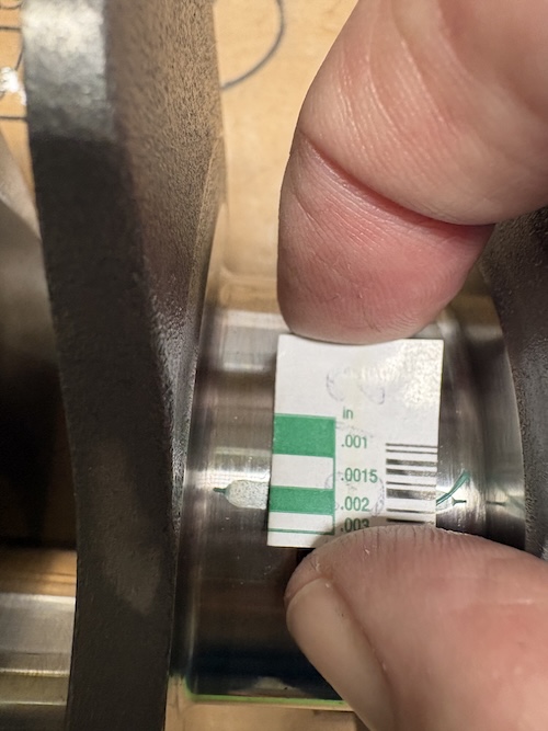

I like Plasti Gage, it has worked well for me in the past and please trust I am far from an "engine builder", I have completed many air/water cooled rebuilds over the past 50+ years and have learned a thing or 2, but always check and double check everything and still check again.
Having the correct gauging tools is key here and I have never used the correct tools, but would like to assume the professionals have the right stuff and fully understand how to use them.

I like Plasti Gage...
Me too! I think about it like this. If I miss-measure my crank's main journal with my micrometer (i.e. too tight), that will translate in a inaccurate zero setting with my bore gauge, and my clearance will be off. Plastigauge might seem crude but it doesn't have this problem. So, in regards to bearing #2, I'm absolutely going to use plasticgauge as an alternate measure. I just wish I could get it to work on the other journals. sad.gif ...and let me know if you have a trick.
I'll pull the plastigauge out tomorrow and give it a go on #2. BTW, the material on this split bearing is different from the others in the set and is starting to show perpendicular scratches from all my bore gauge measurements. This could easily "tighten" the measurement here. And I am highly suspect of the 9-3 o'clock measure here. I'll snap a few pics of the results and report back.

Posted by: friethmiller Jul 11 2026, 08:08 PM

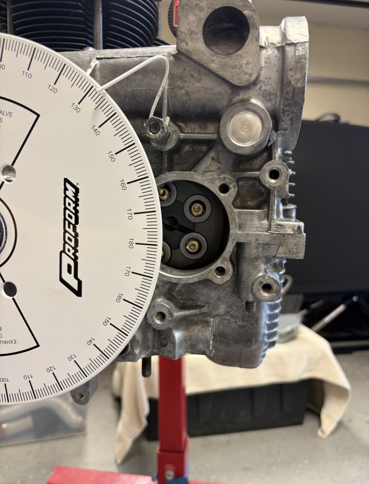

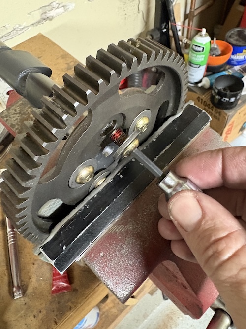

Moving Forward
While I wait for another case from Mark to arrive, I thought it best to move on with the crank to rod clearances. I measured the rod journals at a pretty consistent 1.9694". Zeroing the bore gauge to this, I got a very consistent .0015 - .002 on each rod. In fact, every rod measured .002 at the 12 o'clock position and .0015 everywhere else. You can see that I went "full clean" on these bearings/surfaces. I'm not planning on taking these bearing back out.
With the case an unknown still, I can't install the #3 bearing and gears on the crank yet. So, instead, I gave everything a good "initial clean". Note the use of straight gears on this build. The machinist highly recommended I make this switch based on the HD double springs I'm running in my heads. The second pic shows me cleaning the cosmoline off of the cam gear.
The next three pics show the 163/86b cam being installed with the gear in the padded vice. I'm assuming that I should be using the center (non-offset) washers for this gear. I will need to verify this tonight.
Final two photos show me lapping the oil pump cover on a piece of glass+sandpaper taped to the table. Despite the weird reflection in the photo - this thing was already flat. I must have done it last time. Better safe than sorry. aktion035.gif
I'm also working on several todos in the car's engine bay. For instance, I've already run a return line back to the tank and just need to pipe it up to the new fuel pressure regulator. This regulator is new and needs to be cleaned and installed, as well. I'll document some of this tomorrow. Till then.... Cheers! beerchug.gif

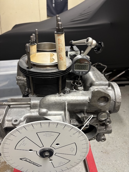

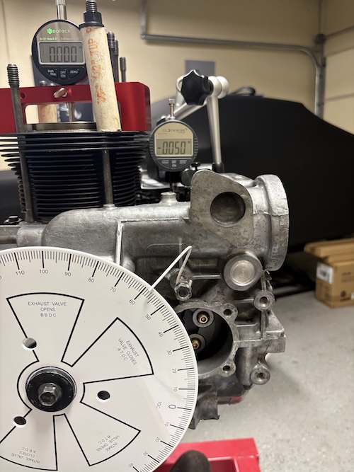

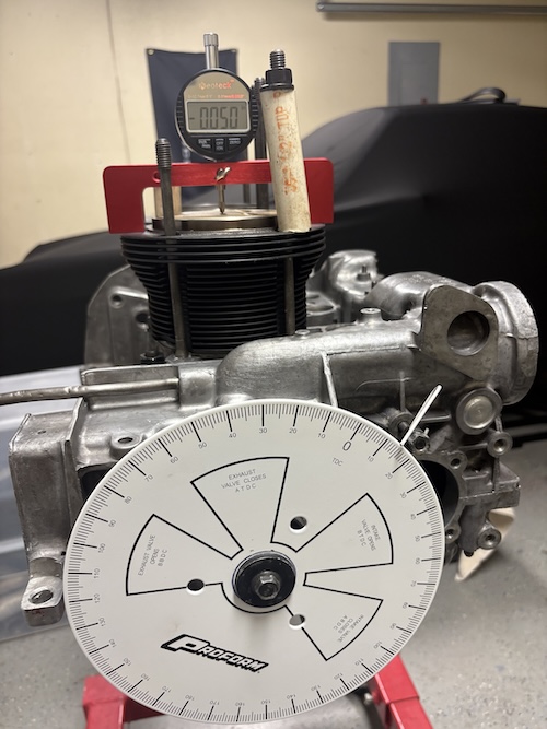

Yeah, I forgot about "Cam Degreeing". Damn! It just hit me with a type 4 ... this means I will need to mock-up the entire case/components, install the jugs, do this test, and then tear it all back down again to potentially use the offset cam gear washers. Nice! This should be exciting biggrin.gif
Posted by: Jack Standz Jul 11 2026, 10:31 PM

BTW when you degree the cam, it might be interesting if you could share where you set it and why please. However, kinda hard to get it "right" without a dyno. Looking forward to where you end up setting it either advanced or retarded. Of course it looks like you might be trying to just make sure it's straight up.
Posted by: friethmiller Jul 12 2026, 05:13 AM

Posted by: friethmiller Jul 12 2026, 07:35 AM
QUOTE(Jack Standz @ Jul 11 2026, 11:31 PM) *
Well, for now yes. I'm straight at 0 degrees. Depending on my measurements, I may need to advance or retard using the washers. That means my assembly of the case is without sealant till this is dialed-in. beer.gif

@http://www.914world.com/bbs2/index.php?showuser=24877 - Plasticgauge on the W-case. Brand new set of .50/STD bearings. Clearance on #2 bearing is confirm at .0015". Included a few pics.
Before & After Installing the crank with bearings (torque'd to 25lbs on the 6 case bolts).
Measuring the gap:
Posted by: Ninja Jul 12 2026, 11:38 AM
QUOTE(Jack Standz @ Jun 27 2026, 07:05 PM) *
Hi Fred,
QUOTE(friethmiller @ Jun 27 2026, 09:59 PM) *
QUOTE(friethmiller @ Jul 12 2026, 03:59 AM) *
QUOTE(friethmiller @ Jul 10 2026, 01:27 PM) *
QUOTE(Jack Standz @ Jul 10 2026, 01:16 PM) *
Fred,
Where did you get these thick gaskets? They look like just what we need for some o-ringed oil pumps/projects.
These came with a 26mm maxi-pump from CB Performance. I had already ordered these "thicker" gaskets from them before I found these in the LE's engine box. They'll probably be the same. I think they're arriving tomorrow. I can let you know.
Confirmed on that thicker oil pump gasket from CB Performance. You can buy it as a separate item.
Thanks for checking Fred. Couldn't find it on their website, so was planning to go old skool and call them biggrin.gif .
Jack speaks the truth!
It's super common to see cams degreed in with a bit of advance (for street use) or a bit of retard (high RPM race use).
But, it all depends on how the restrictions line up in the engine. How well the intake flows against how well the exhaust does.
The T4 is the single hardest "cam timing adjustment" engine I think I've seen yet.
Gota take the puppy completely apart to change anything!
I'm building a Toyota 3S-GTE Turbo MR2 engine with my son and I have adjustable gears. You put it together without the upper timing belt guard and you can alter cam timing in less than 5 minutes.
On that you wait till you're on the dyno before even worrying about cam timing.
I'd want LN, Raby, or Len Hoffman's take on cam timing for your set up if I could access that info.
Without a wizard's oversight, I'd put it in between 2-4 degrees advanced and run it (for street use).
You CAN degree a cam without pistons/rods/valve train, but you cannot find accurate TDC without at least one piston/rod/jug installed. You just take the cam timing reading off of a lifter.
That .050 timing measurement changes if you're taking the reading off of a lifter instead of a spring retainer. It will change depending on your rocker arm ratio.
I believe "off of the lifter" is more accurate than "off of the retainer".
Can you provide a close-up view of the main bearing bore surfaces on the line bored engine?
I'd like to see the surface machine marks.
I'm still having trouble with "how does a fresh line bore be non-concentric" as the machine itself cuts very accurate circles. They can easily be too large or too small (machinist error) but "out of round" seems impossible without a severely worn-out machine.
I use Plasti-Gauge on all of my builds as a final check. It's a verification tool after all the actual measurement are done. Yours looks great!
Plasti-Gauge shrinks with age! If it is 6 months old, it's GONE in my book.
I always buy new from someone like Summit as I'm hoping to get the newest stuff possible.
Posted by: 930cabman Jul 12 2026, 01:16 PM
QUOTE(friethmiller @ Jul 12 2026, 09:26 AM) *
Measuring the gap:
Lookin great, and no, I wish there was a way to check the other main bearing journals with Plasti Gage. Rod bearing clearances a yes
Can we assume all the main bearing bores and the same size and in line?
Posted by: friethmiller Jul 12 2026, 07:51 PM
QUOTE(Ninja @ Jul 12 2026, 12:38 PM) *
Here's a few pics of the W case saddles. Any vertical marks are from me and my dial bore gauge.
If I use a metal ruler and sit it flush against the #2 saddle, you can see light under saddle #3. Saddle #1 looks pretty good. I'm not sure this ruler is good test but it doesn't lay flat. I made sure not to use #4. Need to find a piece of aluminum bar or something.
First photo show the ruler flat across the #2 saddle, with the headlamp against #3. Second photo shows the gap. Third photo is of saddle #1, no light.
Again, I think I need a better, thicker straight edge.
Posted by: friethmiller Jul 12 2026, 08:13 PM
Ok, I reassembled the W case again without bearings. I measured the 1-3 saddles for the 400th time - but this time in metric biggrin.gif
Reminder: A standard case saddle is 70.0mm and a case with 0.50mm line bore should be 70.5mm +/- .02mm.
W-Case Saddle Measurements:
Saddle #1 : 9 o'clock position is 70.55mm; 12 o'clock (parting line) is 70.55mm
Saddle #2 : 9 o'clock position is 70.53mm; 12 o'clock position is 70.54mm
Saddle #3 : 9 o'clock position is 70.53mm; 12 o'clock position is 70.50mm
I've been "over-bored" This is a worst "case" scenario! blink.gif Inadequate bearing-crush. Not good.
Rant: Why the hell don't they make enough type 4 bearings? And how about making some +/- bearings for custom fitting an engine for the above scenario?. There's no boring past .50mm mark.

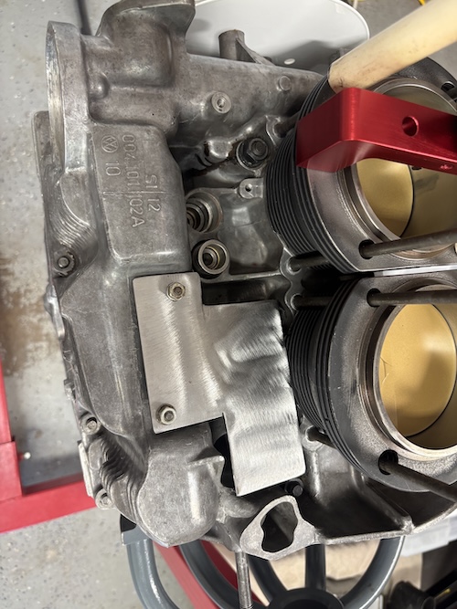

Fuel Regulator:
I needed to mount the new PMO fuel regulator at carburetor height in the engine bay. With the way the fuel lines are already routed, this meant installing it somewhere on the back wall of the engine bay. Unfortunately, the center position is occupied by the TR oil catch can/breather. The supplied mounting plate was good but wasn't the right size for the mounting location. So, I set out to fabricate a mount of my own. Note the diagram in the first pic. The return line output is on top then input with two outlets on the face that go to the carbs.
From the cut out that I had mocked up in the engine bay, I went out to the shed and found some scrap 16 gauge sheet metal. After cutting the shape, I then drilled the necessary holes, painted it, and then mounted the regulator.
I then mounted the entire assembly against the back wall. You may notice that I did do a little bending of the mount itself. I needed to account for the angle differences of the bolt location on the back wall. I also bent the mount below this point (horizontally) to allow the regulator to set more upright. The one problem with the mount as I found out was the interference with the hose clamps. I need smaller clamps for the 8mm hose for sure but I may remove and cut the mount a bit to alleviate the problem. Not bad though. smile.gif
Final photos show the routing of the lines and the lower firewall. With the added return line and my A/C wire routing + new bus bar, things sure have gotten congested in this area. I still need to clean up the hoses and wire with a few good zip-ties. Again, not too bad.
Posted by: Ninja Jul 13 2026, 08:08 AM
WOW! those machine marks don't look even...
Doesn't look like they dressed the edges either!
Your ruler test looks like crap!
How can they machine it like that?
There is a "fix"...
You won't like it.
Machine both sides of the parting surface on the cases .010.
You will need a really competent machine shop at that point.
Easier to find another case.
Posted by: Ninja Jul 13 2026, 10:43 AM
Heads up!
Checking line bore without the cases bolted up is the INCORRECT way to do it.
Cases should be torqued up!
However, I just checked this on my torn apart 2.0l GA cases I mentioned exactly like you did and mine seem straight...
I used an 18" Mitutoya machinist straight edge that has been checked for accuracy with a 36" Starrett straight edge.
The light emission under each journal were identical.

Engine Assembly - Part 1 (8/22/2026):
With the case, crank, and bearings back from Brothers VW Machine, I quickly verified measurements and then completely rewashed the case halves to get ready for assembly. The guys had lightly ground my new crankshaft to provide a bit more oil clearance. I did have an issue with measuring the #2 main but I verified it was just my measurements of the crank journal OD and I verified it with some pastigauge.
With everything cleaned, I set out to slide on the gears and test fit everything into the case. Even with the case torqued, everything felt good, no issues rotating the crank with one hand. I did trade out one of the thrust bearings on the cam. One half was too tight so I swapped it out with a spare. I am running a double thrust for this application, of course.
I then pulled everything back apart and cleaned and installed the rods that were already to go.
Again, the case was reassembled and torqued. This time I proceeded by installing all of the head studs using the permatex thread sealant. Next, I added pistons & cylinders for 1&2 (without rings) and got things ready for degreeing in the cam. The timing wheel I was using wasn't really made for VW engines and I had to remove the air/fan shroud studs to properly "clamp" the wheel with the crank bolt. I also used a short section of a clothes hanger to act as a pointer. Pretty easy to do.
So after watching about 6 different Cam Degreeing videos, I felt like I might actually understand what I had to do and why I was taking these measurements. beer.gif
First step of the process was finding true TDC, which was roughed in by eye and then adjusted by going .050 in either direction to verify my zero (TDC).
With this initial task complete, I then moved over to setting up something to measure intake lift using a installed lifter. To set this up, I cut a piece of 16 gauge sheet metal to allow my magnetic base to clamp down to something. I used the 10mm studs on the side of the case that normally secure the thermostat. The next job to do was to measure max intake lift. And here's where things got off track a bit for me. I was getting lift measurements that were low and I couldn't figure out why initially. It turned out the two small bolts that my base was secured to were not enough to prevent the entire stand from moving during this measurement. I think If I had secured the base using a third bolt somewhere, I probably wouldn't have had the issue. To get past the problem, I simply jammed a box wrench between the base on the engine case to prevent things from moving. Another issue was the reach of the dial gauge. It wasn't long enough to reach far enough into the lifter bore to take any measurements at all. There just too much stuff in the way. I got around this problem by stacking a second lifter in the bore. This worked great for me but I'm sure a longer pointer would be available for purchase for the bore gauge. With all the bandaid fixes deployed, I was finally able to get a measurement of .3895 which is just shy of .390 that, when multiplied by the 1.3 rocker arm ratio matches the targeted .507 of valve lift. cheer.gif
Once you have max valve lift, you can then find your lobe center. This is where I zeroed the dial gauge at max lift and then rotated the cam wheel .050" in either direction taking the degree measurements.
For this I got 145 and 59 degrees. Adding them together, I got 204 degrees and then dividing this number by 2 and got an intake lobe center of 102 degrees. I know that if the number is less than the expected value of 104 degrees, the cam is "advanced" by 2 degrees. I think 2-4 degrees would be ideal for street use and might be good to go here. More measuring coming soon. Cheers! beerchug.gif

Ok, intake duration measured .05 open at 23 degrees before TDC and closes (0.05) after BDC at 47 degrees. That’s (23+47+180)/2 = 250 degrees of duration. That’s spot on! Exhaust is next.
Posted by: friethmiller Aug 23 2026, 08:53 AM
@http://www.914world.com/bbs2/index.php?showuser=4366 Standz, note I’m using a 9inch wheel here. Anything larger would probably get in the way of easily replacing the offset washers on the cam. I’m good with splitting the case again for the oil pump install but with a normal pump you could just install it and move on.
Posted by: 930cabman Aug 23 2026, 09:33 AM
I would take my time, check and double check everything
Go Fred go
great project, thanks for posting
Posted by: friethmiller Aug 23 2026, 09:36 AM
Exhaust:
Calculated max lift of .496
Lobe center: 108 degrees
Duration: 262 degrees
That’s an ICL of 105.5 ATDC and an ECL of 103.5 BTDC
LSA = (105.5 + 103.5)/2 =104.5

Building up the Short Block (8/23/2026):
First pic shows the base I made for my dial gauge stand. At 16 gauge, it just wasn't thick enough and it needed a third point to really lock it down and keep it from moving ever so slightly.
Before tearing everything down, I took the opportunity to get a rough sense of the shims I would need to order to set the proper deck height. You can see how a longer 78mm crank pushes the piston above the top of the cylinder. I'm basically plus .065.
With the cam properly degreed, it was time to prep everything for the final install of the case halves. I had to loctite in the cam bolts, test fit the oil pump, insert/index the distributor, lubricate everything that needed oiled, and clean-up mating surfaces. Here's a few photos.
Here's the assembled short block. I did run into a problem with the oil pump. It was already clearanced for the cam bolts but the snout of the pump was actually bottoming out where the drive gear locks into the center of the cam. And it only happened once the pump was torqued. And it locked the cam/crank solid too! Scared the crap out of me. blink.gif Not surprised, though. I've never worked with these special straight cut sprockets before. I work to get this problem solved next. More on this soon.
Posted by: Jack Standz Aug 24 2026, 12:52 PM
QUOTE(friethmiller @ Aug 23 2026, 09:53 PM) *
Hi Fred, thanks for the info and photo. Not sure how large the diameter our degree wheel is, but will check. Think it's a Moroso.
Also, we have a straight cut set of cam gears too for the 2615 project. Because we think the thrust bearings would take a beating using helical cam gears (even though we modified a set). Still wish a larger LSA cam was available, at least as an option. But, since they aren't available, one less decision to make biggrin.gif

Great progress, question is the relief cut (vee ) in the driven gear to reduce oil foaming or some reduction in noise ? , don't know much about these conversions but the T1 guys mentioned increased noise ? thanks and good luck .
Posted by: friethmiller Aug 25 2026, 09:17 AM
QUOTE(porschetub @ Aug 25 2026, 01:21 AM) *
... question is the relief cut (vee ) in the driven gear to reduce oil foaming or some reduction in noise ? , don't know much about these conversions but the T1 guys mentioned increased noise ? thanks and good luck .
Had to search it. It does a lot of things to include the items you mentioned.

Oil Pump Clearancing (8/24/2026):
Well to get the clearance necessary I had to remove the cam bolts one at a time using heat to loosen everything up. Didn't have any troubles but I did take it easy. I certainly didn't want to strip out the allen heads.
Each bolt was then mounted securely in the vise and filed down/sanded by hand/cleaned. Next, the washers were sanded to smooth out any imperfections. I had to eliminate anything that might prevent the washers from sitting flush in the gear. The next pic shows a bit of work to the pumps drive gear. I used a black marker to help identify any contact/rub points. I also sanded any rough edges on the gear teeth.
Next two photos show the relief to the back of the pump and the cam bolts. I think ideally the cam gear bolts might need to be counter-sunk into the cam washers. Not sure if this is even possible, though. beerchug.gif
So, after test fitting everything without a gasket and getting everything to clear properly with the pump bolts torqued down, I was finally ready for reassembly. After having to insert/remove this pump about 30 times, I had developed a technique for getting the pump perfectly lined-up to go in with one push. So, I decided to roll the dice and insert the pump with the o-ring. You can see in this pic that I've prep'd the gasket (both sides with Curil-T) and used a little bit of assembly lube on the pump body and gasket. I also applied a little bit of lube to the oil pump bore on the case to help protect the o-ring as it went in. And....... after a few tense moments of making sure of my alignment, I was able to push the pump in place. I'm 99.9% sure that the o-ring is still good and right were it needs to be. biggrin.gif
I also took a pic of the thickness of the pump gasket. It's over .060". I wasn't sure what it might crushed down to after torquing but I was glad to have a little more clearance b/w the pump & gear.
Once the pump was in, I focused on cleaning and preparing the cover. This cover was used before and you can see I had a little interface issue with the previous pump. However, I think I have this pump is a little better prep'd. Again, a very light coat of Curil-T on both sides of the paper gasket. Cover went on, and then finally the nuts/washers with a bunch of thread sealant.
I then tested that the engine rotation was good about 3 times during the torque sequence. blink.gif The final test was good to go. I had full unbinding engine rotation using one hand on the crank's snout bolt. aktion035.gif
Posted by: friethmiller Aug 26 2026, 03:55 PM
Crankshaft End-play (8/25/2026):
I had 7 shims to work with last night. I had to take up most of the .050" that I initially measured without shims - targeting the magical .003 - .005 range. After a few tries I was finally able to get 0.003. It's a consistent .003 - .0035 too.

Preparing Pistons & Cylinders (8/27/2026):
In preparing for pistons and cylinders this weekend, I cleaned up the work tables and pulled out all the parts and tools I'll need for this next phase of the build. I also took the opportunity to add the small items to the engine to help get stuff out of the way.
Installed the high and low pressure reliefs, front engine mounts, oil filler tower as well as the oil plug, oil screen, and inspection/taco plate.
Ring End Gap
I've got 96mm cylinders; so that's 3.78". Based on the supplied chart, this would calculate as 3.78" X 0.0045" = 0.017". Can this be right? The difference between the JE and the KB piston gap is pretty substantial, I guess.
Cylinder Wall Gap
I'm also looking at Piston to Cylinder Wall Gap. I got a new battery in the 3-4" micrometer, zero'd it, and then took this initial measurement on one of the pistons. Spec says measure point is 0.5" up from the bottom. More to come on this soon.
Weekend goal is to, at a minimum, have the P&Cs 100% ready to install. The cylinder shims that I ordered from AA should arrive tomorrow so I'm hoping to everything in and ready for heads/value train by late Sunday. We'll see. Cheers! beer.gif

Piston to Cylinder Wall Clearance (8/29/2026):
Thought I'd verify the clearance for the pistons before moving any further along with the build. The spec for these 2618 forged pistons calls for a large .0035 to .0040" gap. Surely the 93mm pistons that I had the machine shop bore to 96mm would have pull my pistons off the engine cart and verify proper clearance. NOPE!

Saturday Evening Bonus - Flywheel, Clutch, and Pressure Plate Assembly (8/29/2026):
Working down the to-do list here. With the crank's end-play figured out, I was ready to pull out the shims, cleaned them up, clean the back end of the crank/case area, and prepare everything for final assembly. With the shims back in place, I then installed the rear main seal and added some oil to prevent any burn-up durning startup (pic 1). The second photo is my silly attempt at switching to a new flywheel but this was quickly ruled out. 1) It wasn't balanced with the rest of the assembly; and 2) I checked the end-play and it was too tight (like .0005). So, I smartly reverted back to my original flywheel and verified a .0035 float [again]. I'll leave that new flywheel for another build. happy11.gif
Final photo here shows the flywheel, clutch, and pressure plate all cleaned up and installed. Done! beer3.gif

Initial Oil Cooler Work - Part 1 (8/30/2026):
Quick post on my initial work on installing the Tangerine Racking remote oil cooler kit. I thought I'd start my Sunday morning re-reading the instructions. After a second cup was finished, I was finally ready to do this part of the install.
The first pic shows the two custom studs that were inserted with thread-locker. These work with the original 3rd stud to secure this mounting plate. Note the orange seals and the use of a (provided) spacer for the original stud.
Attached ImageAttached Image
This plate is what holds on the next part. This aluminum block houses an internal thermostat. This mounts to the plate with two long bolts and another set of recessed orange seals. Final photo shows the assembly completed with the large 10AN inlet/outlet. The other parts of this kit will be installed later.

Prep'n Valve Train and Verifying Deck Height (8/30/2026):
While I wait for new piston rings, thought I'd take some time to clean-up the garage a bit and reorganize things for the coming valve-train work.
I had that Tobari guy do 2 sets of rockers for me several months ago so I figured it might be a good time to pull everything out and get everything ready for install. One set of rockers are 10mm and go to this engine, the other set are 8mm that I pulled off an old 1.7L engine of mine. This smaller set or rockers will like be used for the LE's 2.0L, which will be rebuilt right after this engine is finished. First pic shows the parts getting ready for a round in the hyper-sonic cleaner. The second photo is everything ready [with other parts] for the upper assembly install.
With the extra time I had, I thought it might be worth my while to verify deck height on all my cylinders. Glad I did. Looks like going with the .050" shim. I did note a slightly different deck height b/w the two sides of the engine. The 1 & 2 cylinder side measures at .046 and the 3 & 4 cylinder side is at .048. Not sure if that going to cause any problem. Here are few pics of my engine during this process. The cylinders look good. Everything checks out flat! That's all for today. Hopefully more soon once the rings arrive. Cheers! beerchug.gif
Posted by: Ninja Aug 30 2026, 05:01 PM
You SHOULD tighten up deck height numbers when using the hyper-eutectic KBs.
I'd be hunting .038 to .044.
Will increase compression a tiny bit.
Will increase quench action substantially.
Both effects increase power with zero downsides as long as you don't kiss a head.
Running quench this tight means verifying all 4 cylinders!
Your .002+ numbers look great for the KBs.
I'd ceramic coat those flat tops.
I prefer a true flat-top piston over everything else as long as you can achieve a decent compression ratio and clear the valves.
With your cam I'd CAREFULLY check piston to valve clearance as you will be getting close with those.
Did the JEs have valve cuts in the crowns?
Posted by: friethmiller Aug 30 2026, 05:20 PM
QUOTE(Ninja @ Aug 30 2026, 06:01 PM) *
Yes. They added 0.9 cc to the combustion chamber, too.
With the flat top KBs and a 0.045 - 0.047 deck height, that will put me at 9.2 CR. Getting shims to dial things in seems to be a problem, Rick. If you can @#$! out these off sizes please put them in the mail to me, ASAP biggrin.gif
Posted by: Ninja Aug 30 2026, 08:27 PM
Nope, don't have any shims at all.
I can do the math just fine.
You posted your last post while I was making mine, and I didn't see that you had ALREADY checked all 4 (I wouldn't have said anything).
What you came up with will work fine.
I'd prefer to be a little tighter but it's probably not worth the headache.
The SEVERE lack of good/correct/adjustable Type 4 parts is one of the main reasons I won't be walking this path.
The lack of decent machine shops is another. The one you used is the one I'd count on and it doesn't look workable anymore.
For sure you need to check Piston/valve clearance as that was the limiting factor with a true flat top. Those eyebrows the JEs have are BIGTIME useful. They also make the crown thicker and the overall piston heavier. Those KBs are lightweight pistons.
About two years ago I did research shims, pickings were slim then but looked still doable.
What is possible if you have too much clearance is to have the tops of the jugs flycut the exact correct amount. Once again, you are at the mercy of the machine shop.
This is how I set piston-head clearance on everything else; Deck cut.
On normal water cooled (without multiple head gasket thickness available) going too far means another block or fly cutting pistons.
Forged/cast can be fly cut but hyper cannot without diamond tipped cutters.
If you've got any type of dome/rise in the crown you're screwed on fly cutting pistons.
Fly cutting pistons weakens them too.
The trick is getting the deck cut right.
You are doing it RIGHT! You are making the right choices and trying to buy the right parts. I'm not seeing any corner cutting. You are kicking ass!
The really sad thing is that after doing this whole dance spending all this money you will be lucky if you hit 180HP and it lasts 50k.
You should already know but in case you forgot little baby ROLL PINS in the lower oil control ring groove are a requirement on the KBs.
Posted by: friethmiller Aug 30 2026, 09:25 PM
QUOTE(Ninja @ Aug 30 2026, 09:27 PM) *
Yes, you know I know this biggrin.gif . The new rings should be correct but I will verify when they show up. I think these come with a full 360 degree bottom oil ring with a detent that prevents rotation. We'll see.

Posted by: friethmiller Aug 31 2026, 01:17 PM
Good input guys. Thanks.
If I run .040" shims + either a .010" or a .08" shim (that I found this morning in my a box of engine components), I can now get a deck height of .046 on both sides of the engine. cheer.gif That puts me at a CR of 9.2. One shim is best, I know, but I'd rather have equal deck height running two shims.
I'm set to clay the piston/valve clearance this evening, if I can cut down my adjustable push-rod. The clay is already in the #1 cylinder and torqued down ready to go.
It's basically round the clock engine building whenever I'm not working to pay the bills. blink.gif
Posted by: Ninja Aug 31 2026, 01:25 PM
Make sure the shim packs are exactly the same on adjoining cylinders.
You can have different sizes across the engine but must be the same for both cylinders on one bank.
You can have trouble sealing jug to head is they are different on one bank.
Posted by: friethmiller Aug 31 2026, 01:29 PM
QUOTE(Ninja @ Aug 31 2026, 02:25 PM) *
Yes, I've got a total of .050" on the 1&2 bank, and .048" on the other.

A recent 2056 build I used small strips of Plasti Gage at quarter points at the top of the cylinders when I did a trial cylinder head fit to compare how true the sealing surface ( cylinder to head) connection was. It gave me good information, bolted everything up without a gasket and 20k miles later she is still running great.

Cost is near zero, doesn't take much time and provides information

Piston to Valve Clearance (8/31/2026):
Intake Clearance
To do this, I figured I needed to make sure my valve was meeting the spec for the max intake of .507". So, I bolted on a head and used an adjustable pushrod and dial gauge to make the necessary adjustments to hit this number. I wasn't concerned with the valve train geometry, just trying to make sure my valve was opening the required amount. Once that was accomplished, I pulled the head back off and placed clay under the intake valve area on the #1 piston.
I then reattached the head, valve train, and dial gauge. After several rotations of the crank, I pulled the head, cut the clay with a razor, and exposed the profile. With my vernier caliper, I took a measurement of 0.050".
This seems too close for me! chair.gif [ @http://www.914world.com/bbs2/index.php?showuser=29004 mentioned this earlier] I'm thinking this cam and piston combo may not be ideal. I did talk with a rep at AA today. They have liners that are matched with my 2618 JE Pistons with the valve pockets. This might be the better way to go. Hmmmm..... idea.gif
Posted by: Ninja Sep 1 2026, 05:49 PM
"Standard" minimum valve to piston clearance:
Intake .080
Exhaust .100
I'm not certain if Type 4 clearance recommendations are different but there's not a snowballs chance in hell that I'd run what you currently have...
Like I mentioned in my pm one of the KBs shortcomings is it cannot accommodate a serious cam.
A little tiny eyebrow would help BIGTIME on them.
There are "redneck" cutters available for use directly in the head to "cut your own" for many applications (The LS GM engines are one of them).
I have no idea if such a critter is available for VW stuff.
Doesn't really matter. Hypereutectic material is a BITCH to cut (it's the glass that screws everything up) and I would not want to use a hyper cast piston that I'd cut through the outer "skin" on the crown.
Your JEs are beautiful, use them...
Edit: on the "matched" liners...
As Ronald Regan once said "Trust but verify"!

Posted by: Jack Standz Sep 2 2026, 01:32 PM
Here's what Len Hoffman says about valve to piston clearance:
Target Range for Performance Builds: 0.060"–0.080" (1.5–2.0 mm)
https://docs.lnengineering.com/article/191-measuring-piston-to-head-and-valve-clearances
Also, some say the minimum they use is 50 thousandths. We might be willing to go there or get spacers that get you up to 60 thousandths.
Good luck whatever you decide to do.

Thanks for the reference. Good info. Yeah, I'm unwilling to go anywhere close to mins here and I'm not going to raise the deck height to accommodate. This engine had way too much quench before with these KB pistons (setup by Fat/Rimco). I think a little patience and persistence will get this engine built right. Besides, I didn't like the geometry I was seeing in the valve train when I was adjusting for max. lift. New pistons & cylinders resets the game - from the spacers on up. sunglasses.gif
Posted by: friethmiller Sep 7 2026, 08:44 PM
Quick Update: New cylinders showed up on Saturday morning from AA Performance. These are big bore cylinders that are meant to fit my stroker JE pistons. And, while these provide a little more room than my other cylinders, they are still too narrow. I need a minimum of .0035 of clearance. I will call AA in the morning to follow-up with other possible options. Getting these cylinders honed is probably what needs to be done.
1st pic shows the part number for these Biral liners. The second shows one of JE pistons sitting in one of the cylinders. Note: this piston is rotated about 90 degrees out of its intended position and will slide down the bore but it is no where near .0035 - .004 clearance at the 0.5" mark from the bottom of the piston skirt.
With this delay, I pulled the engine off the stand and started work on the LE's 2056 build. I will post on my other thread for that shortly.

Posted by: friethmiller Sep 8 2026, 10:03 AM
QUOTE(Ninja @ Sep 8 2026, 07:48 AM) *
What's holding that piston up?
Here's what I measured for each piston. The label on the box says bore of 3.779". The ceramic coating on the skirts is really light - maybe .0005". My ability to take exact measurements might be an issue here. However, getting a piston to "hang" in the bore is not a good indicator of clearance and/or ovality. idea.gif Waiting to hear back from AA on what they recommend to do.
