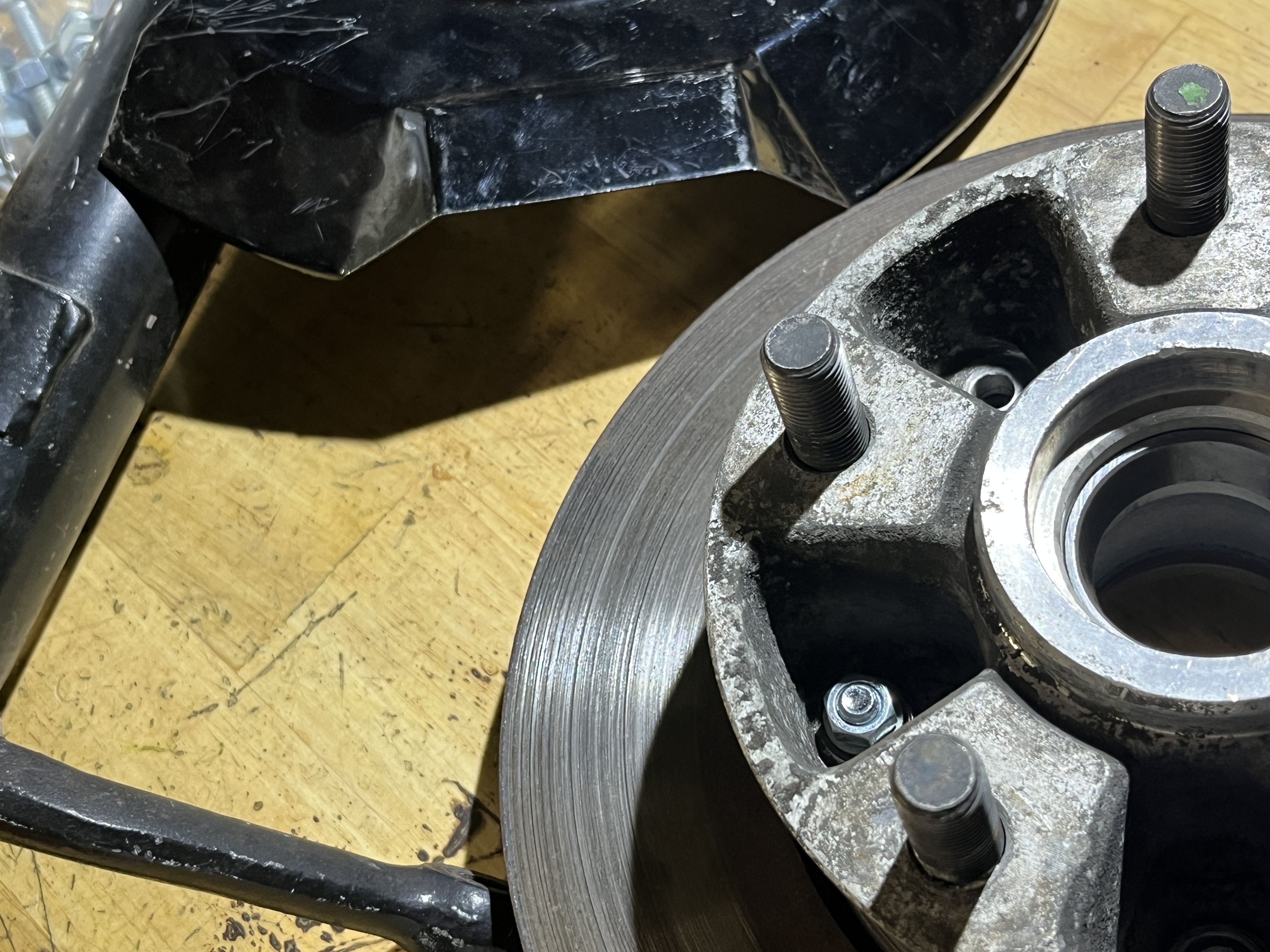

I’m installing these 911 struts. What kind of hardware is needed to attach these rotors to the hubs? Do I need to use locktite?

Posted by: mtndawg Oct 1 2026, 10:06 PM
Here’s a photo with the hub. What hardware is used to attach the rotor where the screwdriver is inserted? Do I have this right?

Hello - I don't know what year your 911 parts are, but a 70-73 uses M8x22 bolts, M8 hex nuts and spring washers. The Porsche # is 900-075-079-02, but any of the fastener supply vendors (also AA, etc.) can supply good ones, a couple of bucks a throw or less. The originals were a grade 8.8, so get at least that - I might be tempted to go to 10.9. Cheers!

..also check the manual for the correct torque on those. Would suggest high temp Loctite as well.

Posted by: sixaddict Oct 2 2026, 05:51 AM
Tony..
For my education, how difficult is it to remove mounting bolts if locktite is used. I’ve never used it in this area…….
Thanks
Posted by: mtndawg Oct 2 2026, 09:50 PM
Here we go, grade 10 with wave washer m8 x 25 since that’s what they had, fits perfectly. Needing new wedge pins to get closer to install.
