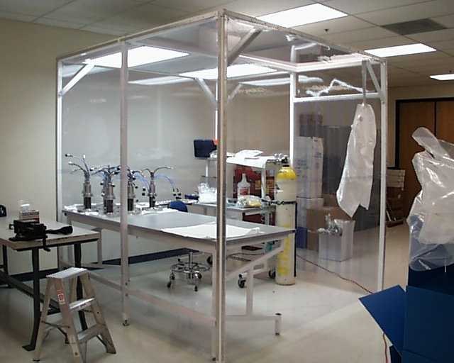

I built the frame of this cleanroom in my garage, at first I used my 110v welder, finally borrowed a 220v (higher amperage also) to finish it.
.125" wall, too difficult to get good welds with the 110v...so I guess it was an unfair comparison since both machines had different amp ratings..
......so I guess my advice would be to buy the highest amp rating 110v that fits in your budget
