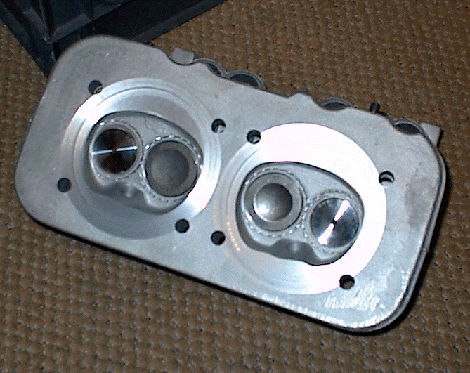

the machine-in lifters won't benefit my engine-in-the-works (see specifics below). My case IS apart. And have my cam/lifters all ready, but they are the perfect canidates for ... (booming voice) ... "THE LIFTER CAM ISSUE".
Here are my projected spec's:
94mm Flat tops (already cut for valves)
78mm CW Demello Crank
H-Beam Rods (lightened-clearanced whatever)
86 Web Cam/solid lifters
40mm IDF's
HD Springs
Stock Valves
Swivel Head Adjusters
Not to mention my heads, remember ?? Everyone is/was scared of them The dreaded seat staking...
is buying a set up from cb performance an option. no web cams. what are the chances that THEIR lifters will be compatible with THEIR cams.
kevin
That combo needs some serious refiguring in my opinion...
where are you getting a 24pinned H Beam rod? bushing the piston? Be ready for serious clearance issues with those pistons if you use a stock length rod.
There are many better cams for the combo as well, the 86 does not like CR at all, and has lazy ramps. its my stock replacement in 100% stock engines otherwise.
I thought I was lacking in the cam department Guess I was thinking the ceramic lifters might take up the slack...
