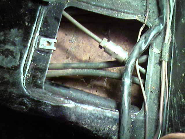

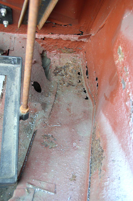

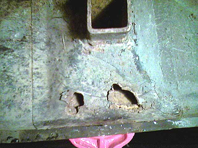

New pics of the longs, rust etc:
http://www.914world.com/bbs2/index.php?act=ST&f=2&t=44837&hl=metal+ready

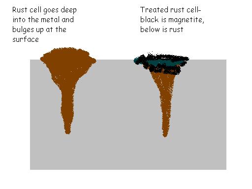

Shannon, the hard black stuff is magnetite or converted rust.
Rust is an electrical process. It forms charged cells. The attached picture on the left shows a cross section of a rust cell. The bulge at the top is what we see. Below it is a deep tapering pit of rust. When you sandblast, the sand particles penetrate as deep as they can into the pit but can't reach the narrow bottom......
On the right is an ospho or metal ready treated rust cell. The cell has been wire brushed to knock off the bulge, and then treated. The surface of the remaining rust cell is converted to magnetie, a hard stable form of iron oxide. How deep the treatment is, I can't say. But I do know from sandblasting, you can find rust underneath.
The magnetite is a seal to prevent oxygen from reaching the metal below. The rust cell is still there, still wants to rust but is blocked. The POR or other paint acts as a shield to prevent the treated rust from getting the 2 things it needs- water and oxygen.
Ooops, forgot the picture....
