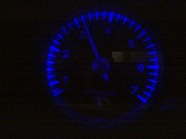

I love the LEDs. I bought the blu for my car and modified all of my needles to white so that they would show up (blue and orange are not very complementary). My gauges were also white on the inside (many of the older ones came that way.

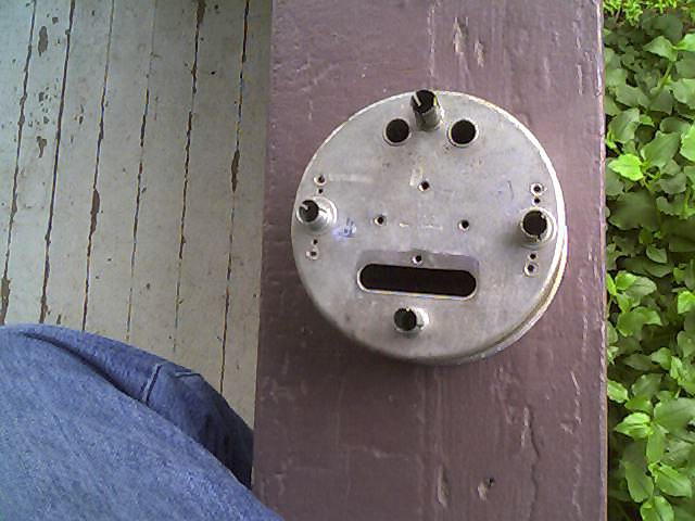

$250 is fair for all gauges because parting them is a bitch and there are parts involved. If I were to do this again, say in the summer, I would charge about $60/gauge + parts. Only a bit cheaper, but we will see.
The gauge pictured has my extra light bung added where the annoying dark spot is at the apex of the tach. What do ya'll thinK?
I got the LEDs that had the wider beam so I would have better spread. I don't think that narrow beam would work.
Here is the back of the modified gauge.
