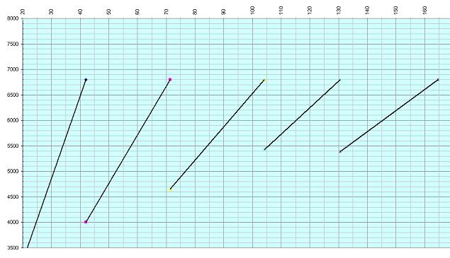

After the engine was dyno'd I had Hayden Burvill at WEVO suggest some gearing for my tranny to keep the shift points in the meat of the power band.
The stock gearing looks like this at 6800RPM shift points:
1st Gear = 0 RPM rev drop =max speed 42.0
2nd Gear = 2800 RPM rev drop = max speed 71.3
3rd Gear = 2146 RPM rev drop = max speed 104.2
4th Gear = 1371 RPM rev drop = max speed 130.5
5th Gear = 1409 RPM rev drop = max speed of 164.6
Graphically it looks like this (RPM on left axis, speed at top)....
Continued.....

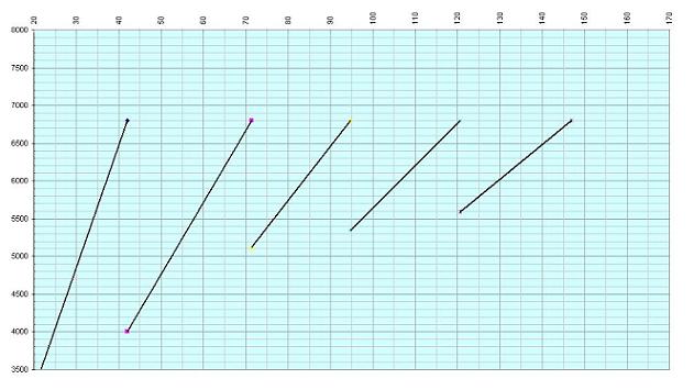

Altenative gearing (shorten up 3rd, 4th, 5th)
3rd Gear = 1681 RPM rev drop = max speed 94.7
4th Gear = 1459 RPM rev drop = max speed 120.6
5th Gear = 1409 RPM rev drop = max speed of 146.8
As you can see, the rev drops land squarely in the meat of the powerband.
Fun stuff to analyze!
