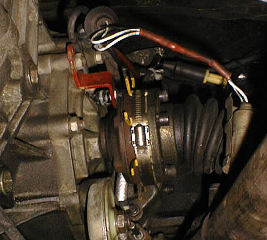

Home Made Wheel Speed Sensor
My approach to fabricate a sender was to use a commercial proximity sensor to “watch” 8 metal “flags” clamped to an inboard CV joint (the flags are the yellow things in the pix). The flags are just ½” cutoffs of Home Depot ¾” galvanized angle, clamped to the CV with a large hose clamp. The flags rotate past the proximity sensor, causing the sensor to generate the pulse stream for the speedo. You’ll have to fab a bracket, and mount it to a convenient stud on the tranny case. I located mine as high up as I could to minimize road crud exposure. The whole assembly is shown below. I used 1” strap iron for the bracket shown, the sensor requires a ½” hole.

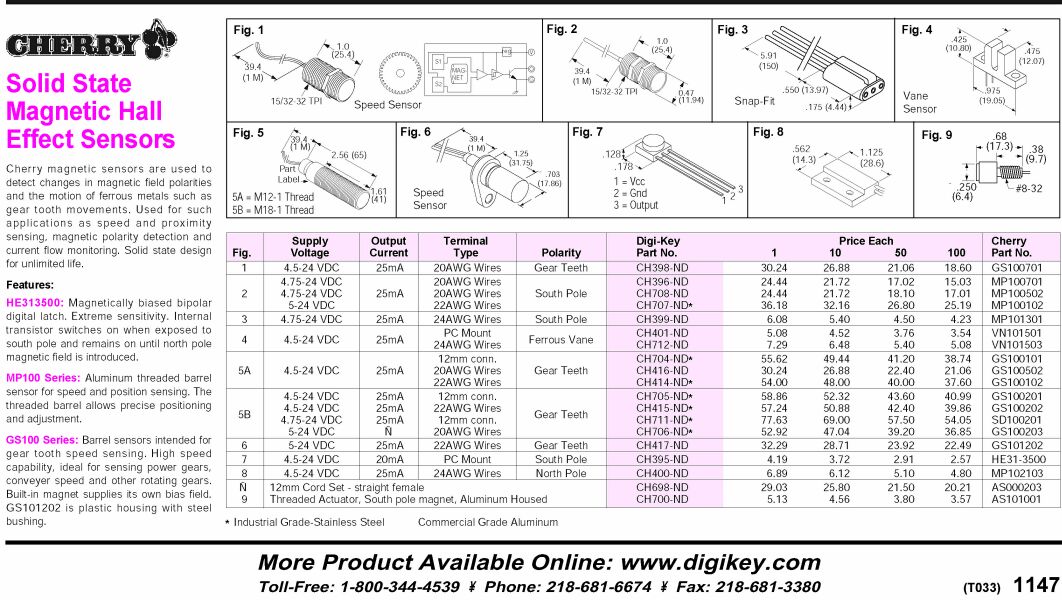

I used a Cherry Corp gear tooth sensor, model number GS100701 which I got from DigiKey (www.digikey.com) for ~ $30 (the Porsche sensor is over twice the cost, naturally). (Digikey’s part number for this item is CH398-ND). This is a common sensor and is available from multiple distributors.
It’s important to get the flags spaced evenly around the circumference of the CV joint, and to “fly” close to the sensor tip. You can make a flag spacing template by wrapping a skinny strip of paper around the CV body, marking where it overlaps, then folding the strip in half (with the mark lined up with the edge), then folding it in half twice more. Mark the creases, re-wrap on the CV, and transfer the marks.
Clamp the flags loosely on the CV with the pipe clamp, line them up on the spacing marks, then slowly rotate the CV and make sure each flag “flies” past the sensor closely but without whacking the sensor. The surface of the flag should be parallel to the surface of the sensor tip. You can “calibrate” the distance by sandwiching a dime in between the sensor and the flag(s), then removing the dime without disturbing the flag. Tighten the hose clamp when everything is lined up.
While the addition of the e-speedo is recent, this sensor rig has been on my car and trouble free for over a year now, with multiple DE’s and AX’s under its belt, not to mention at least one ice/salt/sand/ storm.

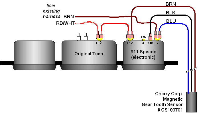

Electrical Hookup
You will have to splice enough extension wire onto the three 36” leads coming out of the sensor to get from the tranny all the way up to the speedo. Make sure to route the wiring away from the exhaust system and away from moving parts, and make sure the splices to extend the sensor leads are waterproof. I’d suggest using SAE-J1128 spec wire (try your local FLAPS that sells to the trade, or http://www.kayjayco.com/catP125CWire.htm, among other sources), 18 - 20 gauge is fine. The PVC cr@p that your low-end FLAPS sells won’t tolerate the oil and heat (or salt, or ice) very well.
The sensor needs 12v and ground, and provides the direct output needed for the speedo. I terminated the leads with ¼” quick disconnects (Radio Shack), and used spade lug “doublers” (Radio Shack) to tap the switched 12v off the tach, and the ground wire that came up to the original speedo. You’ll also need to make a short jumper to bring 12v over from the back of your tach.
The connections are as follows:
- transfer the indicator lamp assemblies directly from the old speedo to the new speedo;
- add a lug doubler between the tach’s 12v lug and its existing harness wire;
- add a lug doubler to the speedo’s 12v lug;
- the JUMPER wire you made goes from the 12v on the tach to the 12v on the speedo;
- the BROWN wire from the sensor goes to the +12v lug doubler on the speedo;
- add a lug doubler to the ground lug on the e-speedo;
- the BROWN wire (from the orig. speedo) goes to the ground lug (-) on the e-speedo;
- the BLACK wire from the sensor connects to the lug marked “31b” on the e-speedo;
- the BLUE wire from the sensor goes to the (ground) lug doubler on the e-speedo;
- the “A” lug on the electronic speedo is not used.
My “new” speedo reads the same as the old one, ie its about 5mph high at 80 mph (on 205/55 - 16 tires). My sensor rig drives another (more accurate) system in addition to the e-speedo, so I’ve not bothered to fool around with recalibration.

I found some information about the sensor too.
Sorry John. I am not trying to steal this topic from you. You are the maestro here. I am just so excited about this
and the sensor.
Guys, thanks for the attaboys. I've learned so much from this community, I thought it was time to give a little something back.
Timo, thanks for doing my work for me. Got a little frustrated with the pic thing, should have stuck with it a little longer.
One minor point on the last sensor pic (directly above). That is a pic of a slightly different sensor in the same family as the one I used (Cherry's product literature isn't too clear), but a little too long to shoe-horn into the space required. The GS10701 is figure 1 in the Digikey page you posted.

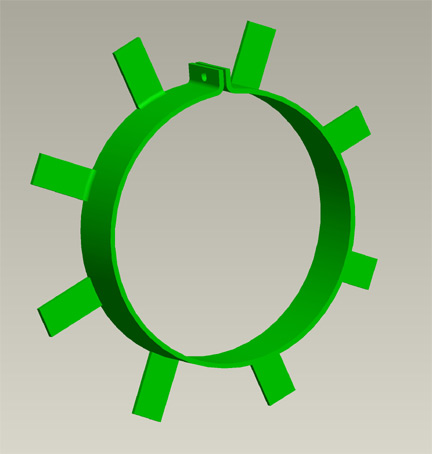

Hey Mueller and other Eng people,
How hard would it be to make a plate with the teeth on it that gets sandwhiched in the cv joint??
Would need 4 bolt holes, 8 errr.... pokey out things. This plus the bracket and sensor would be an excellent kit!!!
Fiid.
It wouldn't be too hard to make a ring, or collar, it just comes down to interest and the most cost effective method.
A sheetmetal design wouldn't be too bad IMHO:
The collar approach is the way to go, you don't have to crack the CV joint to mount it. If I was sure up front that 8 was the right number of "flags" I needed, I would have tried to fab exactly what Mike has drawn. (Nice modelling pkg Mike, which one are you using???)
BTW, if you're going to go the hose clamp route, life will be a little easier if you use the spacing template I described in the post to mark the hose clamp instead of the CV joint, and tape the "flags" to the inside surface of the hose clamp prior to wrapping it around the CV joint. That way, they are less likely to fall out as you're assembling the, uh, assembly.

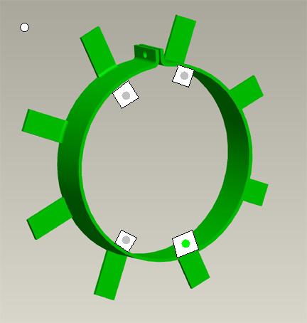

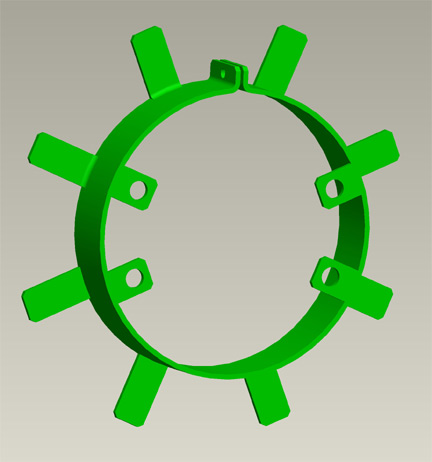

Mike - add 4 drilled tabs on the other side of the ring which would replace the lock tabs for the CV bolts. This way it is held on to the CV with the CV bolts. This will be much more secure and will prevent any possible rotation about the joint.
Keep the split arrangement so that it does not require removal of the CV for installation.
Setup 2 of the tabs so that they are just on opposite sides of the split joint
James
That would work James !!!!!
Pro/E is my tool of choice So easy even I can use it
That looks like it would be fairly easy to fabicate.
Well yes and no to James' idea. The "Half Moons" under the cv bolts are hardened steel. This ring will probably be soft sheetmetal and might allow the cv bolts to loosen. Safety wire the bolts??????????
