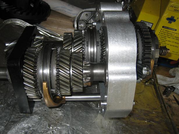

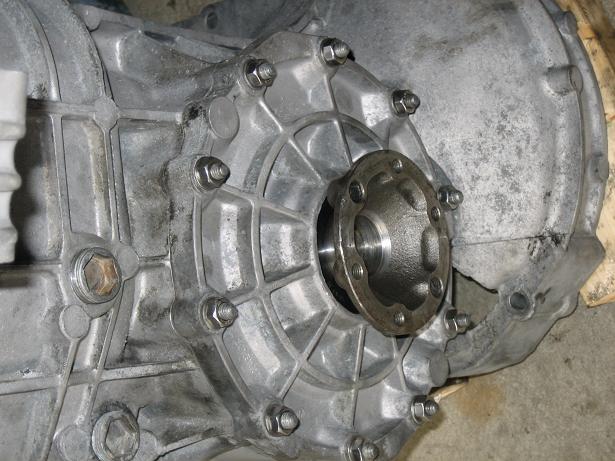

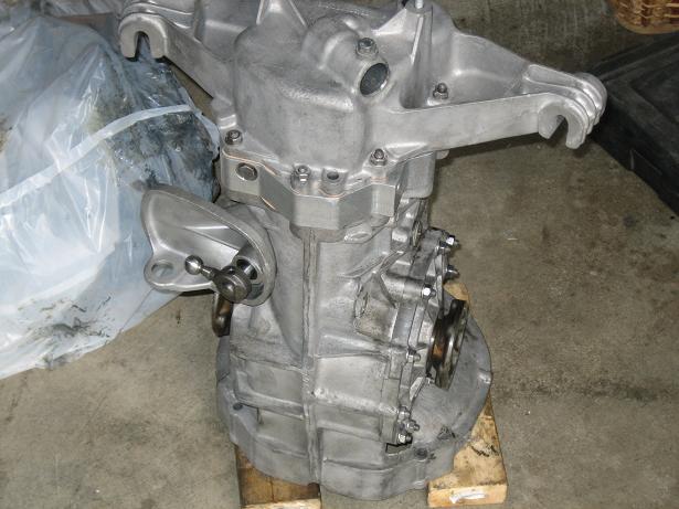

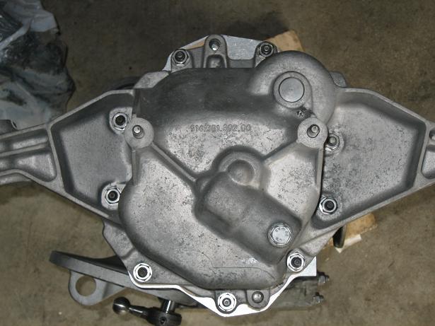

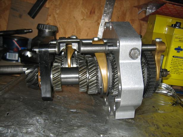

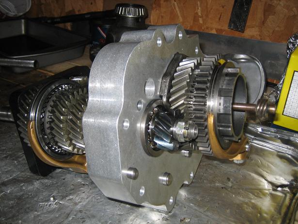

Just thought that I would post a few money shots of the tranny that I rebuilt for a customer. All new everything that needed it and some that didn't plus an aluminum intermediate plate. This thing is pretty enough to have as art in the home! I did not clean the case, it came to me that way (as I perfer) and really sets the tone. Also, now standard on all of my full rebuilds are new SS nuts and washers.......I love this tranny. I may not let it go

Good question, Tim. Since I started doing the "you send me the gear stack and I will rebuild it" thing it has gotten much easier. The stack alon weighs 36lbs and via FedEx cost next to nothing to ship. From here to Atlanta was $16 about. You can send the case too for about the same amount. The big weight in the case besides the stack is the dang diff. I mean look at it, its solid metal! Just sending me the stack for a rebuild opens up a rebuild to more people, lowers the cost of labor and shipping, and becomes more of a value to the community.
I am gonna be putting an ad up in the resources after my test on the 19th that will have fully illustrated instructions on how to remove and install the gear stack so you can send it to me (or work on it yourself). It will be a great resource all around. I already have some killer pics for the how to. I cant wait.

I guess I am kinda used to seeing pictures of tail shifters and wevo converted side shifters.
If I didnt know better I wouldnt think it was an average side shift. I have never seen one so clean The aluminum intermediate plate kind of throws off the look as well.

Yours WAS the best tranny, until this one came along all DRAINED and CLEANED and with an aluminum intermediate plate to put in it.
I still love your tranny......I just love this one a little more. Its not you, its me

Nope, you should defiently not need gears. If you look in trhe first few pics you will see that the gears are always intermeshed unless something catasrtophic happens. The grinding you are hearing is you selector sleeve and your synchro teeth not playing nice because your synchro bands are probably shot. Once they start to grind, and you are sure it is not the various bushings or adjustments causing it, it is wiser to take the tranny apart at that time. The longer you wait the more expensive the parts are gonna be to replace.
