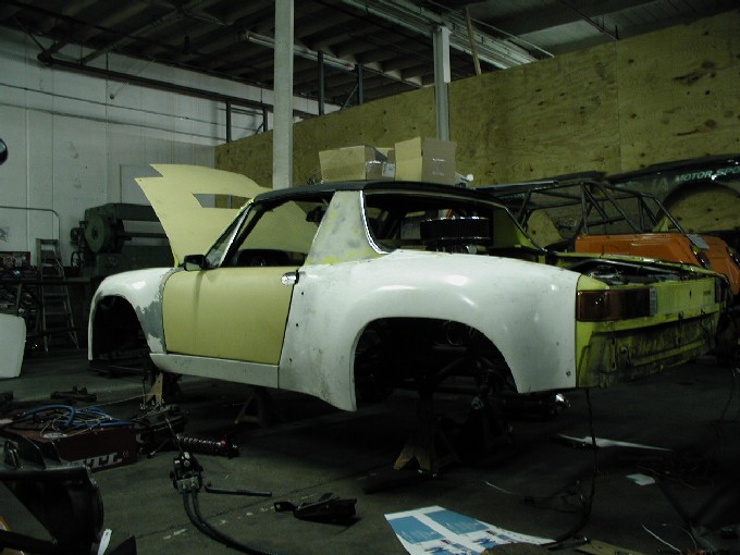

I vote "None of the Above" My car just got delivered to a shop to get started on my project. First up, fitting the 3 Rotor engine into the engine bay with the transmission attached. I'll be sure to take pictures and start a blog. Will it be a hack job? I sincerely hope not. I hired the guy based upon a beautiful LS6 conversion he did on a mid 90's 3 series BMW. It looked almost factory and on the track outgunned an F40. Very nice. He said his biggest problem was people saying they could "do it for $5,000" when it cost him $20,000 and he did all the work. I imagine the same is true for the V8 conversion guys here.
