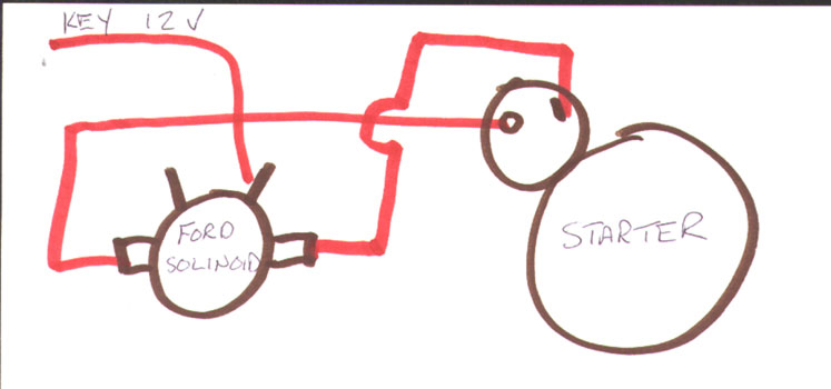

After you clean everything and put on a new ground strap if you still have problems here's the fix.
Go to your local FLAPS and buy a Ford starter solenoid, the type that mounts to the firewall (early eighties), some heavy wire, one spade, three large and one small ring connectors.
Mount the solenoid somewhere like on the side of the trans. Then run a wire from the hot side of the starter to one of the big terminals. From the other big terminal run a wire to the keyed (spade) side of the starter. The wire that did go to the spade connector now goes to the Ford solenoid.
What this does is the VW/ Porsche starter must have 9 to 10 volts to click the solenoid in, over time the wiring gets old and there is too much line loss. The Ford solenoid only needs about 3v to kick it in, and then it gives 12v directly to the starter.
