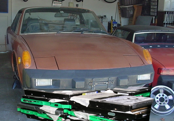

In my experience, the only sure way to secure the data on old hard drives is to use them as jack stands under a 914--It's safe, and insures decades of protection!
LOL
