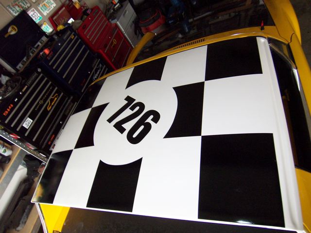

I trashed my $100 top decal. I'll leave it on for Moab, but It'll have to be redone.
There's also a circle that goes around the number, but there was absolutely no way it would center in the correct space.
I ended up having to apply what you see as individual pieces, because I didn't know the water trick.
I've pissed away more than $100 on the RS...
Bubbles or not, that design is cool!
Yes on the design. I like that a lot.

Joe, my cutter is 30 inches wide. However the targa top is about 31.5" wide. If you can live with a bit of a gap at the front or back, or a two piece sticker, I can help out.
I use exaxto blades to pop bubbles...also on a top, you can either section like Mark said or use a black border to compensate for the width issue.....not like a Porsche owner has ever had to compensate......
