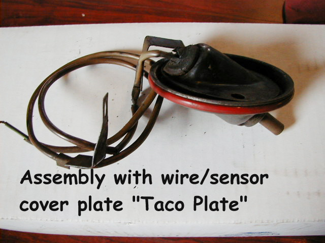

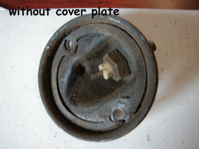

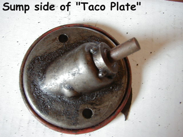

Posted by: SLITS Oct 30 2006, 12:48 PM
Well, that clears everything up ('cept for the Limey's skin).
I just thought you were still pissed 'cause we dumped that rotten tea into the harbor.
Iffin' ya want a pic of the "taco plate" jes ask. Maybe we might even send one across the pond and to the down under so you won't burn yer finger.

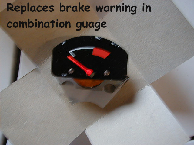

Posted by: SLITS Oct 31 2006, 02:02 PM
And the guage that goes with it (replaces brake light in combo guage)
