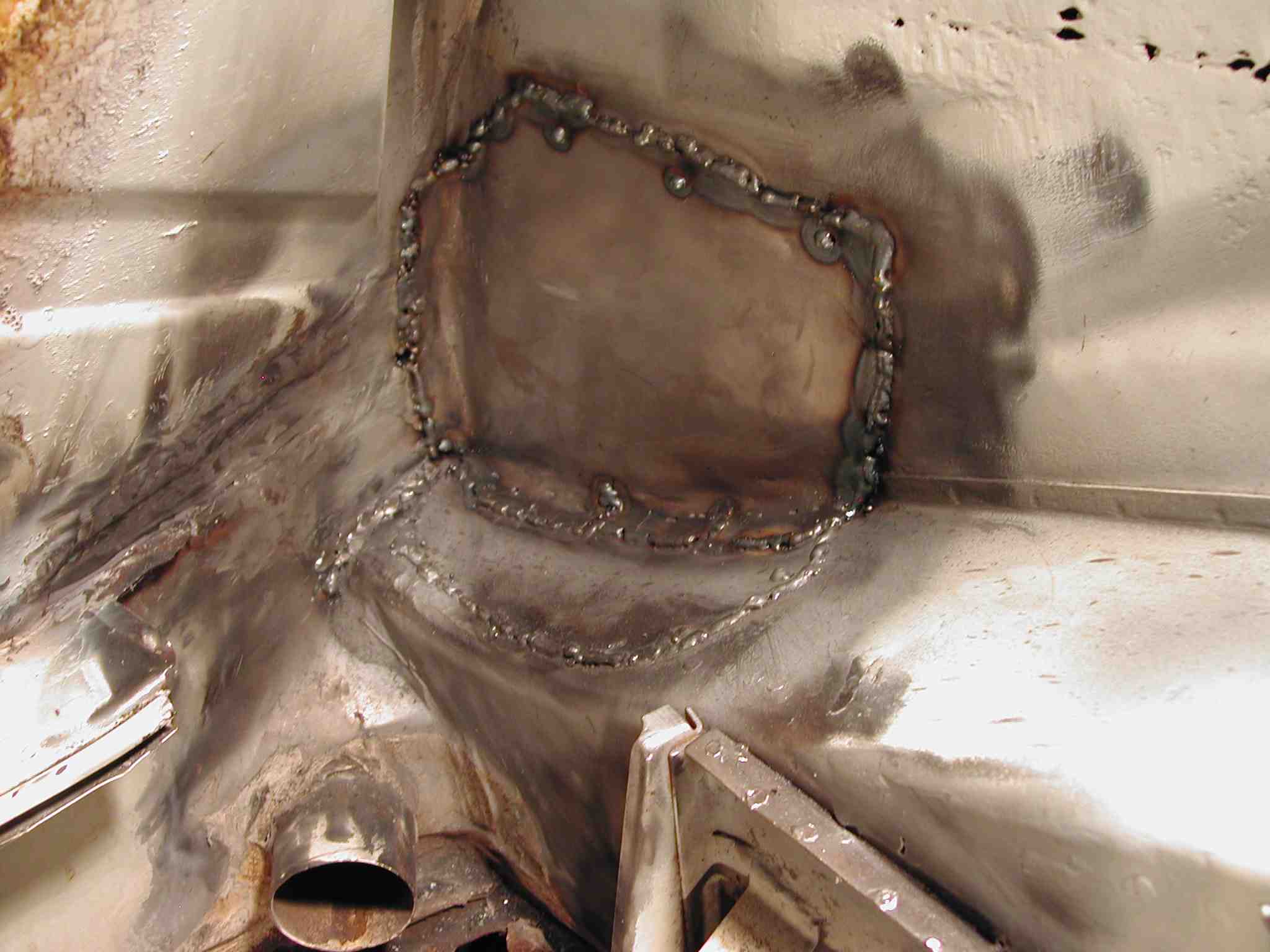

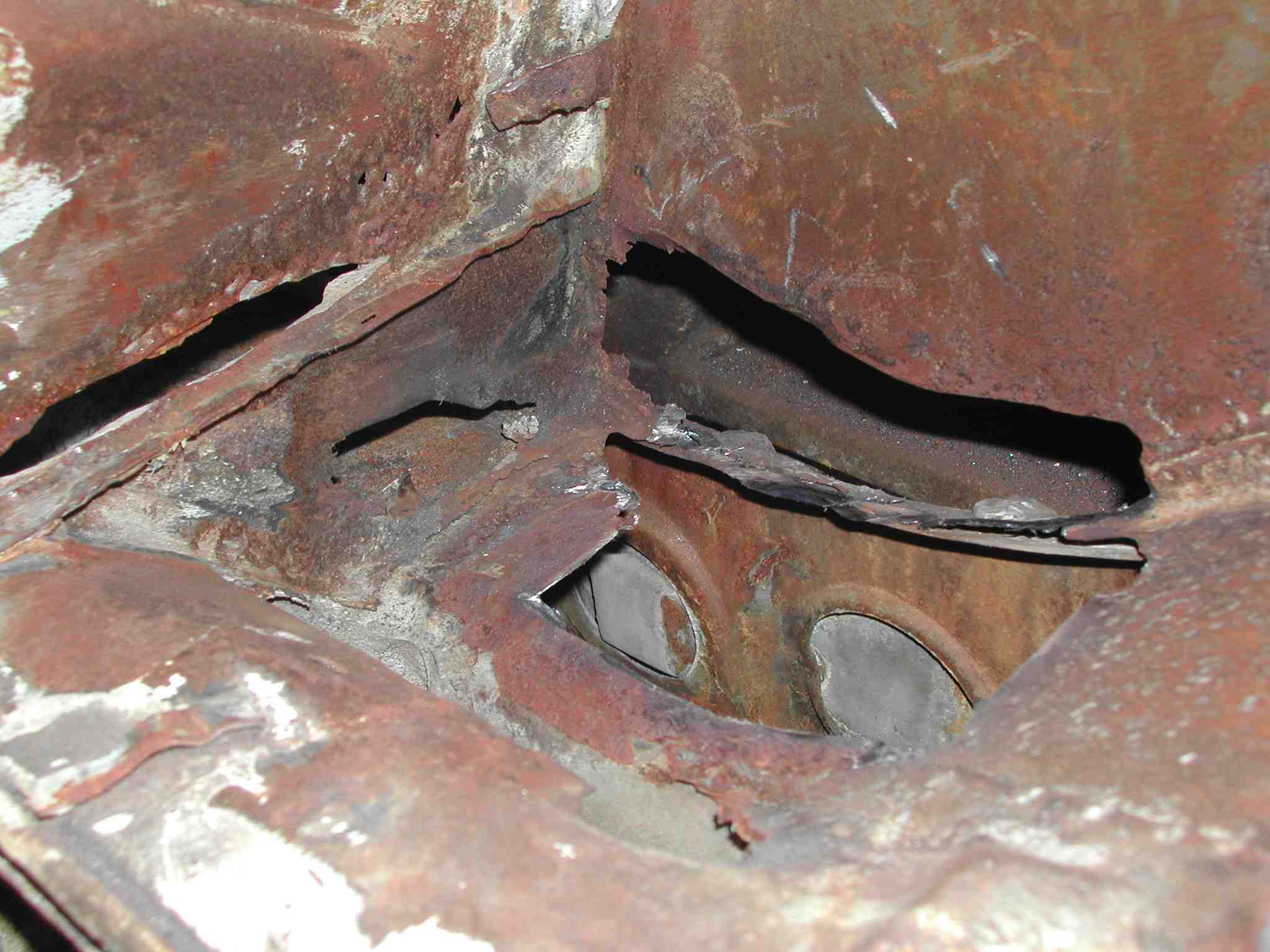

I did it, teaching myself to weld along the way. Just takes a little bit of balls and determination to turn this:
into this:
Into this:
Um. INTO THIS:
Okay. What did I do with my pics of the finished hell hole job....
Well, anyway. I did it, knowing nothing about it going in, and learning a ton by the time I was done.
Zach

Here's my hell-hole-be-gone pics (before final paint) :
Oh yeah,and for those who are afraid of welding- my welding experience consisted of about 10 minutes practice on scrap metal basically to set the wire speed and voltage and practice making little circles.
