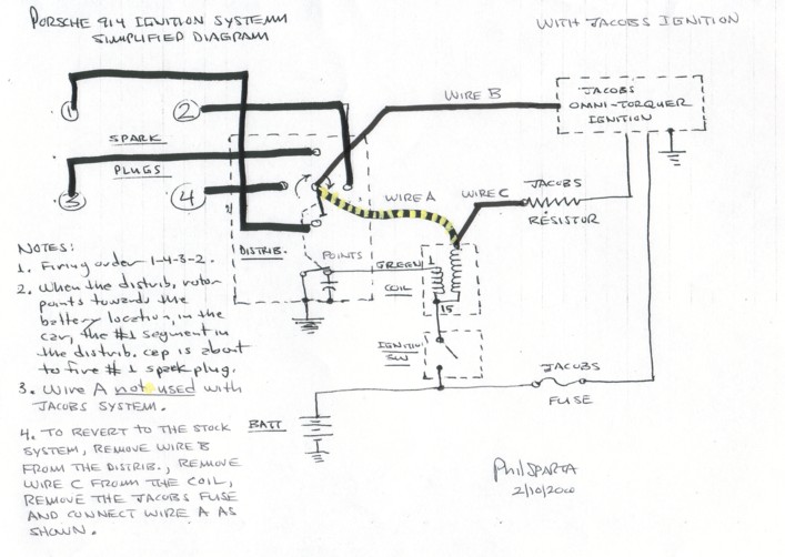

Posted by: philinjax Dec 4 2003, 03:41 PM
Brad,
I am sure that all things and systems will be improved over time (except age) but as far
as a Jacobs system failing at midnight on the express way, there is a perfect back up. You simply pull the inline fuse for it, pull the hv lead off the Jacobs unit and plug it in to the top of the dizzy.
Fire up and go. The stock ignition stays intact as a back up.
