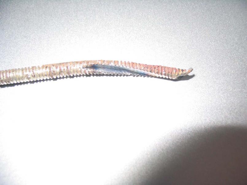

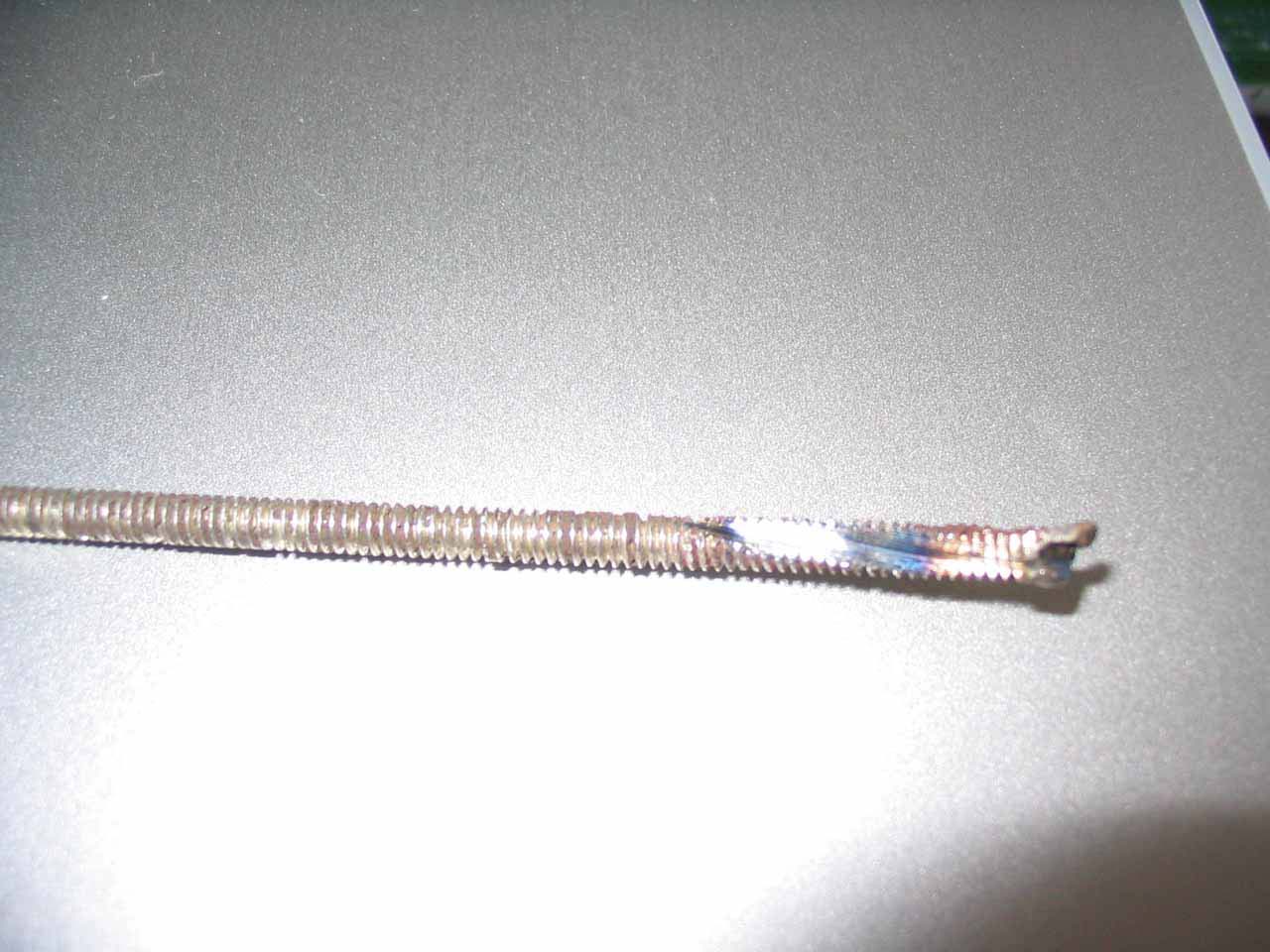

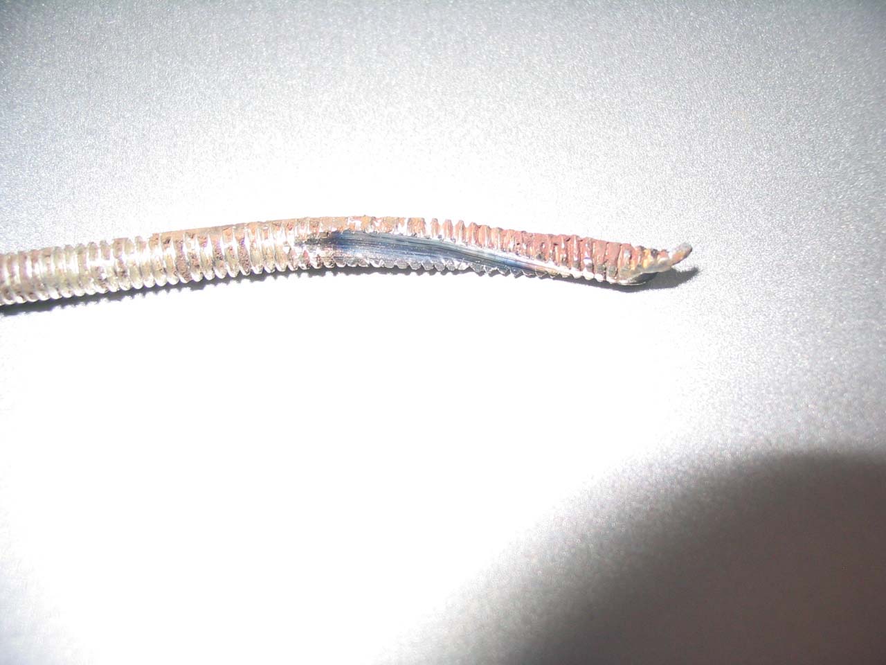

then i bought a threaded 1/8th inch rod and grooved it, torqued it, bent it until it started grinding through the mess inside the tube.
it's hard to describe the black, junk that came out. all i can say is i can see why it was so tough.
days and days of thinking, doing, failing, planning, buying, doing, failing, buying, trying, buying, thinking, trying, failing. you get the idea.
these pics are of my boring tool. anyone wanna buy it... onethousanddollarsamerican!

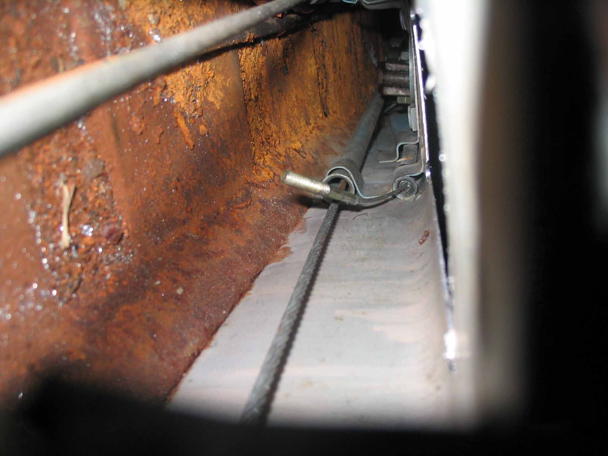

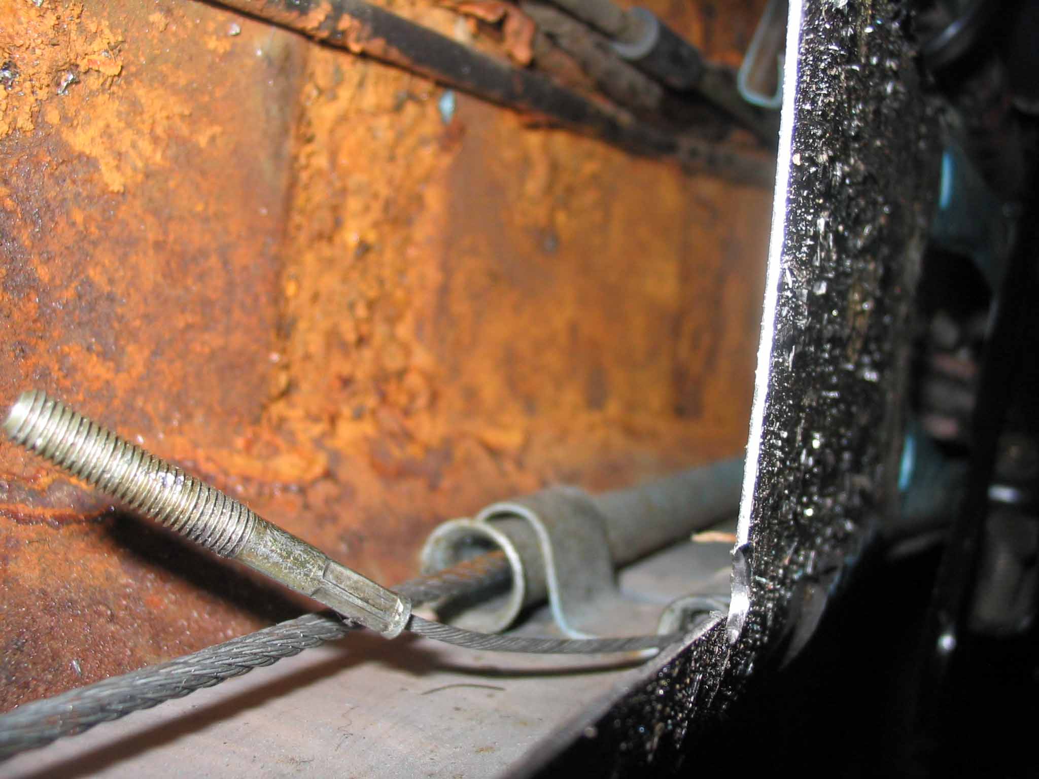

josh2, my guess is that the throttle cable is wrapped around the clutch cable, it wouldn't take much. i never would have known the risk of getting the cables tangled had i not cut my tunnel open.
here's a couple pics of the tunnel in case you haven't seen it:
